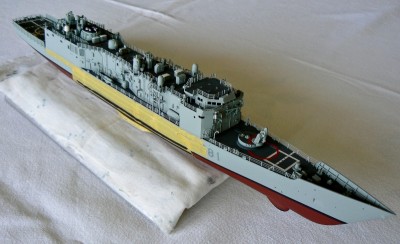

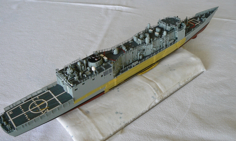

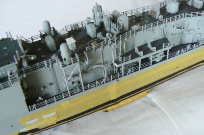

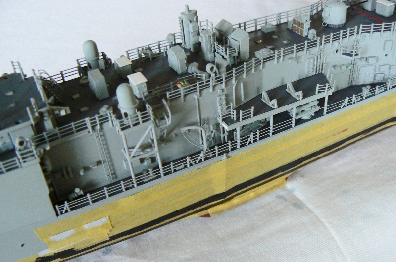

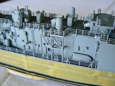

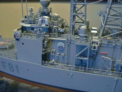

Hi all once again.

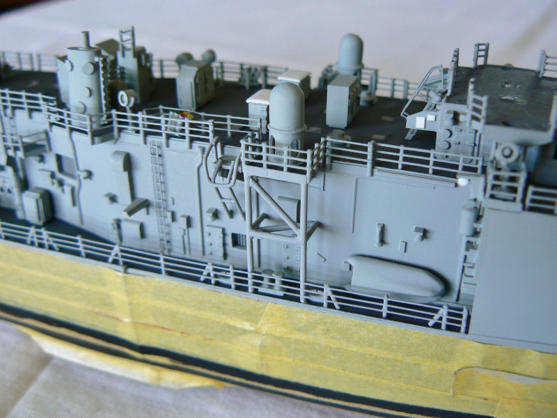

After this horrible, eternal winter that I would like to forget and I am not able to, I have had some time to devote to this construction, so I am now in the runway to say so.
The following step was to set in place all the handrails in both decks. The ones in the upper deck are made in steel tube, while the ones on the main deck are made in wire, so I had to make some --well, many-- tests stretching sprue to have threads in different calibers. I more or less got them, although at a short distance the difference is hard to appreciate.
I have also set in place the decks for the SAT aerials, with the supports and all the trimmings, and most of the elements in both decks are already glued in place as well.
It is now like this :

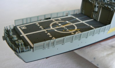

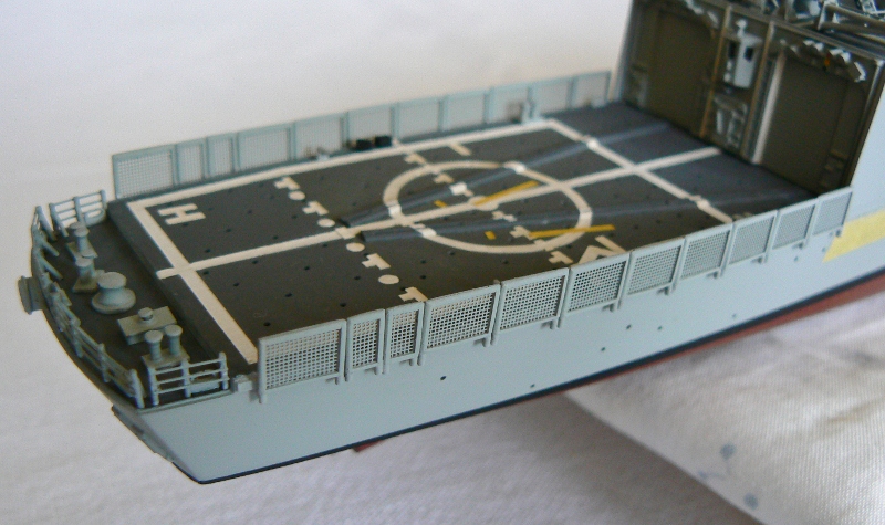

The flight deck is virtually finished as well, and the nets are to some extent translucent, what allows to see the details on deck through them. I didn�t expect so much, honestly. It is like this :

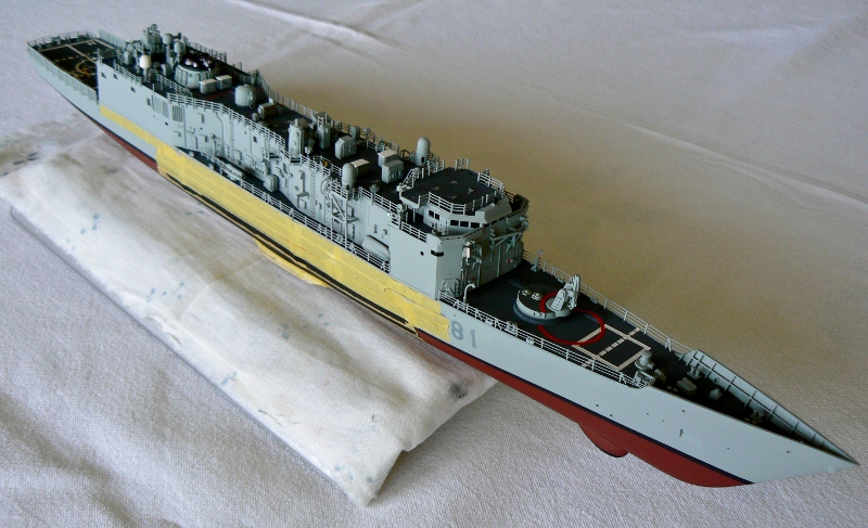

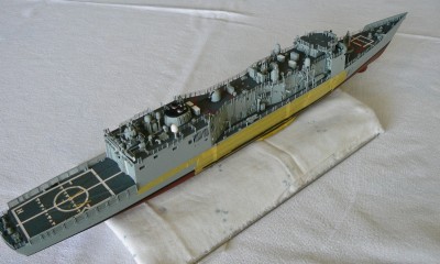

And finally, the whole ship looks like this at the moment :
And that�s all for today. I hope you like it, and warmest regards to you all,

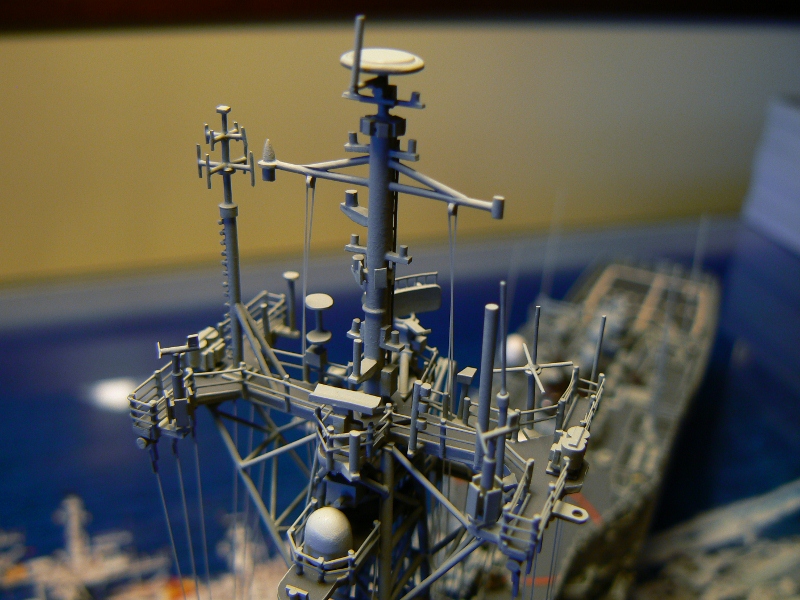

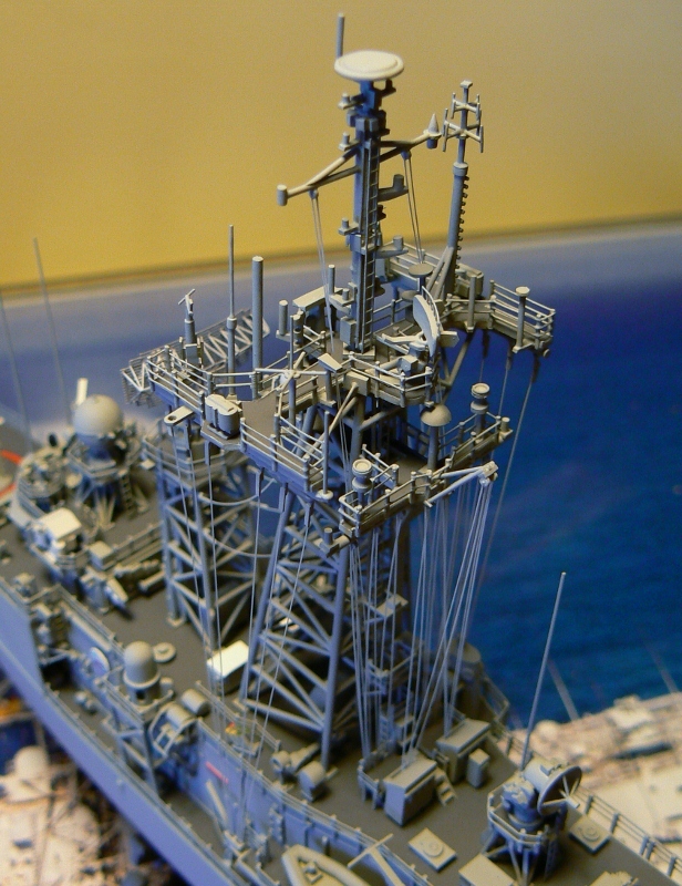

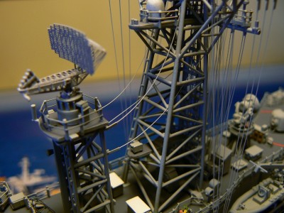

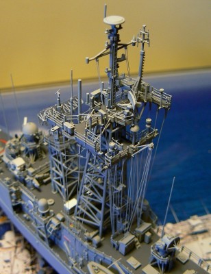

Hi all once more:
Well, the last thing to do is the final fixing, and a couple of minor details.

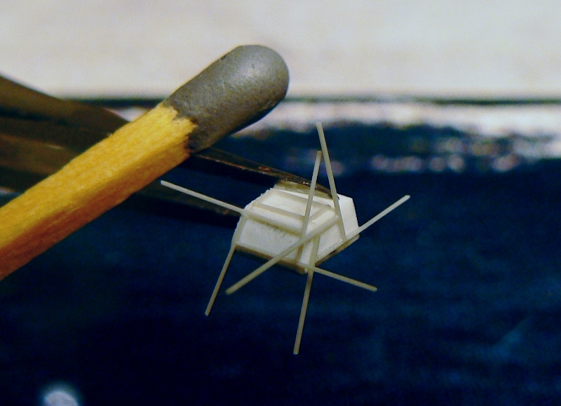

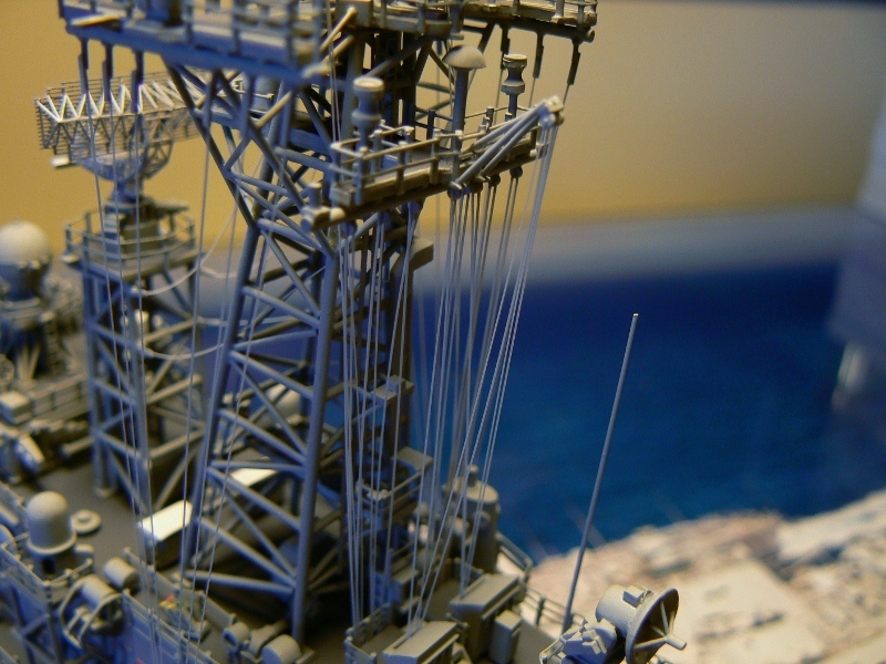

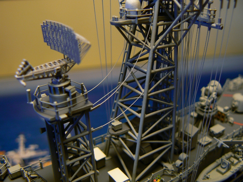

The halyards are made of stretched sprue, glued at the top and loose at the bottom, what makes the process way easier, and makes no difference reg. realism.

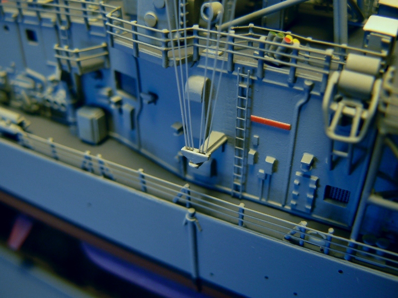

The main mast has twelve wire aerials, six on each side, in groups of three, fixed at the top with short Evergreen strips, and at the bottom using a kind of Evergreen sandwiches --the same way as in the original FFG�s-- that are necessarily much bigger than the original elements, but it is something we have to accept.This :
Once in position, the effect is very realistic and convincing:
Maybe the halyards are a bit thicker than necessary, but I was not able to make them thinner so that the liquid poly does not melt them. In the pics they look also much thicker than they actually are because they are not painted in order to make somehow translucent.
The halyards in the upper mizzen do interfere with the elements present there and do not fall straight, which is exactly what happens with the 1/1 Santa Mar�a. This not only adds another element of realism I didn�t count with, but is also a further evidence that the measures of the mast are correct. Wonderful.

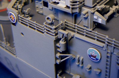

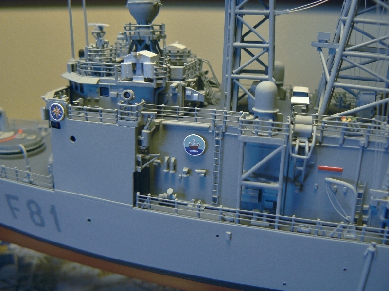

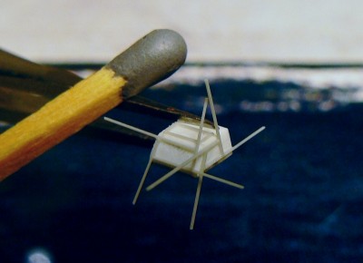

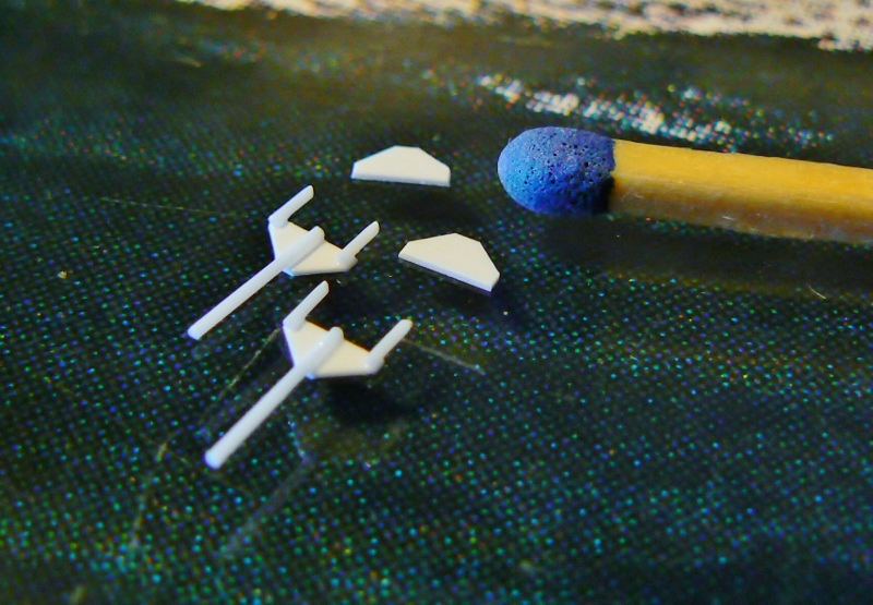

The flight control station in the flight deck is made with a piece of evergreen, and the windows profiles again with stretched sprue :
As you can see, the macro has no mercy on mistakes, but at half a foot distance these mistakes disappear, and the effect is excellent.

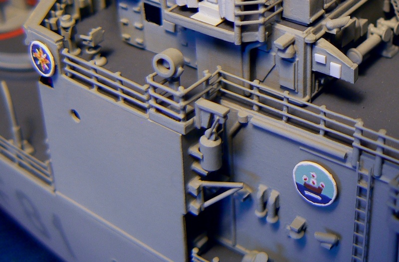

And at last a touch of color, the crest of the 41st Squadron and the specific crest of Santa Mar�a. I would tell you a lie if I said that I got them at the first attempt, so I will not say so... :biggrin: But at last I got them. Not as well as I would have wished, but I can live with it.
And that�s all. I will try to upload some pics of the finished ship tomorrow, if possible.
