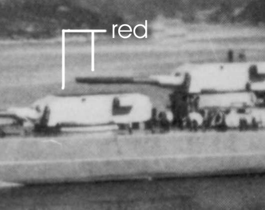

It is my research but I come to think that the barrels were red on early 21st May 1941.
Bye!
Bye!

Re: Reconstruction of hull, Battleship BISMARCK, 1/100 scale
Well, I would like to know what makes you thinking this. Why should they have switched that colour TWICE? Can you please PM me?109 wrote:All the best for 2013!
Bye!
Are you saying early in the morning of 21st May 1941 and not before and after?
Happy painting ~ Olaf!
Edit: I saw that discussion at Graue-Flotte, ... eeh ... hmmm ... I understand the thing about panchromatic and orthochromatic film, but I think this drives you down the wrong path. There was just ONE colour ordered for the time the ships were under friendly air cover. And there is only ONE colour they used to overpaint it while in Norway and upon leaving the air cover.
Hi,
in the Grimstadfjord the photographer used an orthochromatic sensitized film material. This material is sensitive to UV, blue and green light, less sensitive to yellow and orange and non-sensitive to red light. This red blindness resultus in a transformation of the original red into black or dark grey in the b/w photograph. This type of material was common in the 1920s to 1940s. This type of film could be developed and exposed to red light conditions - I guess you saw a red light photo chamber in a movie or so.
Also, Norway was "red sea area", baltic sea "yellow sea area". Red turret tops were applied as long as the ships were in the red sea area and within the range of German a/c. In the fjord markings were covered.
During the 1930s panchromtic sensitzied film became available which was sensitive to UV, blue, green, yellow and red. Colors were transformed into grey values more or less according their relative brightness in reality: dark colors as dark greys, light colors as light greys etc.
Bye,
Bernd.
Bye,
Bernd.

I'm sorry, but you can't tell from the pictures what type of film they have used. It should be the other way round. If you clearly know the type of film, then you can try to find out the colours. In addition, you need to know what colours were available, or should I say allowed according to the paint regulation.
Red around Norway was true for another operation. For Rhein�bung it was clearly yellow, as stated by an official document (which made its way round the internet some time ago). The dark grey you see at Grimstadt is indeed dark grey. It replaced the yellow which is *visible* during the stay at Gotenhafen.
The aerial view you named *Hamburg?* ~ Believe me, since years I've been pondering about the different *colours* in that photo. I have a theory, but I don't have proof so I keep my lips sealed.
Anyway, if you have a colour photo of Bismarck showing the red, then I owe you an apology (in return for showing me that photo ...
@ Anatoly ~ Too bad, my 1980 edition of the Baron book doesn't contain this photo plus the caption. I don't know what to say regarding the latter, but all I've heard is that the black appearance of the barrels plus the light coloured (metal?) rings had something to do with the shooting trials (AVKS-Schie�en) in the Baltic. It is the first time I heard something about red lead used on barrels and I don't see a benefit here. Well, I'm no expert by any means, but could it be that there went something wrong during the translation from German to Russian to English?
Happy guessing ~ Olaf!

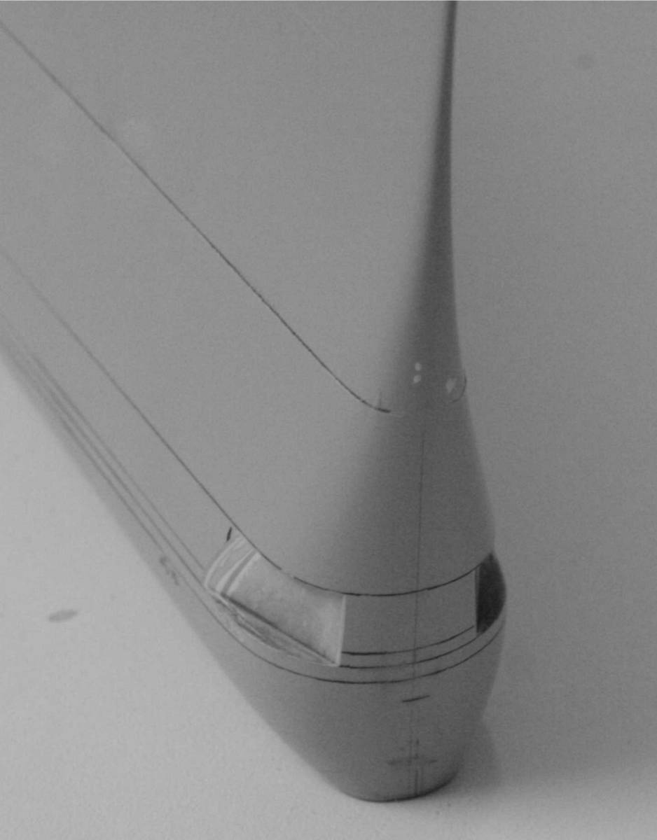

- 109
- Posts: 627
- Joined: Sun Nov 16, 2008 7:56 am
Hi,

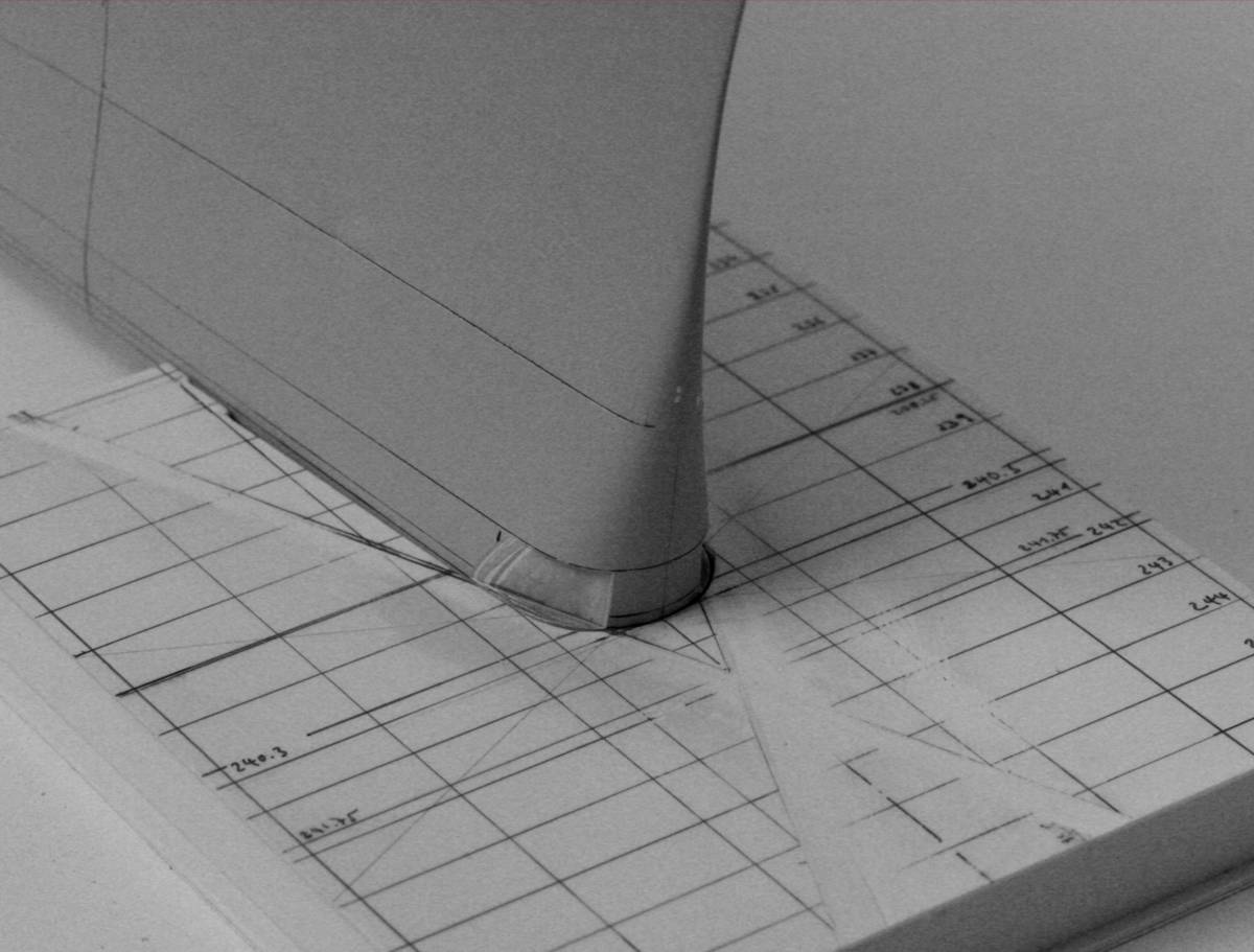

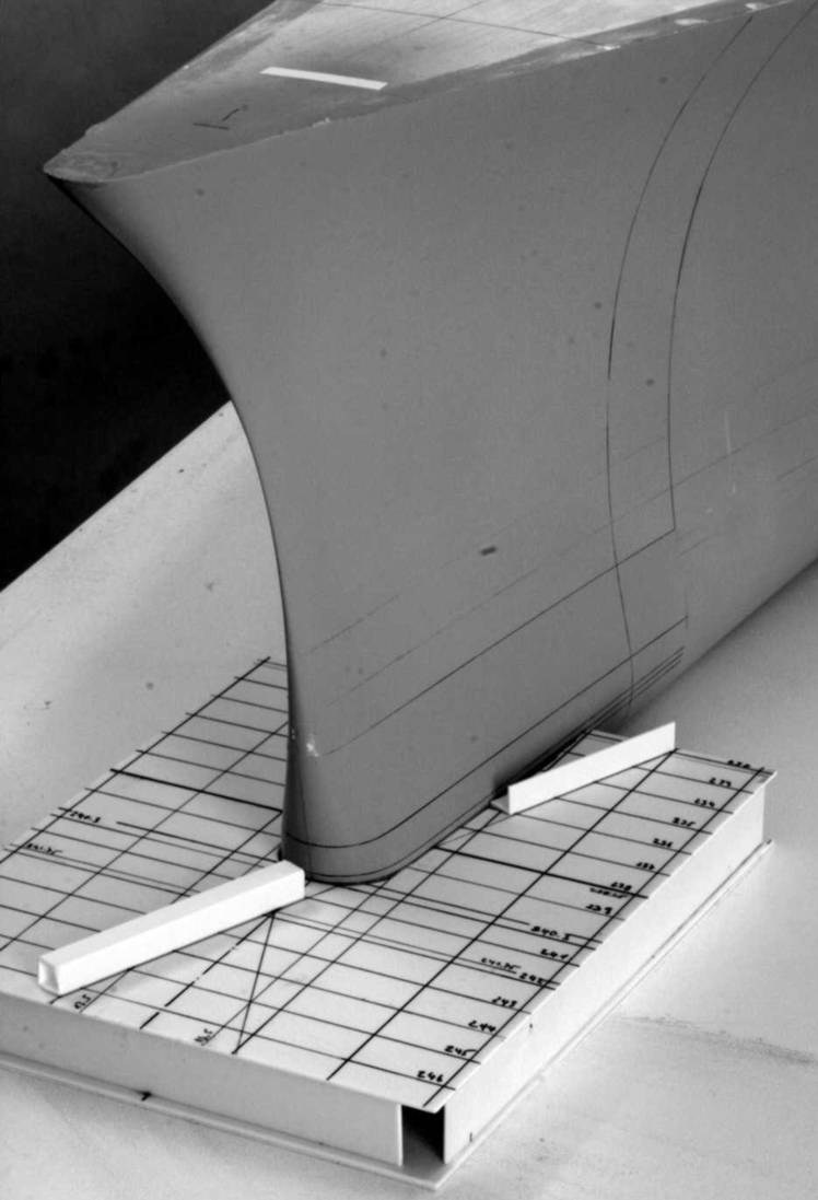

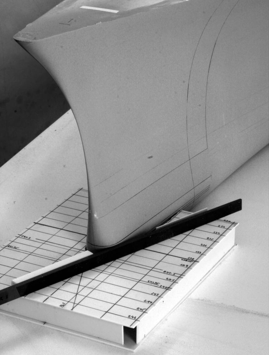

I finally started to build the active sonar in the stem of my Bismarck. I first made a jig to guide the file at an 22.5� angle and parallel to the waterlines.
Bye,
Bernd.
Bye,
Bernd.
- 109
- Posts: 627

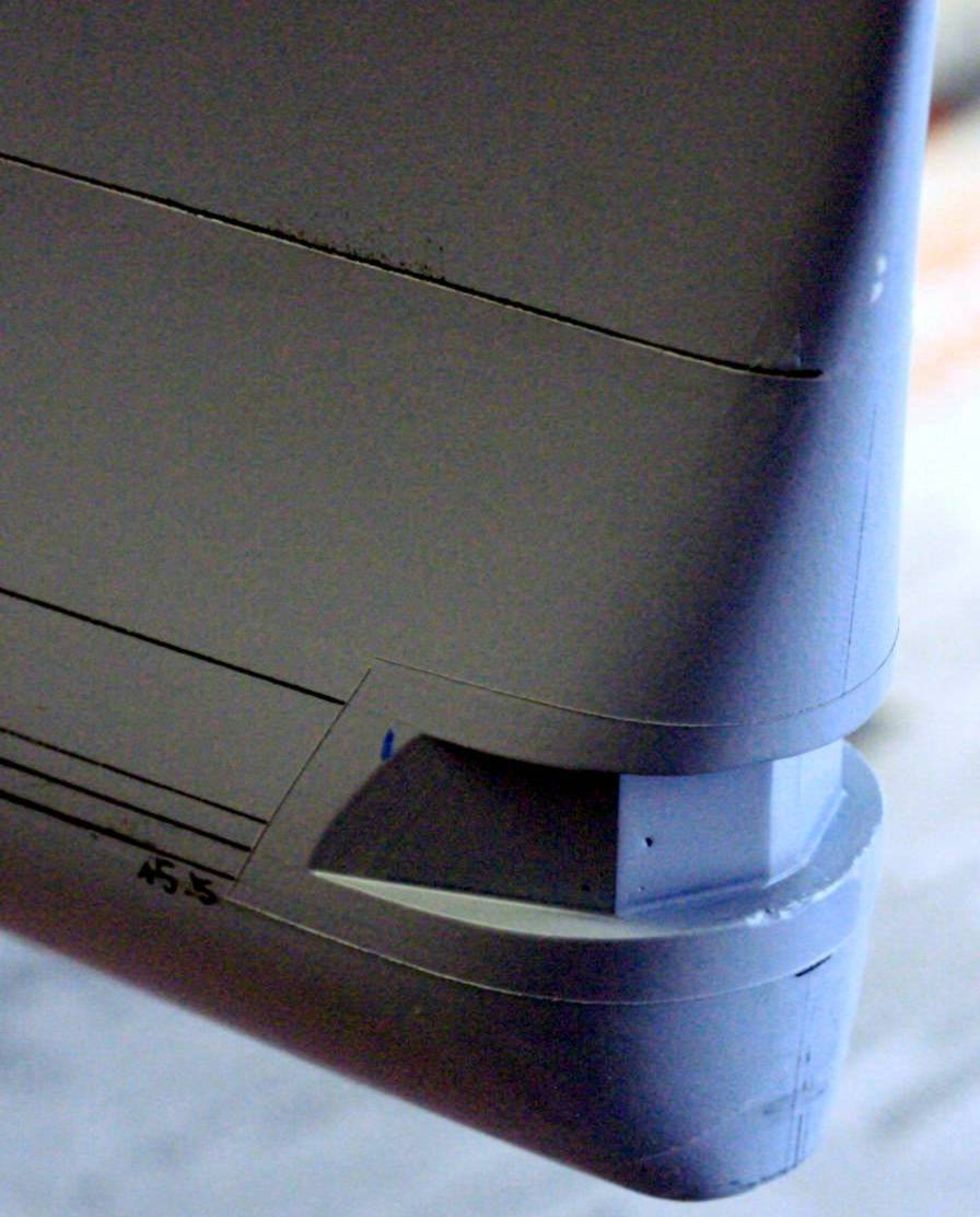

Two segments have been filed into the stem ...

The jig is a very good idea .Have to remember that one .
- 109
- Posts: 627
Hi,Richard J OMalley wrote:The jig is a very good idea .Have to remember that one .
yes, it�s a handy jig. Use metal or hard wood for a long lasting jig if neccessary ... Bye!

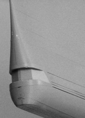

- 109
- Posts: 627
Hi,
filed all facettes into the stem and applied a coat of primer to check the basic geometry.

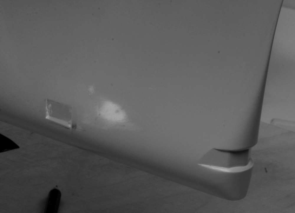

- NigelR32
- Posts: 305
- Joined: Sun Oct 30, 2005 12:27 pm
Bernd,

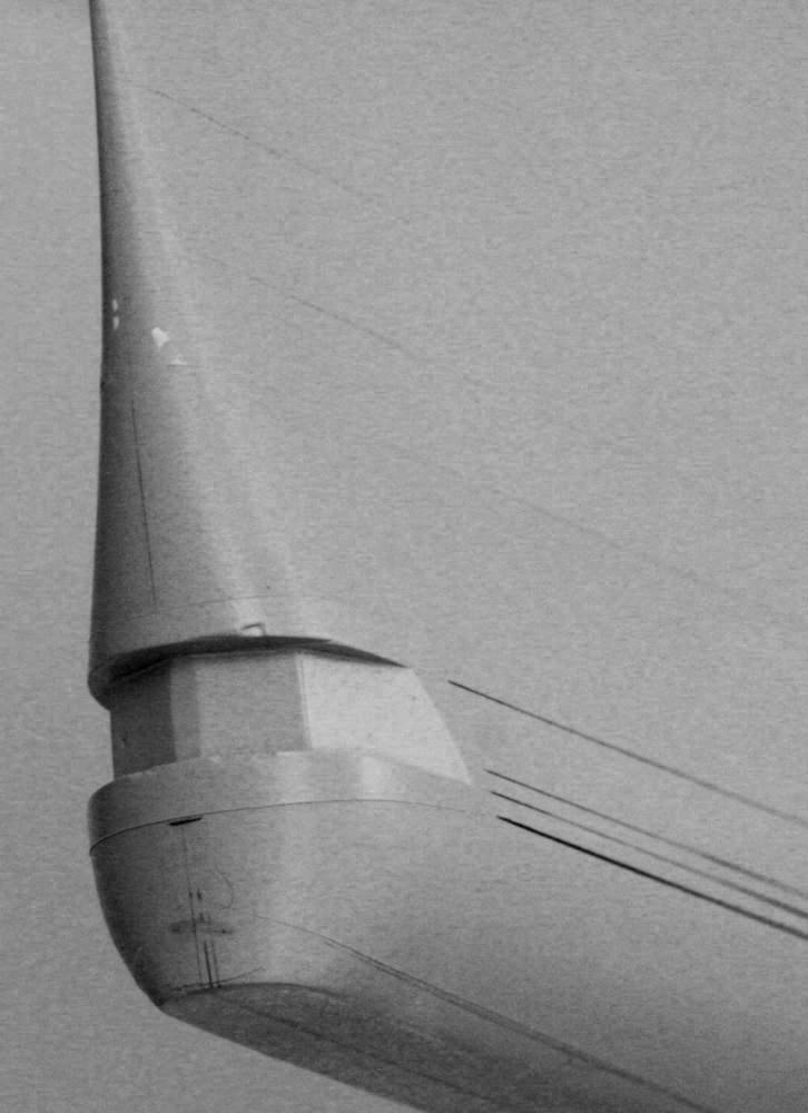

What is this active sonar all about?
I notice you have many grilles and vents in your hull below the Boot topping. Where did you gt the reference material from for this? I would like to add this detail to my Bismarck.

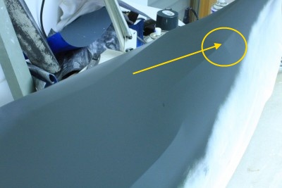

- 109
- Posts: 627
Some more work on the sonar ...
