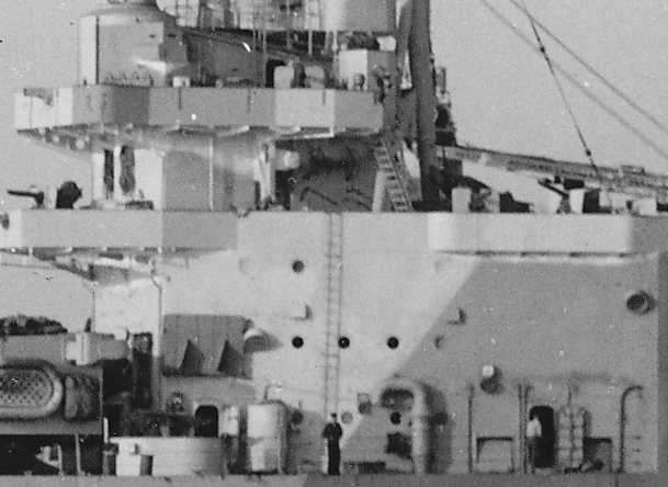

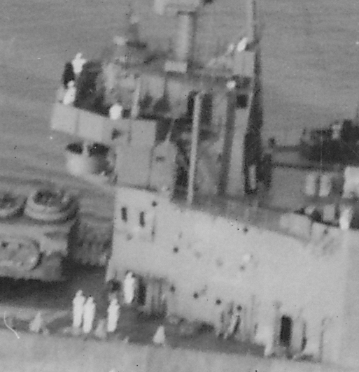

So, I have a little bit of a mystery; in the picture below, what is that attached to the aft starboard side of the superstructure? This is from Dec 42 upon her return from Guadalcanal.
Better pictures from her departure in May 42 seem to indicate this was on the port side as well, but apparently by the next pictures in Dec 42 after her return the port side was gone, you can see lighter paint hinting that the thing was removed.
So, any ideas? And, if you have any ideas, do you know of any better pictures, maybe from a sister that could aid in building a replica?
thanks
Bruce

bwross11 wrote:So, I have a little bit of a mystery; in the picture below, what is that attached to the aft starboard side of the superstructure? This is from Dec 42 upon her return from Guadalcanal.
thanks
Bruce
I sure don't know. They look like fins that you'd find in heat exchange designs, but no reason for cooling fins there. Perhaps they were a poor man's attempt to reduce air flow over the top of the aft main turret for some reason (i.e. they were wind baffles)? Maybe to improve conditions for an AA battery. Then they were later removed because they really didn't do a very good job of it? The angular superstructure shape aft of the hanger suggests air could wrap around the hanger and converge behind the aft bridge about where the aft turret is when the ship is moving.
Dave
Angeliccypher
Posts: 1381
Re: Calling all USS New Orleans class (CA) fans
Post by Angeliccypher »
Looking closely at the photo and realizing the angle it was taken at, could they be hinged panels of some kind that are sitting open?
Gabriel
Posts: 3881
Post by Rick E Davis »
I don't have a clue what this structure is, but I couldn't find it on any of her sisters.
Also, whatever it is, stayed with her through at least October 1944 on both portside and starboard side views. But, what is really interesting, is that it appears to be located at a lower height from the main deck by 1944!!!
Several sisters had Life Floats located in this general area, but among my limited number of SAN FRANCISCO views, she doesn't have floats there.
The views below date 4 December 1942 at Pearl Harbor, 9 November 1943 off Hawaii , and 13 October 1944 and 15 October 1944 ay MINY.
MatthewB
Posts: 2269
Post by MatthewB »
This is just a thought about those thingies on the side of the hangar on the SF (great, another thing to take into account on my re-build of that ship).
They look like sleds of some type to be pulled in the water, with the fins made to stabilize them.
Could they then be a part of the sleds used to recover the float-planes?
If you had one of those on the end of the netting, it would keep the netting flowing out directly behind it, and help keep the wake from flopping the netting about.
I have absolutely no idea about this, I am just shooting at the sky for possibilities.
MB

bwross11
Posts: 258
Joined: Tue Nov 01, 2005 8:19 am
Location: Medford, OR
Post by bwross11 »
MB,
That's what I thought at first as well. But, then thinking about it a couple of thoughts came up. I think that they are placed outside of the reach of the cranes. If they are made of some material substantial enough to be used in the sled job they'd be relatively heavy. That means, those things would have to be manhandled up and down by the crew; at sea that could be a challenge.
The problem with modeling them without more substantial pictures is that it appears that there may some shape to them other than just a flat sided shape. Since the model I'm working on is destined for museum display I need to either get the shape right, or just not include it.
Rick, once again, thanks for the pictures. Question for you sir; in your library of pictures of SF (understand it's limited) do you have any pictures that show the area immediately aft of the second stack? I know there was an incinerator in that area but don't know exactly what it looked like.
And the mystery goes on.......
thanks
Bruce

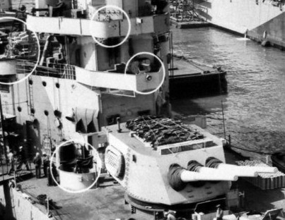

Dick J
Posts: 1992
Post by Dick J »
The area aft of the second stack did vary somewhat. The navy yard built ships were largely similar as built. (CA's 32, 34. 36 and 38) San Francisco differed from the other three mainly in the turrets and related armor thicknesses. But the four were otherwise similar. All but New Orleans had similar bridge mods and similar early war configs. Aft of the second stack, all four had a single rectangular "mushroom" vent that ran athwartships. The trash burner was a squarish box forward of the vent to starboard of centerline. The trash burner stack was the starboard pipe up the back side of the second stack.
Tuscaloosa had two square vents in this area that angled back and down. The trash burner was between the two vents adjacent to the port vent. The stack crossed centerline and was still the starboard pipe up the back of the second stack. Quincy and Vincennes also had two vents, but they were enclosed in a larger structure that extended more to starboard than to port. Their trash burners were forward of the port side vent and their trash burner stacks were the port side pipe up the back of their second stacks.
Of course, once war modifications set in, all bets were off for uniformity.
bwross11
Posts: 258
Post by bwross11 »
Dick good information, thanks.
Do you think that the basic shapes of the incinerator would have been fairly common, location withstanding? I knew that it vented up the starboard stack pipe, but I'm thinking that if I can find at least some representation of the basic shapes I can at least fill the space with some kind of representation.
Any thoughts on the mystery structures on the aft superstructure?
