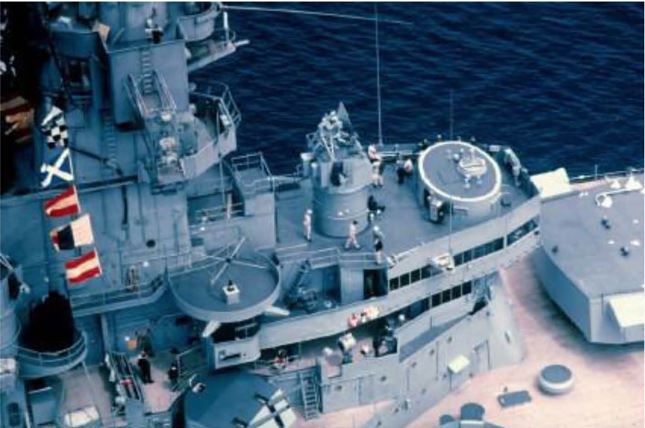

I'm sitting at my computer, whereas my B.O.G.P. (Bureau Of General Plans) or whatever they're called, are all rolled-up and downstairs for the moment. (we're still transitioning here from 'summer mode' with our boat on the water,,, to 'winterizing' which is retrieving said boat, winterizing it, and brining out the snow-blower) Then I can get back to modelling and such.
But (whatever the name is) that has all the windows (squared at the front) where I'm assuming a whack of officers hang-out, brag, and drink coffee. (The Bridge?) My point being, imagine standing at the starboard windows, looking across the room and out the port windows. Same/same for standing at the port windows, looking across the room and out the starboard windows.
Lastly, I'm assuming again that there is something somewhere around the 'middle' of that room, (playstation, game-boy, compass-rose, etc) that one would stand behind, looking forward out the windows towards wherever the bow of the ship were pointing.

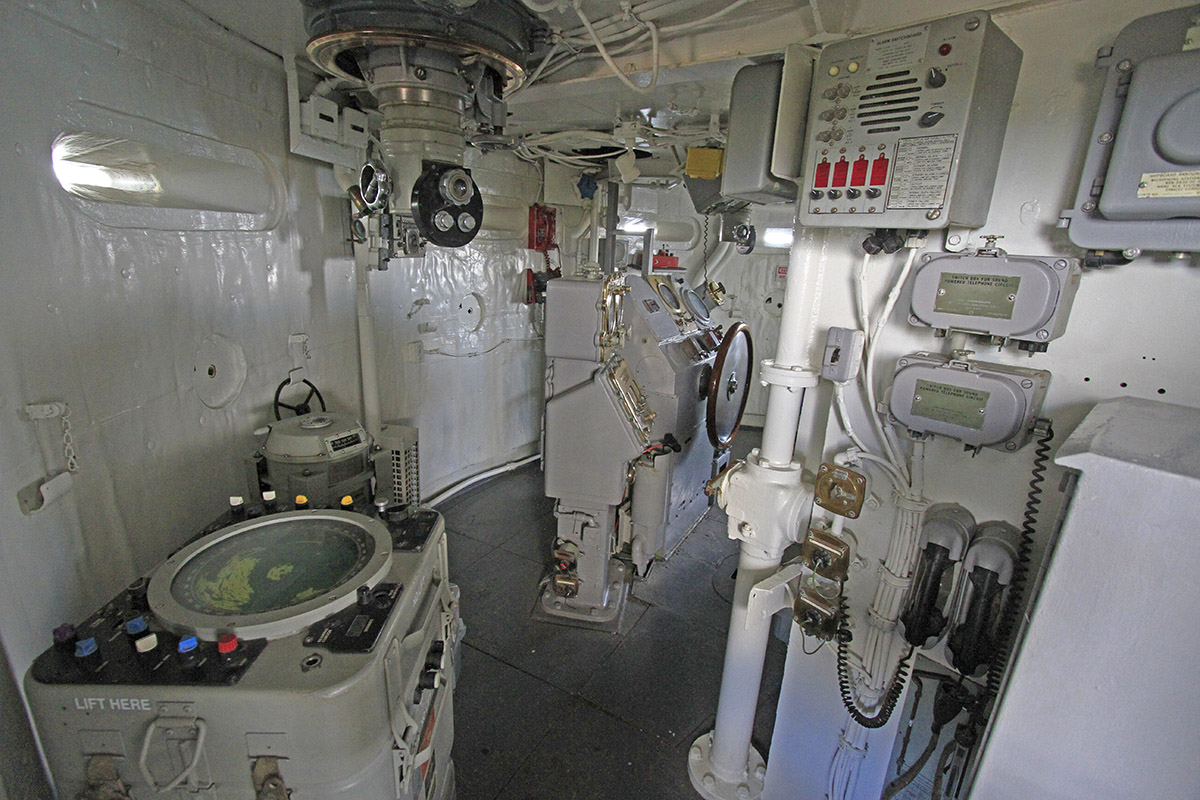

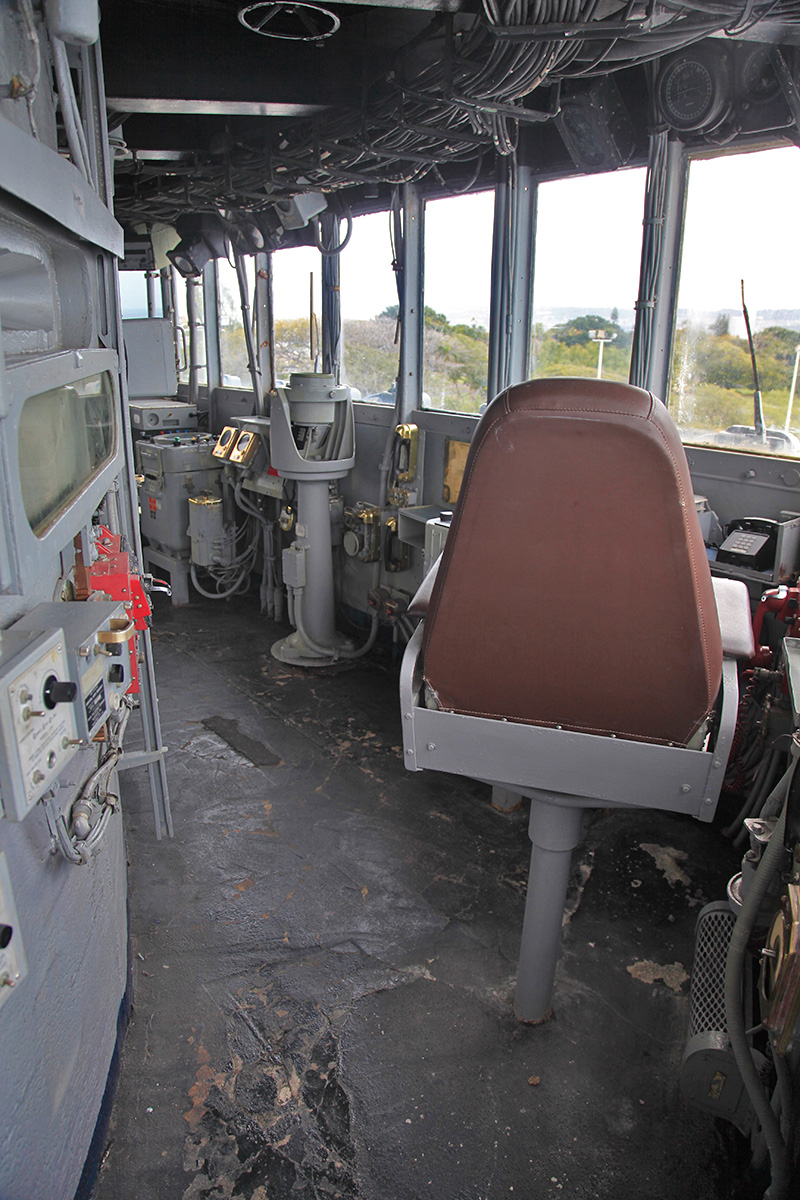

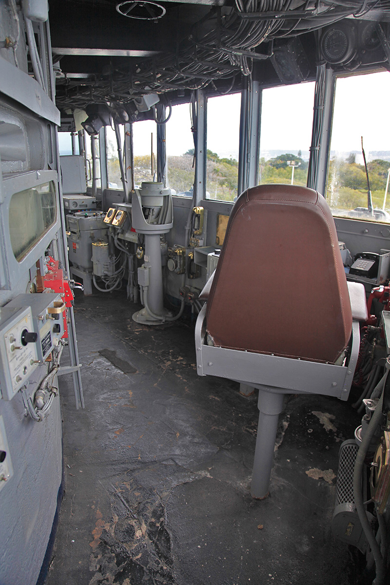

Starboard side of the bridge, Missouri: Note the the cramped space and on the left the slit in the coning tower and the cover which can be cranked up from inside.
Posts: 5068
Post by Fliger747 »

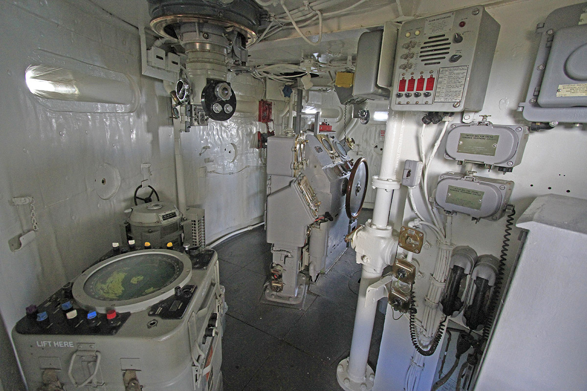

Helm inside the coning tower, Missouri, from port side.
Note the Radar repeater is probably not displaying anything in actuality and the handles for cranking up the view port covers have been removed.

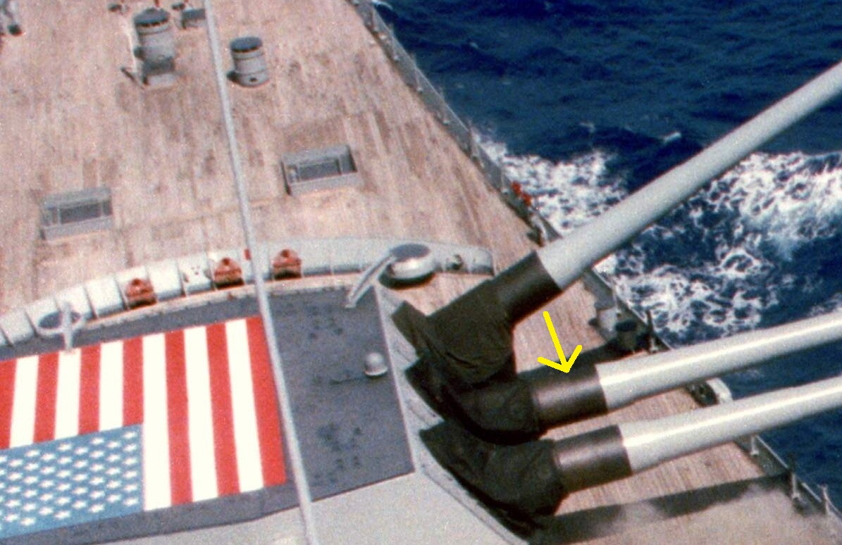

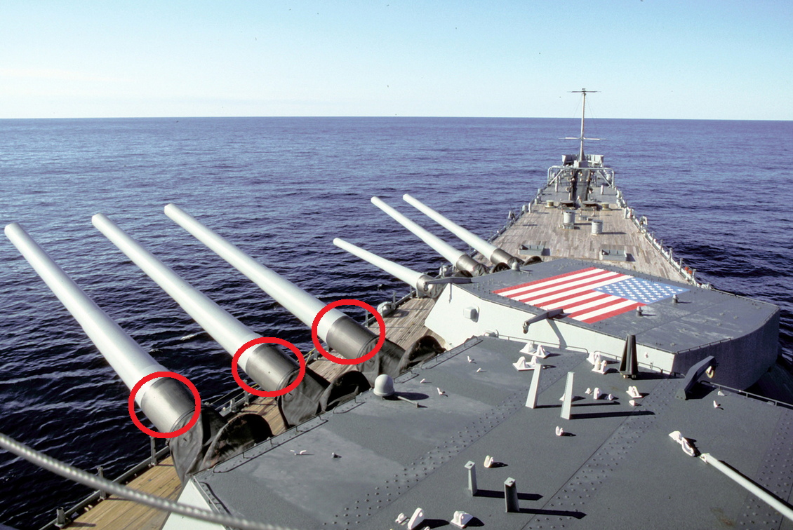

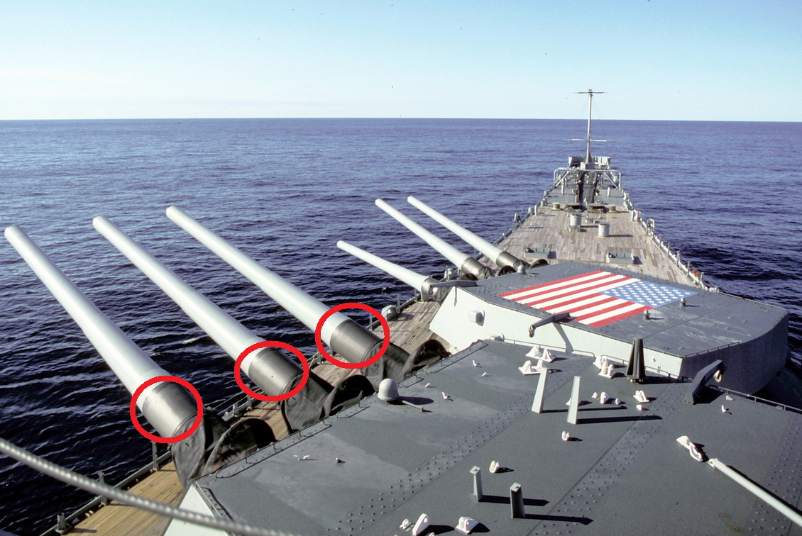

I'm trying to find a good color match for the circled/arrowed areas in the below pics.
I've been thinking of maybe Vallejo # 71.073 Metallic Black might work.
Or does anybody have a better suggestion? I only prefer to use Vallejo paints.

Not a lot of help, but somewhere in Picture post, someone had a nice build of the 1:200 Trumpy kit and explained how they did a very nice job on the barrels, I think there might have been some bronze or such slipped in there. The museum ships of which I have many photos are of no help here as they are merely painted black.
Good luck!

I point out that this darker area is paint, not metal.
Looking at the Vallejo color charts German Yellow is the closest IMHO.

Post by BB62vet »
EJM, et al....

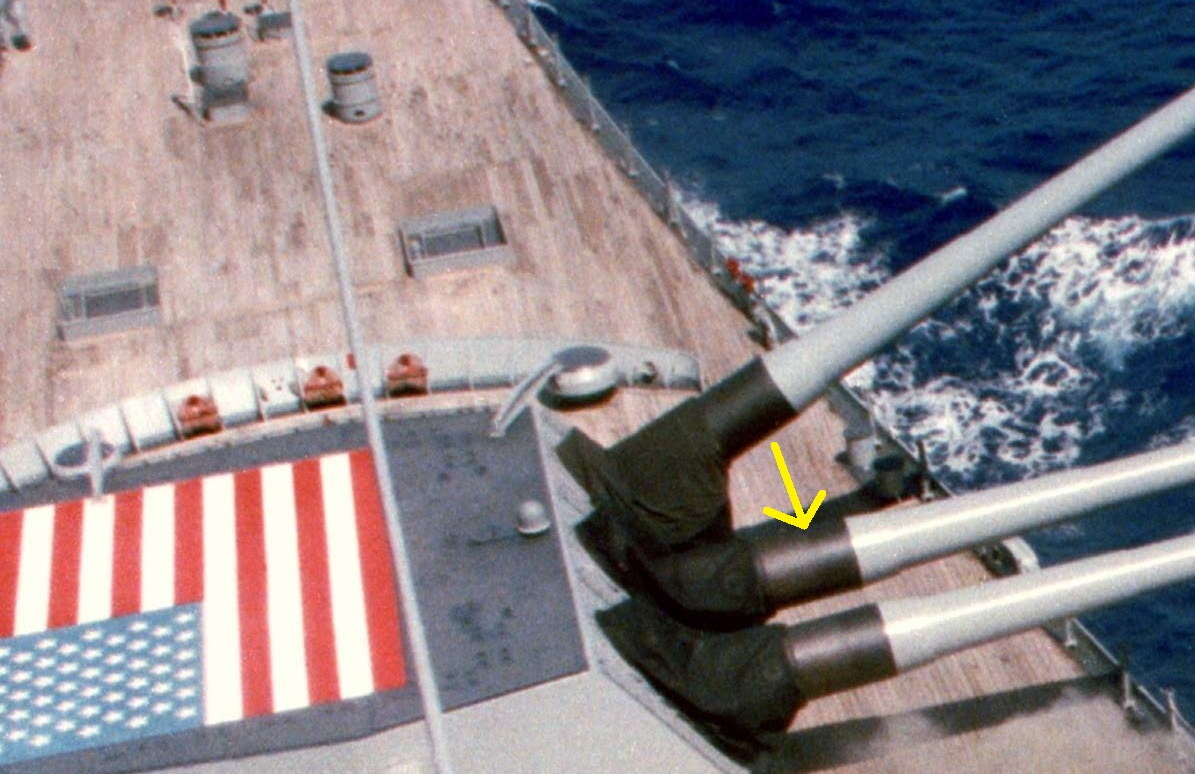

You're barking up the wrong (color) tree entirely!!! This area of the barrel was the "slide" area that is a NON-PAINTED, greased portion of the barrel. What you're attempting to do is show it painted which is incorrect!!! The museum ships all have this painted for preservation and do not display an accurate (operational) picture as Big Jim has pointed out. One other comment is that the pictures of IOWA that you show are during her firing training mission - the blowback from powder detonation always left the turrets/barrels/deck covered or coated with a dirty, oily residue that had to be cleaned up after securing from firing. This would tend to darken the brass on the barrel as shown in the photos you posted.

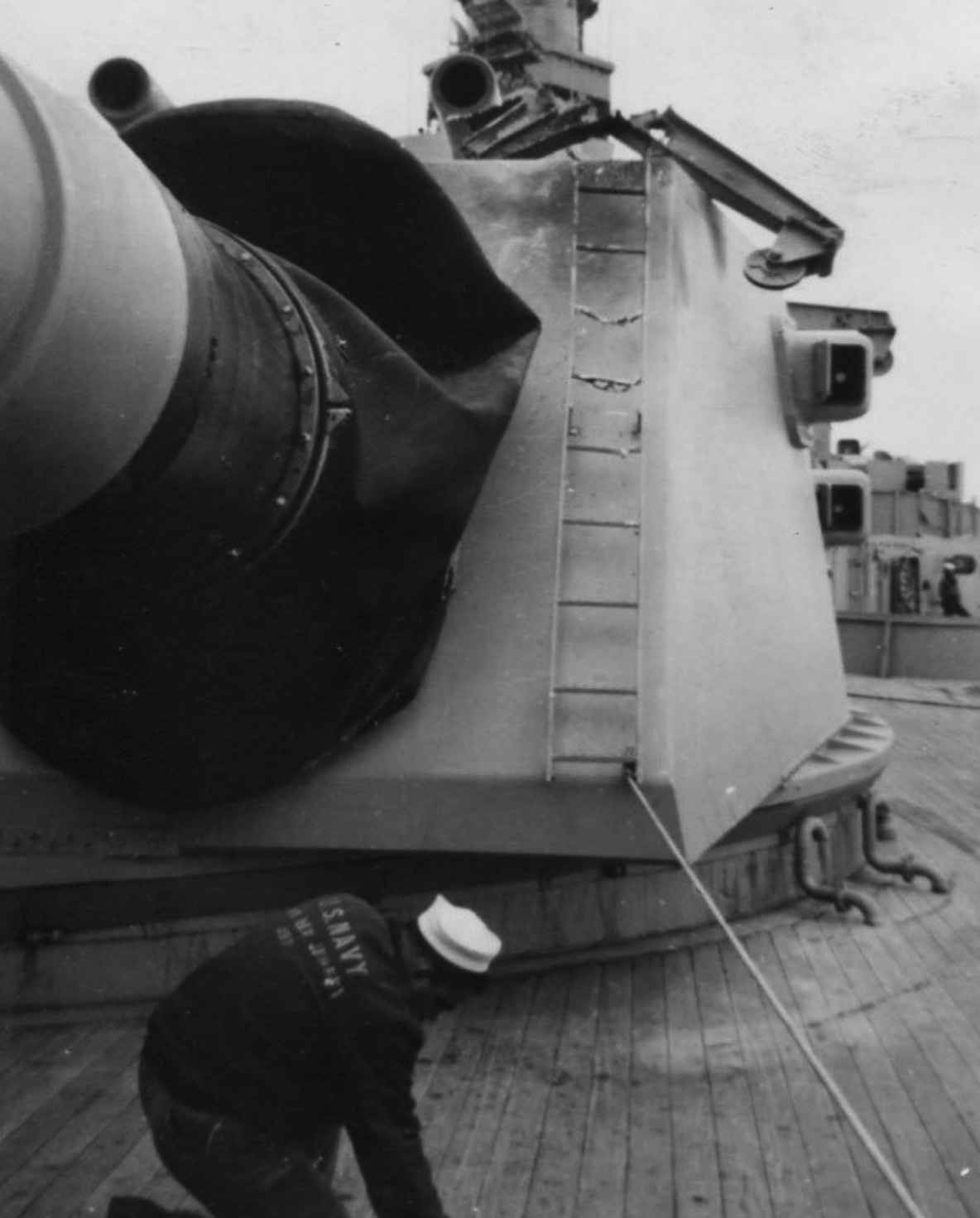

Here is a shot of BB62 in 1968 showing the right/center gun barrels of Turret 1 -
Clip of Turret 1 1968.JPG (18.72 KiB) Viewed 10758 times
This portion has only grease applied to the brass, no paint.

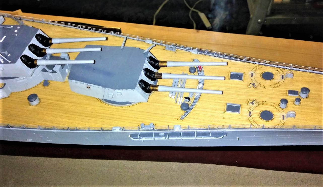

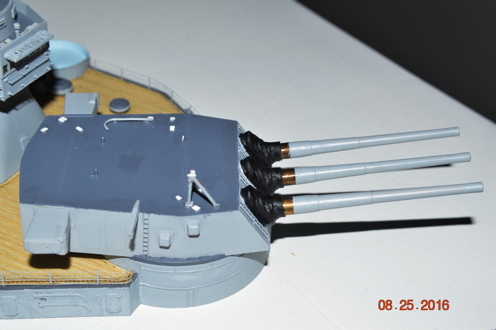

Here is how I represented it in my 1:200 scale BB-62 model -
I believe I used Testors Brass Enamel with a small amount of flat black added, I can't exactly recall. A "dirty" brass would be appropriate. As for how they maintained this during the 1980s, I can't say, but prior to that (WWII, Korea, Vietnam) what I've described would be appropriate.

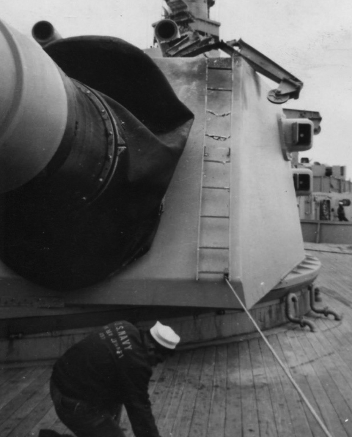

Posts: 5068
Post by Fliger747 »

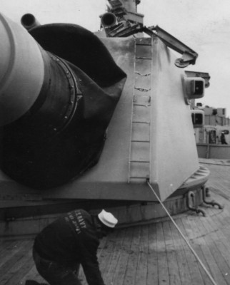

A closeup of the NJ recoil area of the barrels. One can discern that some material scrapes up at each end of the recoil area against the ring of the bloomer. I know Hank Strub has a color photo of these lubed up with a yellowish looking grease, maybe a little lighter than the bronze and rust red mix I use for props. Hopefully Hank will post this as it's the best photo I have seen of the color of this. Makes me want to go back and modify my Missouri and Alaska.
Regards: Tom

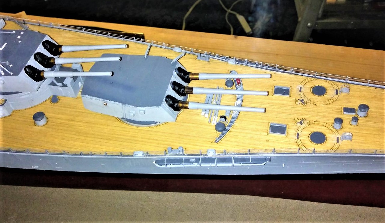

Not sure if this is the photo you mentioned, but it does show Turret's 1/2 and how I did the "slide" area of the gun barrels -
As you can see, I individually "toned" each barrel as they aren't all identical. I think Turret 1's center gun is probably the best of the 6 as far as accuracy goes. The "shiny" brass as shown in my earlier reply was probably after the barrels had been freshly polished and greased, not after months at sea and firing, etc.
Hope this helps,
