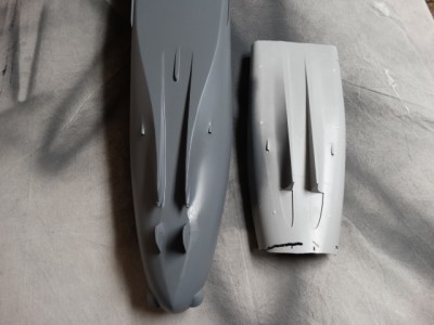

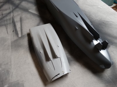

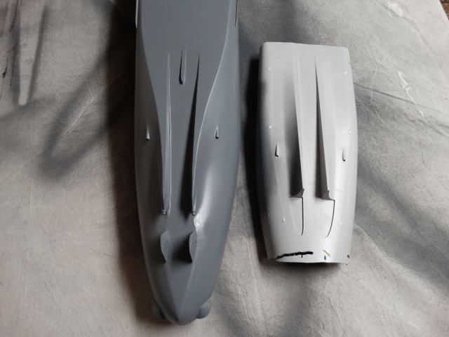

I do need that particular area on my barrels to be a slightly darkish color just like you see in the two original pics I used because I'm building and converting TAKOM's 1/72 scale USS Missouri 16" gun turret into the turret # 2 that was on the USS Iowa during the 1989 turret explosion. I'm trying to create a memorial build with my model.
- BB62vet
- Posts: 3174
- Location: Mocksville, NC
EJM -EJM wrote:@BB62vet:
Understood. However, if you look closely at your own photos, you will see that there's a reddish/copper hue to the "slide" area of IOWA's barrels - more than the fine speckled black that appears to me to be the powder soot or residue. Perhaps you might try taping off that area of the barrels (or find something else similar in color to use as a test) and spraying the reddish-copper first and then from a distance, spray the dark silver/black mixture to see if you can get a fine powdery coating w/o totally masking out the undercoat of red/copper. At least, some waste sprue from the kit (if there is any!) might be worth testing out on to see the results.
Hope this helps,

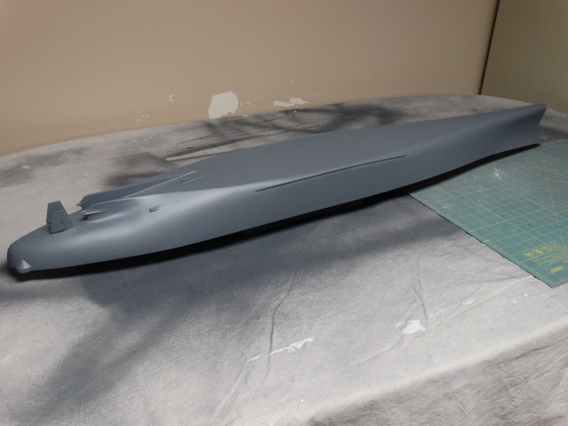

Hello:
I've been thinking about fixing the hull shape issue on my 1/200 Missouri model. I've heard of some others doing this, but I haven't been able to find any notes or a build log that shows how they did it. The two methods I'm thinking of using are A) heat and push or B) Cut vertical slits and try to bend the strips to the right profile.
Mike
Mike
- BB62vet
- Posts: 3174
Mike,mconnelley wrote:Hello:
Mike
I modified the 1/200 Trumpeter hull for making my USS NEW JERSEY (BB-62) model and have a build log on the Picture Post forum/Works in Progress, etc. - finished in 2019. My method was to fill the hull with Bondo and then grind out the hull using station lines and templates. Not an easy or usual process, but it accomplished the task fairly well.
I personally don't think either of your two methods would work and you would end up with a totally ruined hull - just my two centavos worth! There are a couple posted entries about others who have done this modification, you'll just have to spend time looking thru the build logs to find them. I believe Jason Channell did his hull by grinding off the areas of the hull and putting bulkheads in place that were then covered with thin styrene strips (basically, plank on bulkhead), and then covered with plastic filler and sanded smooth. He also has a build log on this.
Hope this helps,

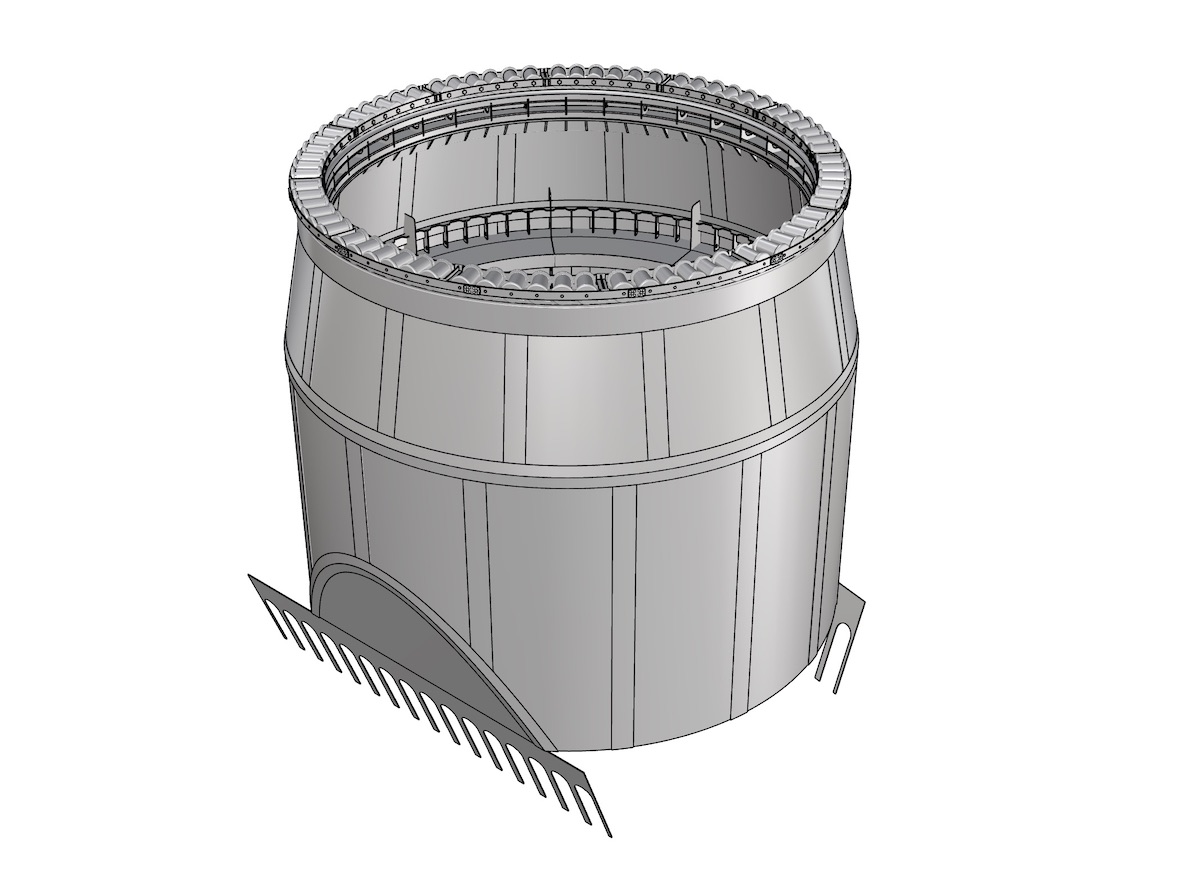

While I am pontificating, here is something I did last week. Turret No. 1 on Iowa/New Jersey. Note that this is quite different than what you may have seen in some references.
attachment=0]ViewCapture20221018_160339.jpg[/attachment]

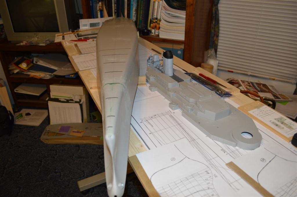

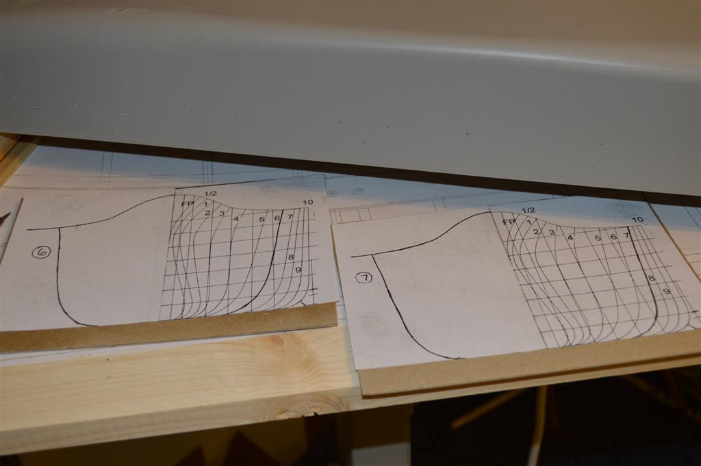

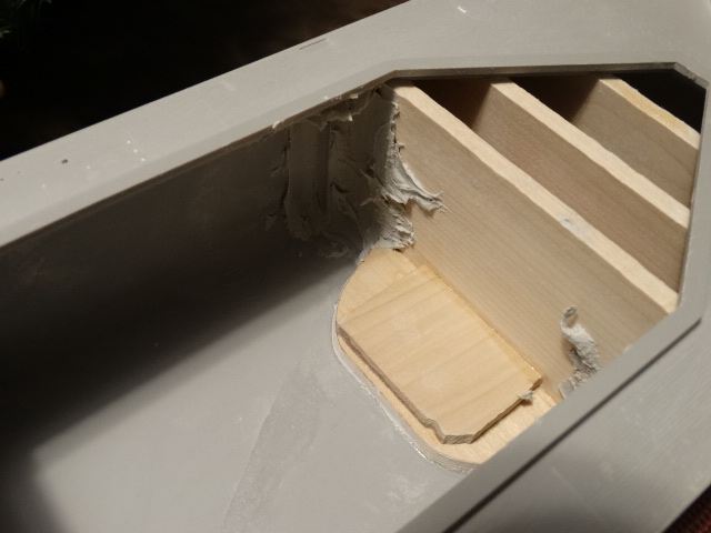

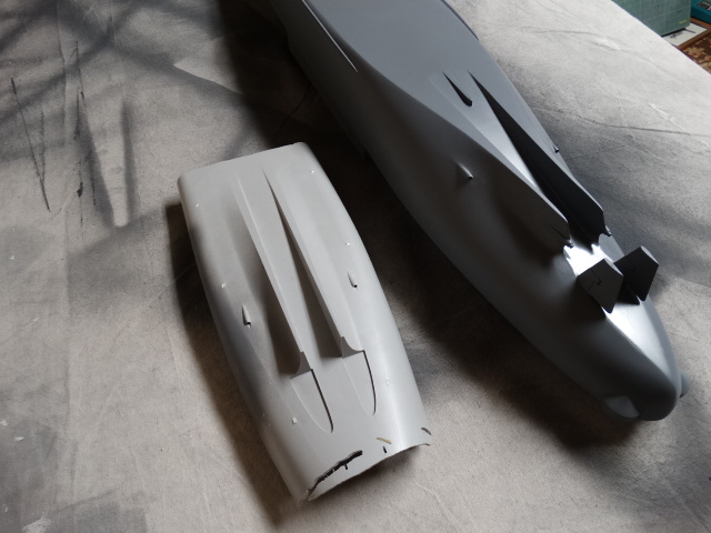

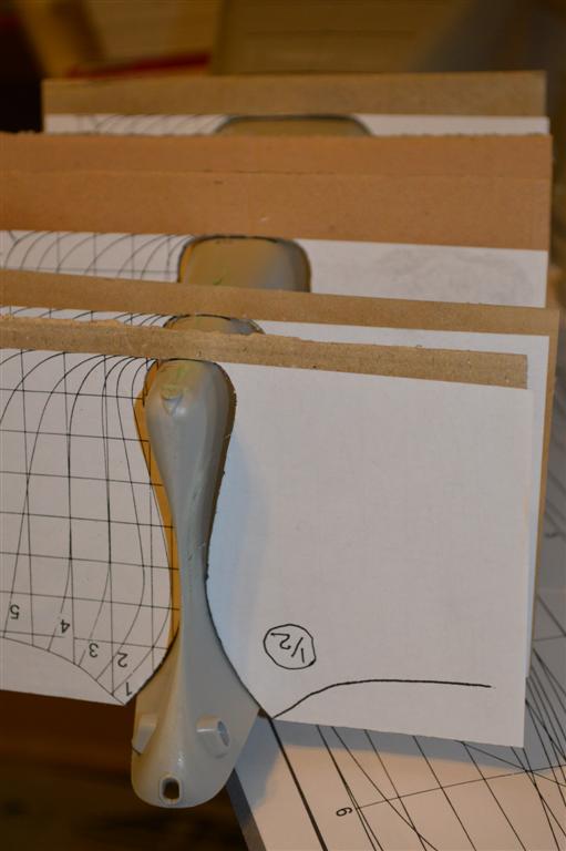

- BB62vet
- Posts: 3174

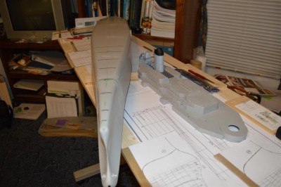

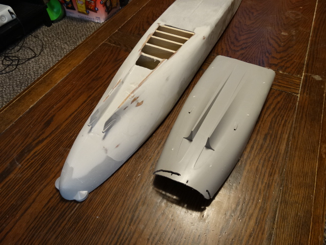

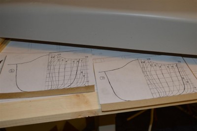

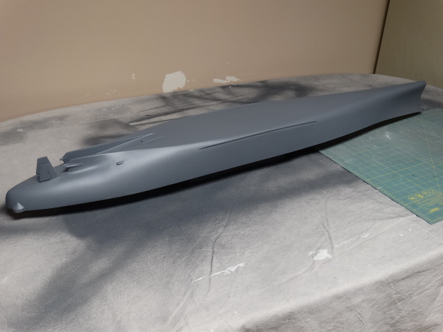

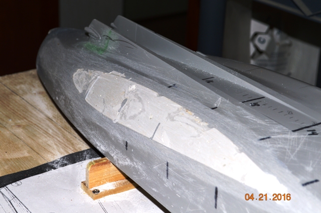

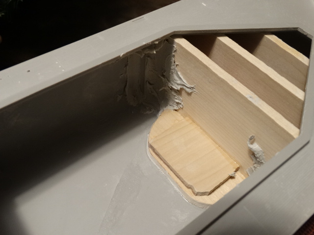

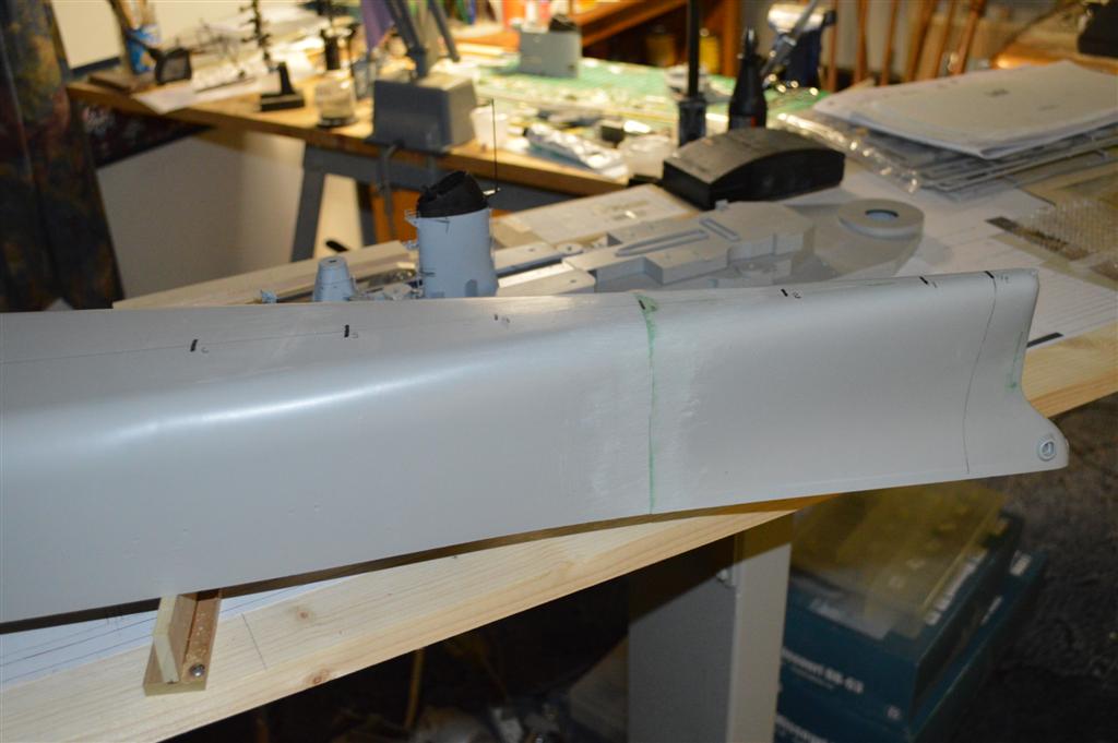

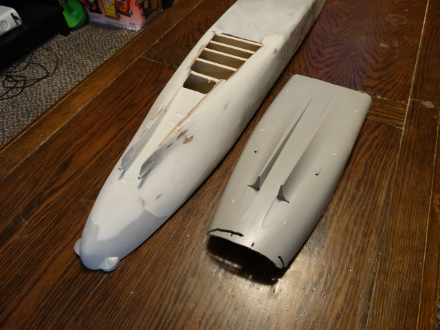

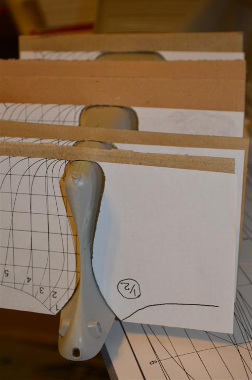

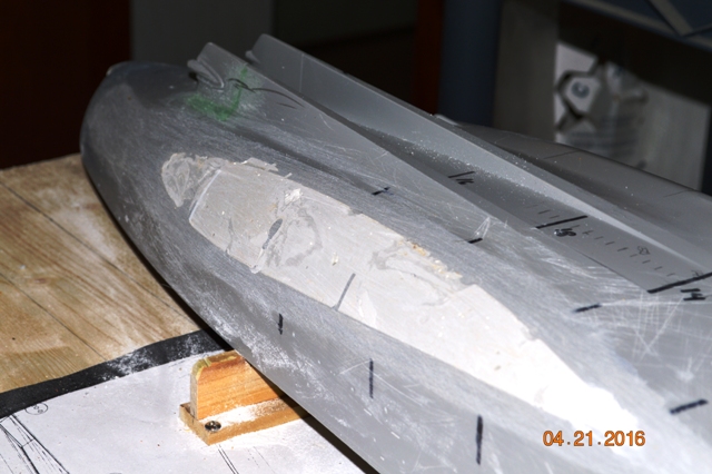

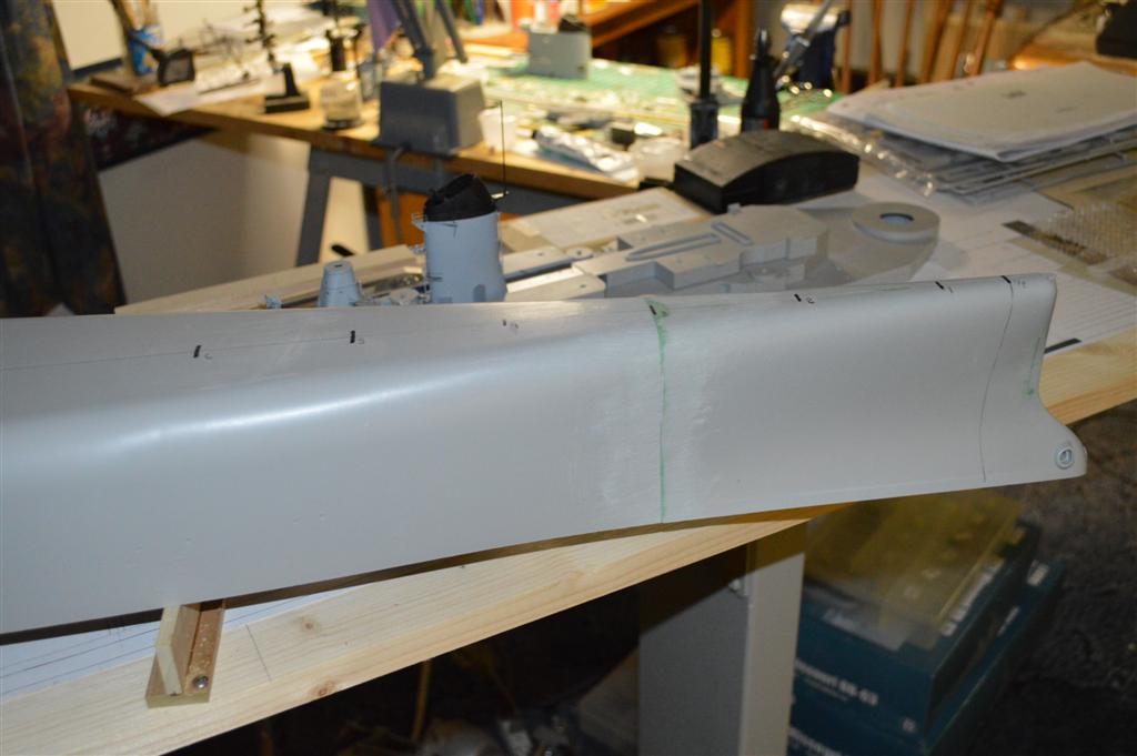

Timmy C - thanks for locating my build - I'm guessing at how this was filed (by creation date, which I had forgotten!). Anyhow, I'll bookmark it for future reference!
Mike - I also can't find a discussion of how I did my hull in the build log either; why - I can't explain now, perhaps I did...don't recall now. I know I had started a mini-topic on that topic that I had planned to post and never did. Anyhow, a bit of history on others who also have modified the 1/200 Trumpeter hull:
Jason Channell - used a plank on bulkhead type method for internal supports with styrene strips as replacement for his hull after cuttting out a section of the original hull - covered with putty and sanded smooth. Here are a few photos I saved from his method:
His internal bulkheads added inside the hull: And his finished hull:
One other member also did (what I would consider the BEST METHOD) a complete hull replacement of the last 19 inches of the hull - this was a 3D designed/printed replacement for the after part of the hull. He used a high-end 3D CAD program (Solidworks, I think but I could be wrong) to do the design and also created internal bulkheads within the hull for structural strength.
And, I did my hull totally different by filling the interior of the worst affected area of the hull (behind turret 3 back about 6-8 inches). I also rebuilt the forward lower hull to widen the bulb area which is also incorrect.
Bow area - I made section templates from the IOWA class body plan and then adhered them to cardboard. Here is a photo of them in place: The templates allow you to see how much new material you'll need to add to get this area to the proper shape & thickness. This was after I had mark the hull w/magic marker to location the section lines: I built up the forward section using styrene strips and putty and then sanded these down to shape. Not what I would term now a desirable method - due to my experimenting with liquid glue which didn't work well. If I were to do it over, I would use CA or styrene cement. Here is a shot of the forward hull with the station lines marked: As for the hull stern modifications, I also made templates for that area, as well: I marked off the hull where these templates would be located, and then knew how much of the hull would need to be ground down to the correct shape. Here are photos of the hull after the Bondo had hardened and I had ground off the excess hull plastic: I didn't attempt to alter the shaft alleys, simply tried to get the hull shaped closer to what was the actual contour of the hull. The application of the Bondo was a small nightmare as I wasn't aware that a 2-3 inch thick blob of that stuff would generate heat, but it did. Luckily, overnight it had cooled and begun to harden; I left it for several days before attempting to work on it. I didn't make any photos of the interior of the hull filled with Bondo, why - I don't know, I just didn't.
If I were to recommend a method to use, it would be probably something along the lines of what Jason Channell used as his method was a lot more logical in some respects, and certainly a bit easier in the long run. A complete replacement of the last 19 inches of the hull would be the answer, but unless you know 3D solid modeling or someone who does (and is into ship hull design) then that option may be moot.
I hope this helps; this is a BIG undertaking for anyone to accomplish!

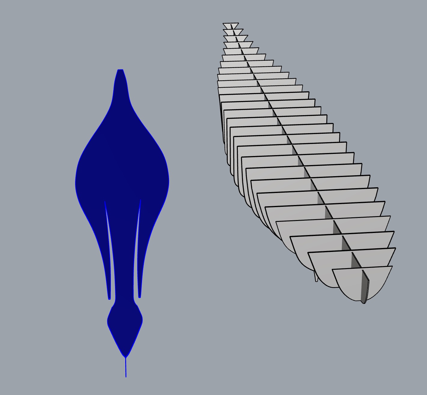

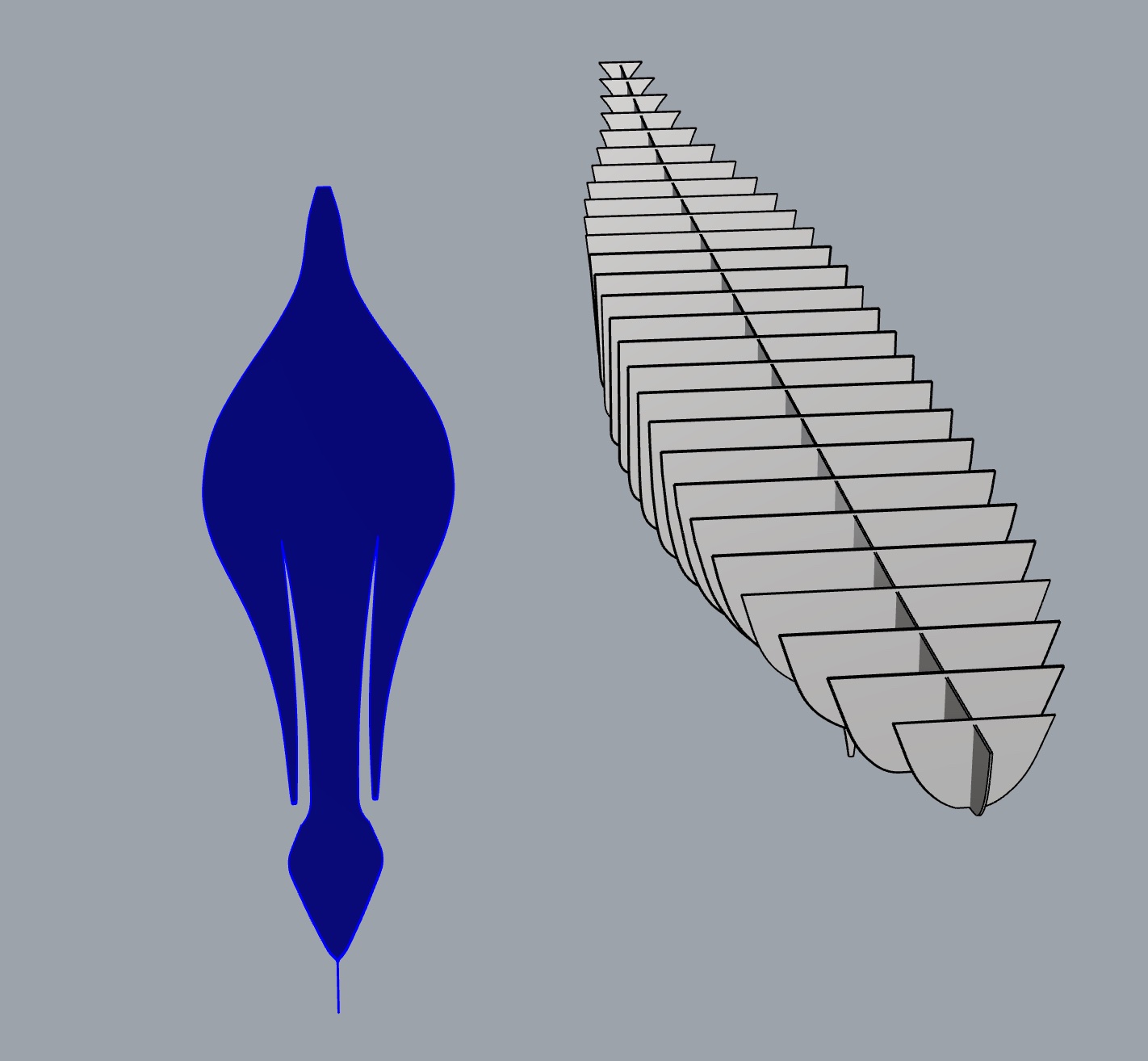

I was playing around with my 3D models. I wonder if this might be the approach for building a correct hull. Working at 1:192 scale, I imagine 0.04-inch styrene being laser cut. The blue is the half siding that runs along the bottom. I have 27 frames on a keel shown here at my infant state (about every 2-inches).
I imagine some longititudinals and stringers added for thickness and building assistance.
The frames are offset 0.04-inches for "planking." Two layers of 0.02-inch or one layer of 0.04"
I imagine a 3D printed bow, stern tubes, stern bolster, docking keel, and shaft bossing on the twin keels.
It could possibly be cut out of brass sheet as well.
- Posts: 5068
I built my 1:192 Alaska using a somewhat similar method with success, however it's a waterline model and is attached to a base board. I also added rigidity by adding non expanding foam. However in general thin styrene lacks rigidity and plywood is a much more satisfactory material. We subject our models to types of forces that a real ship would never survive, just think of model wise how gentle of a kissing of two ships in a real collision causes severe damage.
I had considered how fun it would be to build a ship with an accurate interior, ini my case via 3 D printing. The bridge area of the ARL 12 USS Poseidon I built had proper bulkheads and some interior equipment in the navigators and radio rooms.
Such construction from styrene would be quite an innovation and it might or might not work. You have accumulated as much information as anyone, critical to implantation of such a project. Certainly a challenge, which in it's own way speaks well for such an attempted construction!
That's how progress is made! Good luck!
