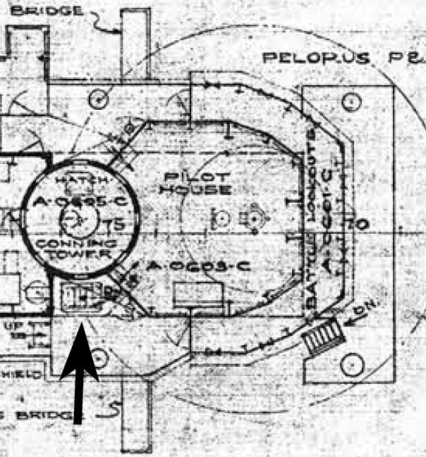

Looking at the General Plans for Yorktown 1940, I see what looks to be a deck hatch behind the starboard pilot house door leading downward. Am I reading this correctly or is it something else as I don't see it shown on any of the other pages of the plans related to that specific area?
Any ideas?

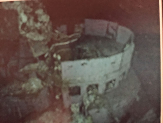

I was going back through the Ballard expedition photos the other day and ran across this pic of the top of the pilot house which shows the sky lookout stations/shielding. You can also see the access ways to both structures. It wasn't until the picture of this area came out in Steve Wiper's new Yorktown book that I had ever noticed them.

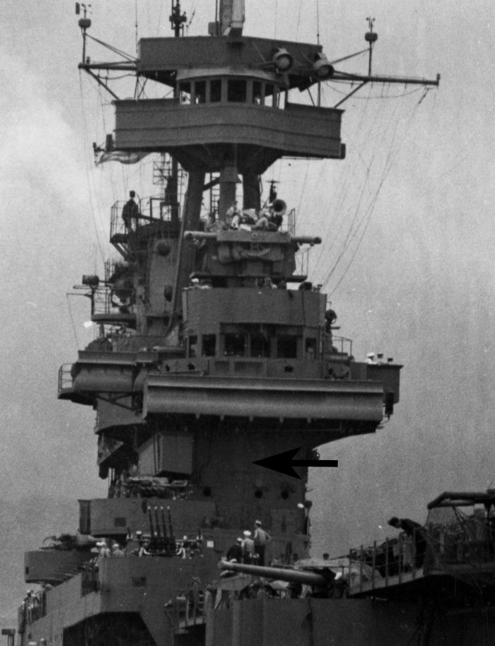

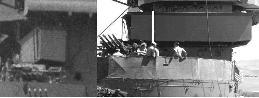

Don't think this has been mentioned in the thread before: In the pic of Yorktown in PH drydock just prior to Midway, I've never understood why the bottom of front of the starboard platform looked like it was tilted downward towards port. Comparing it against the ENT platform, and drawing a line at the point where Yorktown's platform was cut off to make arrangements for the large bridge platform, I can see that the bottom angle is actually part of the bottom bracing that you see on the ENT on both starboard/port sides. This seems to confirm to me that the Yorktown's and Enterprises platforms were identical prior to Yorktown having a portion of hers cut off.
