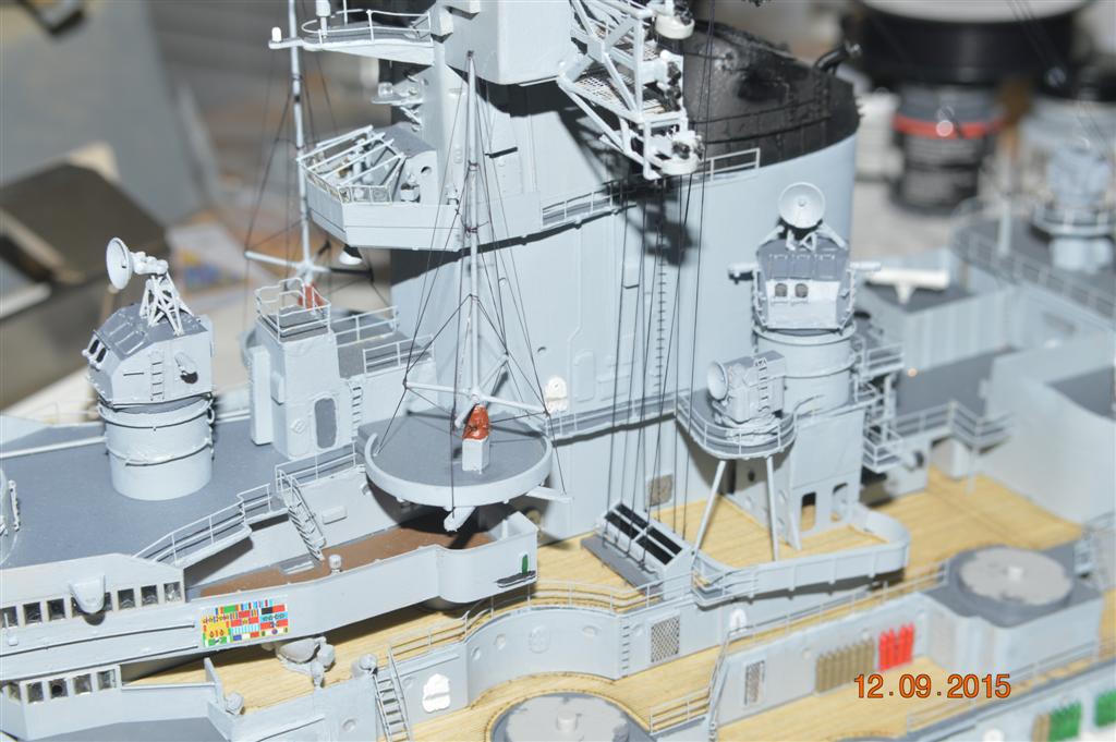

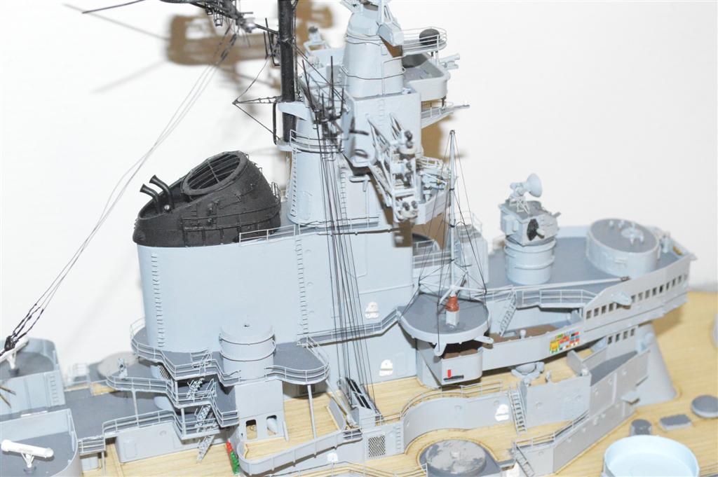

All Mk. 37 FC Directors complete and in place (not glued, yet!):
Model Monkey did a really good design job on the Mk. 25 Radar assemblies - I think this really adds to the overall correct equipment appearance of the model.
Hopefully, tonight I will begin to mark up the hull for modification work to begin. Setting aside the superstructure for a while to concentrate on the hull.

Hello Hank:
Looking good. The Model Monkey parts look great. I am really pleased with what I have received from him.
Mark

Hank:

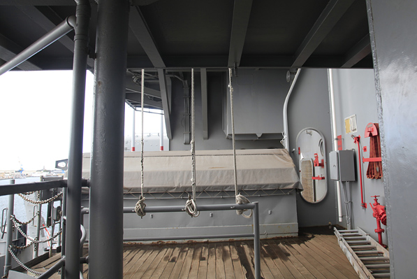

Look really nice! Rigging of the antennas quite amazing. One question, did NJ have the brace onthe Fire control tower base between the flag bag and the tower, with the oval step through, like the one on Missouri?
Cheers. Tom

Post by Channell »
Very nice Hank! I'm interested to see your hull mods too, hope they go smoothly! :wave_1:

Tom - not sure what you are referring to (did NJ have the brace on the Fire control tower base between the flag bag and the tower, with the oval step through, like the one on Missouri?
Yes - if the angled gussets on either side of the bulkhead at deck level are what you are asking about:
Stbd FC Directors.jpg (72.1 KiB) Viewed 1708 times
Those are something I did put on the model, but only the fwd one on each side, as I have one detail that is not correct - the solid railing around the director base on the 03 Nav. Level should be 3 bar opening railing. If I had done the properly, the after angled gusset would have been put in place.
As it is, the is one of two things that are not completely correct for the time period.

Have some photos of what I am talking about and will post.
Tom
This is the brace I am referring to.

Tom,
No, I don't think that support gusset was left after her 1967-68 refit. I'm not positive, but will look thru my cruise books next week; that is a very obscure area that does not get photographed very often and is not in most of the known photos of the ship.

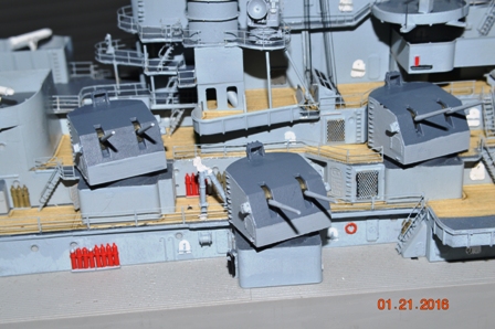

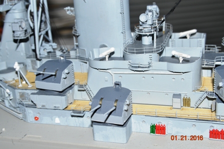

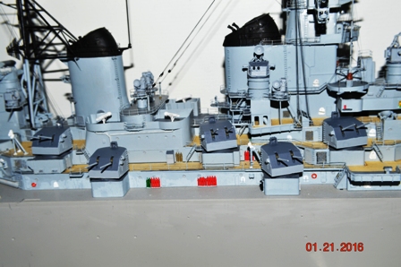

Using the Model Monkey (Shapeways) 5" dual gun mounts rather than the kit mounts (not correctly shaped), I have 5 completed and set in place:
To be honest, drilling and placing all the hand rungs was a very long and tedious process. I'm not looking forward to the other 5 mounts, but I do have a method that works - one at a time, start to finish - painting and all.
So, small steps = closer to finishing.

Post by Fliger747 »
Hank:
Looks great, yes imaginably tedious! Going with installed mount blast hoods under the bridge wings?
Yes these deals are often a step forward and one or two backwards sometimes!
Cheers; Tom
Thanks, Tom! - well, I mentioned they were set (not glued) in place and whether I leave the blast hoods on those two mounts is debatable - I am leaning on removal. I may have to trim back some of the railings in order to position the mounts in a more suitable display.

Post by Mgunns »
They look great Hank: I see what you mean about the individually installed ladder rungs. Yes, I can imagine the tedium in that. But; you are halfway done now. :cool_2:

Post by BB62vet »
Thanks, Mark! Yea, halfway there. One thing I've found out - even the acrylic paint doesn't really adhere well to the Shapeways plastic. Two coats are a MUST - I do like the acrylics from the drying time standpoint, unlike the enamels.
