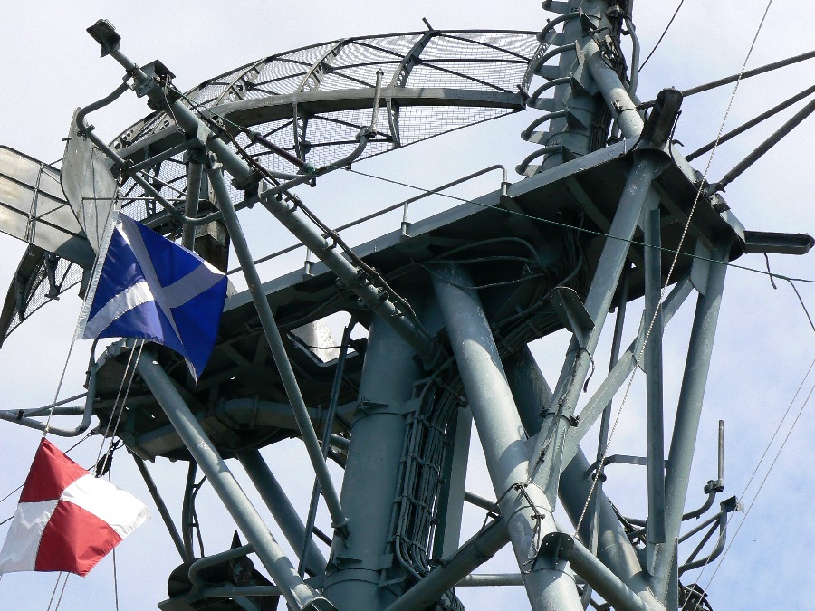

I have devoted lots of time to the two radar aerials, with less-than-promising results as for now, and at this 1/144 scale, PE seems to not even exist. Too bad.
The second thing to be solved is the wiring up the mast. It is complicated, to say the least. Lots of time were devoted to this subject too, and it was not until a short time ago that I found what I think that can be if the solution, at least something that can be tested.

After this, the mast. This pic is an example of what has to be done. Lots of small elements, interfering with each other everywhere, what means that every step has to be carefully calculated:
I decided that the elements have to be built from the inside to the outside, leaving the bigger elements as the last step, and always leaving some room for the secondary wiring lines. The first thing were then the brackets that seem to support the brunt of the weight of the wiring lines. In my files, I could find 14 of these brackets, most of the placed at uneven distances:
This is USS Isherwood, but after everything I have reseached, this mast is representative of any square-bridged Fletcher. From the flying bridge downwards there are some more. I made four, the last one being necessary to secure the lower section of the wiring, but only three of the will be visible in my model, as the rest of them would be covered by the deck of the commodore cabin the this ship displayed.
As it can be observed, the brackets are made fast on the sides. I made the circles with 4.0 mm Evergreen tubing, filed and sanded inside and outside to acceptable calibers, cut in the rear to allow the correct placing, and completed with scraps of stretched sprue. In this case, I had to trade reality against realism, beause I was not able to handle smaller pieces. This is the main mast as for now :
I know they are a bit too thick, but I think this problem can be covered to some extent by not giving them any kind of shading when they are painted, and only some dry-brush lights, so that they are apparent but without highlighting their true thickness.

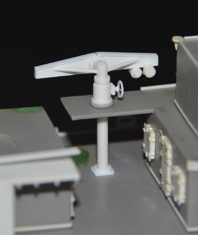

The next step, the torpedo crane, was again a passtime in between I decide on the main mast.
This torpedo crane was quite distinctive in the Fletcher�s silhouette:
It was present in Jorge Juan as well, as it can be seen in this otherwise blurry picture :
After the many pictures I have found of this crane, I could see that there are many different models, or variations, of the same elements, but this one seems to be the most universal, but again with the handle at front or at the side of the main support:
On the other hand, the head of the crane seems to follow the same pattern in all cases, with the same elements in the same position:
The kit offers a crane, but very crude for this scale.
The measures are basically right, and I considered recovering the cross, but I decided that it would take as much time --if not more-- as building a new one, that was what I eventually made. The base is a piece of 2.5 mm. Evergreen rod, with all the rest of the elements built accordingly to this size
When set in place, the mount is quite convincing, and it will be more when it is painted, dry-brushed and finished with a piece of chain hanging. I could not find a clear picture of the base on deck, so I imagined one, and made the body of the crane longer than necessary so that it can be hoisted if desired

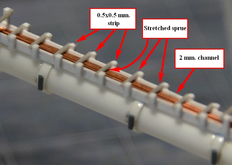

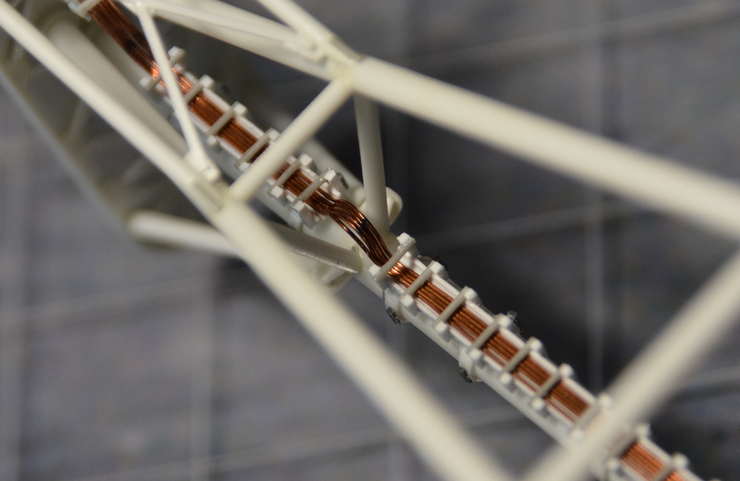

The next step, the wiring, was not that easy at all. First, what had to be done is 4 sections of brackets, at an uneven spacing, and lots of wiring in the racks. After some research, I could not find a complete picture of the rear of the main mast of a modernized Fletcher (to say nothing of Jorge Juan herself), and even in sections, I found out that not all the ships had --as usual-- the same arrangements, but I could more or less stablish that most of the ships had similar numbers of brackets in similar sections, so as representative of the class I was using the mast of USS The Sullivans, of which I have excellent pictures.
At first I tried to replicate the racks in the aft stack, and made all the pieces accordingly, using 2.00x0.5 mm. Evergreen strip,with sections of 0.5x0.25 mm. Evergreen as well. It had worked well on the stack, but (I noticed it too late), because it had required no handling at all and I was using small sections of stretched sprue for the wiring itself. It was not the case here: I had to handle it continuously, using copper wire for the wiring, because the stretched sprue broke easily with so much handling and bending at odd angles. I also discovered at my own expense that the copper wire has a life of itself and takes its own decisions, that in even in small bundles can coincide or not with my own decisions.
All this together along with the amount of glue that I had to use made the vertical strips too soft, and eventually they bent and broke. A full three-day work directly to the bin...
I had to start everything again, this time trying to make the thing a bit more solid, using 2.mm Evergreen channel and 0.5x0.5 mm. strip instead. The only drawback is that the channel limits the number of wires to only 5 instead of the 7 that I was using before, but it was now way stronger, and I thought it could cope with the unavoidable handling. It did..
The trickiest thing was to comb the copper wire in the right places at the right angles to form the three waves that are so typical of these masts, and all of them at the same time, the only possible way that I found to have all of them identical. I did the job using a 3.2 mm. tubing section bent under the pressure of two 2.00 mm. rod sections. I made a couple of tests before, and apparently it worked.
I made the middle wave first, and then the third and then the first, because the middle can be done stretching the wires un and down, but the other two have to be made with only a two mm. margin. I said apparently, because this time the copper wires got really temperamental and all the three curves seemed to agree on bending together to almost 30� to the right. It cost me blood to take them to the right position, but more or less I think I got it.
After this I simply had to add stretched sprue sections to the sides of the racks, this time a bit thinner to compensate the thickness of the 0.5 mm. bars.
I had to accept some compromise in the relative thickness of the elements, but I broke nothing, all the elements are there, the racks are not thicker than the mast itself (my fear nr. one) and I have to add the vertical ladder, many smaller elements and all the rigging and halyards yet, so I think the final effect will be good all the same.

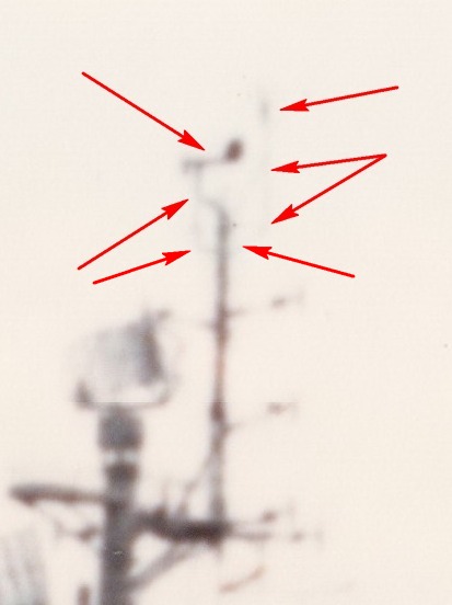

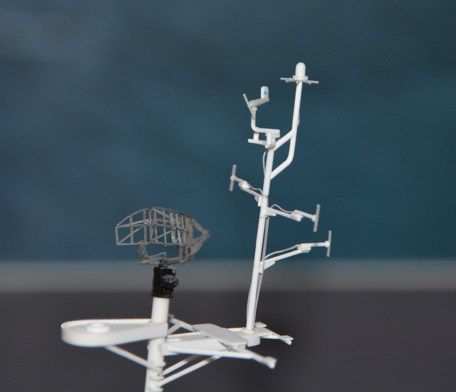

Even if there were the usual variations in the location of the different elements, the Fletcher class had a common equipment reg. the topgallant masts, and USS McGowan had the most usual location of aerials, this one, in 1956, short time before the transfer to the Spanish Navy, and one that she kept for some years:
The wiring was attached to the masts following also a common pattern, with beautiful curves that were IMO as specifically designed for modelling:
On the other hand, Jorge Juan had an further upper topgallant added AFAIK in the mid 60�s, the moment in which I try to represent her (no other reason than I was born in 1964). Sadly, there is (or I have not been able to find it at least) absolutely no clear picture of this part in both Jorge Juan and sister ship Alcal� Galiano. I have been able to find only these two crops :
One of the elements is clearly an anemometer, very easy to carve in a piece of sprue. The other elements seem to be the AS-390/SRC aerial, two supports for the topgallant mast placed in a 45� angle, and apparently a small rounded platform for two more aerials (?) just under the anemometer.
I am not completely sure that all this is 100% true but I have found no better source, so this will have to do. Making it all was much easier than finding the information.
I think it is quite consistent with the pictures, and in any case it is not unrealistic, and it is enough.

When set in place there are no gaps in the sections, it is parallel to the mast, it has the correct angle to follow the inclination of the platform, it is correctly aligned with the axis, and this is everything I wanted to see.
After this, I finished the small details with stretched sprue again and scraps of 0.4x0.75 mm. Evergreen stripe, added another trunk using 0.5x0.5 mm. Evergereen bar, and the thing was done.
When placed on deck, the effect is quite convincing:
