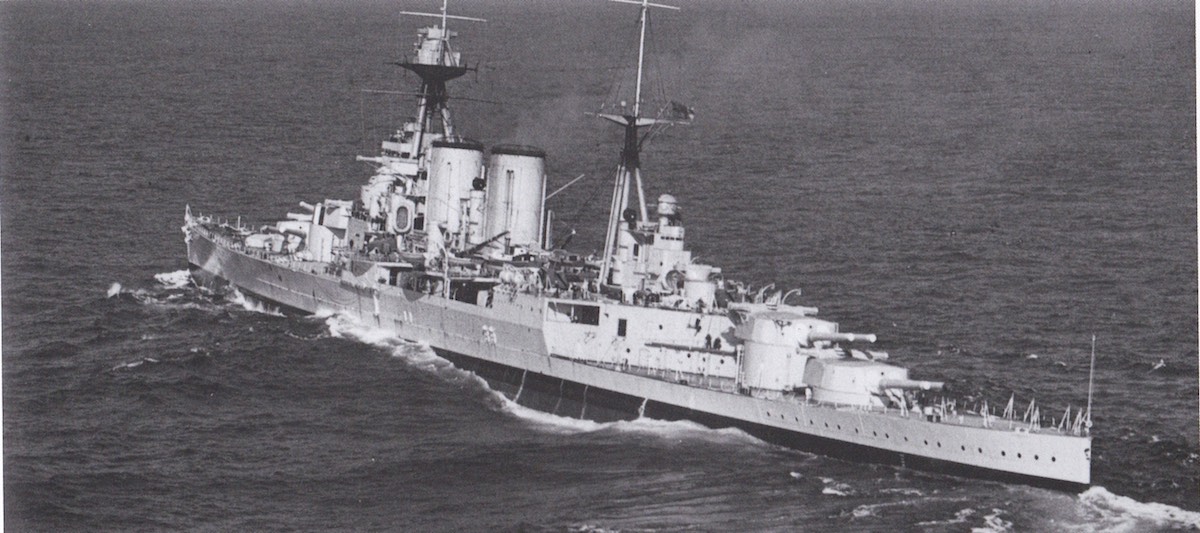

Found something in RA Burt... British Battleships 1919-1945
This is a little earlier than the period we are all modelling, but I doubt the bottom line of the boot topping would change.
I have a larger scan if you would like it emailed, but here is a 1200 wide version:
I hope there is enough contrast on your screen to see the point at which the boot topping tops and the hull 'red' starts...

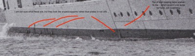

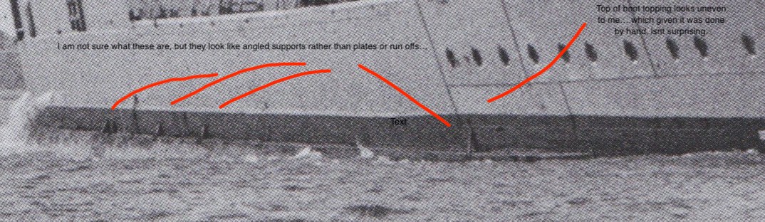

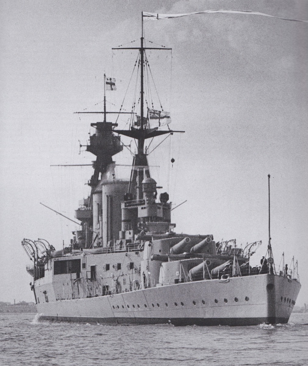

While I was looking through some other photos I found this... Its listed as of an earlier period, Jan 16 1936. As you can see, anchor removed, no degaussing cable and no sign of the platform on X Turret. But what are those angles supports within the boot topping seemingly linking the hull plating to the anti-torpedo bulge? I have never seen these on any full hull Hood model before...
Here is a close up...
And an even tighter crop. I cant do much better than this is it is hitting the resolution of the photo in the book...
tight crop on support.jpg (16.91 KiB) Viewed 2754 times
But there certainly appears to be indicating this is a stand off of some sort, not a solid plate... so small outflow pipes? You can see main outflows above the boot topping in the first photo, there is water coming out of them!
I just found this quite interesting and would be a very interesting additional detail on a full hull Hood... mainly because I have never seen them on one before...

Interesting Bill...I agree about the bottom of the booting not changing, that was my thoughts too, yes she got heavier but it wasn't that much percentage wise, changing the booting completly wouldn't make sense in my mind, adding a little to the top to compensate does. Those brackets are a mystery to me, they seem clear enough with hints of in other photos too although difficult to tell. The Armour belt was bolted from behind so nothing to do with that, they seem to go from the 12" armour down to the anti torpedo bulge, no real sign of any towards the front of the ship. Hood was for her time a very advanced ship, better protected than the QE class BB's in all but deck having an inch less side armour but angled which gives her more. She also had the hollow steel tubes packed in her bulge to reduce blast pressure from a torpedo hit and aid in buoyancy. She was an impressive ship and fast too.....she just needed a couple more inches of deck armour...:)

I've been digging a little deeper Bill...still no closer to what these are or for how long they were on the ship but one thing that I have noted is that in the sequence of photo's taken during her build the bulge top plates were left off during her launch and remained so for many months after. She was launched with nothing on her decks bar the barbettes, the bulge top plates were still missing after her funnels and bridge superstructure had been built which I would assume took some time. Perhaps the new 'hollow tubes (crushed tubes) weren't ready to be filled into this space till much later after her launch? The straps that you have noticed going from the armour belt to the top of the bulges would have been attached after the bulges had been filled with said tubes and the top plates had been fitted to cover them over and made watertight, in fact I believe they were 'airtight' as this was part of the protection system designed into the bulges.
All very intriguing....:)

That photo was dated much later than her launch... around Jan 1936 if the Burt book has captioned the photo correctly.
There could be a cover plate fitted over... B15 on page 60 in AOTS shows some brackets supporting the plate over the crushing tubes... they could be what we are seeing, but I dont think so, I think there would be much more of a step if that was the case.

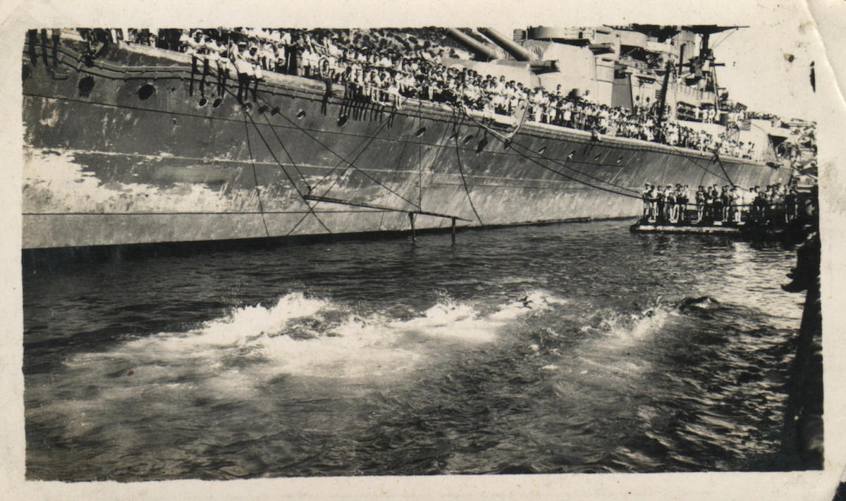

This is HMS Prince of Wales, perhaps a nice indicator. I'd estimate about 8.5" for this boot topping.
