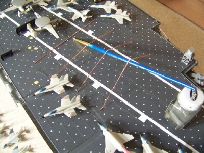

I am building the Tamiya 1/350 CVN65 and I came up with a cool trick for the arrester wires! I looped thread through like it says but I tied them long in the landed position, I then placed a split shot lead sinkers to them underneath the deck so now the weights pull the arrester wires tight on the flight deck. now you can pull them like a plane would then the weights will pull them back in. I then went one step more and hooked rubber bands to underneath so they have a back-up as well. Sorry I did not take photos of the set up before I glued the decks down. The only problem was minor, the second from the back gets caught between the deck and the hull so I filed the hull down just a little at that spot.

Tamiya 1/350 CVN-65 deck painting
There are literately over 200 small circles on the flight deck that should be painted white and I found the best thing to do it with. I went to Joann's fabrics and got a opaque paint marker fine tip made by Elmer's. It was amazing how fast & easy it was and it really made the deck stand out great. They have other colors as well and I am going to buy every color they make.
