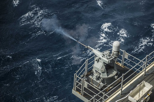

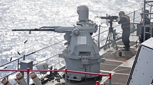

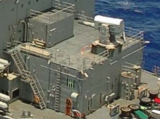

EJM wrote:Mk.38 Mod 2 Bushmaster gun system.
The Mod1 system was in place of the saluting batteries on Missouri and perhaps Wisconsin during the Gulf War. The Mod2 has the EO/IR camera which is the fragile point. I figured for the longest time I would mount the Mod 2 on top of the bridge and have their RSLs just aft of the citadel top.
I have recently moved that location to the amidships VLS deck.

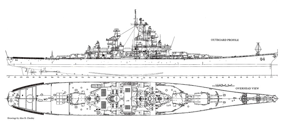

This is what I meant. This is taken from the Over Pressure Study of the systems aboard the battleship. It shows the positioning of the Mk29 NATO Sea Sparrow launchers and the Mk95 illuminators.
The link you posted is an interpretation of a drawing CliffyB and I collaborated on. The reason I know this is because the guy who posted it in secretprojects, Tzoli, was doing research for a report, and over our many correspondences, I sent him the result of the collaboration between CliffyB and myself. The original picture is very large so here is a smaller version:

In the attached second picture above, as well as the DeviantArt picture link I gave, I do not like the positions of the Seasparrow launchers as I feel their positions limit the firing arcs of the 5" gun mounts that are next to them.
Second, why can't there be more VLS missiles amidships between the two funnels? Two 4x4 (16 total) VLS sections doesn't seem like enough for that area. :(
EJM
Posts: 1061
Re: Modernized USS Iowa and USS Wisconsin
Post by EJM »
P.S. - Also in that second attached pic, I noticed the Mk.23 TAS radar above the second funnel. If I'm not too mistaken, this is also/was used in conjuction with the Seasparrow launchers, right?
I'm thinking of adding Seasparrow launchers to my Iowa model. Should I also add the Mk.23 TAS or has that been upgraded/replaced by a newer system?
