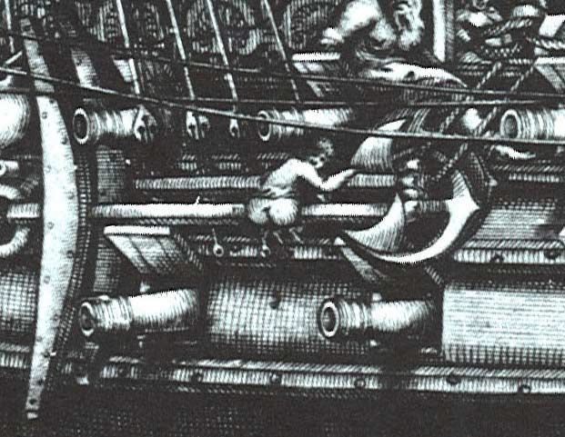

Post by dafi »
Not ?!? Wimpy!!!
And I was already thinking about how to add the characteristic smells to the model ;-)
By the way, here is a contemporary drawing of about 1600. It shows the middle of a great battle, and then I realised this small character sitting on the anchor and a bit lower ...
... no, I do not think that small blob is to represent a treenail from the planking ...
...hihihihihihi...
XXXDAMdan

Post by Channell »
:rolf_3: :rolf_3: :rolf_3:
Though having "danced with death" a few times myself I guess I oughta point out that the old saying "he got the $h#@! scared out of him" is more literal than one might expect!

... some of the lumber to be seen on contemporary pictures: (under-)deck chairs and packages wrapped in sail cloth.
And immediately we have some homeliness in the smallest confinements ...
