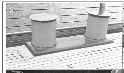

Hank, I gotta say - this is one gorgeous work of art. Not to mention a labor of love! I can't believe the amount of detail you've put into this ship. I've been over this thread several times now and each time I find something that I add to my "Think about doing this" list for my build. You can be very proud of this but I want to caution you , now that you are nearing the end, don't try to hurry to finish it.
I do have one question, Hank, and it pertains to this last photo you attached. I'm trying to figure out what you used for the 20" dual bits along the railing. Looking at TFD's plans (and their CD) they show the bits are set on a slight angle away from each other. He also posts a photo of the bits on the IOWA in which you can easily see this angle.
Now, the plastic parts in the Trumpeter kit do have these bits angled, however, the Pontos detail kit has them straight perpendicular with the base.
Which did you use for your ship? Looking at the photo closely, it looks like they're set on an angle, which means you probably used the plastic ones, however I can't really be sure. I'd like to use the Pontos brass bits, but I'm not sure I can get the proper angle on them.
Thanks Hank
Re: 1:200 USS NEW JERSEY (BB-62) 68-69 (Trumpeter MISSOURI k
Posted: Sat Aug 26, 2017 5:58 am
by BB62vet
Larry,
First - I appreciate your nice very positive remarks - THANKS!! :thumbs_up_1: And, while I haven't said it - YOUR model is coming along excellently also!!
Yes, I did use the Pontos brass bitts and following their instructions on how to use both their parts and the kit parts. I was able to get some angle on the bitts in the last stage of rebuilding them - once the bases were completed and ready to have the bitts installed into them, I put a drop of cryo into the base and then the bitt was inserted and held at an angle until the cryo set up. I had the base mounted in my small work vise in order to hold it in place. This took a couple evenings to accomplish (I usually work a couple hours each night on the model). They are not all uniformly angled, but enough that it really won't make that much difference when viewed from a normal distance.
I will make this comment - the current practice of "dumbing down" the typical model instructions so that the modeler does not have to be able to either read or speak any known language (simply look at the stupid picture) leaves out any form of complete understanding of how to PROPERLY assemble the kit parts. All in the name of making sure we don't offend anyone (or sell as many kits as possible to the morons of the world!!) - take your pick. Just my take on this p.c.b.s.
OK, so my advice would be - you know how they "should" look - take your time, use both kit/Pontos parts as shown, and carefully assemble the bitts so that they end up looking correct. A bit of "fudging" may be necessary - I think you may need to slightly angle the tiny holes in the base with a properly sized bit (can't recall the right size off hand) prior to inserting the pin in the brass bitt.
Hope this helps and answers your question!
