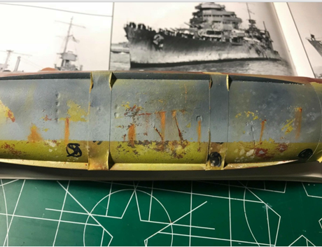

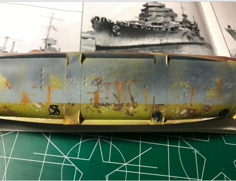

Finished work on a weathering and color study. I posted about the weathering in 'Tips and Tricks', but had a question specific to -38 in '42 post battle.
I used WEM Navy Blue N-5 as the base and then lightened it for my purposes.

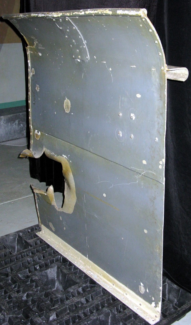

Is it me, or does the WEM N-5 not look like a good match compared to color photos of the period, or parts of -38? I understand the -38 in '42 could have been in S-5, but no one seems to know for sure and even if it was, the colors were very similar (outside of how they weathered - and why the Navy changes to N-5).
Thoughts?

I have to ask where you found these images of ship structure and what ship are they from? If they were posted earlier, I missed them. I have to wonder, does that "-38" refer to USS SAN FRANCISCO? When were these parts removed?? Whether these parts are painted in 5-S, 5-N, or even 5-H is depended on when they were removed. Very few USN ships were painted in 5-S after about the Spring of 1942, unless the ship was too busy for a complete repaint job.
As to the apparent difference between 5-N out of the can and what it looks like in photos, color or B&W, there are several factors to consider.
- All paint will look different outdoors in natural light. And even appear different under different lighting conditions; bright sunny day or overcast cloudy day.
- The camera settings. filters used, processing of the film or age/preservation of the film/print/transparency, etc will alter how the image looks color or otherwise.
- The WWII 5-N paint was notorious for fading in the bright South Pacific sun. Also, the exposure to salt water left a residue on all surfaces, particularly the hull.
- Distance from the camera that an image is taken.
- Generally speaking, the "true color" of a WWII camo paint will appear to be darker on a model than on a full size subject.
Here are a sample of images scanned from original transparencies at the US National Archives (NARA). All of these subjects were painted in Ms 21 with 5-N paint.
This image of USS St LOUIS (CL-49) taken on 5 July 1943, is really an interesting study. Note that parts of her superstructure looking darker than the hull. Also, note that the hull of the oiler in the foreground left is a darker 5-N than St LOUIS. Further, you can see where at some point her hull has been touched-up painted. You can see the salt residue along her hull, particularly along the waterline.

Rick - thank you so much. That was really helpful information, especially the nuances of coloring in different environments. I assume I could also add, that the myriad shipyards (domestic and abroad) that painted USN ships during WWII all probably used different color mixes, different suppliers and different application techniques at different levels of workmanship resulting in a fleet that while might have been in the same measure, might actually look different side-by-side. This helps a lot, as I think I can give myself some wiggle room in paint match.
"-38" indeed refers to the San Francisco. I'm actually modeling her as she is seen upon return following the Battle of Guadalcanal. So either 04 DEC 42 when she returned to Pearl or 11-14 DEC 42 when she had to stand off San Francisco while berth space was made available. The picture behind the model is off San Francisco(fittingly).
Lastly, the parts are actually from the San Francisco following the battle. The bridge wings are in the memorial at Golden Gate National Recreation Area and the others were put in storage in their original condition, which is really helpful (especially in seeing how the yellow primer shows through the faded blue). I wish they had done that to more ship of the war.
They can be found here, at the bottom of the page:
http://www.navsource.org/archives/04/038/04038.htm

Actually until mid-war, the USN manufactured the paint and distributed the two component paint to USN yards and private yards. With increased need for paint as more ships were added to the Fleet, private paint manufacturers were provided the formula to make the two components of paint.
The family of USN camouflage paint, 5-H, 5-O, 5-N, 5-S, etc, was shipped to application sites as "White" paint with all the properties desired in a good marine paint, and "blue tinting" paste. The ratio of tinting mixed in to the white paint determined the shade of the final paint... http://www.researcheratlarge.com/Ships/S19-7/index.html ... It was possible that whoever mixed the paint, could loose count of how much tinting he was using, but most times the paint was mixed and applied at a yard or an advance base. Early in the war, it was directed that ships were not allowed to carry large quantities of paint after it was realized how much of a fire hazard it was in combat. Ship crews could apply the paint, but it was supplied at a base or yard for that purpose and likely was delivered to them pre-mixed in smaller containers than large barrels.
