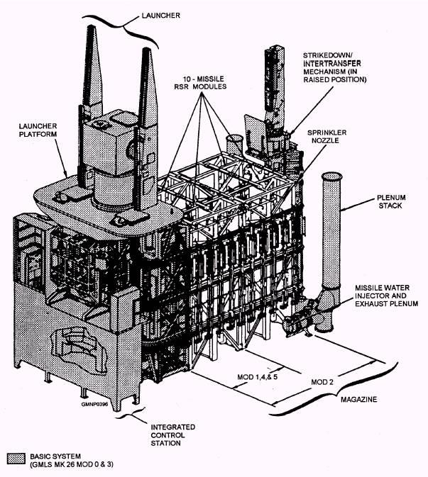

CSGN138 wrote:i have been thinking a lot about putting either a MK26 or a Mk13 launcher for the sole purpose of firing Harpoon. I would build a "house" for it between the masts on the boat deck, but one level above. the mk13 could hold 40 and the mk26 could hold 64. what do you all think about the viability of that? I was reading in navydaves Des Moines post that for a true anti-shipping platform you would want a buttload more that 8 harpoon... so there it is, a realistic (IMO) way to have a buttload of harpoons.

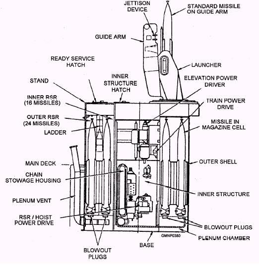

Well, I would suggest you have 2 Mk13 launchers (one port and one starboard) instead of 1 Mk26. The 64 missile Mk26 had a very large magazine foot print, probably too big to put between your super structures.
However...if you put one Mk13 on port and starboard of the center line amidships, you would have 80..count them...80 Harpoons, or a mix with some SM-2s. Here is the profile view:
This is what it looks like inside the FFG-7 Perrys:
Both would look really cool. The Mk26 can be center-line. I am not sure if you have enough room to have 1 launcher on either side of center-line. However, if you have the Mk26 Mod 0, 1, or 2, it could come close to butting up against the super structure, because the launcher arms would simply pivot to either port or starboard to fire.
You have some neat ideas, ones that I would not pursue, because the launchers are no longer supported, but they would make a great model, the Mk13 or the Mk26 :big_grin:

I found a MK17 in a picture that is about the correct angle, scaled it by matching up the guy staning next to it to the guys on my ship. Verified the scaling by also checking the sps-49 that was in the other picture to my 49. should be pretty close to the right size
Next, i took the line drawing Navydave posted and scaled it to the MK17, now on deck, so i can see how the magazine would fit in there. looks like it could be feasible...?
Lastly, i cleaned up the launcher so i can better picture it in my mind.
I think i like it. with one mounted port and starboard thats a theoretical load out of 80 harpoons :cool_2:
How do you all feel about that. alll comments welcome
