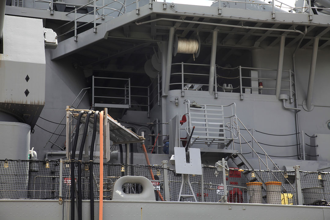

have time to get in one: Note the taper and curve of the bulkhead at the start of the covered weather deck just aft of the 56 mount, portside.

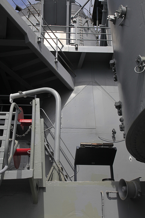

another shot stb side of the area of the covered weather deck, note how the edge turns and tapers above the ladder.

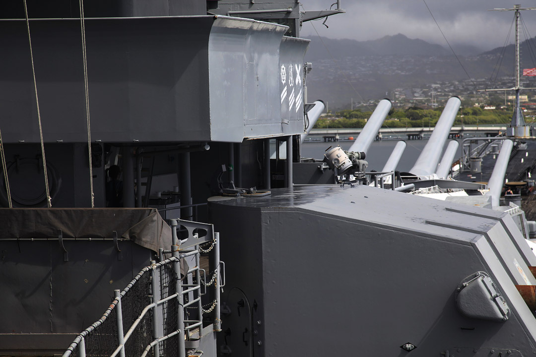

51 mount below bridge wing, stb side. Note that the gun captains hatch has no blast hood due lack of verticle clearance. The hatch, about 1 1/2" STS is spring ballanced to permit easy opening.

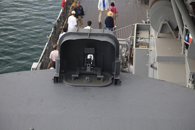

Blast hood and hatch 55 mount, stb side

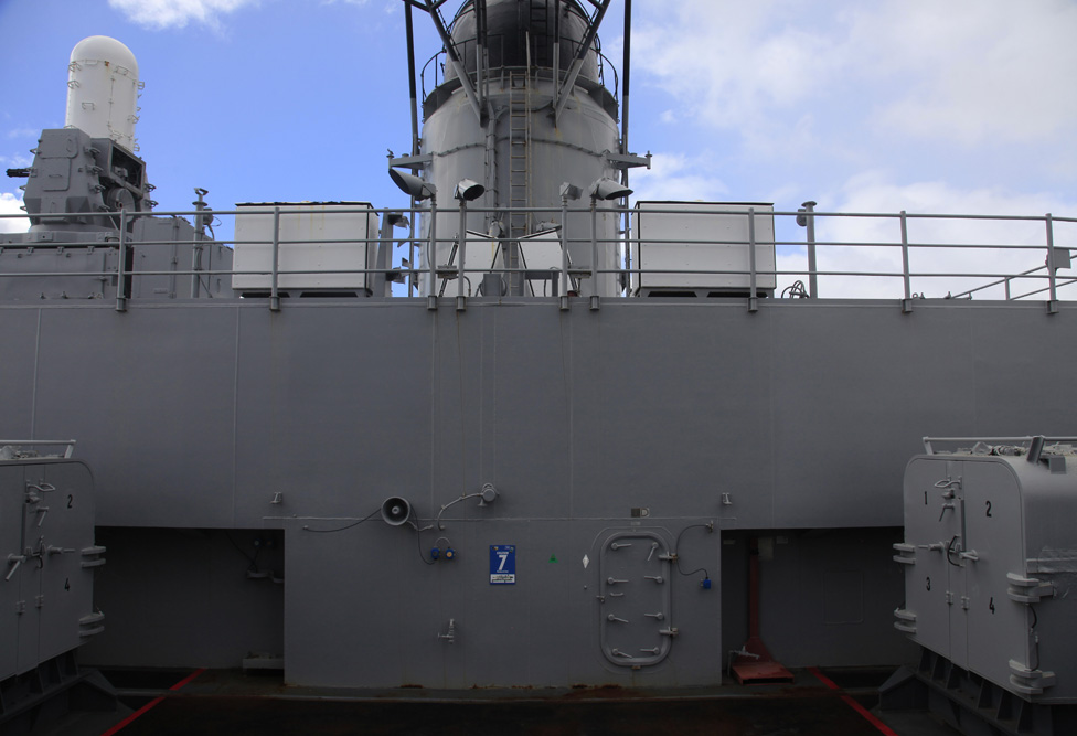

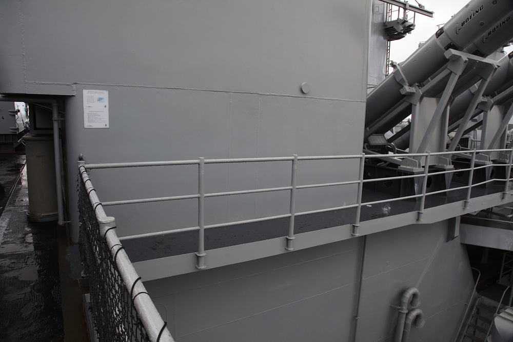

two photos, another area I screwed up! CIWS deck has an undercut port and stbd.

Post by Luky »
Yes I missed those too!
"two photos, another area I screwed up! CIWS deck has an undercut port and stbd."
No way to get to it now.
I think what I will do is make two fake covers for those .
You know the captain has to have a place to put his golf clubs etc.,!

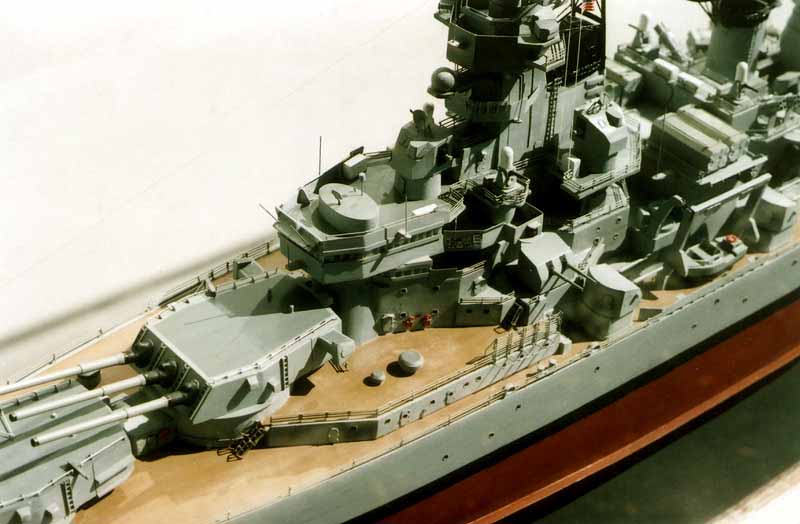

Yes. Thanks, I am attaching the railings to the outside of the decks on this model.
On the previous model I attached the railings to the inside, and drilled through the deck.
The only thing I do not like about that is the glue is mostly holding on the railing.
Below is a detail of the model I built in 2005.
Click on the photo to enlarge.

Thanks! What did you make the spherical radar domes from?
