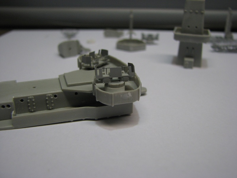

The North Carolina progresses. I've got the quad 40mm mounts done and the Mk8 fire control radar started. I have the aft stack and deck house glued in place and sanded. I also have started the catapults, boat cranes, foremast, a/c crane and SK-2 radar.
There is a problem with the six raised 40mm mounts, they don't fit very well behind the molded on deck shields. So after looking at the pictures in my reference books, I see that they are raised up so the bottom of the shields on the mounts are higher than the deck shields. My guess is that when the 1.1" mounts were replaced by the 40mm mounts is was easier to raise the 40mm mounts than enlarge the platforms the guns are mounted to. I cut some tubing and used it to raise the six mounts up.
Here's how she looks today.
Aft stack glued in place
raised mount
raised mount
The port side raised mount is free to turn anyway where as the starboard side will only go so are.
