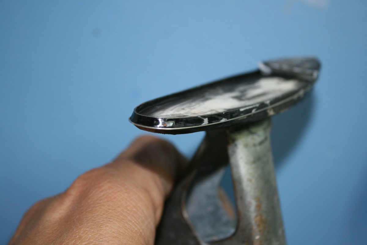

My modelroom has been graced by my presence once again as the pre-Easter rush at my Buisness has at long last subsided a little ...
With the glass case at long last being built it was time to mount the ship as I now had the baseplate...

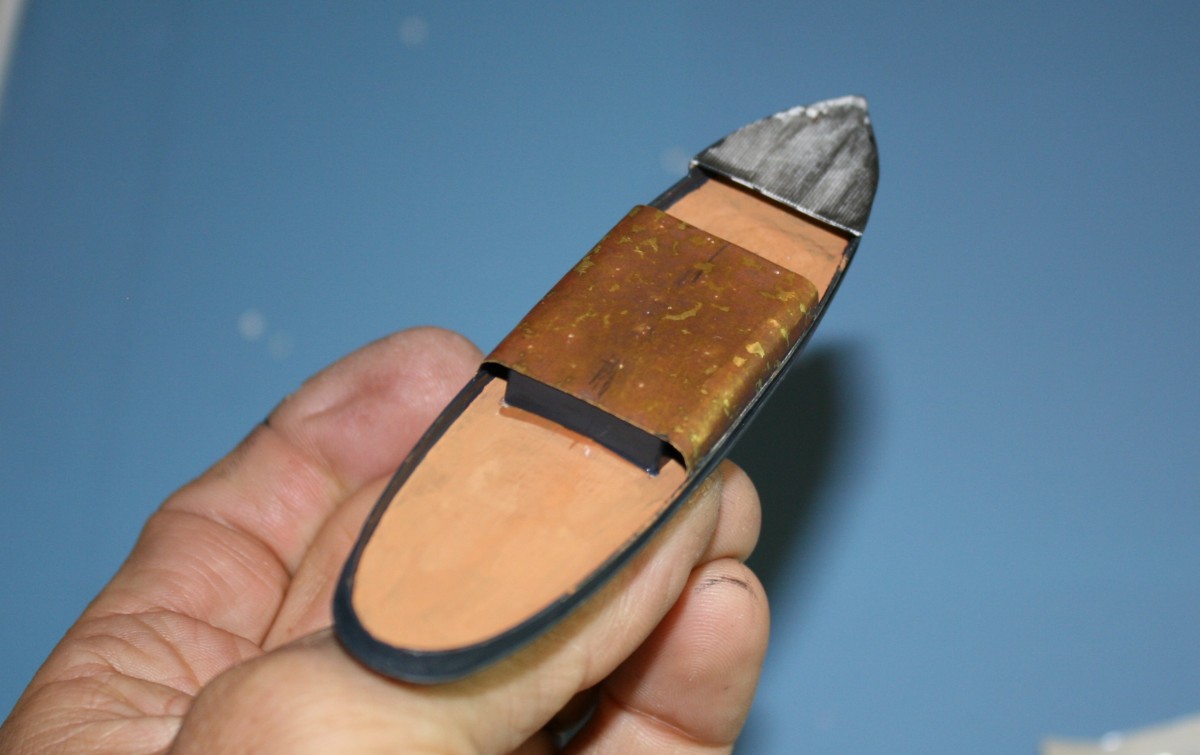

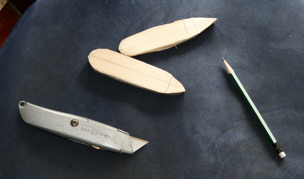

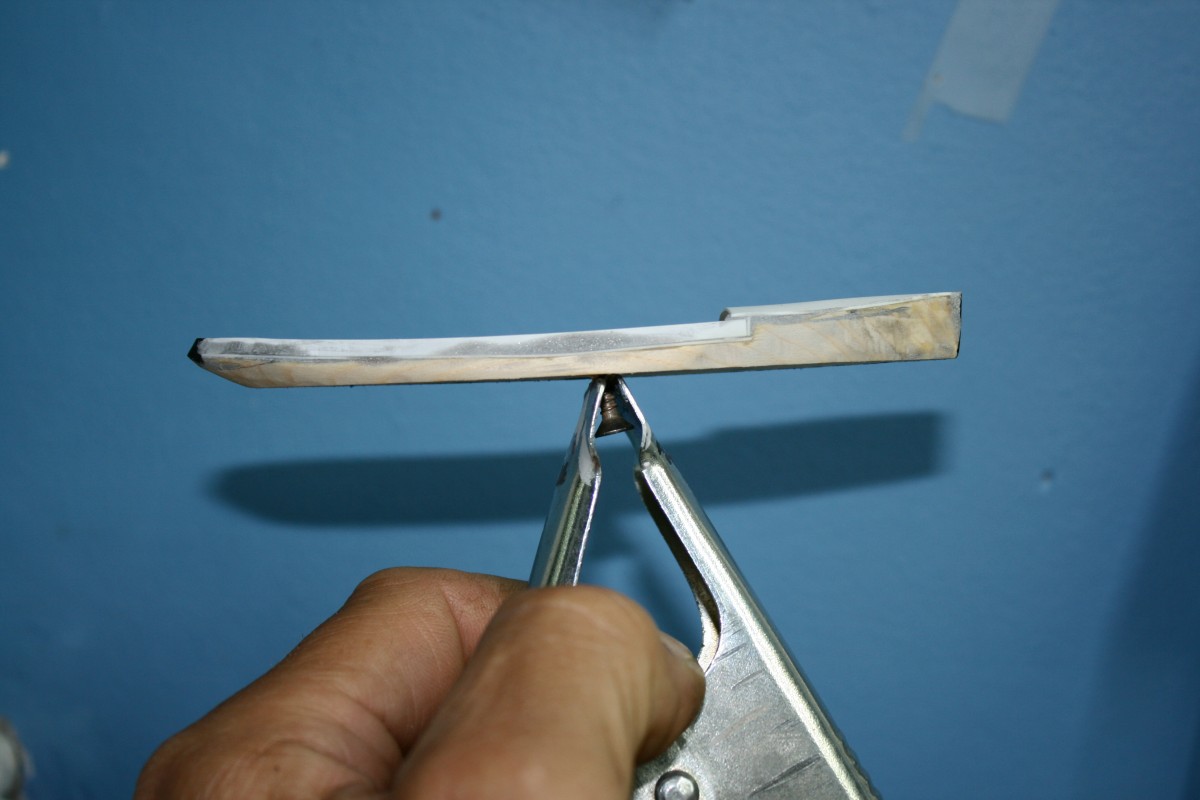

To portray the scene of Vulkan taking up the two to be broken up in Harwich UK I needed 2 x tugs...
Thanks to Lars and a lot of time spent on the ' net I believe I have some useful images of models and the real thing to commence the building of the tugs

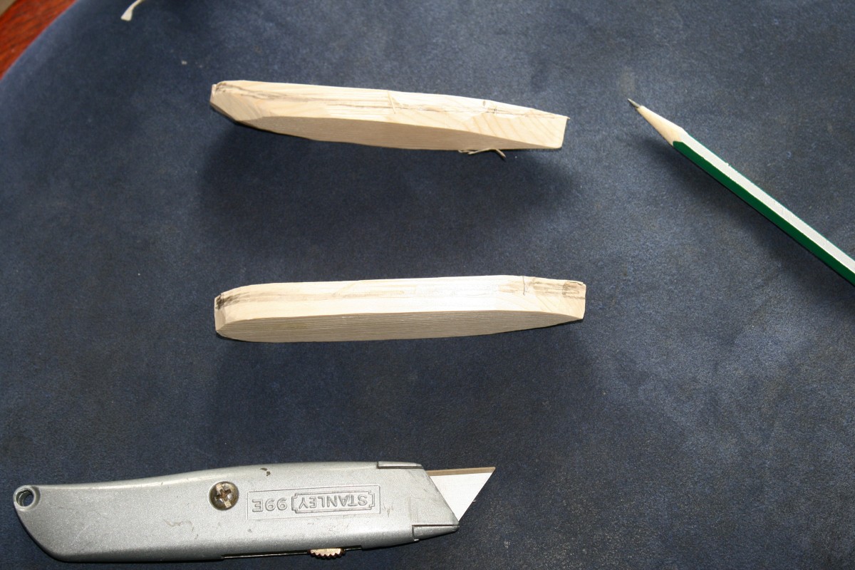

I used the lines plan in the PN Thomas book of the Dutch tug Oceana to give a generically correct basis...

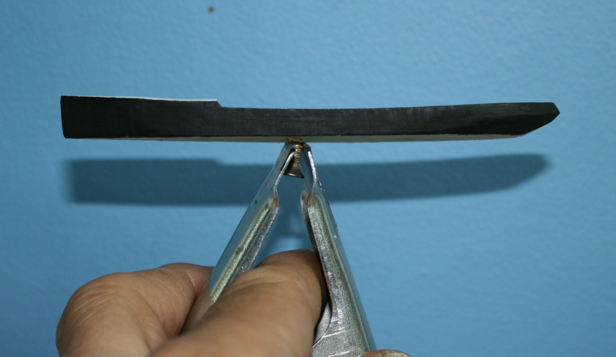

I carved the roughs of the hulls using the fine tool of a 'Stanley knife.... :big_grin: :big_grin:
( I also made some card half templates to guide me--not completely by eye!! )
one long foredeck; one with short foredeck

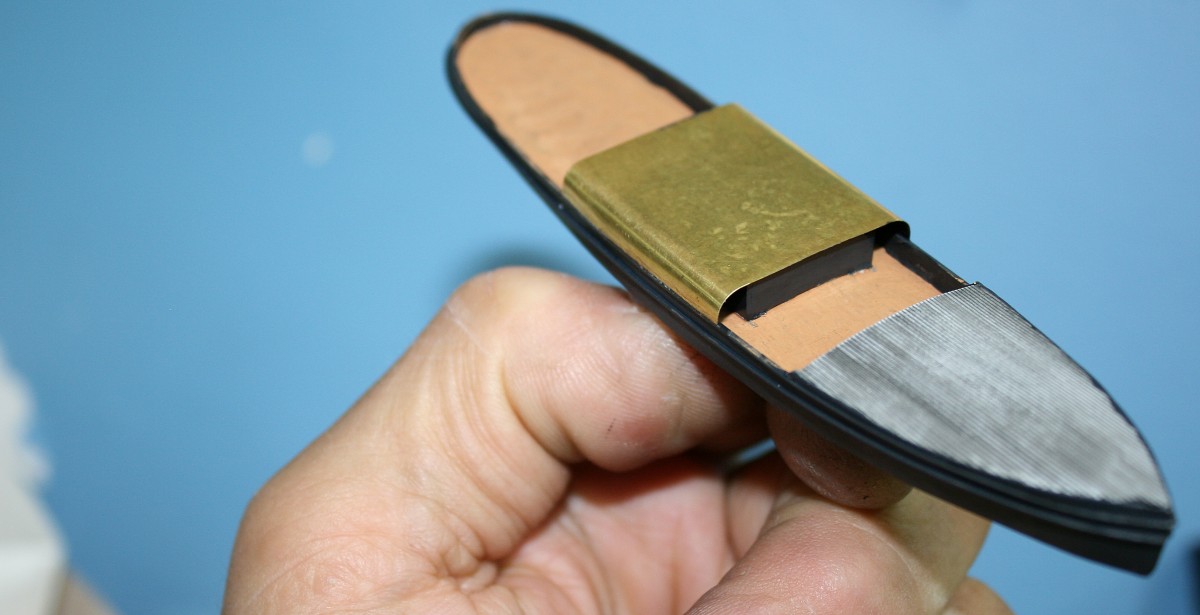

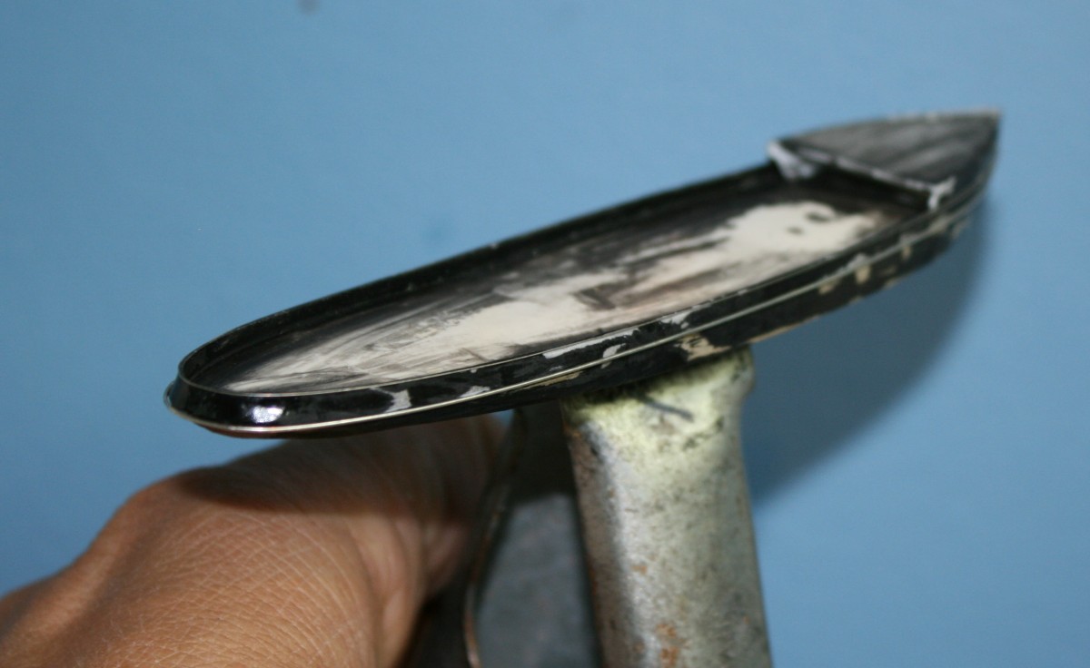

with the use of styrene and a lot of filler ...progress was quite rapid...
a guide coat of paint showed more work required--but it looks I may be back in the swing of it at last!!
Hopefully more soon over the remainder of the Easter break....
:wave_1:

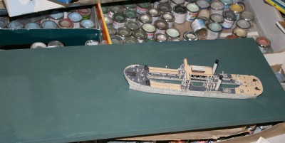

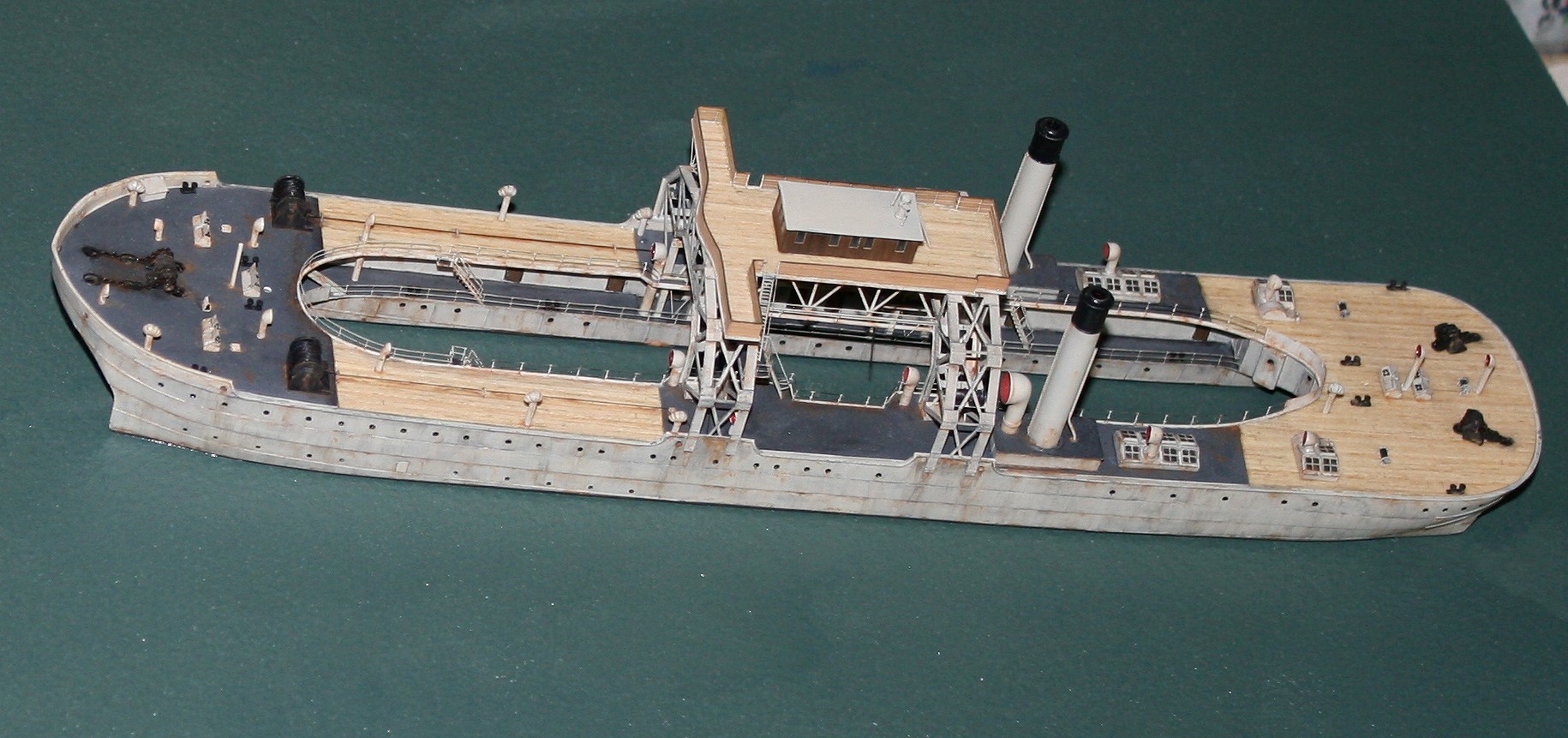

here is about the current status quo
not terribly impressive for such a long time but a bit of progress nonetheless...

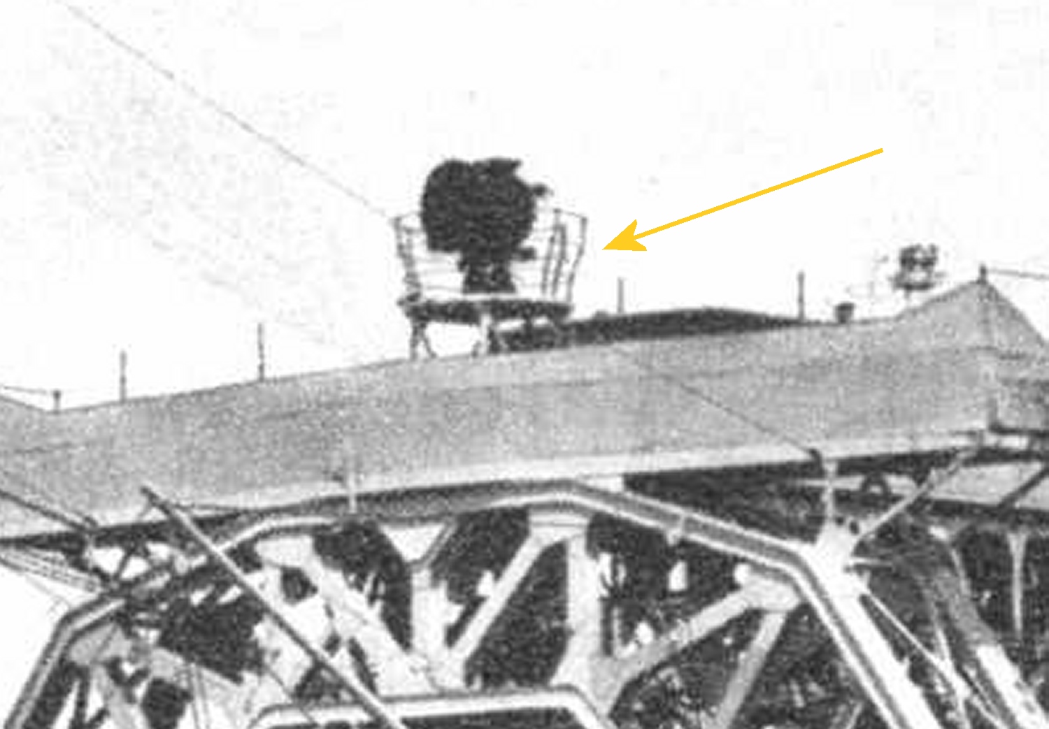

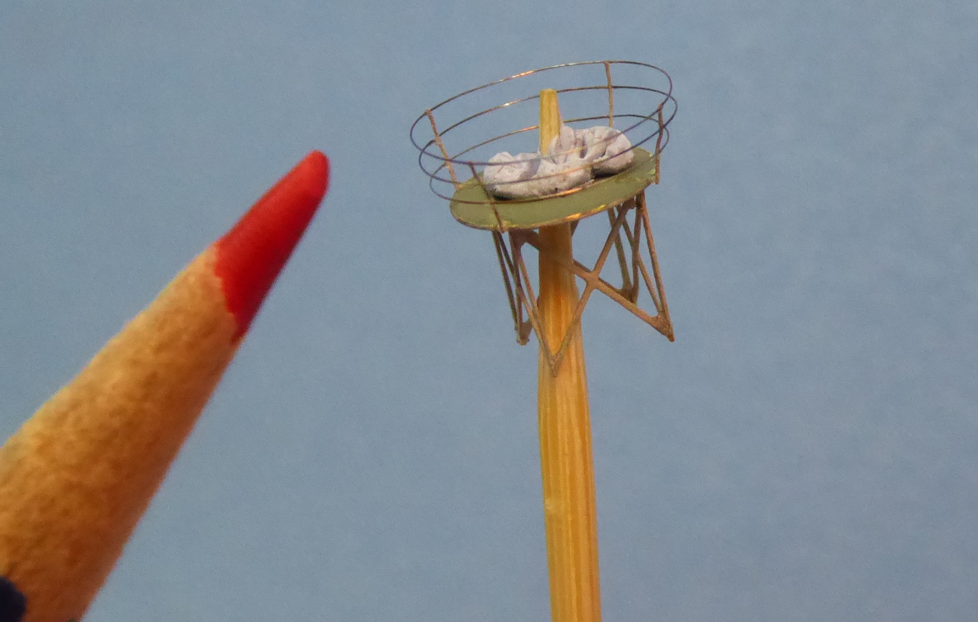

the searchlight platform railing....which I think with the benefit of better magnification,
--and a more lateral approach I can solve..
herewith the ' problem'
( I have already made the platform -- in readiness - back then ! )
how to make that railing...
any ideas how ? :wave_1:
and... how did they access the platform ?
I have not seen ANY sign of a ladder on any of the ( many!) images I have of this ship! )

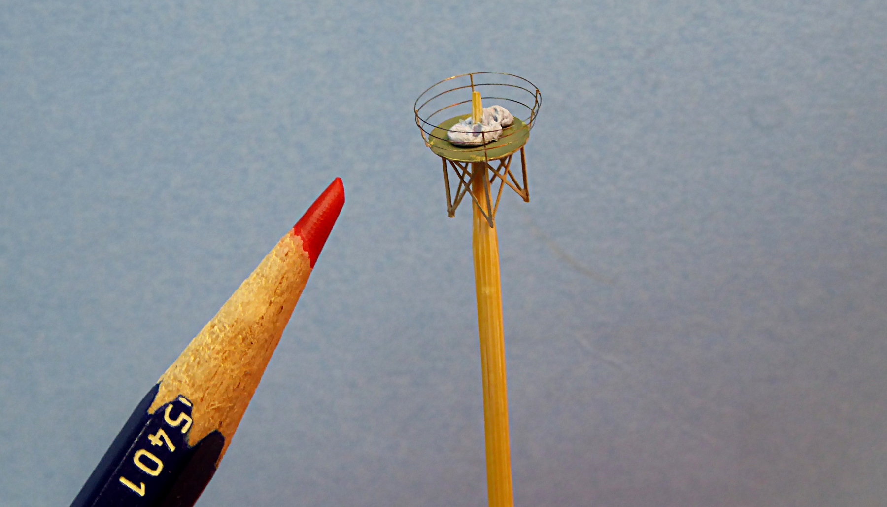

JIM BAUMANN
Posts: 5728
Re: Building SMS Vulkan( submarine rescue ship ) in 1/350
Post by JIM BAUMANN »
well-=.... - still awaiting my wire for Normandie rigging...
so make some tangible progress on Vulkan !
the aforementioned searchlight platform with its angled and curved stanchions!
==> was beyond the remit of any PE rail in the conventional sense
for my liking, ...

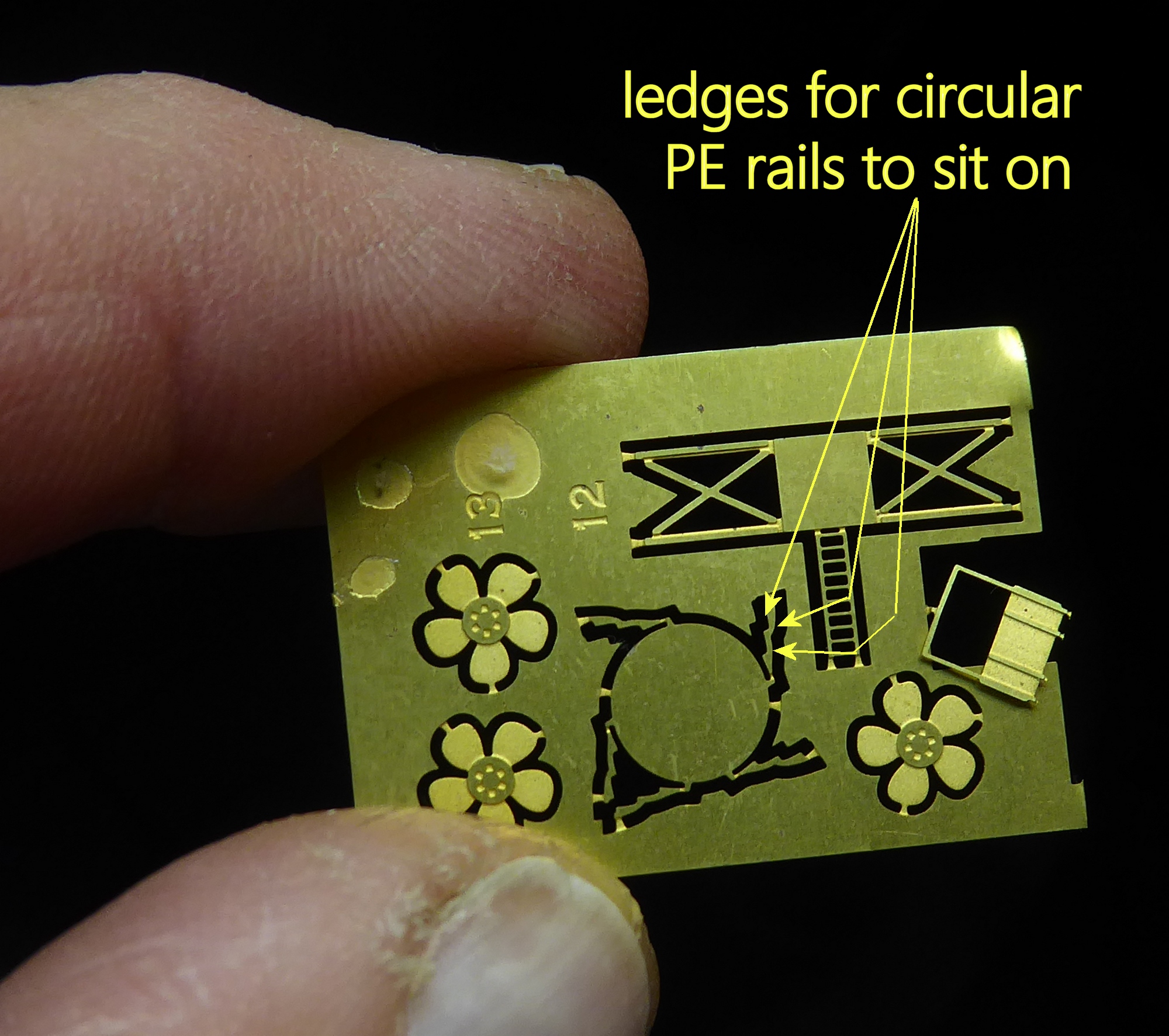

The original PE designer had solved the issue cleverly --albeit it in a somewhat heavy way overscale way
But it did serve to inspire me to carry out , the more satisfactory -- to my eyes-anyhow--- solution!
I made 4 x shaped stanchions , made of PE longitudinals from some 1/350 railing ,
to my previously ( 2013!) constructed platform...
I then drew some very thin stainless steel wire straight, and rolled this with a series of tubes and round bar on a pad of 'post-it notes'
( the pad allows the wire to deflect under the pressure of the tubes / bar being rolled back and forth)
until they curled - so that I could then form them into circles -- of differing diameters....(#!!!! )
gluing wire ends butt-end to butt end together is a tricky business...!!
much failure, cursing and failed attempts etc
but success in the end ...
compare the rail thickness to the the intended PE rails to go with the platform and integral stanchions of the PE in previous image
the end result was more pleasing to my eyes, although to make and assemble the platform rails sitting
on the stanchions , level and solid --took in excess of 5 hours...(!!)
just needs paint!
I shall recommence the 2 x tug--boat builds next
:wave_1:
JB

Probably rungs on either side of a leg? Much like a telephone pole. Patience has been rewarded!
Tom

-I was going to settle( pah! --settle...!!_ )for generic-sort-of-that-kind-of-tug...
I was working off photos--of the wrong tugs- of the wrong era
a but tooooo much guess-work resulted in my 2 x tug hulls being quite tug-like ( phew!_)
-- but with too much beam and
--for that era of tug-- not enough sheerline ( deckspring ) fwd and a bit too much fordeck...
move on 6 short years and 'generic tugs 'won't do--and with my chums Maarten and Lars we are now on the correct track !
More on the construction of these correct shaped tugs shortly--
but I reckoned that some practice at scratch- building this type and tugs would be useful - so as to proceed armed with info and techniques.
so decided to recycle the more likely one of the 2 hulls into a ' generic-dutch-style-tug-of-that-era ' and try and make a stand-alone model.
so as not to clutter up this ( seeking accuracy etc ) thread tooo much... :big_grin:
here is the link to the rather fictional tug stand-alone build thread in the WIP forum here at Modelwarships.com!
viewtopic.php?f=59&t=314432&p=927583#p927583
drasticplastic
Posts: 1439
Location: Montreal, Canada
Post by drasticplastic »
Meanwhile, my Vulkan is still still sitting mint-in-box...the amount of PE is a little intimidating. Hope to tackle it while my eyes are still working!
:wave_1:
Maarten Sch�nfeld
Posts: 1847
Post by Maarten Sch�nfeld »
drasticplastic wrote:Meanwhile, my Vulkan is still still sitting mint-in-box...the amount of PE is a little intimidating. Hope to tackle it while my eyes are still working!
:wave_1:
Hi Drasticplastic,
I really hope you pick up the courage to build this lovely model! But if you don't, please let me know, I am very willing to take over your kit! Through the coop with Jim on the matter of the tugs, I got very interested to build the beast myself too, one day (I have other subjects on the slipway now...)
Maarten
