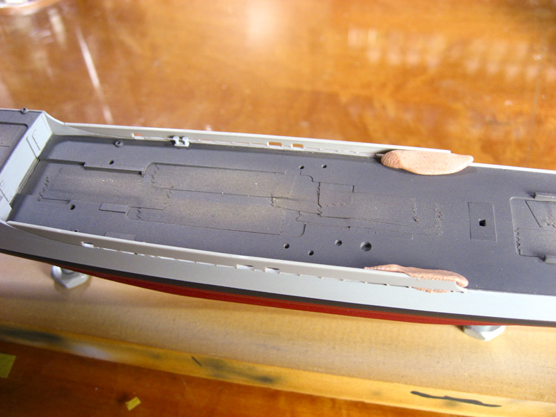

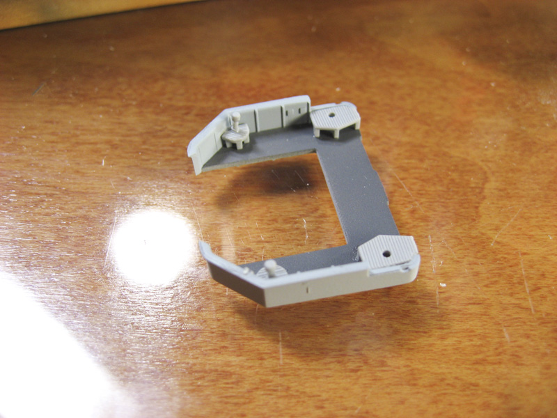

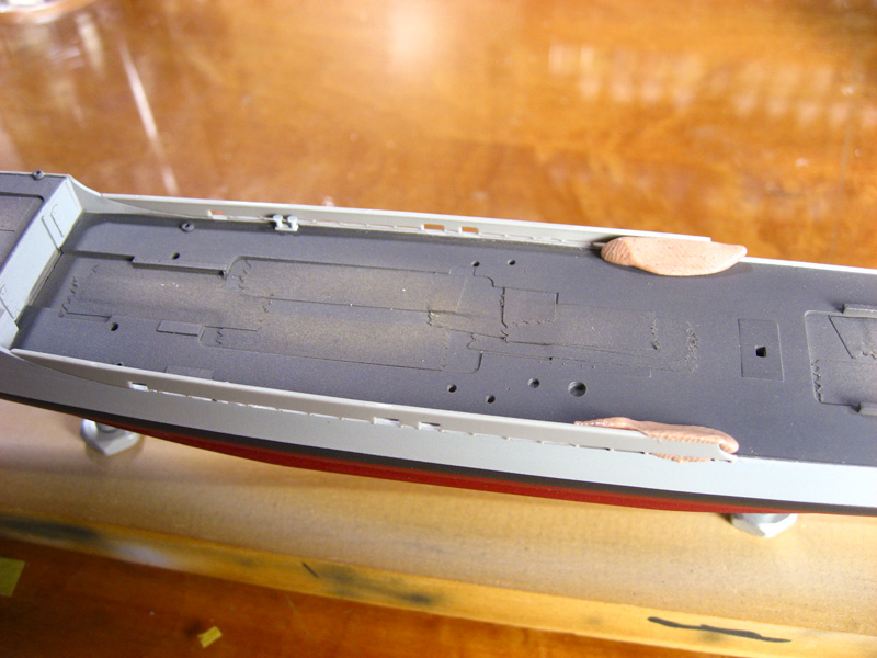

Just a single photo so I can say I did SOMETHING and posted proof. Long story short, I've been dealing with some health issues these past few months that have left me not feeling like sitting in a chair at a bench. While I'm still having said issues, I am coping with it better, and there's (hopefully) a light at the end of the tunnel, so I'm forcing myself to get back into my regular routines.
The amidships breakwaters on the Benson kit are the first parts I've really had an issue with. While they're wonderfully thin for a scale appearance, there's no real locators or pins to hold them in place. I futzed around with them a lot and finally decided to use the ol' Silly Putty Temporary Support trick (the same trick I use to position and glue photo etch railings).
Not much to show. I basically stuck the aft end of the breakwater in a glob of Silly Putty, then poked and prodded until the forward most part was lined up. I then applied liquid cement on the inside of the seam with a fine paint brush, checked alignment again, and done. I'll let it sit over night to get good and set, then tomorrow I'll pick out the Putty and glue the rest of the run. Once that's done I can airbrush the breakwaters and any surrounding damage, and then I believe I' can start attaching deck houses and photo etch railings.

I had issues with those too - they are quite tricky to attach. I like your method. May have to try that when I get around to trying to finish Livermore.

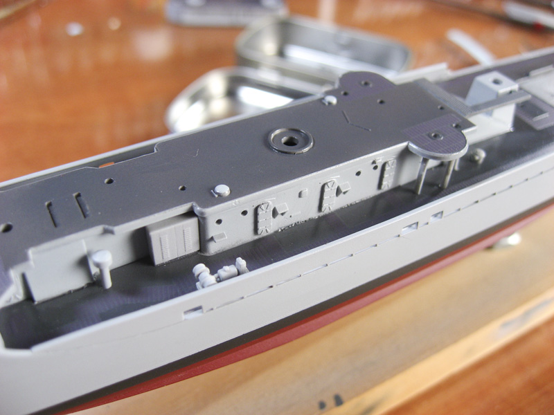

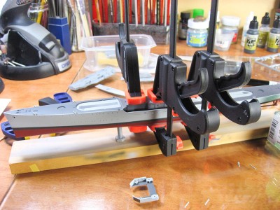

Ten days off for the holidays, so time to get as much done on this as I can. I'm at the point now where things start going together. Big assemblies are good, but the detailing of them takes a bit of time. These Dragon kits have a TON of minute parts, all well done and very nice, but detaching, filing, sanding, priming and painting each of them takes a lot of time. A couple of photos:
- The midship's deckhouse is the one major problem spot on these kits. It doesn't fit very well in bare styrene, and when you paint it, the fit is even worse. It's a simple fix, though: sand down the forward bulkhead until you can wedge it into place, then apply ample adhesive, and clamp it down like it's a fugitive flight risk.

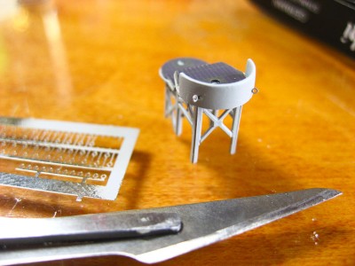

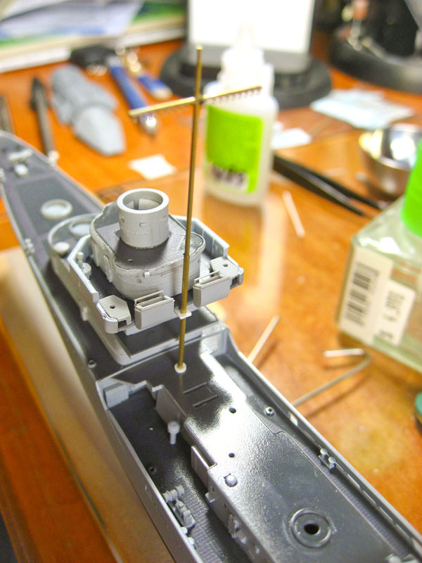

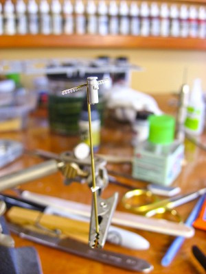

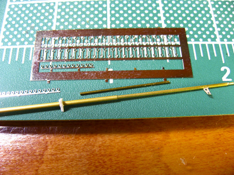

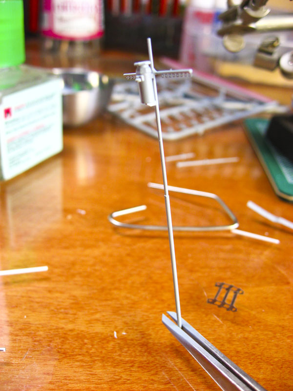

Working on the mast these past couple of evenings. I really wanted to just use the kit parts and be done with it, but I can't talk myself into not rigging this thing, so brass it is. Mast itself is three sections of telescoping micro-tubing, the cross member is brass solid stock. I realize now I should have assembled the cross member to the vertical first, then started adding in the details and crow's nest. Oh well, if the alignment is off, I can just strip it down and start over.
- Devin
- Posts: 2497
- Location: Hoboken, NJ
Re: 1/350 USS Benson (DD-421), 1940

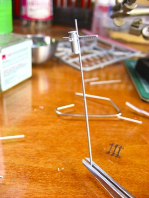

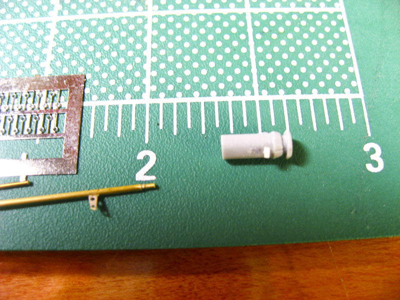

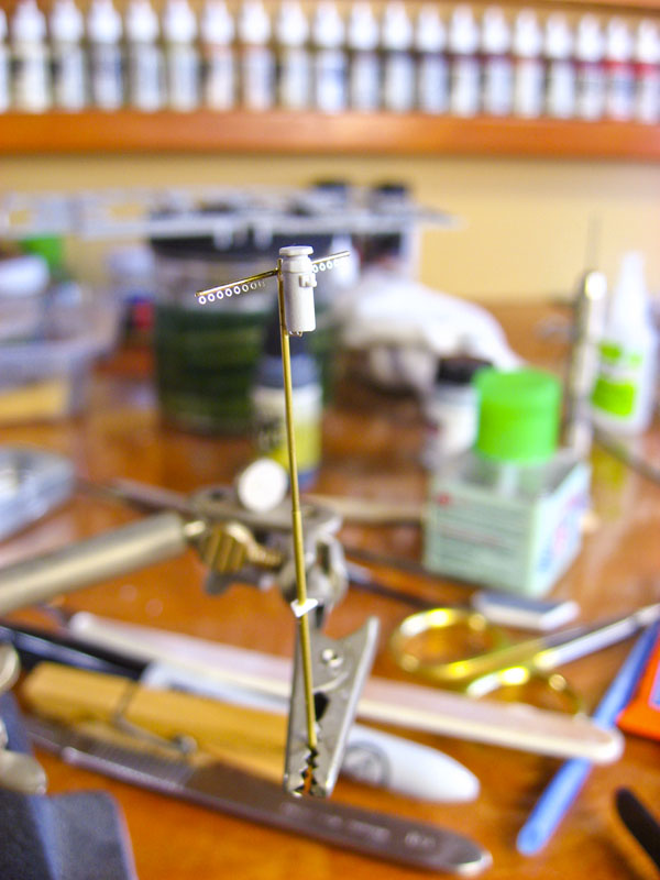

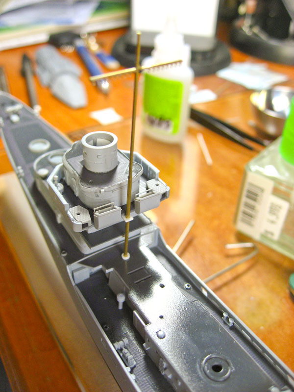

Two days later and still working on the mast. When I said I may have to tear it all apart and start over, I was right. Nothing was plumb, parallel, or horizontal. I started over from scratch, building the vertical once again with telescoping tubing. I then put the cross member (yard arms) using a square to make sure it was perfectly 90 degrees, fixed it with super glue, then reinforced the joint with 30 minute, 2 ton epoxy. In the photo you can see the white plastic square fixture I built on the flag bag deck to give it the proper position and support, and a tiny disk of styrene at the base of the mast that I punched and drilled to fill the too-large opening. I still need to add the crow's nest and other little bits. Trying to decide if I should do that now, or wait until the superstructure and mast are fixed permanently, so I can be sure of alignment.
You can also see small sections of railing that I glued to the front of each flag bag to give something to tie off the halyards to. I have the specific Dragon photo etch set for the kit, and there's a section of railing that's supposed to go there, but it's no where near the right size, so I cut out single sections to make these items.

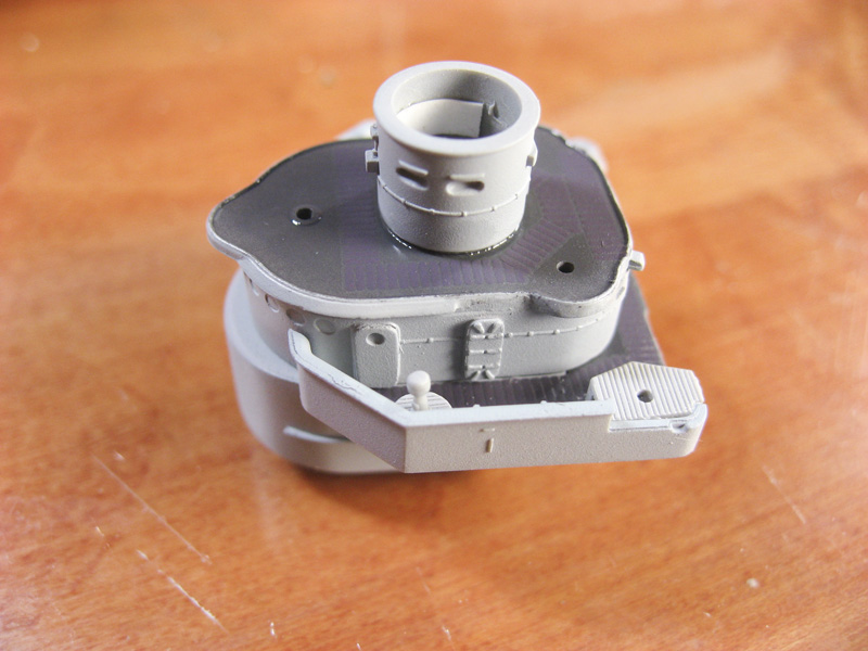

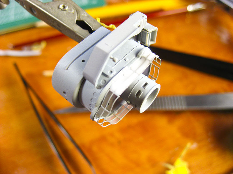

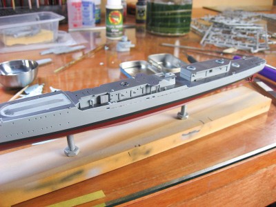

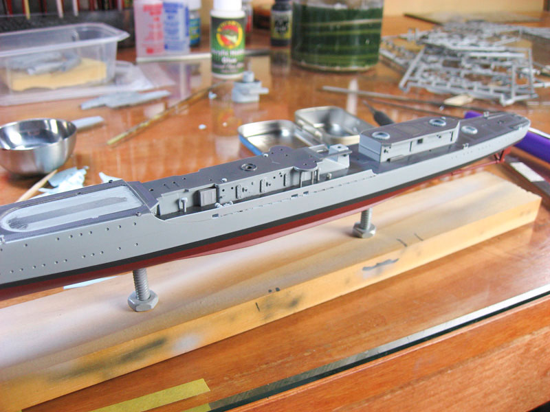

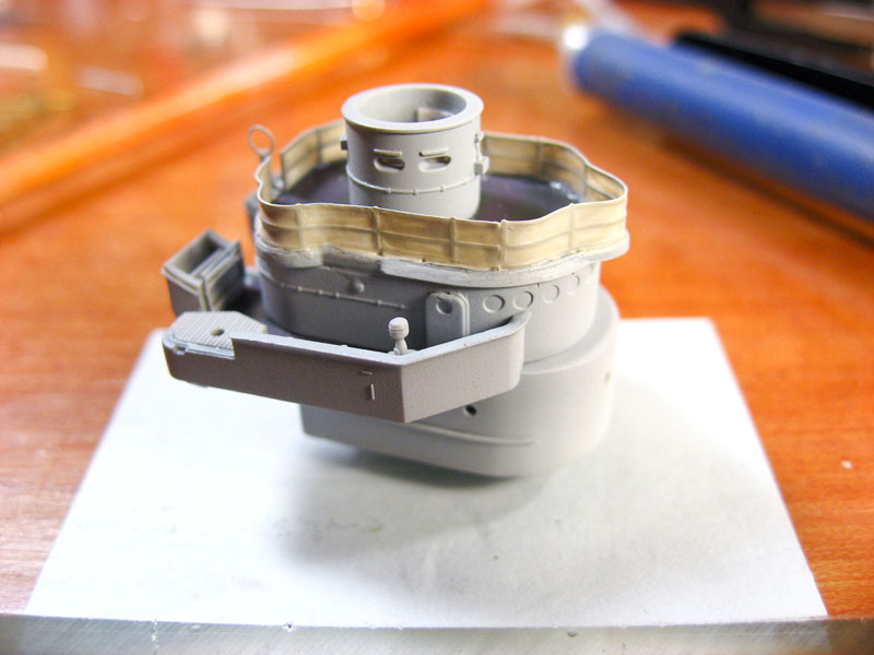

The upper superstructure and railing has to be finished and installed before the mast can go in, but I have to have them both dry fit so I can judge where to drill the holes for the rigging attachment points.
I've built two Benson class DDs in resin before, so I KNOW I've done the railing on top of the deck house, but I don't remember it being so difficult. I started out with the PE bit from the Dragon set, and found it as useless as the railing for the flag bag area. I'm seeing a disturbing trend here. I have a set of Classic Warships generic PE that came with the USS Wichita kit, so I cut some sections from that. Very fine PE, too fine for this instance of multiple curved bends. I'm cutting it down into sections to make it workable. Once it's all in, I'll be coating this upper section with white glue to replicate the canvas dodgers/windscreens.
Lots of work for a single photo. It's taken at least an hour to get this simple bit of railing in place.

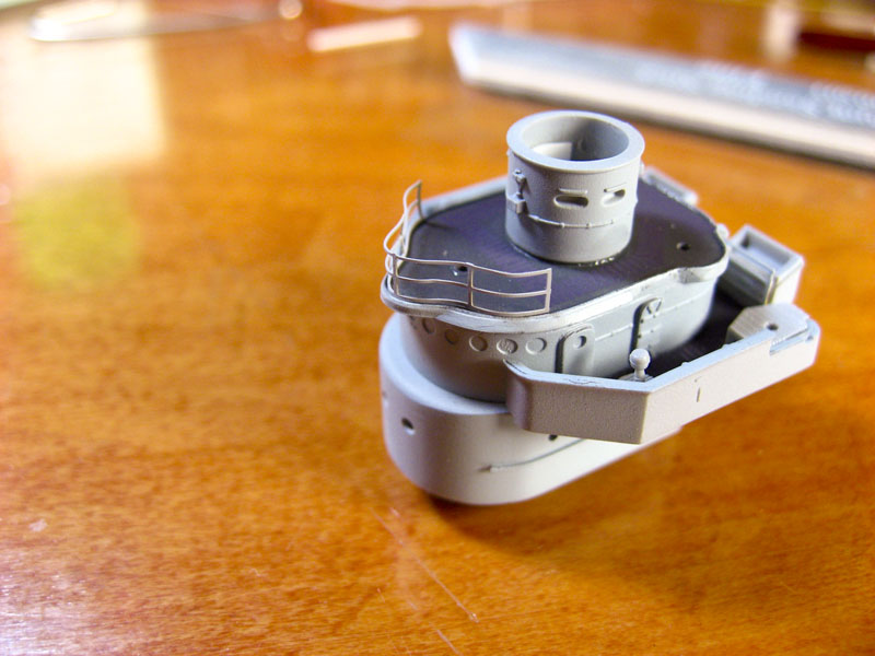

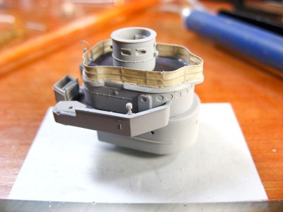

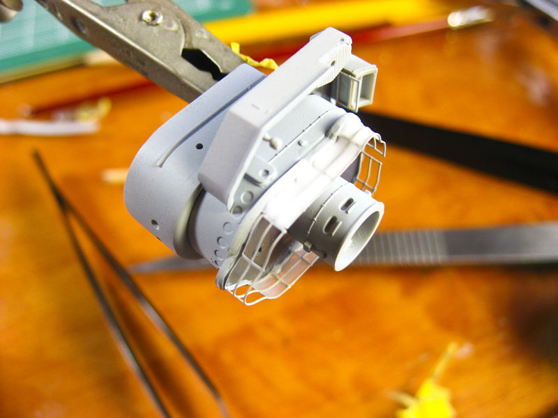

More small details that have to be added before final assembly begins. For the canvas rails on the top of the bridge I'm using something shown elsewhere on this site (maybe Jim Bauman?) that utilizes white glue. The mast is also finished and ready to install, and I've started drilling for the super tiny rigging points.

Nice update. I did not even think of cutting the bridge railing in to smaller pieces like you did. I struggled to bend a long single piece that rook a long time and was pain to do. Good tip for next time.

Thanks for the feedback, guys. Gordon, the railing trick was out of necessity, I tried for about an hour to get a single run folded correctly, but it just wasn't working, and I was losing my mind.
I have the forward superstructure ready to glue to the hull. I'm going to let the paint dry over night, then mount it and the mast tomorrow. It looks like I'm going to have Tuesday off from work due to Blizzardzilla here in NYC, so I'll make as much progress as I can then.
- Needs some touch-up, but the canvas dodgers turned out decently. I like the translucent look. The paint is Vallejo Deck Gray, which looks to be a spot-on match to the shade in that pre-war USS Hammann photo I posted earlier. One thing I did do was go over the dried white glue with clear lacquer, as a barrier so that the acrylic Vallejo paint didn't attack the acrylic white glue.
