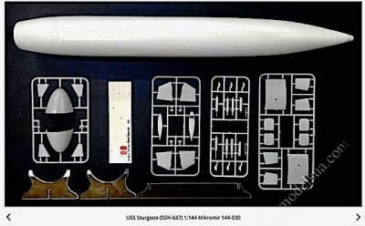

It�s already available to order. I provided MikroMir with Greg Sharpe drawings for both the Sturgeon and Los Angeles class, which is also planned for 1/144 later this year. The model is �as built� 637 short hull, with no towed array or topside sonar/intercept domes added later. I don�t know if they plan a long hull version.
The test shot photos I have look like polystyrene hull pieces, not GRP. Where did you get the fiberglass hull information? The test had a modest number of parts, and no photo etch pieces. See photo.
One aspect that I am not so thrilled about is that the screw is a hub (leftmost sprue) with seven individual blades (2nd sprue from the right, 3 blades each at top and bottom) that have to be butt glued onto the hub. They also did this with their Mike and Papa subs. The smooth hubs on those had no indication as to blade attachment locations or angles. I would have preferred a single cast piece. Room for a good aftermarket piece there.
MikroMir 1/144 scale Sturgeon kit parts
In the description in the link I posted ;)

Okay. We will see if they are correct on HobbySearch. Up to now, MikroMir has been strictly a styrene injection molding outfit. FRP (aka GRP- Glass Reinforced Plastic) requires different adhesives than polystyrene. Gluing parts to the hull will require cyanoacrylate or 2 part epoxy. I notice that HobbySearch price of $129 is at the high end of prices for this kit. This site is considerably less expensive and lists it as a plastic kit.
https://plastic-models-store.com/mikro- ... -model-kit
I noticed the HobbySearch web site also mentions that it had the S3G reactor, which it did not. Two S3G reactors were employed solely on SSRN Triton. The Sturgeons had the S5W, as did the Skipjacks, Permits, and the 41 Polaris SSBN. And the sponsor was Mrs. Everett Dirksen, not Darksen. Lost in Translation.

Hobby Search doesn't write its own descriptions - it just posts the autotranslated version of whatever the manufacturer gives them.
As for the kit's actual material, I can only say that the photo shows the hull to be distinctly lighter in colour, even accounting for the curved nature, than the other parts. I agree that it's out of character for Mikro Mir to make the hull this way, but they also haven't made many this large before.

Yes, the screw looks pretty high in the awfulness department! And I'll certainly be responding though I'll have to wait until one of you lot get it and report back the hull trailing edge diameter to insure my screw integrates well. Also releasing a 1/144 Permit/Thresher 7-blader here soon (Modelsvit kit), so the Sturgeon will fit right in.

Regarding the screw. Turns out it�s worse than that.
Six blades instead of seven. Totally incorrect.
