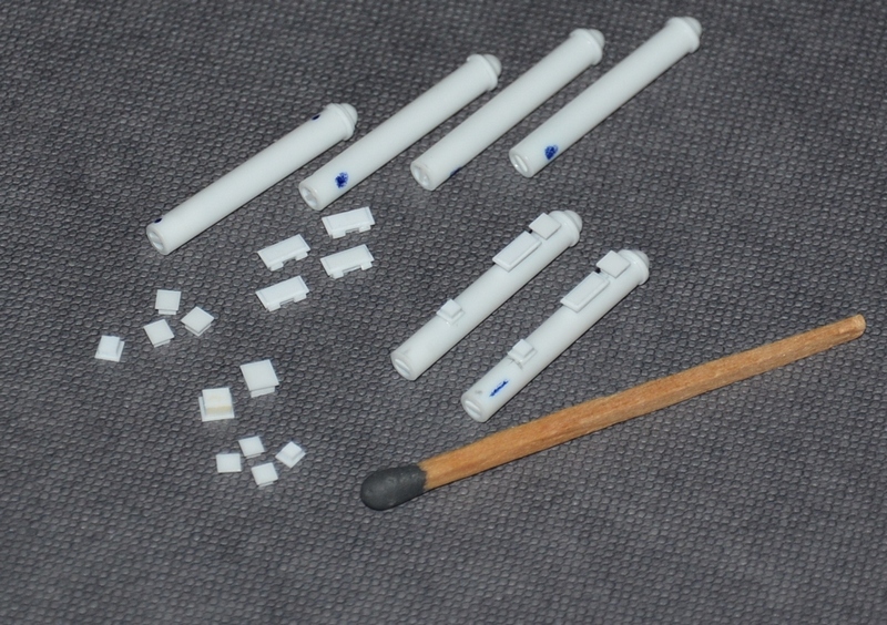

Hi there to all modellers,
After the basics of the torpedo tubes are done, I started completing the minor details, something not difficult at all. I have searched for a set of PE handwheels to complete these little things, but apparently these Mk.32 torpedo tubes are not produced in this 1/144 scale, and accordingly I have found no PE for them. I will have to think of something else.
I have also started the stands, again using 1.0 mm. Evergreen plate and some plastic from a yogourth container.
I will try to finish these stands tomorrow, if I find the time.
Brgds from this side,
Willie.[/size]

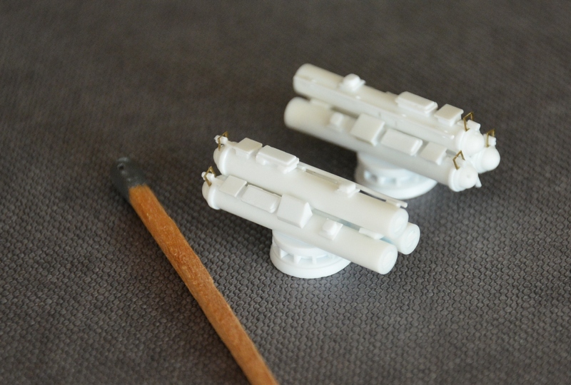

Hi there again all modellers.
The Mk.32 tubes are taking shape. The stands are half done, with the tubes already in position and almost complete too.
The lower tubes are kept apart and placed on the stands using two small pieces of 0.5 mm. Evergreen strip, invisible when the upper tubes are set in place themselves, using now two sections of 0.5 thick Evergreen tube, which are telescopic to the 3.2 tubing of which the tubes are made. Very easy to make, and again with quite convincing results :
I hope you like it, and very best regards from this side,
Willie.[/size]
Posted: Tue Apr 30, 2019 2:00 pm
by Willie
Hi all friend modellers,
I think the Mk32�s are already finished. I have added the conical bases, the last elements in plastic and some others in PE.
I don�t know if it would be convenient to add wires, in case it ruins the overall effect, although maybe I add some in copper.
I hope you like it, and very best regards from the North Atlantic,
Willie.[/size]
