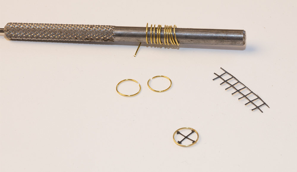

- Posts: 5068
Re: APA project
Handwheels made by coiling soft copper wire around a mandrel, nipping each coil to make a circle, soldering or jointing with CA. Then the spokes are trimmed from a fine mosquito net and then finished when glued to a shaft.

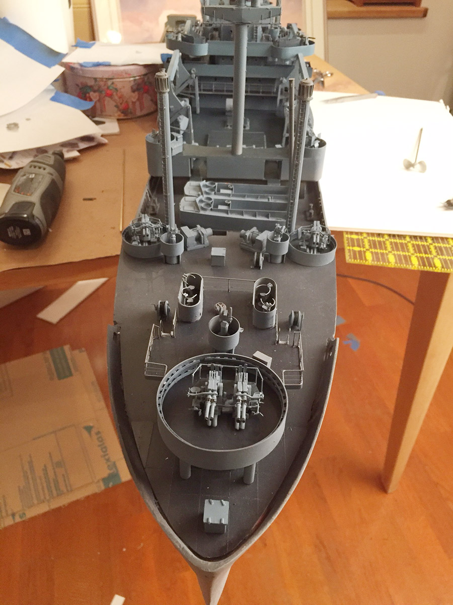

- Posts: 5068
Re: APA project
Bow View, (Eye Phone). Again just a bunch of pieces piled on deck. Today's effort was mostly making steering wheels for the plethora of Higgin's Boats. A lot to do with installing all the frames extending up through the bulwarks fore and aft, painting the hull, prop and rudder then getting to the lifelines boat cradles and trying to figure a sensible way to do the standing and moving rigging.

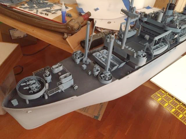

- Posts: 5068
Re: APA project
Same deal, Bow, port side. Even small items such as several cable reels can take some time!

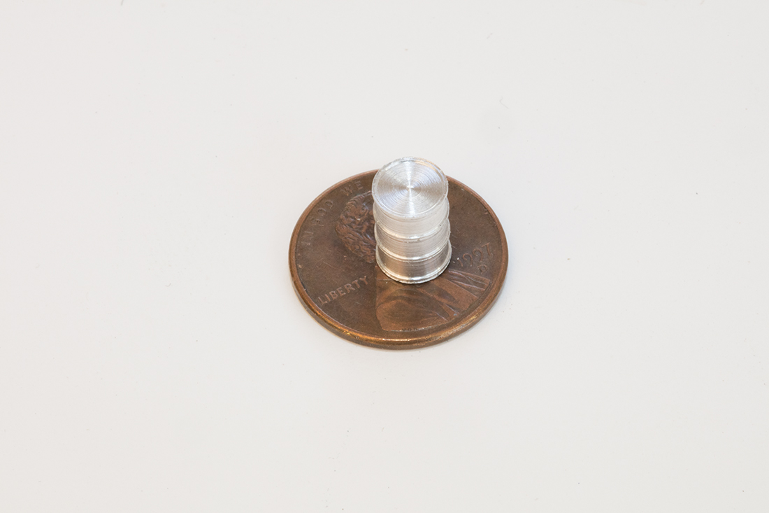

- Posts: 5068
Re: APA project
Fire Main
Oil drum for fantail, there are four.

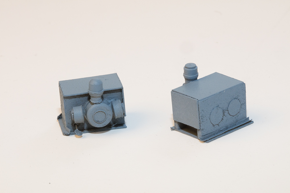

- Posts: 5068
Re: APA project
Thanks Hank, I found that today. Using the illustrations there I made two 4 tank generator units today. An interesting feature is the inclined track and an emergency release handle. Apparently they could be jettisoned overboard by pulling the handle.

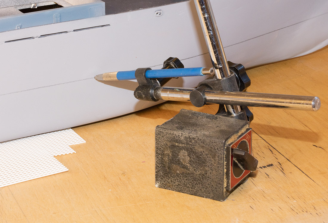

- Posts: 5068
Re: APA project
A very useful tool for scribing waterlines on the hull. Normally this tool can hold such measuring devices such as a dial indicator and attaches to any metal base with a strong magnet. Mechanical pencil works well as a scribe.
