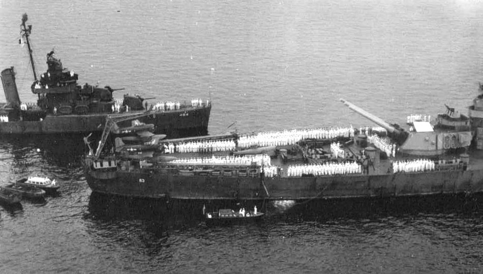

As Tracy said, Buchanan had no major overhaul or mod's after her mid-1944 overhaul. When she left Mare Island Navy Yard she was painted in a dazzle camo scheme (see photos attached). At some point before the surrender, likely in late 1944 to early 1945, she was repainted into Ms 21. DestroyerHistory.org (also the NHC website has many of these as well) has a series of Tokyo Bay photos of Buchanan although less than being perfect images, should show the changes, if any were made ...
http://www.destroyerhistory.org/benson- ... on484.html ... on a quick look, I don't notice any major differences. Other than that "D". :smallsmile:

The model of the 45 Buchanan is based on the 44 overhaul. There were no visiable changes other than paint that I was able to find from 44 to 45.
I still don't know what the big D on the top of the bridge was all about at Tokyo Bay. But it appears to be associated with the surrender signing. Possibly to identify Buc as the ship carrying the big dogs. So Dragon was nice enough to include a PE version so you could do a dio with the Missouri if you wanted.
So will we see a scene like this at next years Nats?

I'm working from memory, but I think that the Squadron Book on the Benson class mentions that the code square 'D' was for Buchanan to act as MacArthur's transfer vessel in Tokyo Bay.
