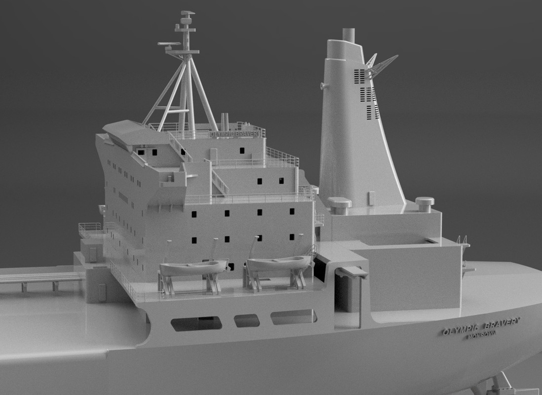

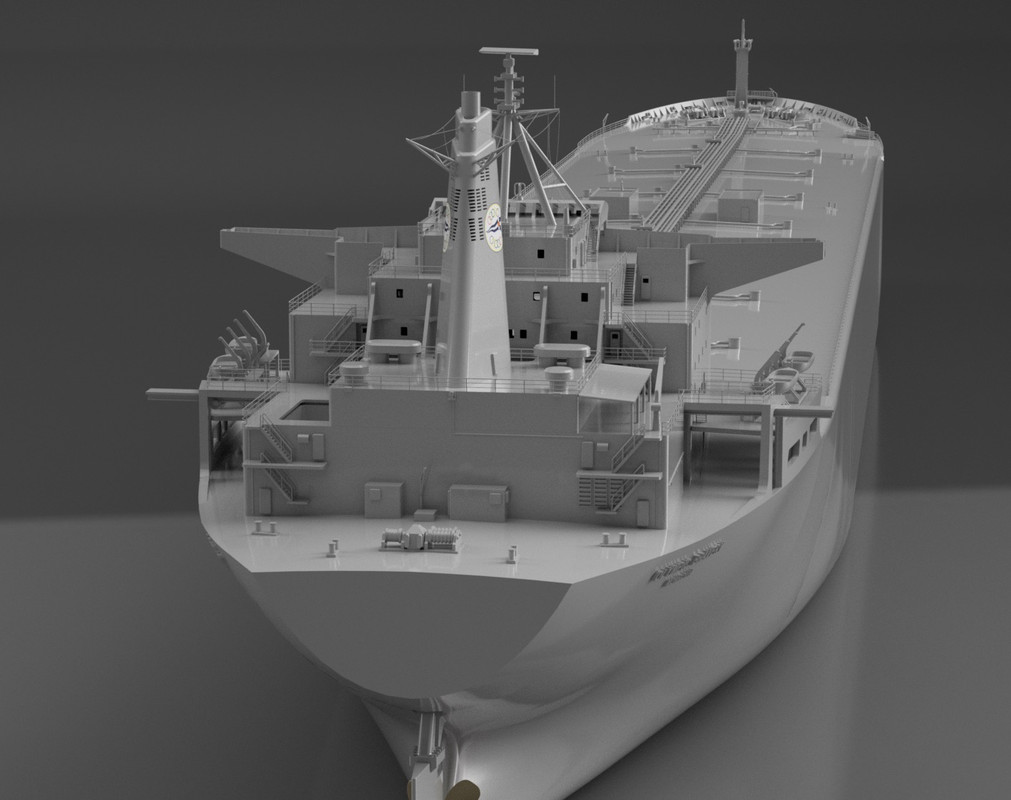

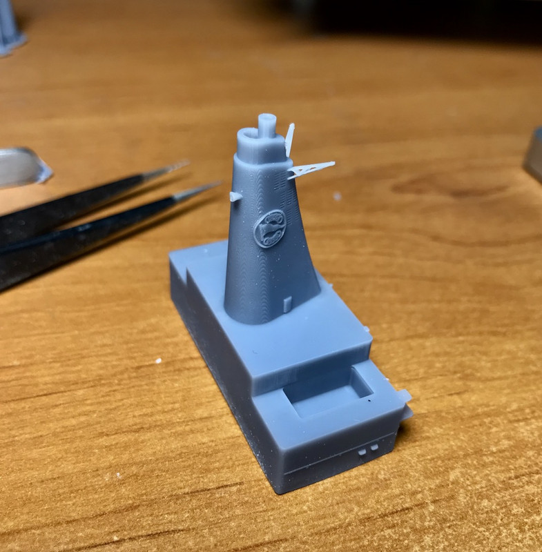

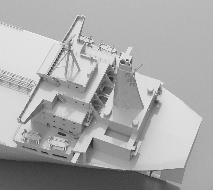

Some progress on the design of the chimney block (or Engine Trunk).
Pascal

Surprisingly I have been to all of the landmark tall buildings you display, though the one in Chicago was the "Sneer's" Tower back then. Buildings are like trees, being rooted in one place simplifies many things. Airplanes and ships and animals lead a more exciting life, if also more complex.
Looking at the extra bracing added to the aft of the superstructure, one realizes that the size of these ships races beyond the strength of materials and additional measures must be employed. With this great length the hull girder must have to handle tremendous bending moments. The shape of the stack/funnel etc is quite elegant and you have done a good job of capturing it!
Regards: Tom

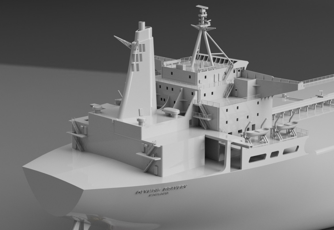

I continued to draw the stern. The pool is on the port side, on the opposite side there is a playground, often transformed into a bowling alley under the awning, with real sand.
Pascal

Pascal"
There is an interesting overhead rail that extends overboard on both sides. This leads into a "tunnel" between the two deck houses, is this for possible removal and replacement for large engine pieces and parts?
Tom
Iceman 29
Posts: 1945
Location: Bretagne, France
Re: Diorama Shipwreck tanker Olympic Bravery, 1976, France 1
Post by Iceman 29 »
Yes, Tom, it's an overhead crane, there's a double hatch in the center of this corridor, a small one and a large one. We use either one or the other depending on the size of the spare parts or supplies that the crane is carrying.
Doors lead to the lazarette and the cold storage rooms also in this corridor. This type of bridge crane is rather rare at the moment, a configuration with two hydraulic cranes, one on each side are rather preferred. It is much more flexible in use and there is nothing protruding along the edge.
Pascal

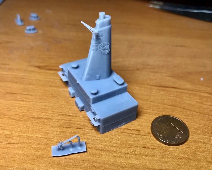

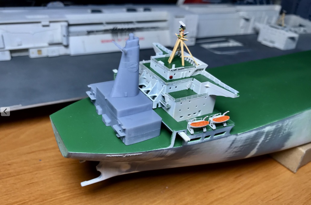

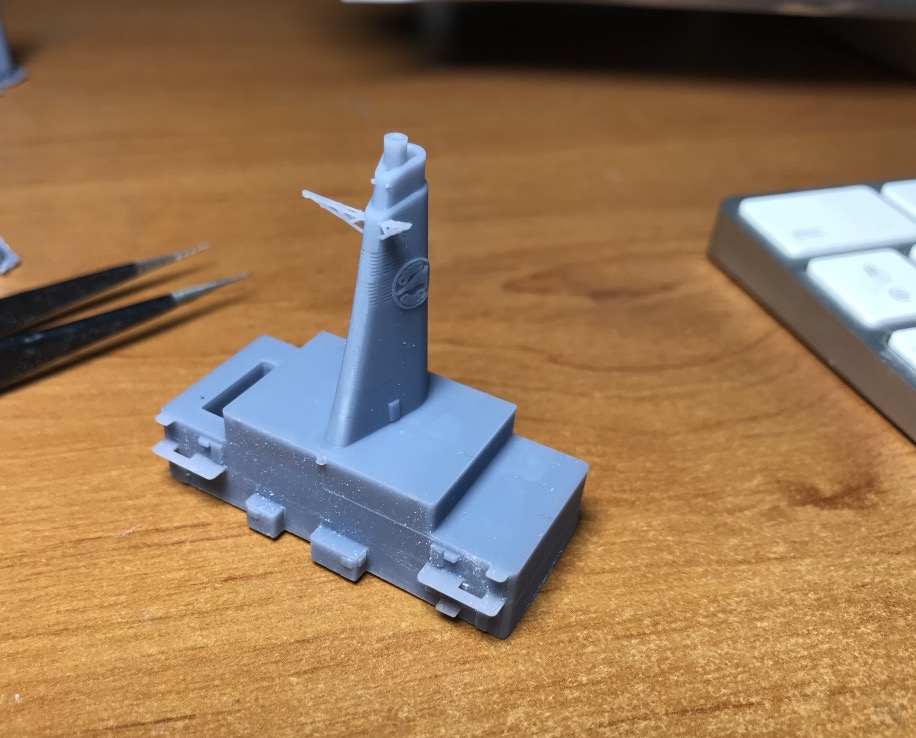

I printed the chimney block, a staircase landing on the left is missing, my fault, I'll glue a piece of plastic card, if I'm satisfied I'll leave it like that, if not I'll reprint it.
My drawing of the Olympic Maritime logo came out well.
Drawing of the railings and ventilation ducts of the pump room.
Pascal

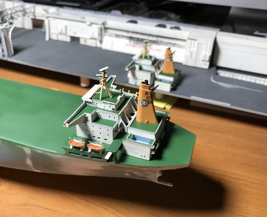

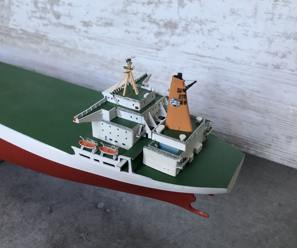

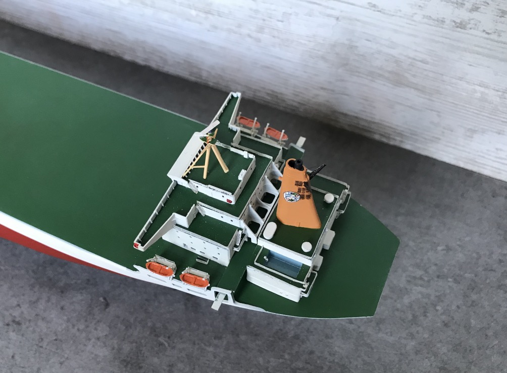

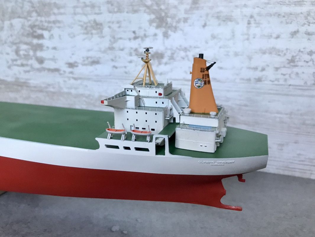

Some progress on the chimney block, it's not finished. The color of the chimney looks good, I had to mix it. A lot of masking done, as everything is airbrushed, including the pool. I have to put a swim ladder in there yet.
Olympic Maritime's chimney color:
Pascal

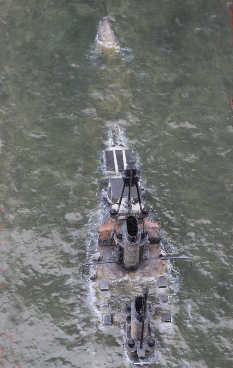

looking very good; ref the diorama...
allow only a bit of translucence in the water when viewed from above
here is my take on it...
link to my sunken Hindenburg at Scapa Flow
cheers
JIM B

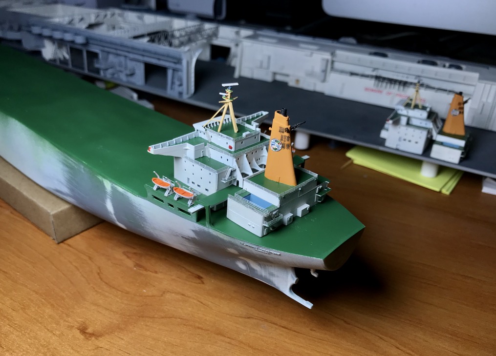

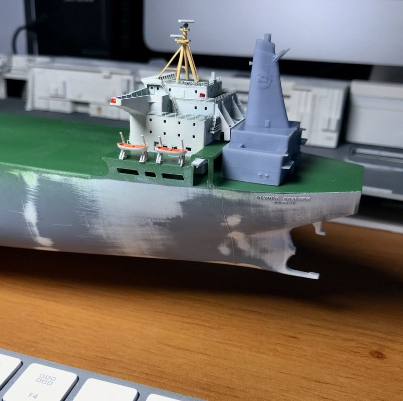

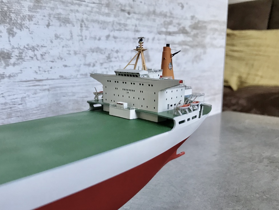

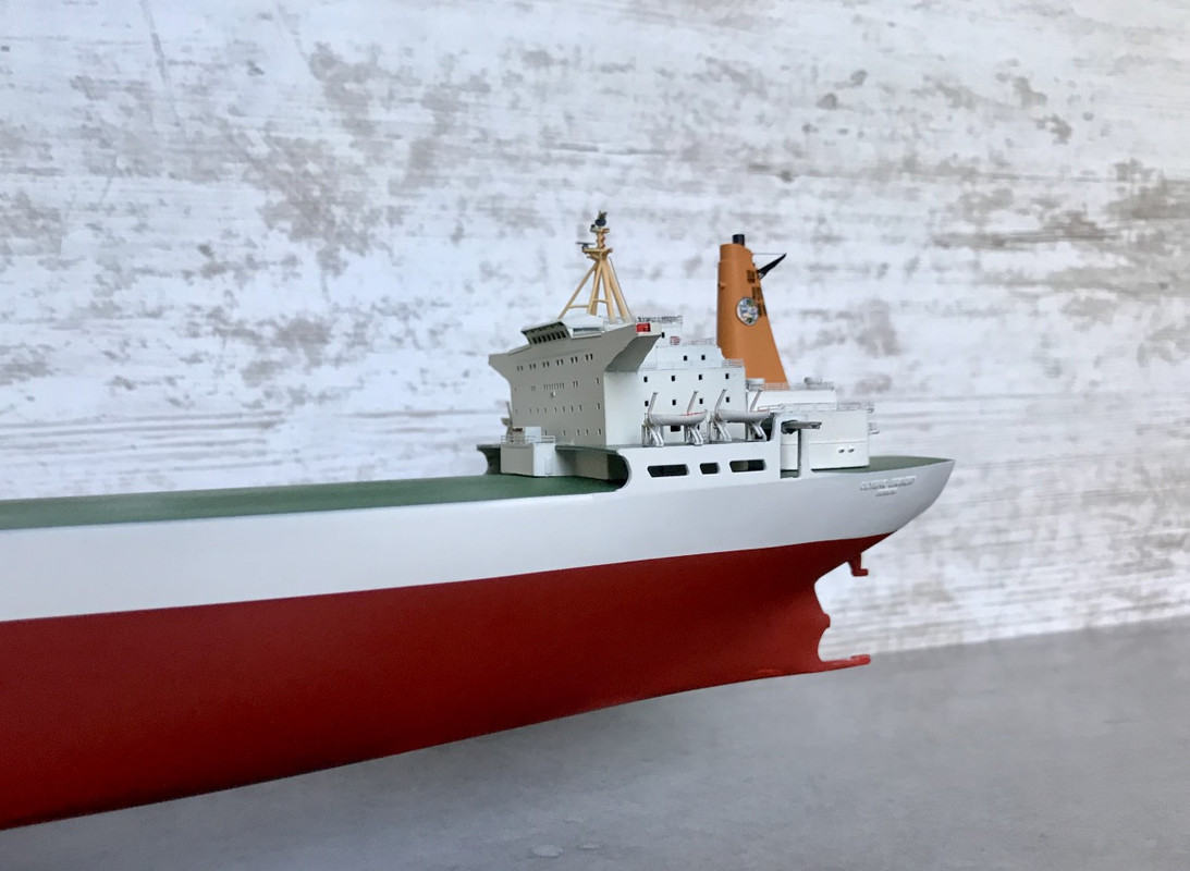

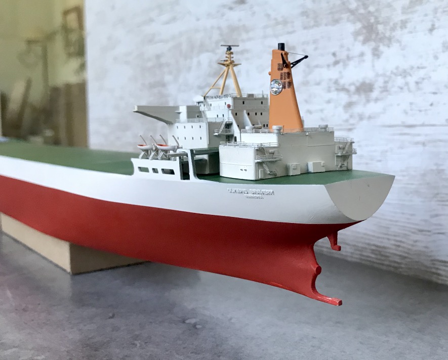

Some small progress on the engine casing and the paint. I have the low antifouling to apply yet.
I had to tinker with my new Humbrol pot color #60, it was not the same red as my old pot #60.. �
Pascal

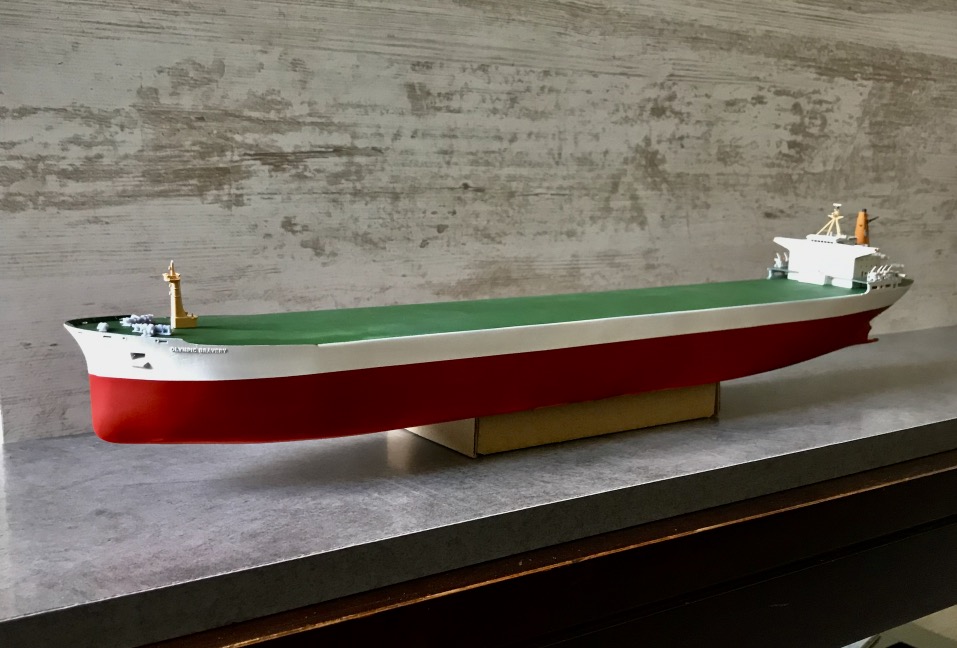

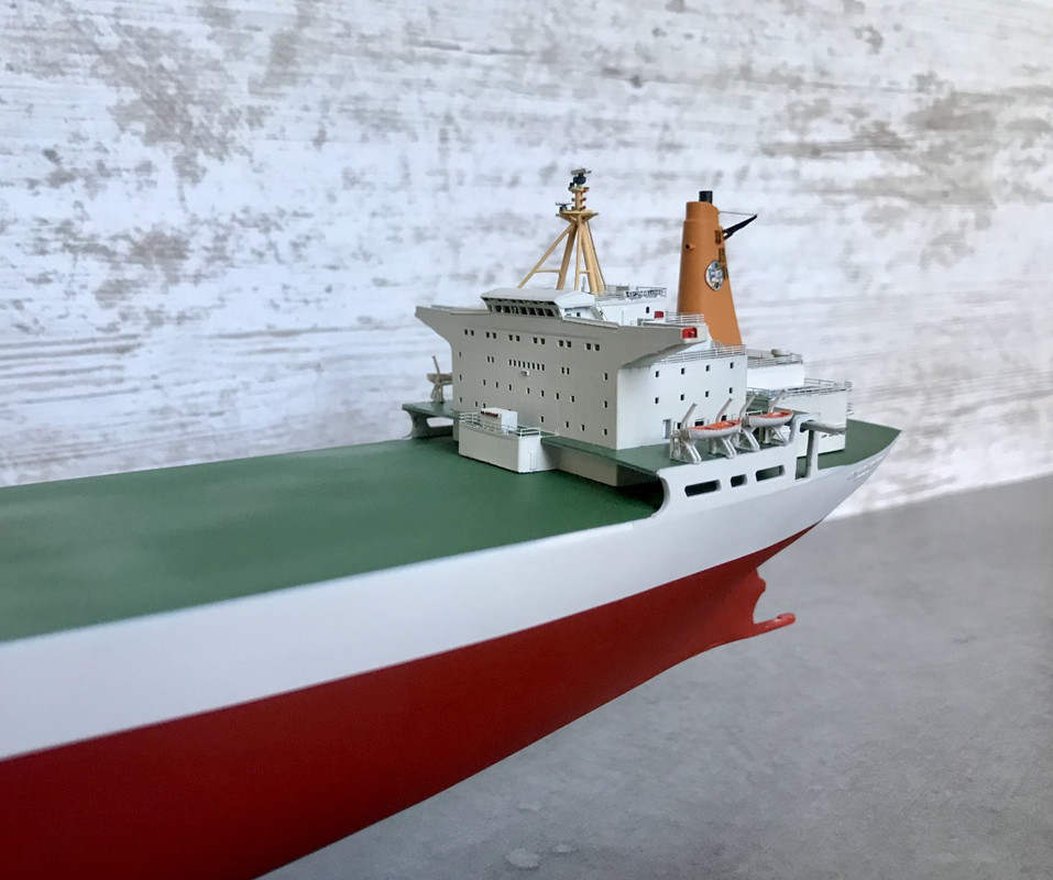

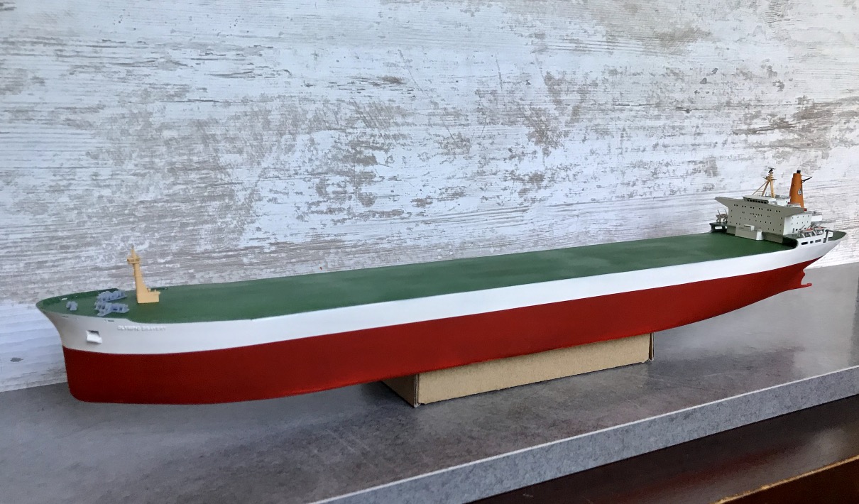

I have a lot of printed parts already, almost all of them, there are some test parts too, which is a lot to sort out.
I started to paint them, I chose N�9 Humbrol for the black of the deck gear, it's a dark anthracite grey that goes well, because it's less contrasted with the rest, always the story of lightening the tints with the size of the model. The pipes are almost ready, but I still want more details.
I also painted the second antifouling. Aero touch up to do on the bow at the waterline.
I still have the white stripes to paint on the hull that indicate where the tugs should push without distorting the plating.
Pascal
