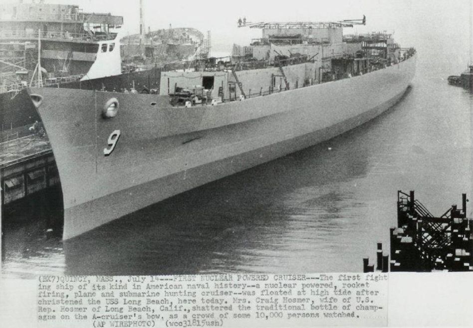

CliffyB had found part of this picture before, only the back half and wondered where the front half was. I just happened to run across the whole thing when I was searching for something other than Longbeach

Good one Mr. Holmes, pray tell where did you find it and was there anymore info?

Found it again! No, unfortunately they don't have anything especially interesting about her, but here is the link!Cliffy B wrote:Good one Mr. Holmes, pray tell where did you find it and was there anymore info?
http://warshippictures.webs.com/nuclear.htm

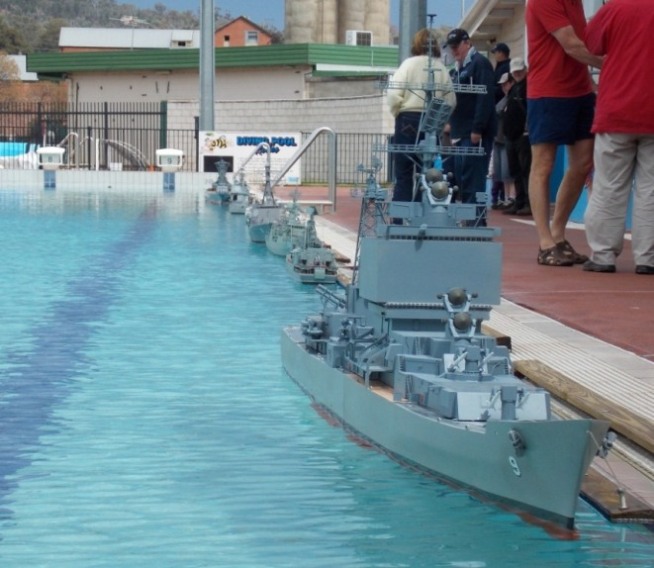

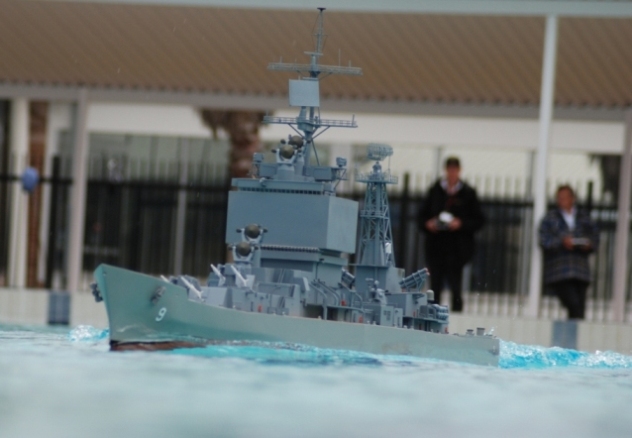

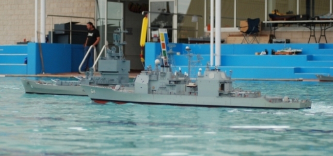

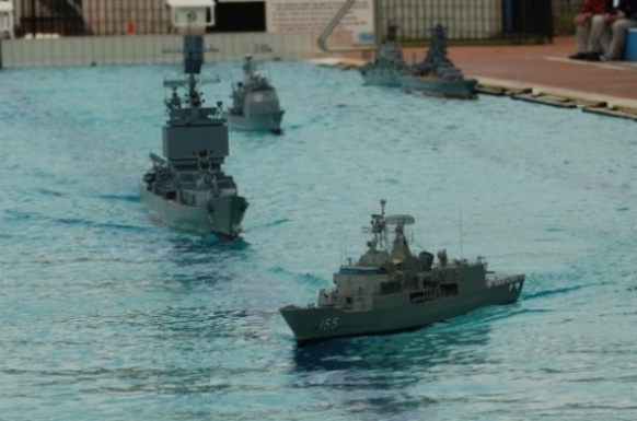

Meanwhile still operational (but with heaps of bits to be finished....)

Hi Guys,
HeavyCGN-9,
Now, that's some modeling! 1/72 is usually referred to as, "small scale modeling", until we're talking SHIPS!
I just got my 1/72 Skipjack today, and it's huge!
I can only imagine my 96 scale Long Beach at 25% larger!
I have a question, and I may have asked this before. When you decided on the sizer of your models props/screws, did you do your absolute best to determine the proper diameter? I have a copy of Loren Perry's 96 Long Beach plans, but I don't trust the props as they are a representation of props in the drawings moreso than an identical likeness; the opposite is true when referring to the rest of the plan drawings I must say. Loren leaves nothing to chance.
Keith Bender and I batted around the size of the screws/props and came up with 16'2" and 4-bladed. I was told by Lee Upshaw that CGN-9's screws were 4 bladed when he was under her in drydock; that was 1980. Soon afterward, Long Beach did have 5 bladed screws installed.
Would you mind showing the screws?
Thanks for sharing!
Tony
HeavyCGN-9,
Thanks for sharing!
Tony

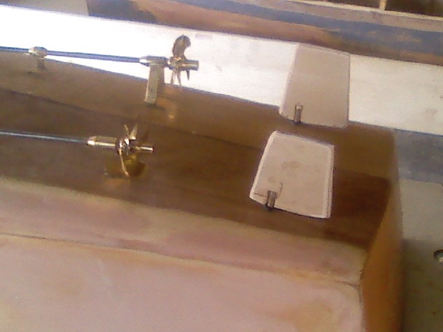

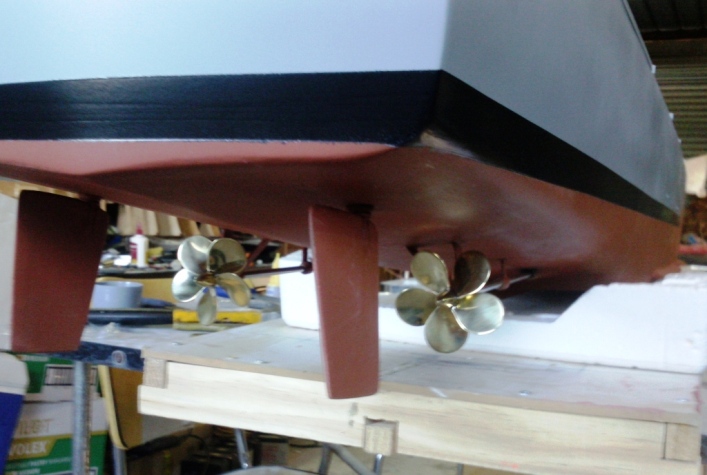

G'day Tony,
I was a bit slack and took a wild guess! I actually ordered a type 23 running set from George Sitek (before I realised he does custom work too...DOH!) and used everything except the small rudders!
The original set of props on my LB where 57mm Scimitar bladed type.....they lasted 15minutes as I forgot to loctite the props and lost one doing an emergency stop
After that disaster I got a set of Raboesch 55mm Mtype props which I had on there till November last year when I refitted her with a new set of Sitek props these are Mtype 57mm with the way I set up the A-frames I cannot go any bigger as there is not enough clearance! But with the amount of power N' torque the Graupner 900's have its not a problem
Here is a pic of her current props when they went on last year.

Hi Guys,
Hi Bruce,
Thanks for sharing. I have studied Long Beach more than some ships and less than some others. I have read the DANFS report but did not commit to memory; impossible!
I have copied BuShips plans in 1/96 scale that were dated 1959. These drawings showed the Polaris missile launch tube placement; FYI. I don't have the FDD plans, so I can't say with any certainty if they differ from Loren Perry's drawings. The Loren Perry plan drawings would be given some credibility simply because of the source; FWIW. I'll study LP's drawings in the area you've mentioned to see if the accuracy is off; same for the BuShips 1959 prospective deck plan drawings.
Thanks very much, Tony
Hi Bruce,

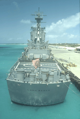

Here is a pic or 2 of the area I was talking about (and some other nice ones I have come across recently)....and I just noticed I've missed a smaller vent too! Oh well time to get out the hammer....
