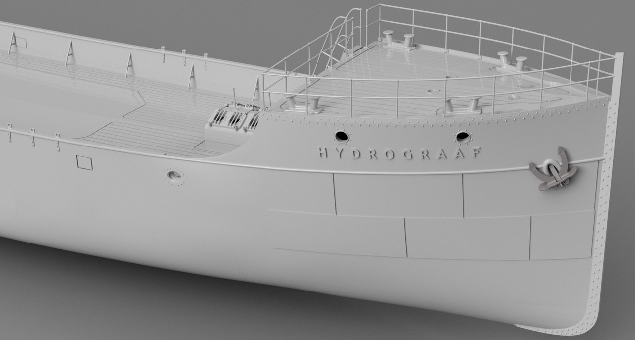

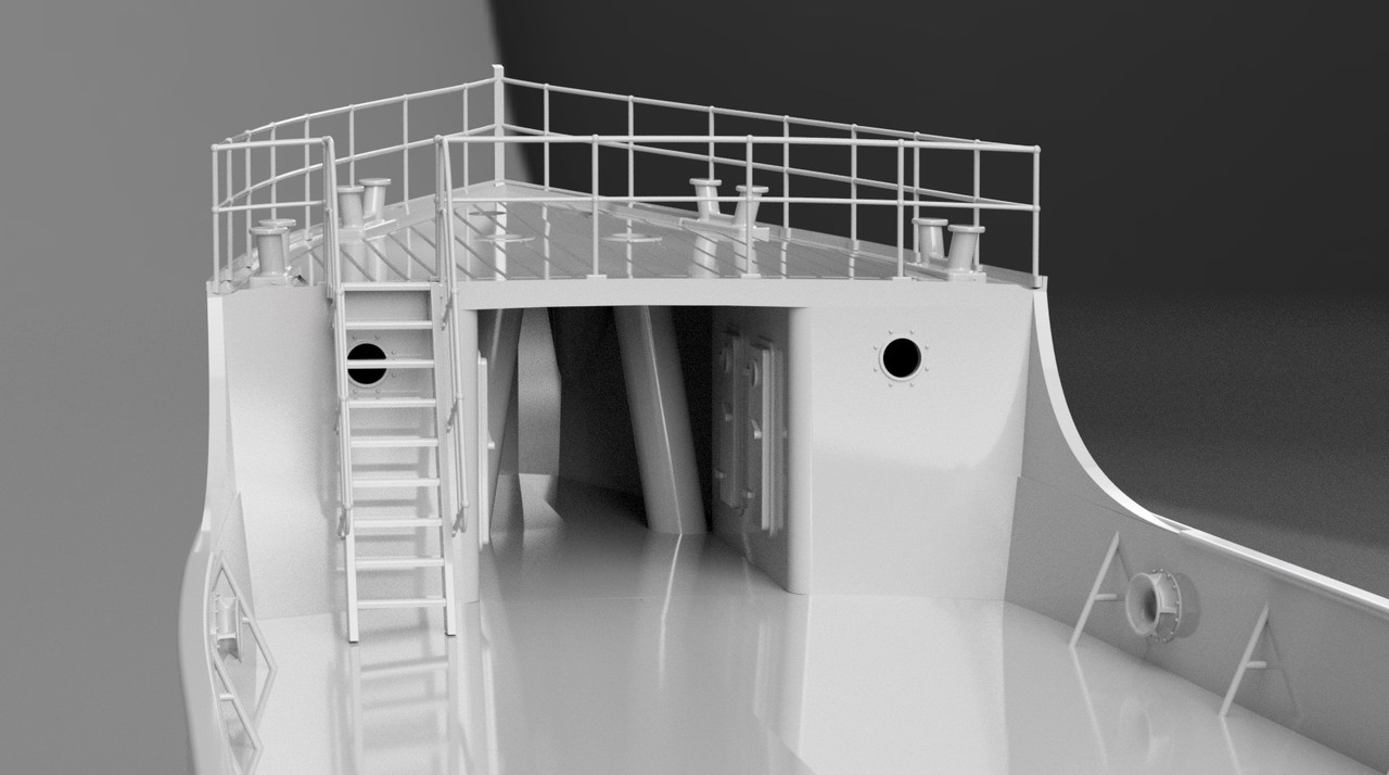

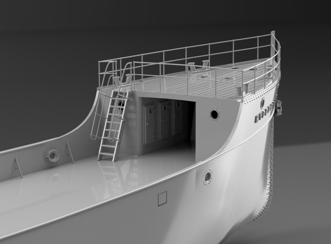

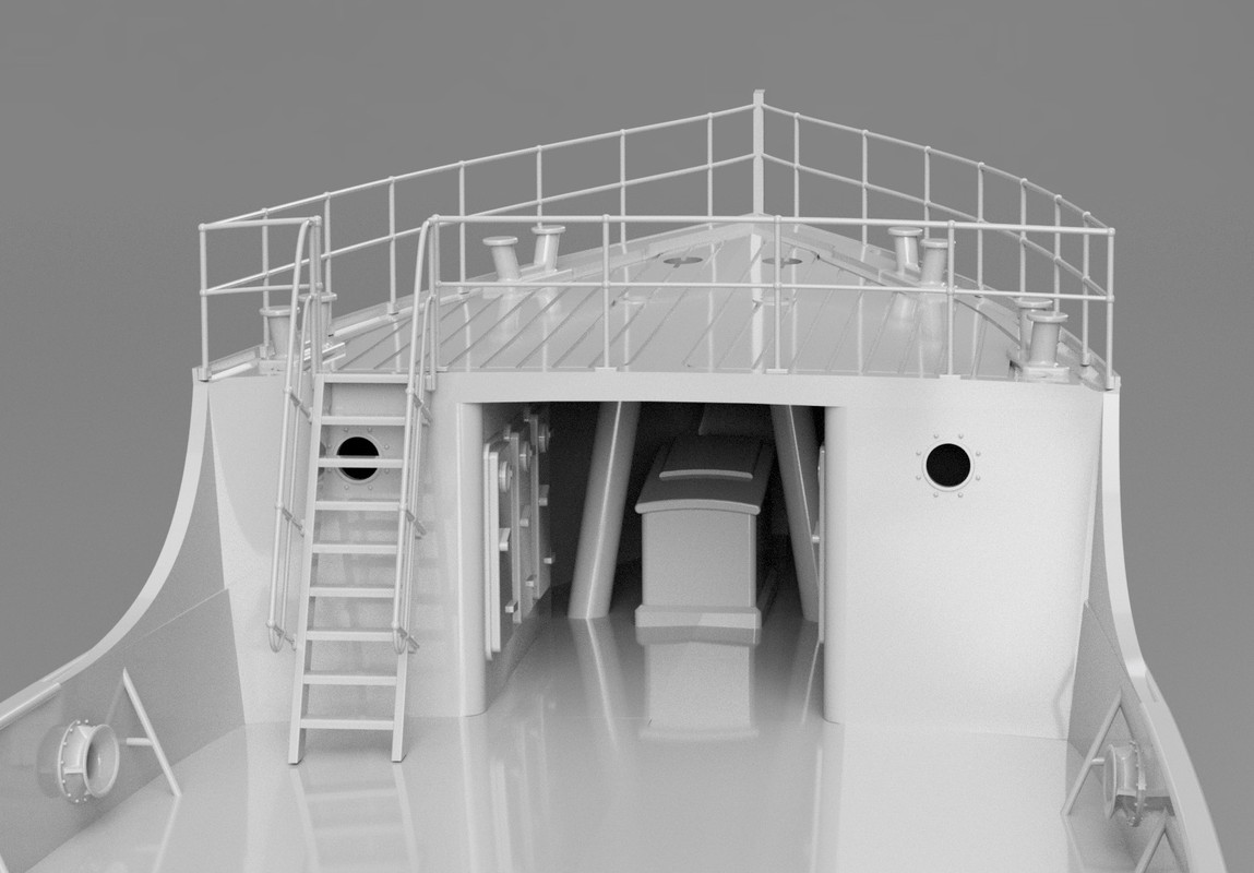

I fitted the missing railing, the stairs to the forecastle, the descent to the lower deck under the forecastle.
Pascal

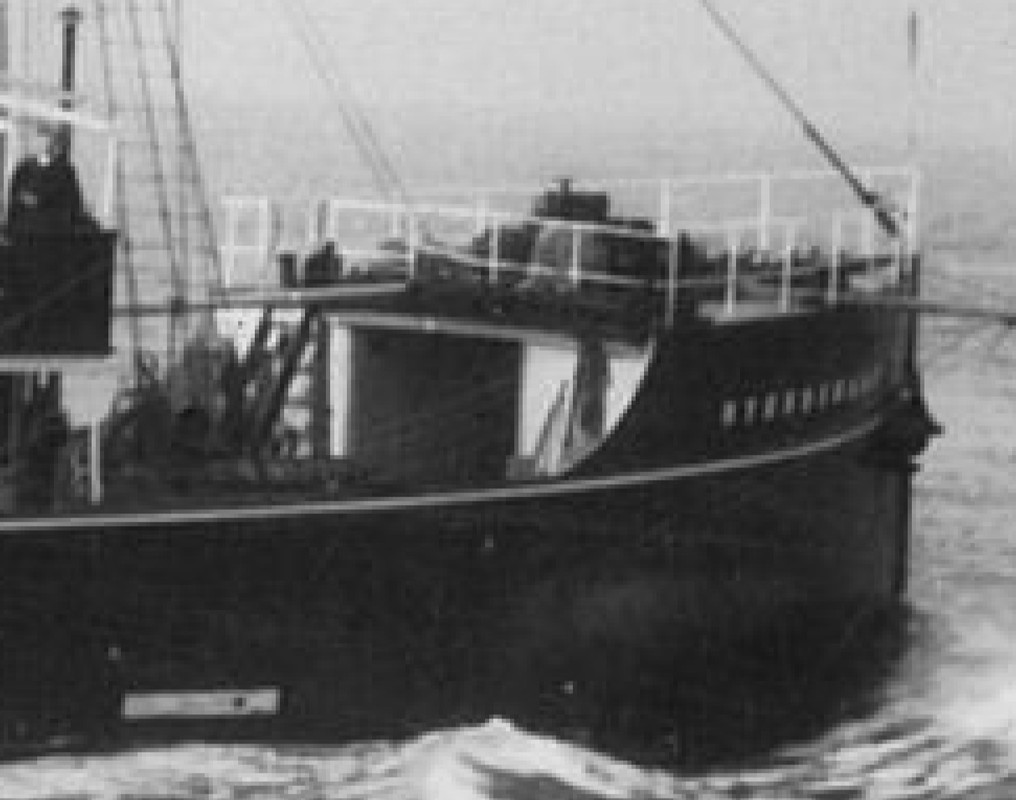

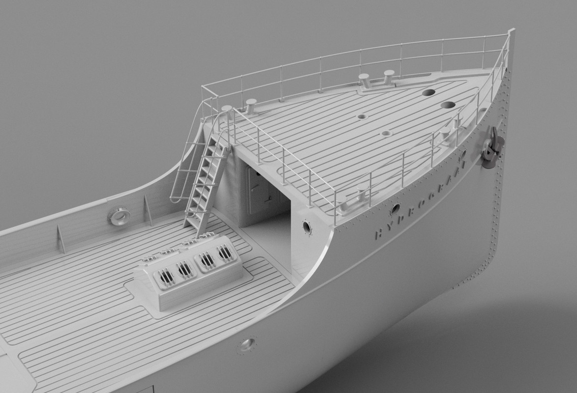

End of the skylight drawing, add some details of the bulwark. Starting to draw the hull plates, quite time consuming.
Thanks to a friend for this nice picture of the front clerestory, it allowed me to refine it.
Pascal

Lovely detailed skylight! And I notice that in the current situation the forecastle deck has been extended backward nowadays? Plus the obvious wooden bulkhead with two doors just forward of the skylight.

That's right Maarten. Thank.

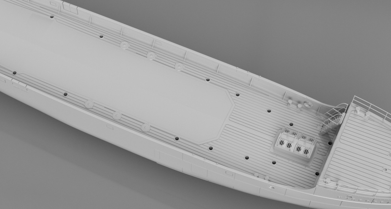

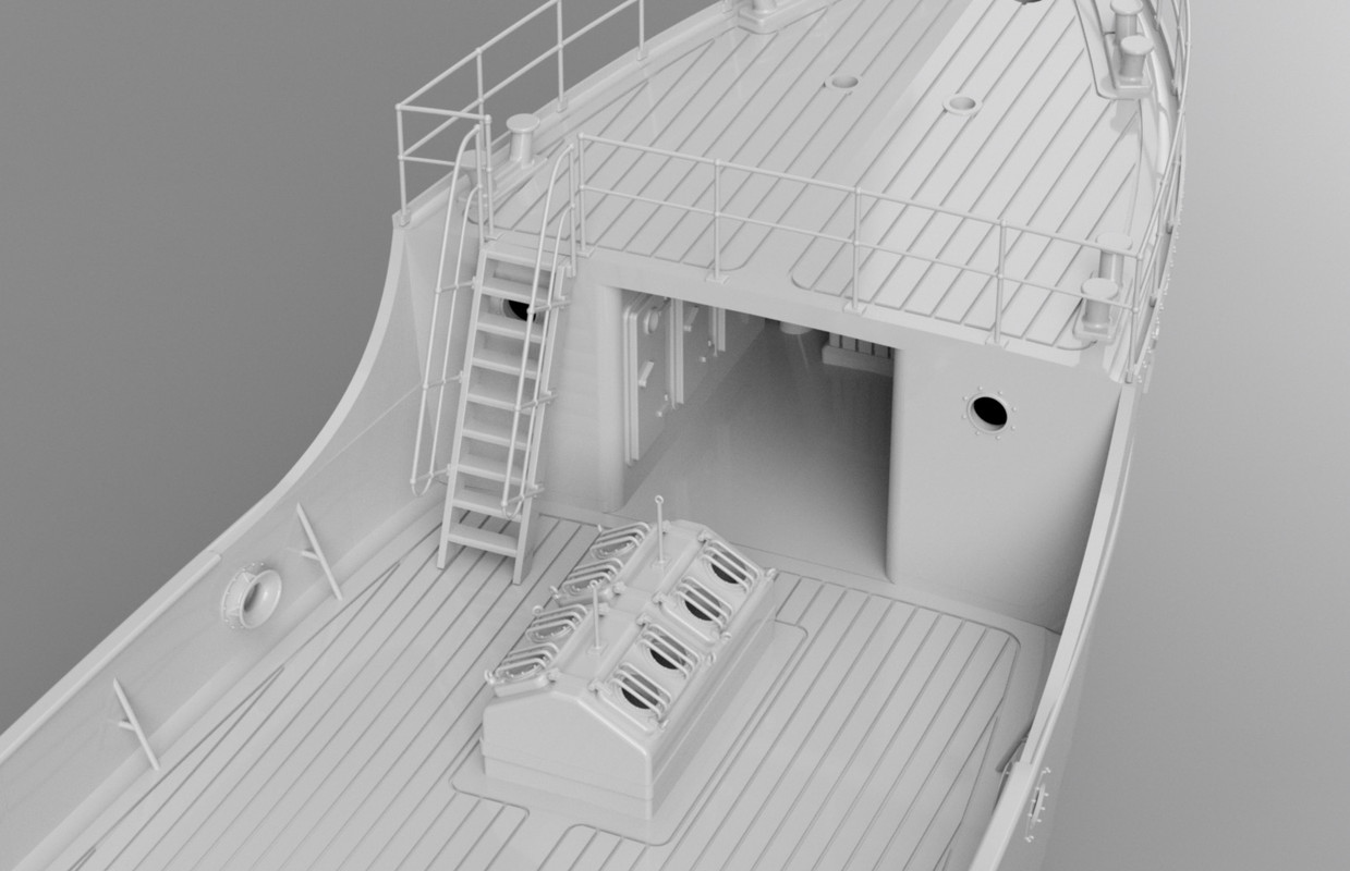

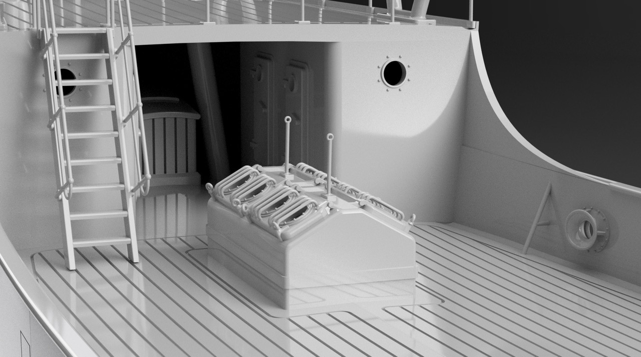

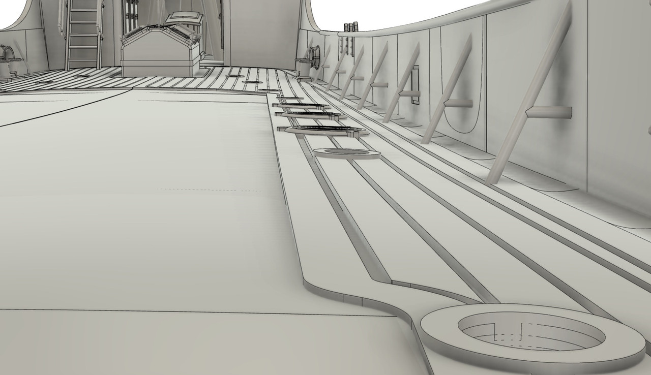

I continued today to draw the planking, the deck portholes, the coal bunker filler hatches.
Pascal
Maarten Sch�nfeld
Posts: 1846
Re: SS Hydrograaf, 1/100 3D, hydrographic ship, Royal Dutch
Post by Maarten Sch�nfeld »
Hi Pascal,
You're going nice! :wave_1: But are these deck details not a little too prominent? I'm afraid your vitual crew will trip over them and break their virtual neck! :big_grin: I would make them almost flush with the deck.
Last edited by Maarten Sch�nfeld on Tue Aug 31, 2021 1:26 am, edited 1 time in total.
Roger Whittaker +9/13/2023
wefalck
Posts: 2150
Location: Paris
Post by wefalck »
Maarten is right, as nicely done as they are, the coal scuttles etc. should be flush with the deck, as seen also on the photographs.
Not sure, how it is done on the prototype, but a typical solution is to frame the deck-planking with L-irons (as on the forecastle), which then forms a gutter together with another L-iron that runs inside of the bulwark. The gutter thus formed then is shaped with a cement mixture into a trough - the idea is to prevent water from accumulating in the corners of the L-profiles. The stanchions for the bulwark would also be standing in these gutters, rather than on the planked deck. The reason is that that fitting the planks around the stanchions and sealing the perforations against rot would be difficult. I would check this my assumption against prototype photographs, of course.

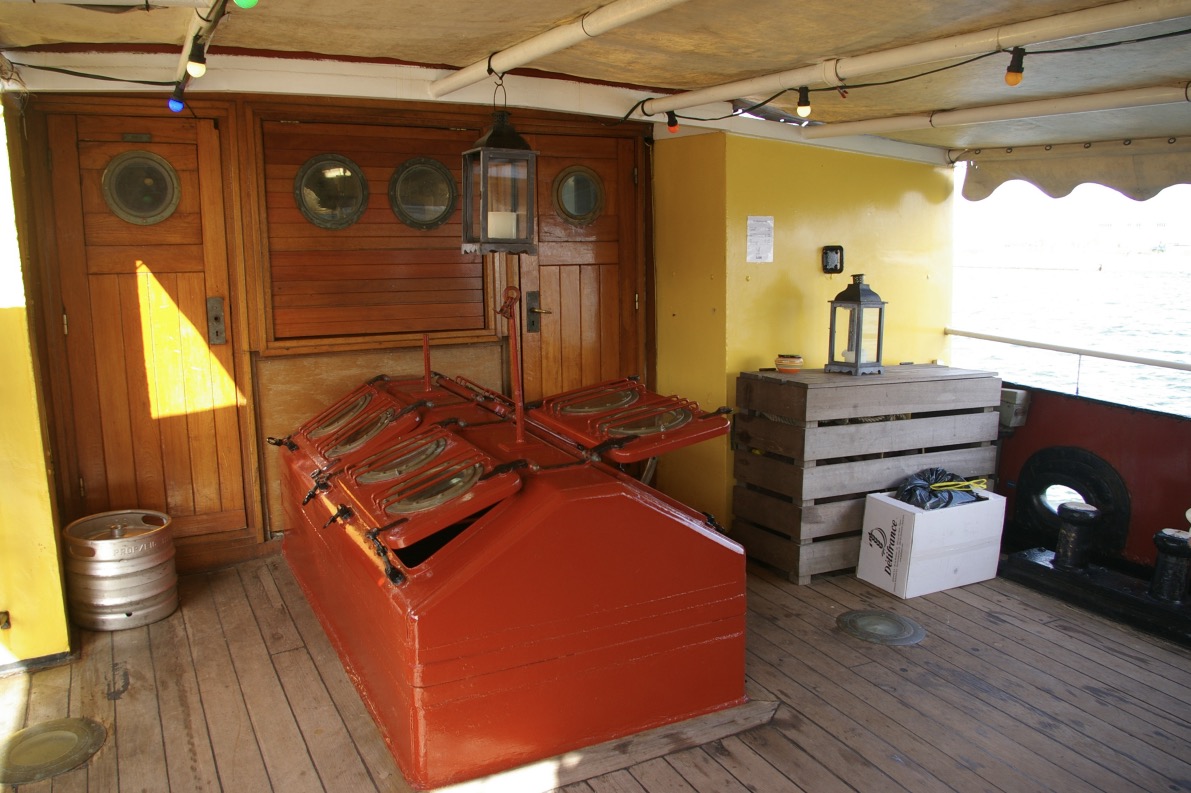

wefalck wrote:... Not sure, how it is done on the prototype, but a typical solution is to frame the deck-planking with L-irons (as on the forecastle), which then forms a gutter together with another L-iron that runs inside of the bulwark. The gutter thus formed then is shaped with a cement mixture into a trough - the idea is to prevent water from accumulating in the corners of the L-profiles. The stanchions for the bulwark would also be standing in these gutters, rather than on the planked deck. The reason is that that fitting the planks around the stanchions and sealing the perforations against rot would be difficult. I would check this my assumption against prototype photographs, of course...
Yes indeed, a clipping from an earlier posting shows these gutters on Hydrograaf were exactly as Wefalck describes:

@Maarten
The extra thickness is deliberate, because you always have to think about the paint and how you are going to paint these details easily. So I left 0,15 mm to make it easier.
You can see the gutter on the sides in this view.
The extra thickness won't show up at this scale, I'm not even sure it will show up in the print.
Pascal

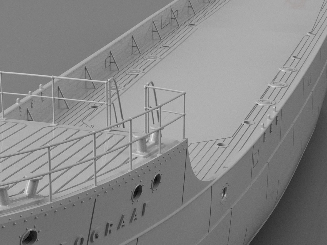

Iceman 29
Posts: 1952
Location: Bretagne, France
Post by Iceman 29 »

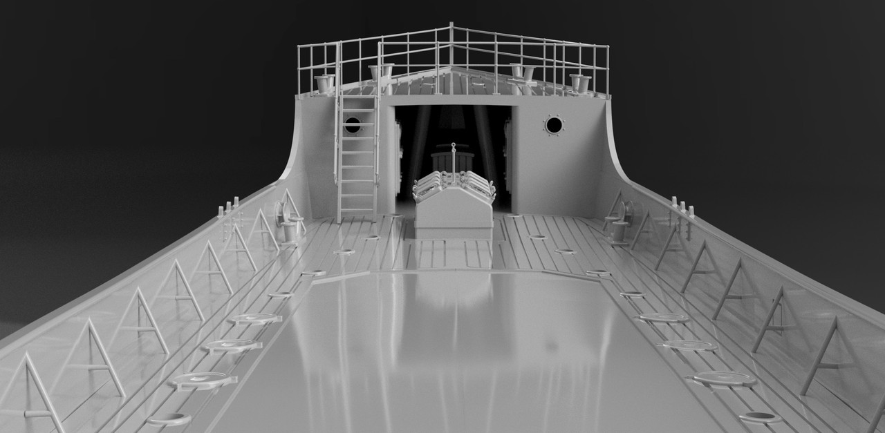

Replaced the legs in the gutter. :cool_2:
Overview.
Pascal

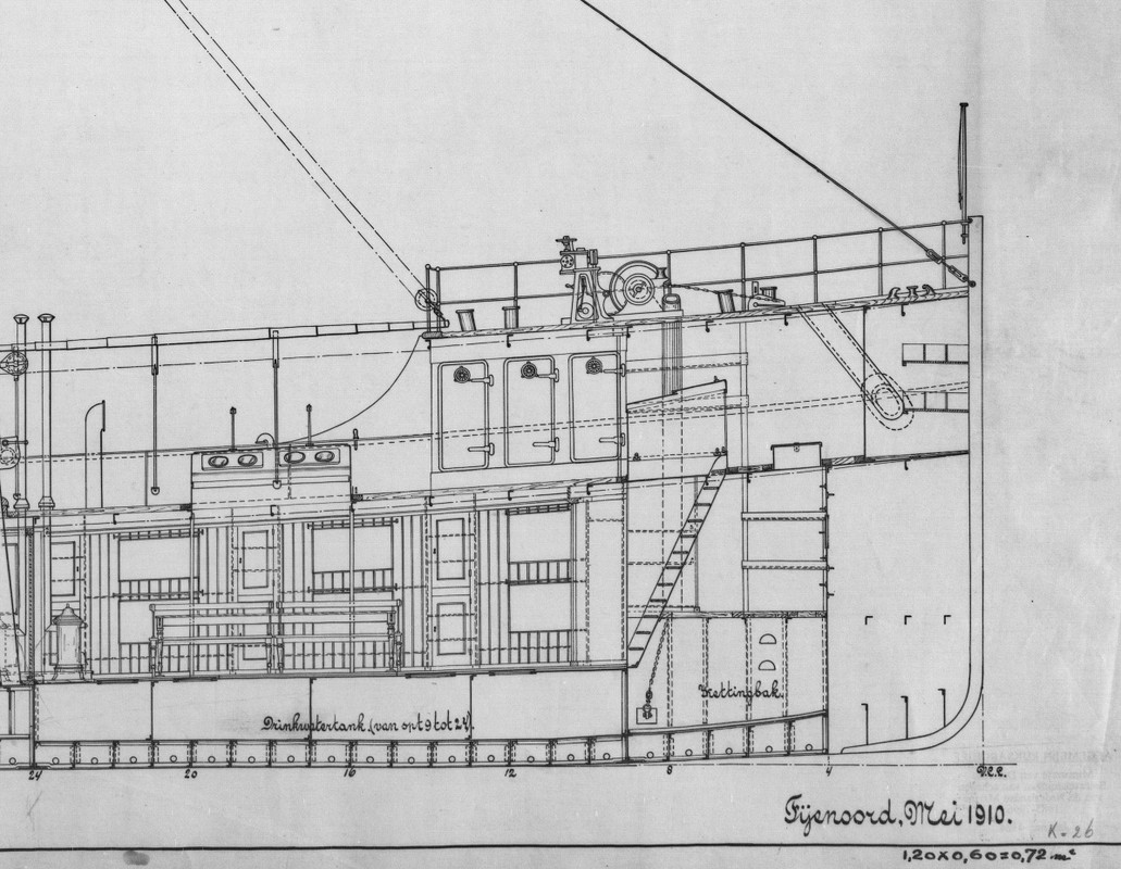

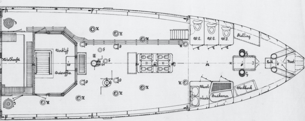

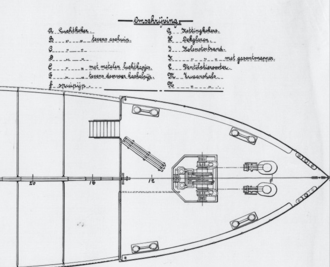

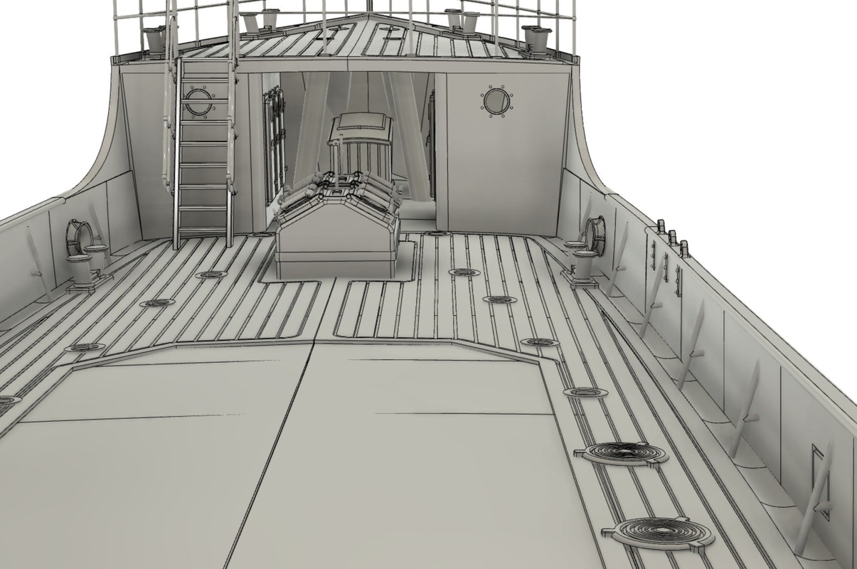

Drawing of the pipes on the deck, probably of the steam pipes for the windlass, and the skylight in front of the castle.
Various modifications. And I continued the drawing of the hull plates.
Pascal
wefalck
Posts: 2150
Location: Paris
Post by wefalck »
Strange pipes. Normally, there would be one (insulated !) pipe to the windlass. This pipe should have a diameter of about 5 cm without insulation, I would guess.
Perhaps these are modern hydraulic pipes supplied from a central pump. Still strange, as an electric motor would be more convenient than a hydraulic one.
Eberhard
Image Image Image Image
Iceman 29
Posts: 1952
Post by Iceman 29 »

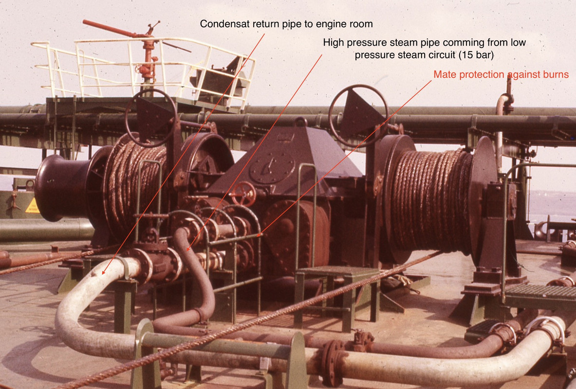

No hydraulic oil system at the time (1910).
Only steam or men's arms.
I worked on steam winches in the 1970s when there were still turbine on supertankers ( ULCC / VLCC) . The winches and windlasses still worked with steam. On deck the pipes were not always insulated especially the condensate return pipe to the boilers aft.
The problem with the insulation outside and especially at the forward of the ship is the sea breeze in bad weather and rain. The insulation remains wet and corrodes the pipes quickly, they are only hot when the winches are used of course, so rarely.
There is not one but two pipes at least, one that brings the live steam to often 15 bar, and a condensate pipe that brings the condensed or semi condensed steam back to the boilers. Sometimes there was a third, smaller pipe which allowed the steam engine and steam line to be heated so as not to damage the special Monel spiral wound joints. The condensate pipe is always of larger cross-section.
On this picture taken in 1976, you can't see any insulation on the pipes, this ship is new. We can see protection for the mate against burns.
Pascal

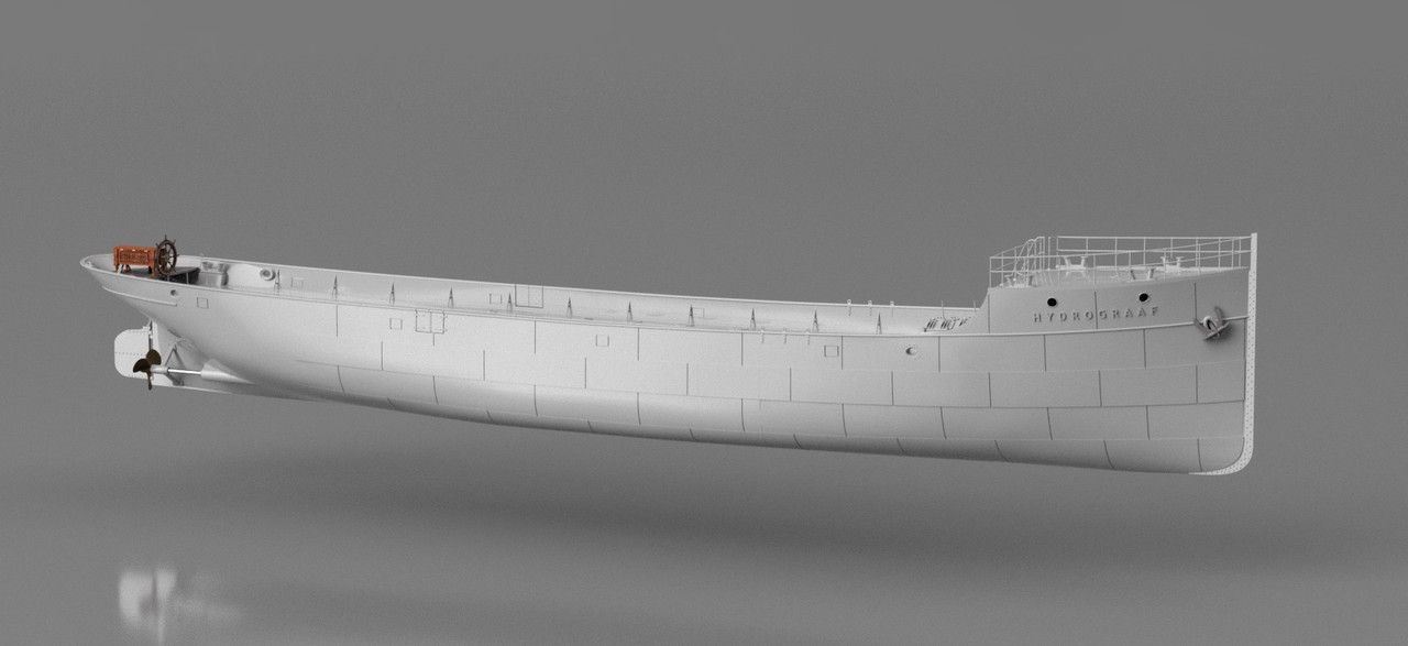

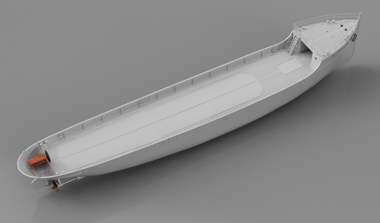

It's almost done for the hull to the main deck, Tom. The first part, the superstructures will be the second.
Many of the small parts on the drawing are ready to be printed.

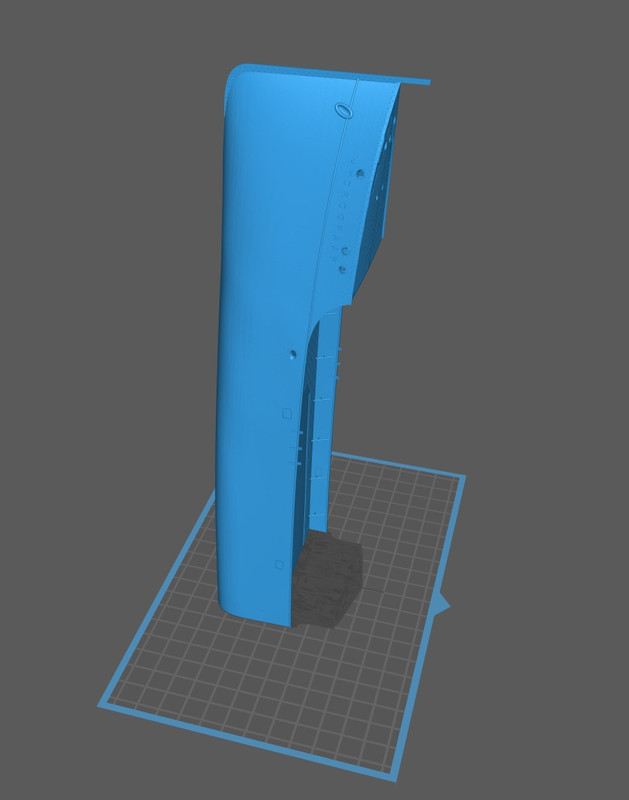

I'm waiting for the hull to be finished so I can hollow it out and cut it into two 20 cm long pieces. I've done a test already but I didn't print it, the hull without support for the moment:
You have to take your time and check everything again before printing the big elements, a mistake is always possible leading to a loss of time, precious printing hours for the printer, and wasted resin.
Pascal

I didn't realise that the pipes were in the drawing, I thought they were based on the photographs of the ship in preservation, hence the idea of hydraulic pipes - hydraulics in principle existed in 1910, but not for exposed parts, such as winches. I think hydraulic steering gears were invented before the turn of the century, but I may be mistaken.
Eberhard
