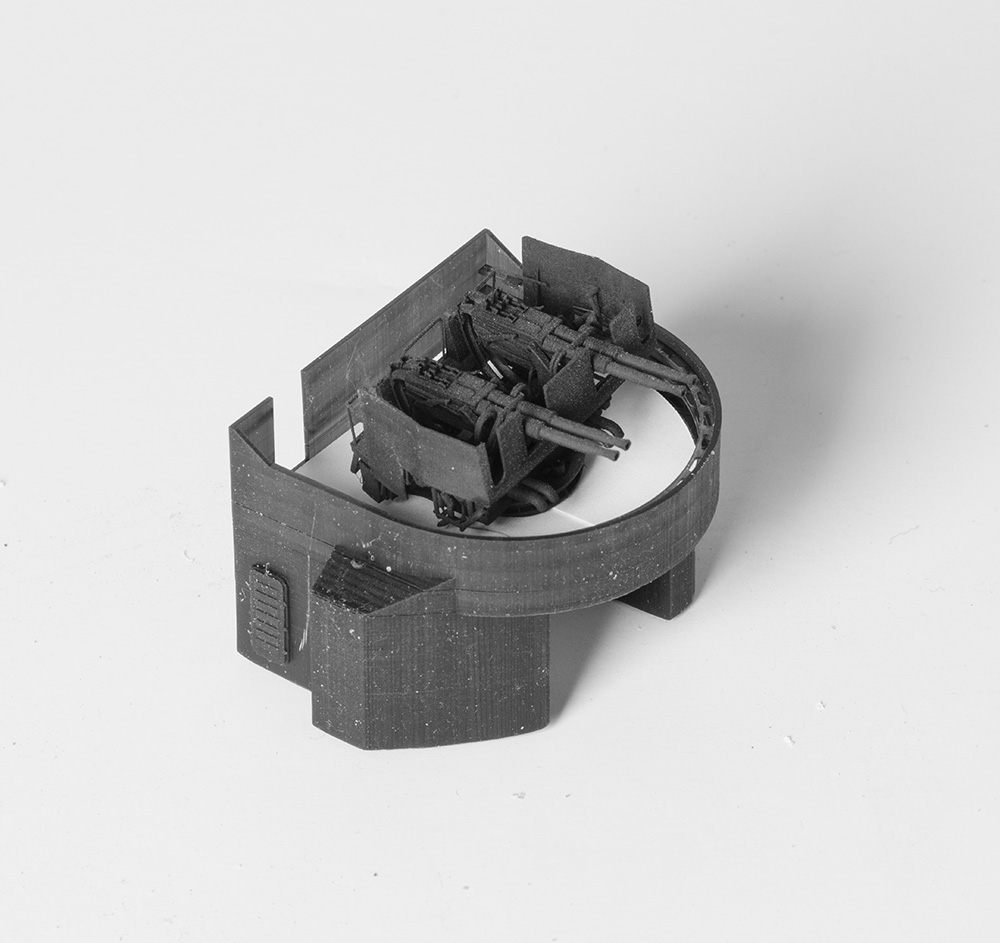

Aft deckhouse with 40 Quad tub and mount. I printed this open without the deck for printing reasons. The deck, is cut seperatly on my stencil cutting machine (very accurate) from Strathmore Bristol Board (A historical favorite with Model RR types).
Slowly adding bits and pieces about the superstructure. Possibly an endless process.

Did the quad 40s really have the shields? On small combatants (destroyers and light cruisers) the shields were omitted, possibly to reduce topside weight.

Phil:
Yes the 40's had the shields. For a small 12 knot ship, 8 40's and 8 20 mm Orlikons (with the latest MK 14 sights) was a fairly decent close in AA armament. This were suggestive that these were considered valuable in support of the beach head. Despite the minor superstructure above the O1 level, one would guess that stability would not be an issue.

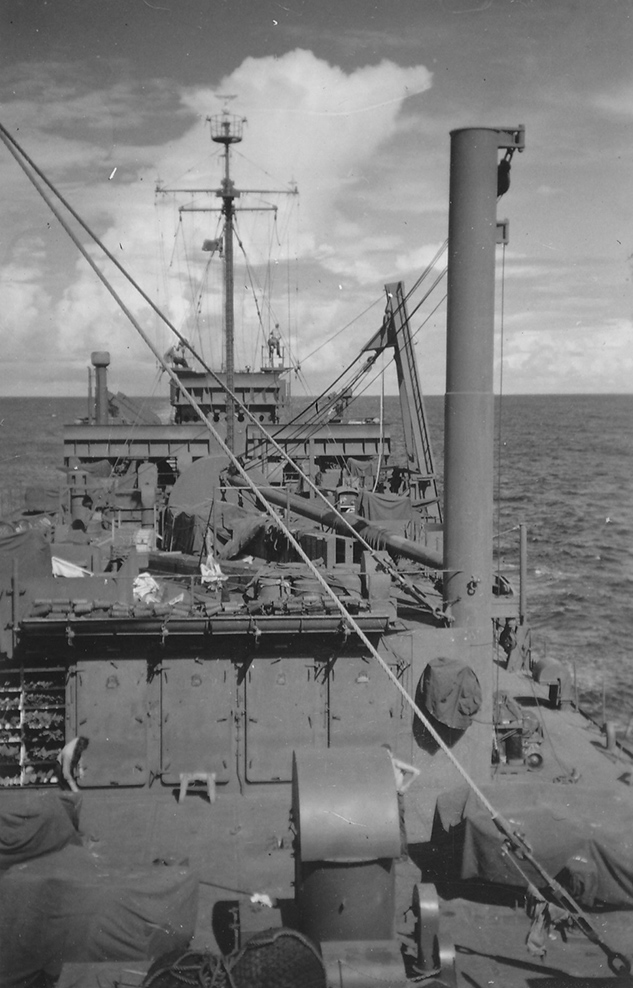

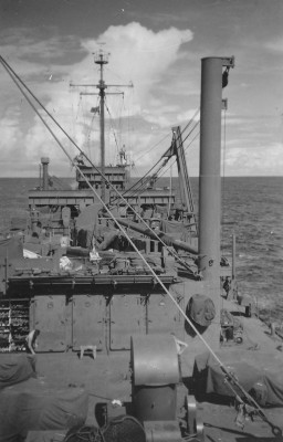

One of the better, more detailed photos from Navsource. I like photos like this, showing a lot of small detail which I can attempt to replicate. These material lockers forward held a treasure trove of repair materials to build whatever you wanted!
- ARL from bow.jpg (48.66 KiB) Viewed 1091 times

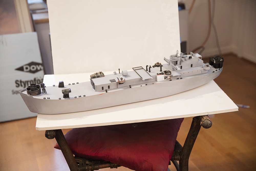

On topic: Yesterday I added the hull side ribbing. First to turn the hull upside down and scribe the location lines. As the hull bottom is not parallel to the base line the inversion is necessary. I use a heavy magnetic block with two adjustable arms and a holder for an instrument. What I used to scribe was a #11 Xacto blade.
For the ribbing i used a material called "Wildfire" by Beadalon, a synthetic woven .15mm beaders stringing cord, non fuzzy and non stretchy. Beginning at the stern I anchored with CA and strung along the scribed line, adding tape and spots of CA for anchoring to the point at the bow where the ribs kink. Then misted with Krylon flat and let dry, then a coat of auto primer.

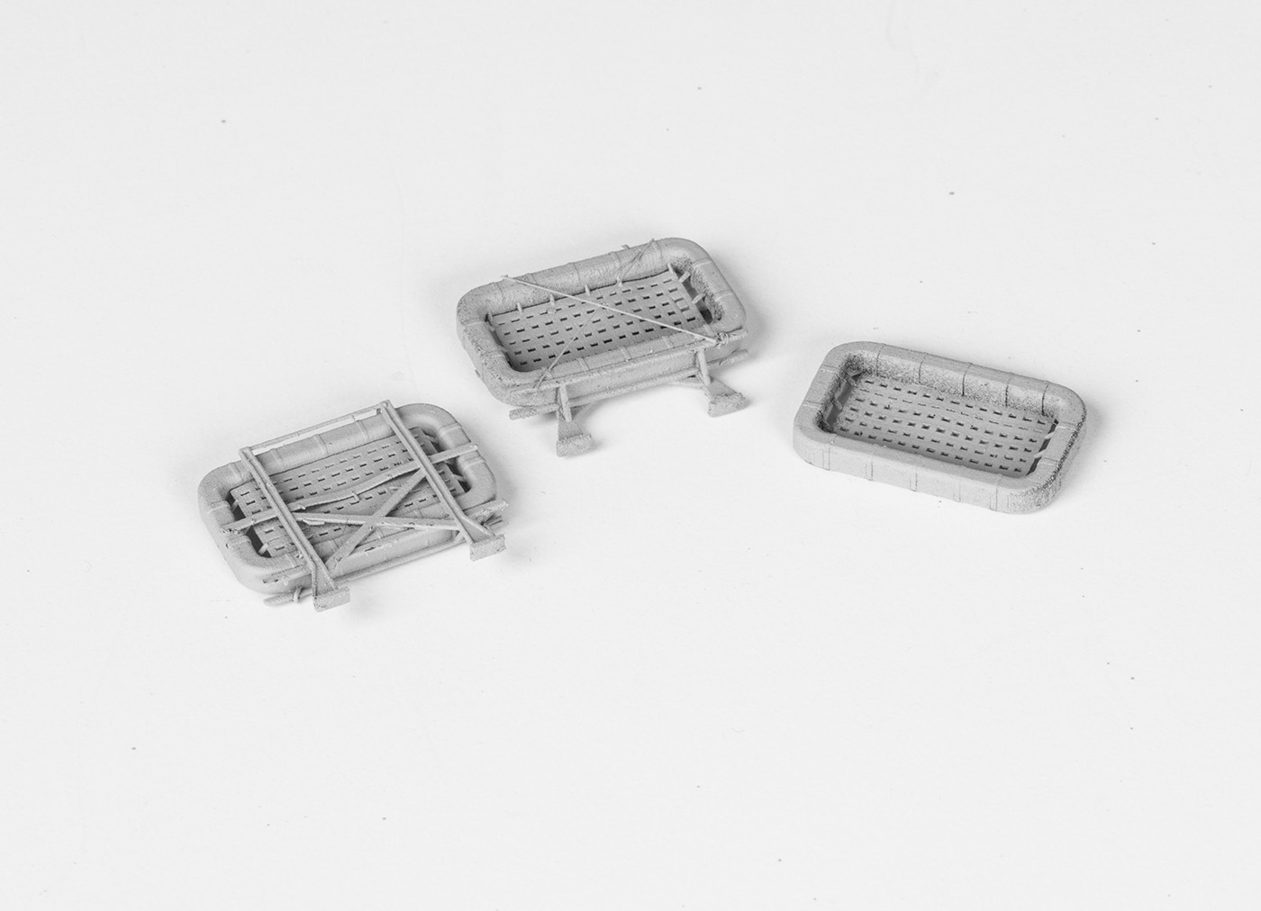

Printed some more Carley floats of a new design, some with frames, some without. Also the Stern Anchor with frame, modified from the design I used for the LSM. Rudders, skegs, props, prop guards etc, not to say fwd anchors etc to go on the hull. For some reason the "Spelchequr" doesn't recognize "Skeg".
Tom

Printed more Carley Floats and the outboard A frame derrick winch. I have a decent side view of this winch in one of my dad's photos and the base size on the Sphinx drawings. Looking at this as a first effort with hopefully, as happens, more information will come to light. Suspicious of the size on the Sphinx drawings as it's just shown as a rectangle with a Gypsy Head. There is another large winch associated with the A frame which I have not yet divined the exact configuration. Similar but not the same as the starboard side winch?
Many of the ARL's had Carley floats along the main deck rail in the same manner as the LST's on a vertical frame. I printed a number of these and they are cute little devils, but not satisfied that Poseidon had any of these. Her rafts apparently to be on inclined frames between the superstructure and the main deck. Here I am peering at 76 year old small original photos with magnification to try to discern configurations.

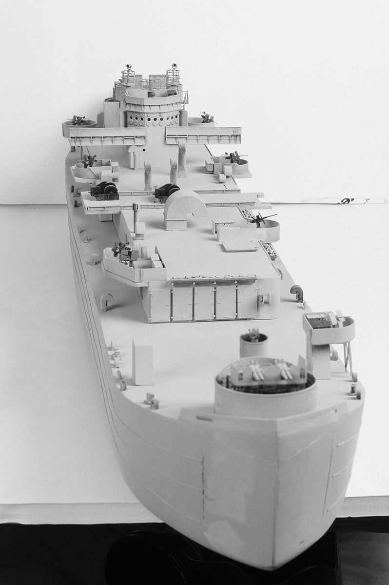

Bow view ARL 12 current progress. Note the rub strips on the sides of the hull.
Tom
Tom
- Posts: 5068
Re: ARL 12 USS Poseidon
Showing rafts with frame and bare as well as starboard midships A Frame winch.
Tom
Tom

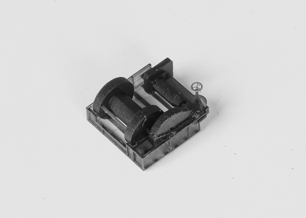

- Posts: 5068
Wa Hail...
I now have the two large winches for the A frame Derrick. However somehow I managed to print them 16% too small. So one is drying and one is printing. An advantage with winches and 3D as opposed to wenches, size can be adjusted exactly by a pull and re print.
This ship seems to have the odd square inch of free deck space, unlike the APA. Bulkheads do seem rather used, space wise, there are huge numbers of gas bottles in racks along the main deck. Vents? A veritable forrest of vents of all sizes, I presume to extract work byproducts in the myriad of workshop areas.
Originally the ship was equipped with 2 LCVP's hoisted into the Whelan Davits abaft the bridge, but photos show many times ships carried 20 40' launches here. Poseidon also carried a 40 ' launch far forward on the work area cradle. Whether or not I have the 3D capability to pull this off is open to question. Song would carve one from wood, that possibility is always there.
Tom
Tom
