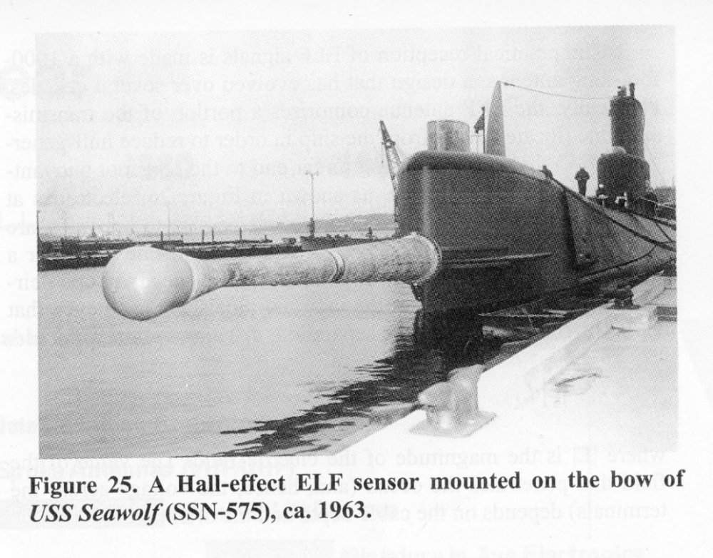

And you are correct - the BQR-3 was installed topside on the Nautilus/Seawolf in the early days. The Wolf did a lot of experimental testing in the 60's. (See the attached pic.) The Parche didn't carry the BQR-2, but had a BQR-21 topside/aft, as I mentioned. She left service with a BQQ-5 suite, which replaced her obsolete BQQ-2 system. The Q-5 was an awesome system. The Q-6 integrated every sonar, (Underwater Telephone/ Acoustic Emission Intercept / Bathythermograph and Towed Arrays) in a common system to a greater degree, but did not have transducers in the spherical array, just hydrophones. (Boomers aren't in the business of pinging.) The Q-6 sensor integration experience was highly useful for the systems that followed.
There has NEVER been an accurate model of the Seawolf portrayed anywhere in her Projects configuration that is accurate beneath the waterline. In drydock, a curtain that conformed to the hull was lowered as the drydock was emptied, protecting her modesty. An armed guard (MINSY PD) was posted outside the underbody curtain. Even they weren't cleared to look behind the curtain. Anything you see online or read in a book is pure speculation, fantasy or garden-variety BS. The same rings true for other projects boats. As long as inaccurate info is available, the truth will always remain protected. As it should be.
If the Navy ever declassifies the physical characteristics of the multiple Projects boats that have come and gone over many decades, I'll likely be the first to create and post accurate 3D depictions online. (I've posted a few submarine renders in the Virtual Ship Modeling section.) But until that day appears, myself and all who were/are involved swore and signed an oath to STFU, and for the most part, everyone has. A few stories have emerged, but the level of detail is astonishingly weak due to their minor involvement and limited "Big Picture" access. I can promise you, that there will be a lot of discredited so-called "experts" who will be most embarrassed when the real stories emerge - if ever. And the real stories are the stuff of movies, starring ordinary people, placed in extraordinary circumstances, backed up by a cast of hundreds of unacknowledged patriots.
Until then, keep in mind that those who know, --don't talk; and those who talk, --don't know.

The picture of the 50' section (we all knew it was longer, but that's what we called it) is the only known shot of the MINSY conversion that I know of online. The vertical plates that cover the sides of the Ocean Engineering section served two purposes - they kept it level, preventing it from rolling over as it was slid into place and concealment. (Notice the beams beneath - round hulls don't slide too well without side support and MINSY didn't use a launch cradle to move the OE section.) The plates were subsequently removed for hydrodynamic streamlining, (contributing to overall quietness and less drag) and a curtain was used when in drydock for concealment as noted above. Note the watertight door in Frame 27 leading from the front of the Crew's Mess. Above it hung the sign attached below. . . When inport, there was an expanded metal mesh door with a six-button cipher lock and a curtain positioned in the passageway behind the screen leading through the watertight door. It was removed when underway.
