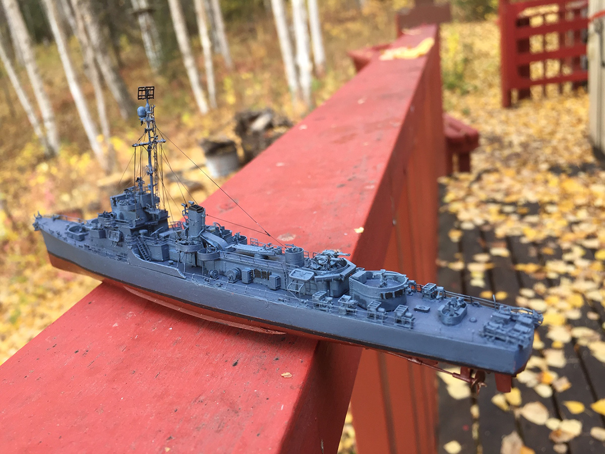

by Fliger747
Whitehurst 1:514 today in measure 21. A small scale model emphasizes all the things you are bad at... Props aren't bronzed yet, rigging is mostly OK as you can hardly see it except for the halyards which I may re do. They need the ends trimmed a little on the yards, need better clippers!

Re: USS Whitehurst One to who knows DE.
Posted: Tue Sep 06, 2022 8:54 pm
by BB62vet
Tom,
Very nice, indeed!!! From sea to shining sea....well, glass patio table, right??? Almost a sea :big_grin: !!!
Good job on the bottom & boot topping. Quite the little boy you've got there!
