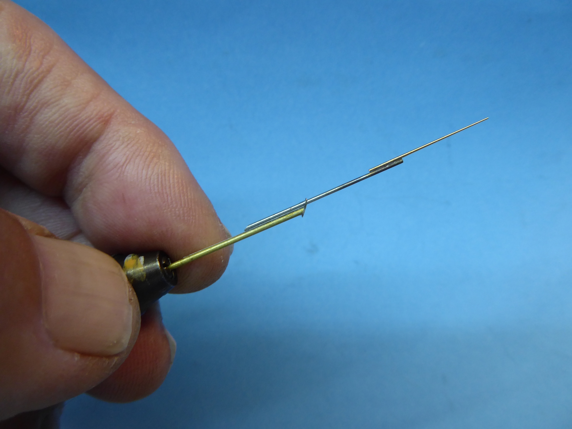

The lower mast are tube ( with another section of Tube glued inside as a laminate )
with the tapered sections cut out of appropriate size of 1.350 scale yardarms
The yards were cut out of 1/350 and 1/700 spars of suitable diameter

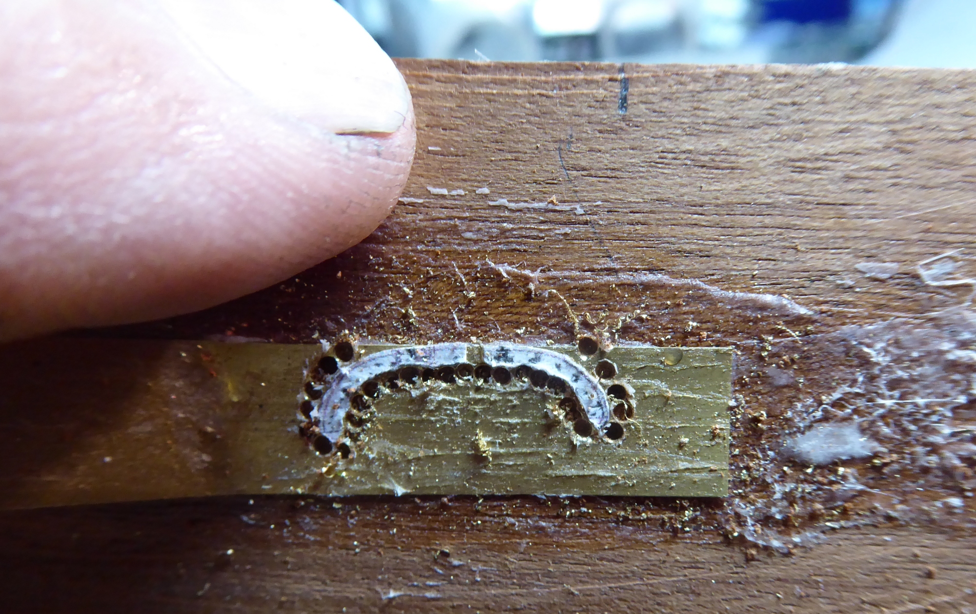

the platforms of which cut out of 2.5 thou brass PE waste fret surround.
Cutting the outside shapes with Fiskar curved scissors is easy-- the inner radius rather less so...
I elected to glue the brass to my wooden drill block with 'Pritt ' paper glue
... using the Pillar drill make a series of holes
==> chain-drill the inside curves first and the use another drill bit as a ' milling machine to cut it clear.)

The bow-sprit was built of 3 pieces ,
then the 'Dolphin striker ' ( vertical ) and the ' net-spreaders' were added
of stainless steel stiff-but-thin Photo-etched ex 'pulley sets'
The masts were built and test-fitted for rake , heights and position
and eye checked against a drawing on screen

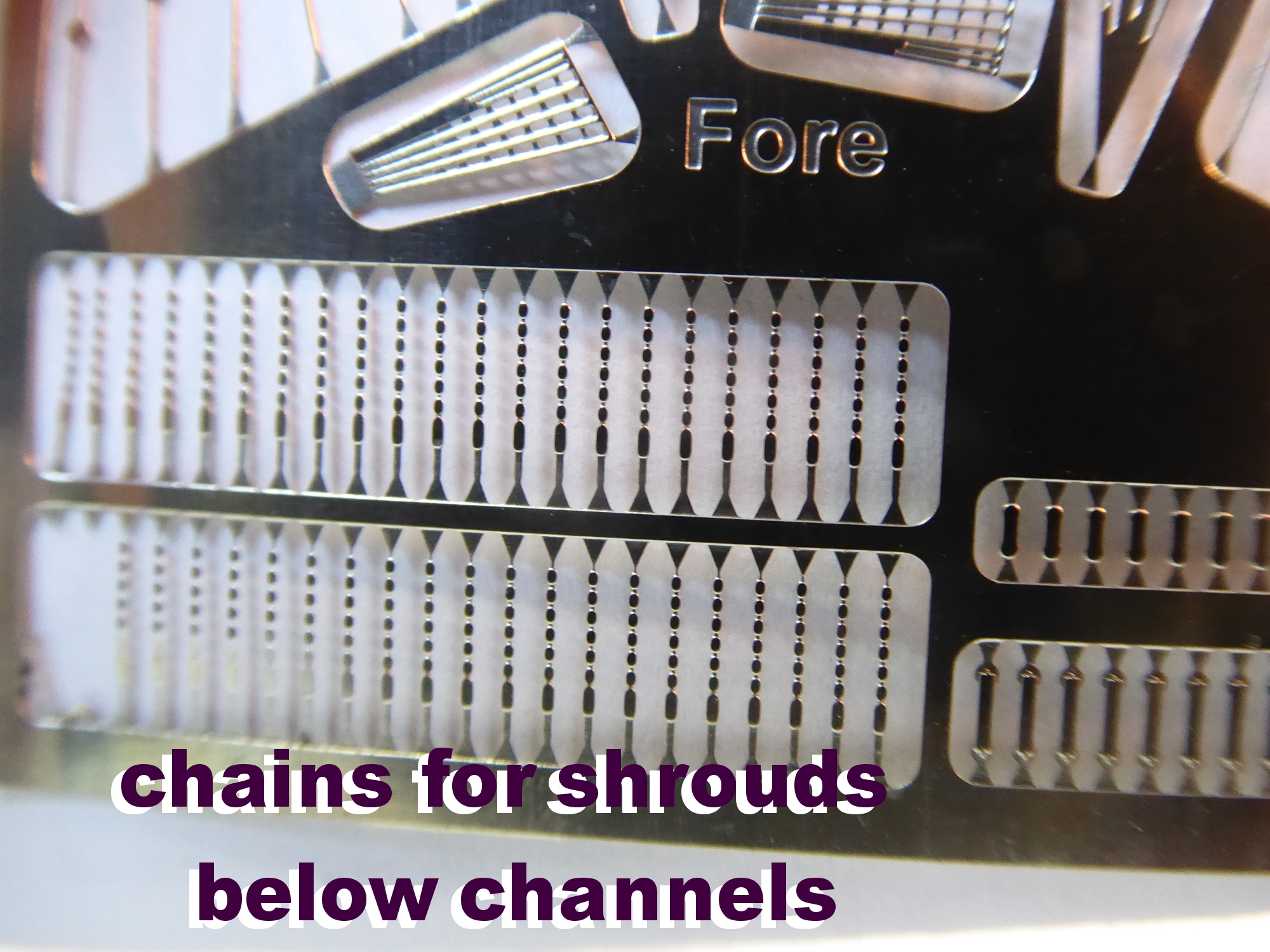

I had the shrouds and ratlines designed and made of relief etched stainless steel PE by a French master designer.... :thumbs_up_1: :thumbs_up_1: :wave_1:
At last, unpacked now.... :thumbs_up_1:
