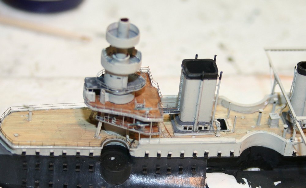

I knew the fwd funnel base had vents and flaps--so I duly added those-- decals stripe for hole and paper for raised lid.
Alas--after greater analysis of the existing photos with a fellow French warship fan and researcher ... we
now noted that my aft funnel base was wrong- it also needed to be square-as it also furnished with vents and flaps.
Not wishing to remove the glued and pinned funnel.... I retro- bodged it to get the effect....
without disturbing the steam pipes etc
In addition-- the previously (retro)fitted upper bridge stairs ...
...were removed, ( ouch!!) the aperture re-shaped and the stairs re-installed--because the stairs on the real ship actually ran traversely athwartships... outboard to inboard.... small detail--but once I knew--I could no longer leave it alone!! :big_grin:
Oh how I long for a nice 'easy' model to build.....!

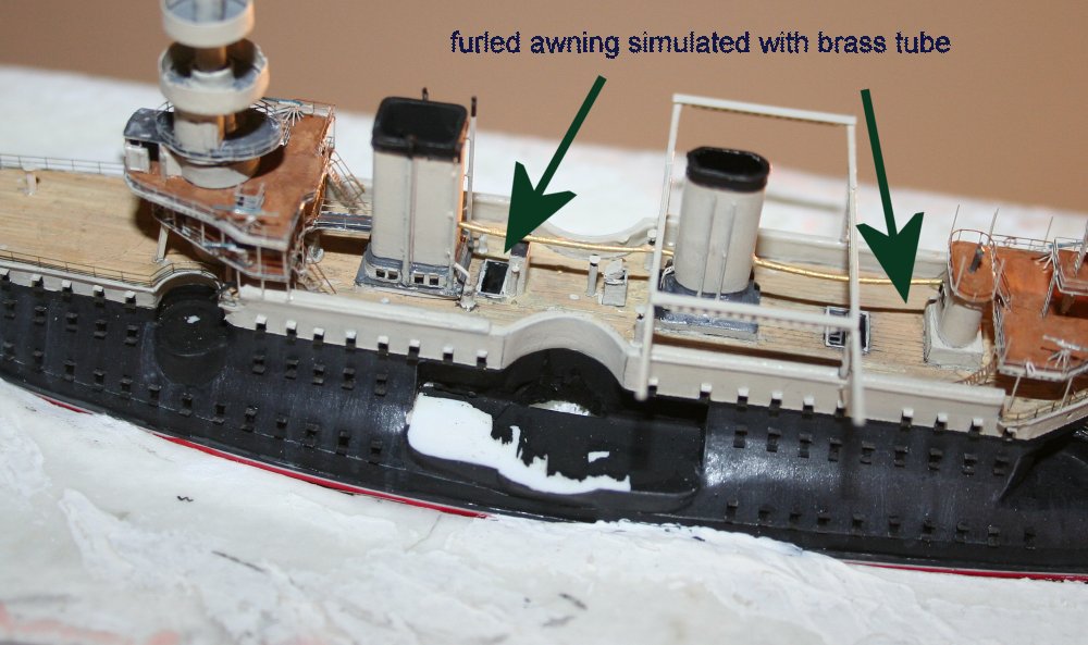

Carnot even when under way often carried a large furled awning, slung between the binnacle vent structure and the aft funnel--and then another awning slung between the fwd face of the aft funnel to the aft face of the fwd funnel....
It is a prominent feature--and was supended from overhead cables.
I decided my model would have to have this feature..!
I first cut to length and shaped some brass tubing, then proceeded to cover it with white glue to roughen its appearance.
The slinging/suspension points were made using dying white glue tease into small triangular shapes.
Once painted it looks like a far rendition of the real thing; once rigged it will make more sense to the casual observer also!

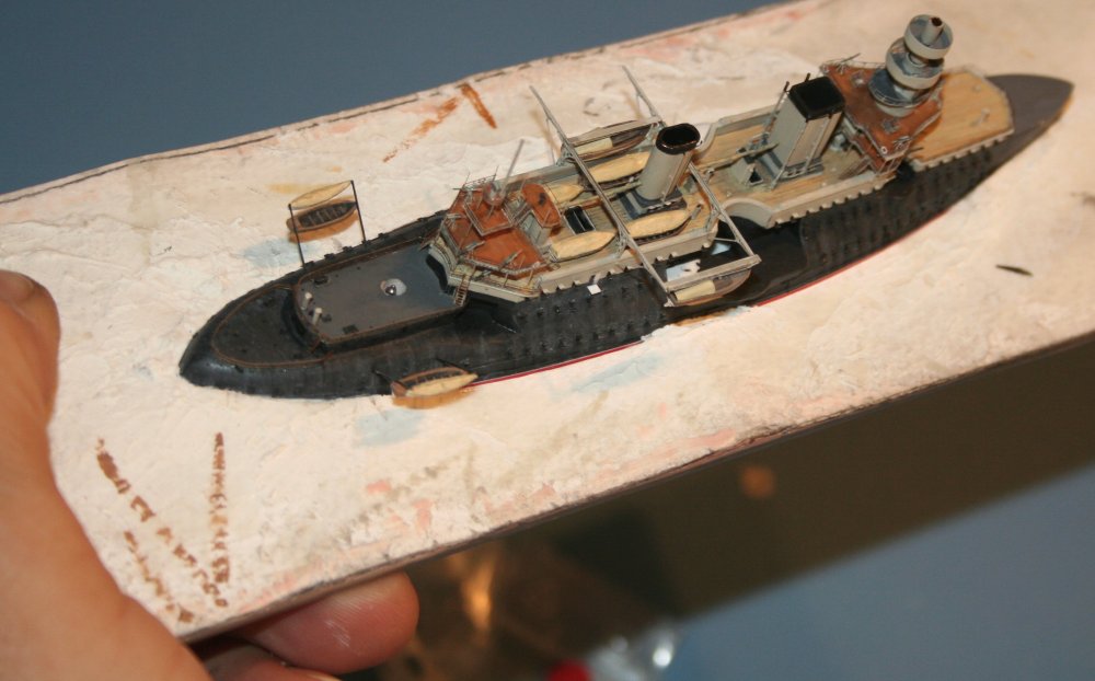

Despite having a streaming cold- I have spent the past couple of days getting the boats ready for Carnot.
The boats are a mix of modified Combrig, shortened and narrowed WSW, ancient (scrap) Airfix etc...
Not a single boat from the kit was any use....
Carnot's boats appeared to mostly have covers on at all times...- I made these using white glue and acrylic matt paste, smoothed and shaped with a wet brush.
The boats all had a band of exposed varnished wood around the gunwhale, masking these neatly would have been beyond my patience threshold!!
I made this 'timber' feature using a strip of black decal stripe, once dry the decal gave just enough of raised edge to give a clean demarcation line. In addition --on the steam launches the top and bottom has a strip of fine brown stretched sprue added.
The covers over the cockpits of the steam boats were made of paper-- photos of the real thing suggest that the canvas was draped over hoops.
The open boats midships were stacked in each other, I hollowed away the thwarts to make the upper boat appear less 'perched'.
The Canvas covers were outlined in sharp pencil with the under-hull ties being drawn in.
The Hull had accommodation ladders aft of midships leading to doors in the hull-- photos show these to have been open sometimes when under way--I guess ventilation...
I made my door 'aperture' using a bit of black decal stripe to simulate the void, the door was made of paper--with a stap of a in to make the porthole within.
The platform was also made of paper attached with varnish.
It will pull together nicely once painted!

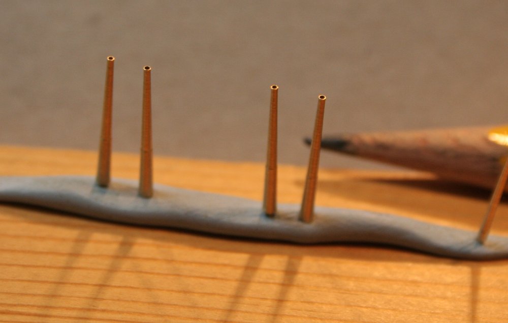

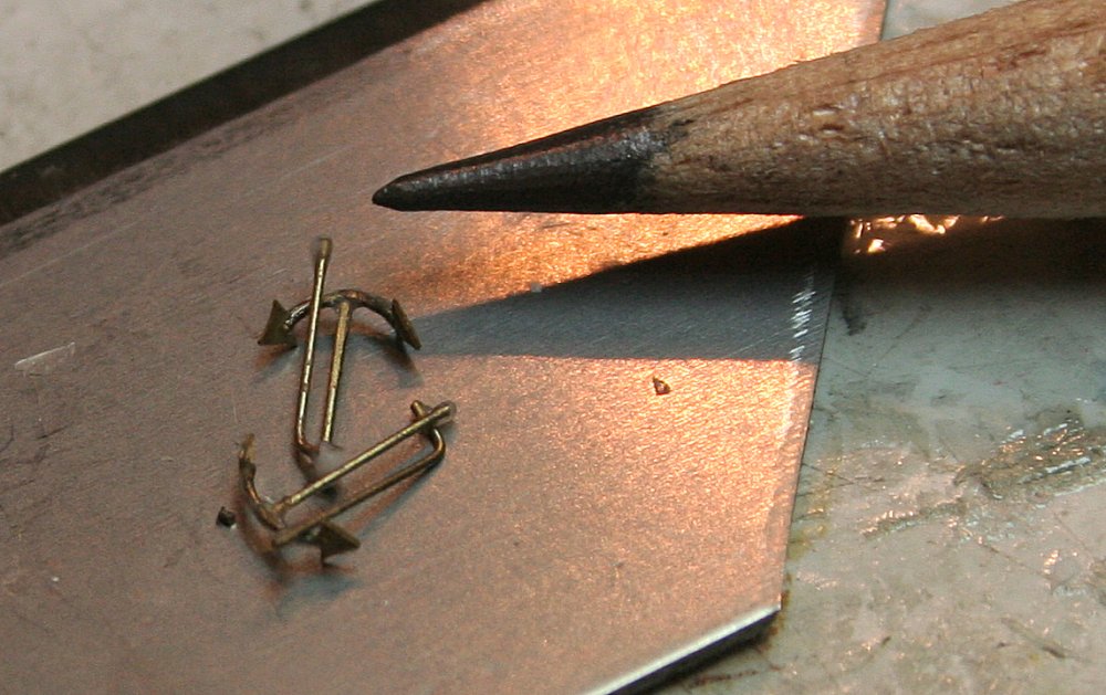

The puzzling out of the small details from photos, and then making them is taking a lot of time.
Carnot was festooned all over with boat booms of all sizes, locating hinge points was quite a game in itself.!
Endless staring at photos elicited 2 x medium sized admiralty pattern anchors--with folded crossbar--to be located aft of the mid-ships battery...
PE is too thin--and indeed I have nothing remotely right in shape or outline of the anchors--
so made my own from scratch using brass wire, shards of brass PE and white glue for the weights

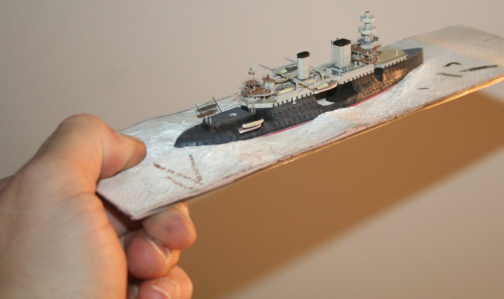

But overall... the model is slowly nearing completion....
With luck another 3- 4 weeks should see her done--
thereafter I shall treat myself to a nice ...... 'easy' kit build!!!!

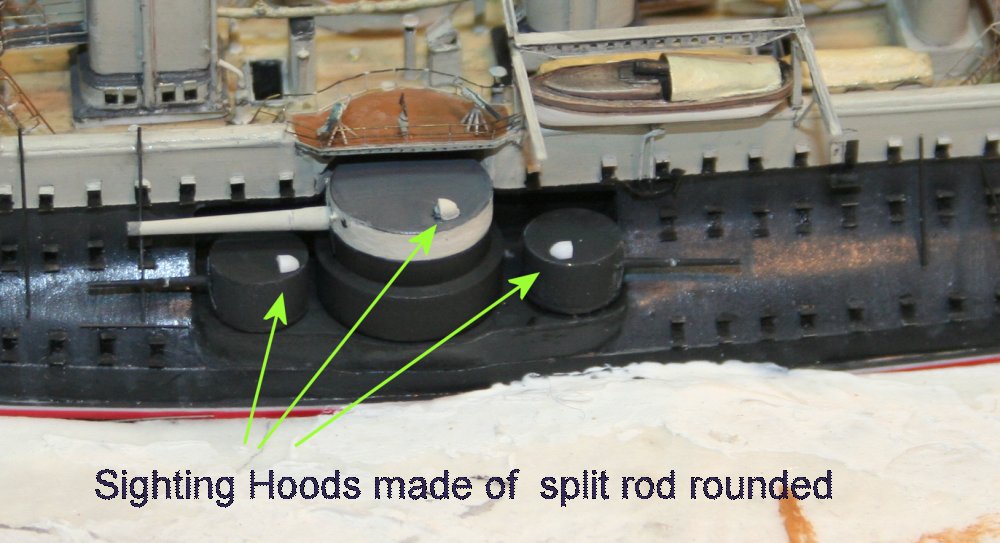

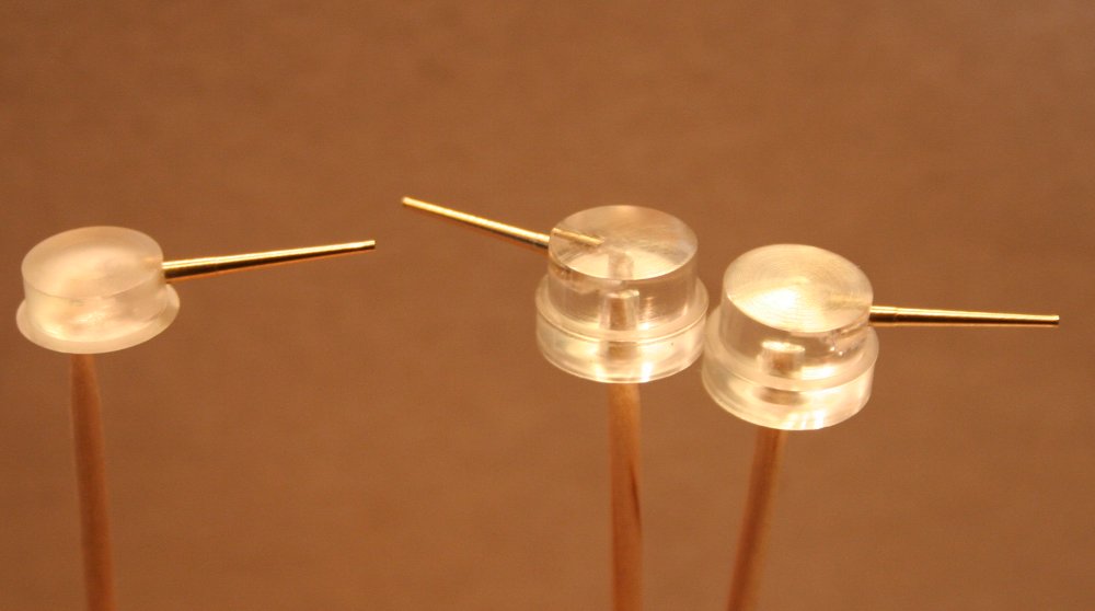

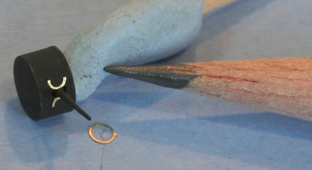

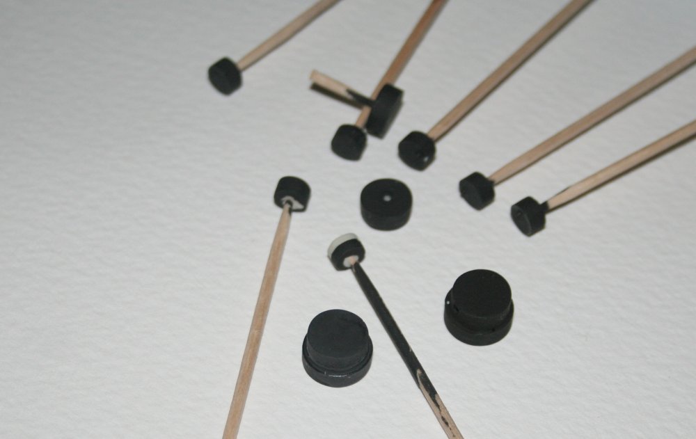

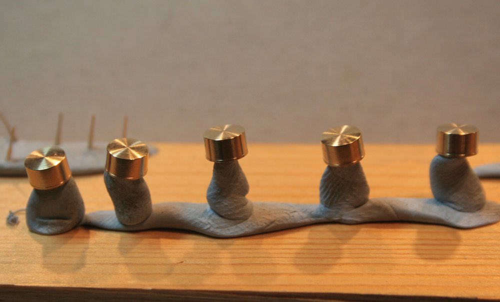

Studied observers of this ship will have spotted that there has been no mention of the main and secondary turrets and guns...( not hard!)
As far as I could ascertain and measure...( using digital vernier calliper)
.... the kits supplied items alas truly failed to convince, the castings being:
the wrong height, diameter, flat-topped and not truly circular in some instances!!
I immediately decided to make new turrets.-
BUT... I was unable to achieve the sharpness and repeatability in shape I desired with my manual manufacturing means
(and lacking in both time and patience) plus not having the skill-set to operate a lathe.....
==> indeed not actually owning a lathe being a further handicap! :heh: :heh:
Burkhardt Masch to the Rescue!!
Burkhardt is the proprietor of well known German based gun and mast manufacturers BMK ( Modellmarine shop.de)
https://shop.modellmarine.de/index.php? ... c81cb25987 and MW.com sponsor.
I supplied measurements and sketches as I perceived I wanted the turrets, and he obligingly converted my rambling scribble into a technical drawing for my approval, whereupon he then proceeded to turn all 12 differently sized turrets on his CNC miniature lathe, as well as the long main gun barrels and all the long 4.5 in
The main turrets and wing turret and barbettes were turned in Acrylic ( an new medium to me) and the 4.5 turrets, in two batches of subtly differing heights in solid brass.
All have a beautifully subtle domed tops--and all are identical, something that I was unable to achieve manually...
I am simply delighted with my new turrets--which I feel will really lift the model.
Highly recommend farming out something one cannot achieve oneself..--why compromise the model! :big_grin: :thumbs_up_1:
Let the pictures speak....
The pictures speak of outrrrrageous, and awesome, detail!
:thumbs_up_1:

The turret all had slim asymmetric doors that sealed the aperture in the turret ( presumably for heavy seas)
I made mine using some PE rings ( L'arsenal) that I squashed on a corner of smooth faced pliers after cutting in half; this resulted in the interesting asymmetric shape--and was repeatable.
The sighting hoods are being made of styrene rod smoothed into a ball and cut in half.
The demarcation line twixt grey and black is hard to mask accurately and consistently; I preferred to paint roughly and bridge the gap with black decal strip and then paint to the edge of the decal strip--it looks pretty sharp!
More soon

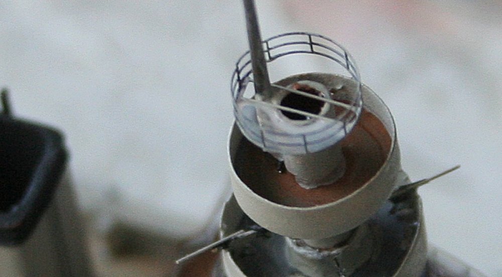

The turrets have been installed, the sighting hoods made of styrene rod rounded and split and the aperture made of a sliver of decal strip after painting.
There was a a further triangular/cloverleaf shaped sighting aperture in the fwd face adjacent to the barrel--this again was made of slivers of decal stripe

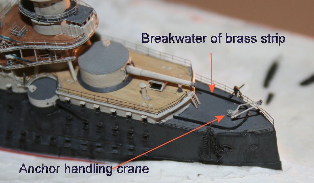

I made the anchor handling crane, and after staring at photos for ages I discovered a low breakwater on the anchor handling deck fwd-which was made and installed of brass strip, and made the the gunbarrel supports
The ship with her turrets in place looks much more purposeful and I am feeling encouraged that the end result will be an interesting model after all!
Self-doubt always creeps in; when I think the whole model is not sharp enough-- a direct result of seeing the model for over 2 months thru an Optivisor--where every flaw is greatly magnified, leave alone when viewed on a large PC monitor !
Jim Baumann
