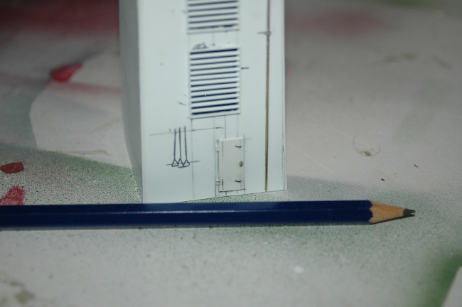

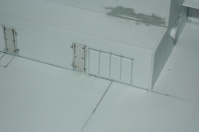

Lots of small details to do now. I was planning to make the grills for the engine room myself along with all the other grills for ventilation. The first results weren't encouraging and it would be a long and tedious job to do. So I thought perhaps Evergreen would have something I could use. For the first time in my life I bought some Evergreen stuff now. The thing I used for the small grills is called "Clapboard" and it has a sort of sawblade structure.
I also tackled the bridgewings. The inside frames were placed, sides cut to height and the front, which bends back and forth to reduce the wind were all done. Afterwards I put some white primer on that deck.

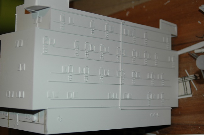

I'm now in the process of putting primer on the whole structure, part by part. I'm using a spray can, white primer, from Graupner. Took some time to figure out how it goes, but I seem to have found the right technique now. The facing (after putting some extra brackets above the escape windows) was done along with the starboard side. The lower level was deliberately left without primer, and has now received the largest part of its details. I'll continue on the portside with the detailing of that level and work on the aft side as well. The bridge has been painted in its "normal" colours, but I feel the grey for the roof is still too dark, so I'll retake it and add some more white. I still have to redo one part in white as well, but I will wait for the rest of the superstructure before I do that.

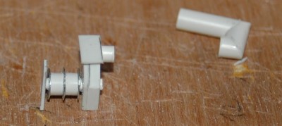

While painting the superstructure (still on the white now), I'm making some fittings as well.
The wooden blocks you see are the tank domes. Technically part of the cargo tanks inside the hull, protruding through the deck. I'll be plating them with Litho, kindly provided by Master Ron.
The smaller fittings are mainly ventilation ducts of different types. The big angled one is sitting just in front of the swimming pool and provides cooling and air for the emergency diesel generator. Apart from those you see one, partly finished Lifeboat winch (for lowering and heaving up the lifeboats and davits) with a split drum. She's about 1cm long.

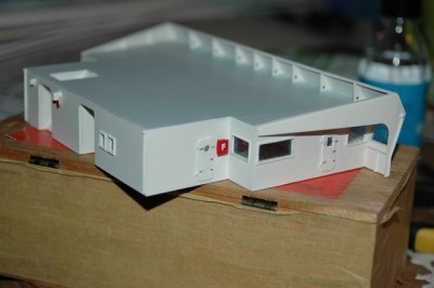

Here is the bridge, nearly finished, I'll make that "F" on the firebox a little smaller and thinner, but the main work on the bridge is done. Also some small paint job to paint the door handles. I'm still in progress with the main superstructure. One side still needs a finishing coat of white and then I can add the grey for the decks. It looks a little too dark, but I guess once the ship is outside it'll be nearly correct in shade.
