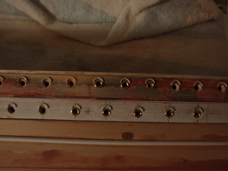

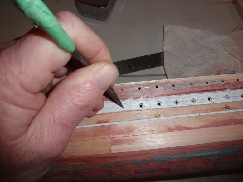

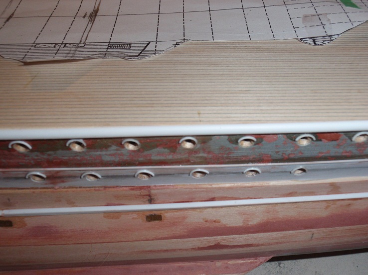

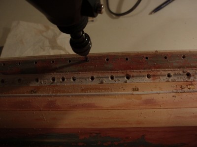

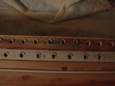

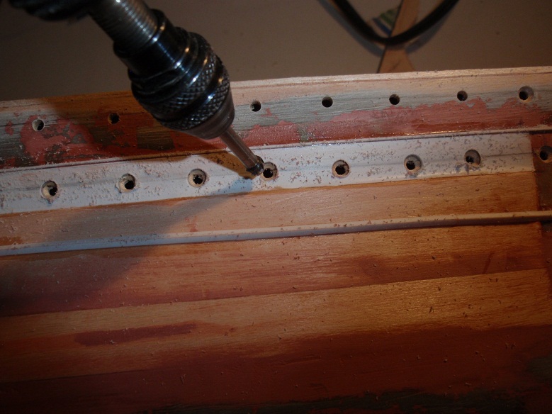

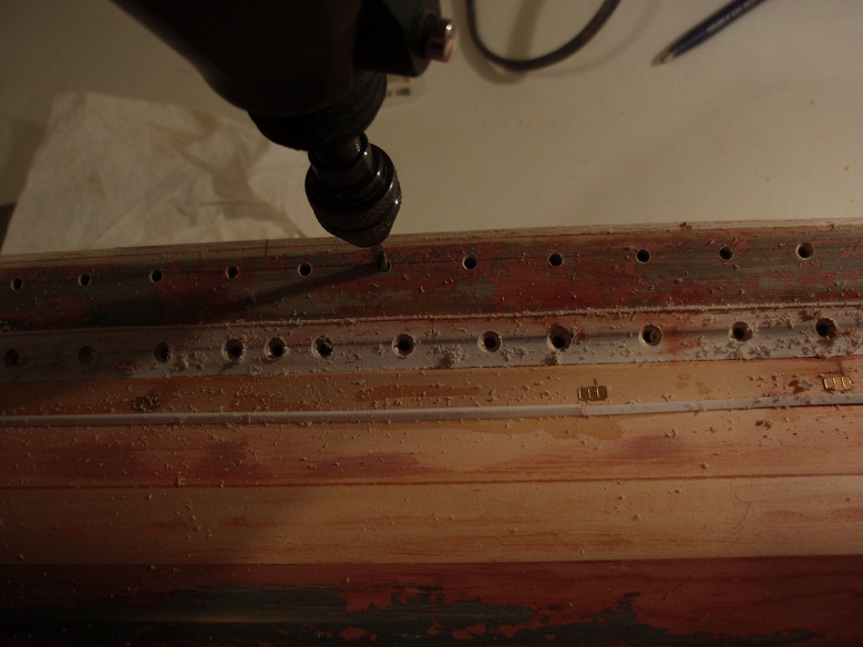

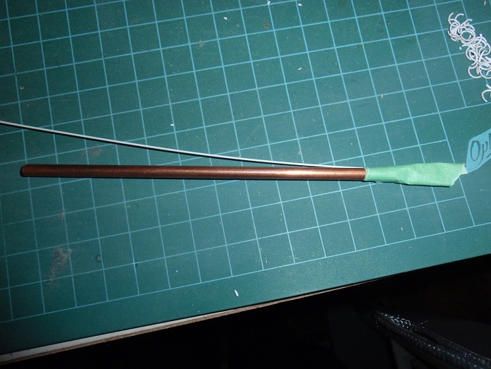

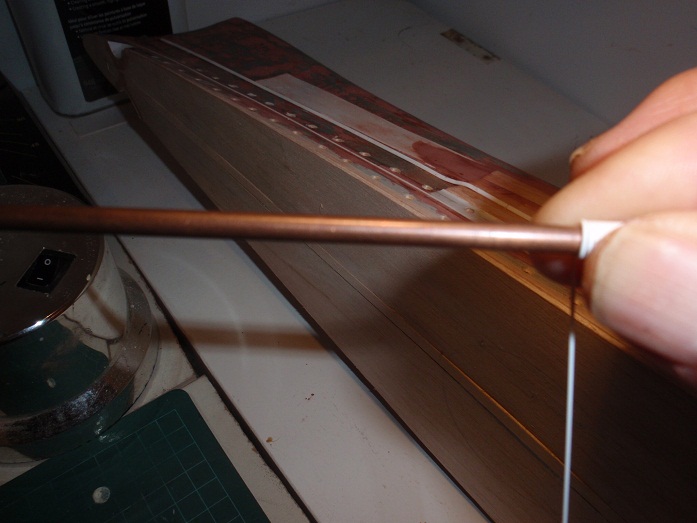

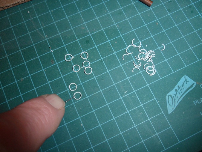

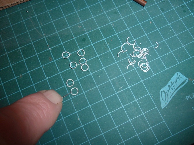

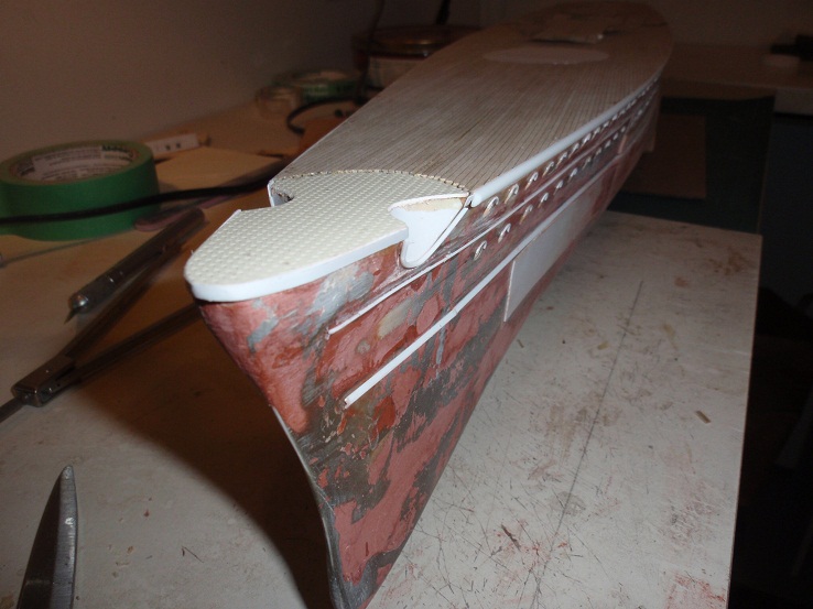

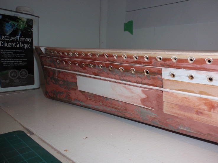

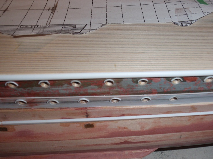

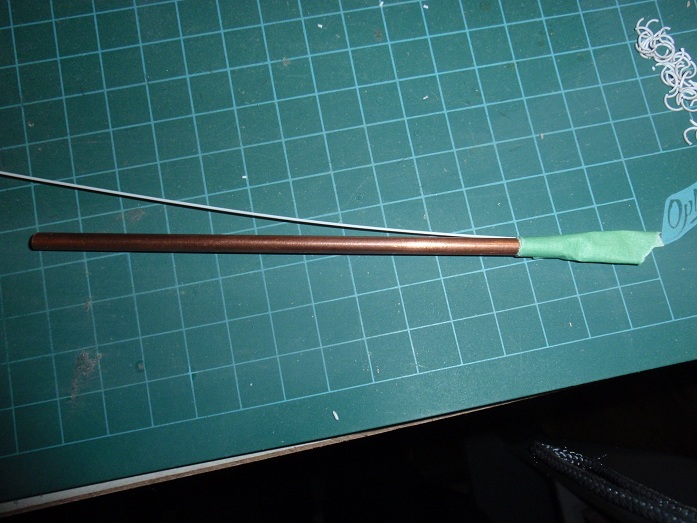

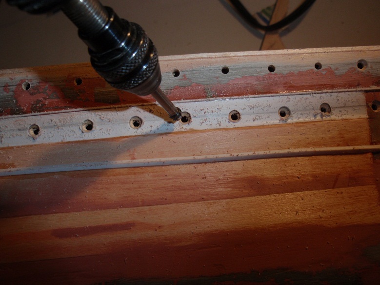

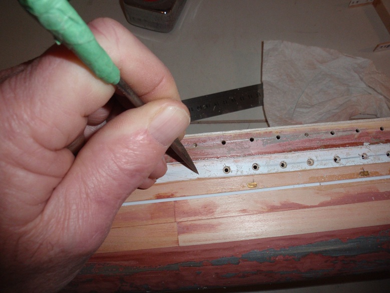

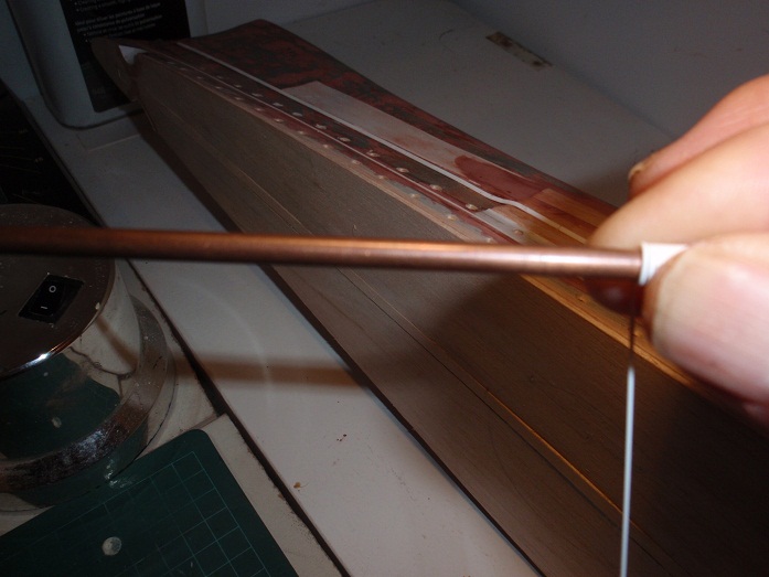

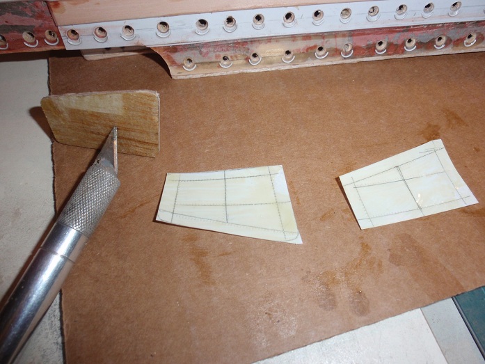

hi all,this is what i decided to do for port holes.i found a buch of small brass circles that are use in making jewelry these fit in the holes in the hull.3 cents each. for the eyebrows i wraped .020 styrene rod around a brass tube that is the right dia. for the holes.i heated it up a bit with a lighter to make it keep its shape.after slipping it of the tube i cut it with sissors,this made a bunch of circles,which where then cut in half.the holes in the hull are done in four passes,#1 poke a small hole with a scribe. #2drill a small hole. #3 drill the correct dia. hole. #4counter sink the hole to fit the brass rings.repeat 387 times, i am now cross eyed :big_grin:
poking a small hole with a scribe
counter sink
counter sink
making eyebrow circles
after it is rolled on ,i heat it a bit
circles cut in half
circles cut in half
eyebrows on hull,tacked on with white glue ,then i paint on a coat of future acryilic.to realy stick them on
brass inserts,they will not be added untill hull is painted ,i want them to stay brass color

Thanks for explaining your method Russ, the result is outstanding. :thumbs_up_1: I'm off now to count the number of portholes on my plans.

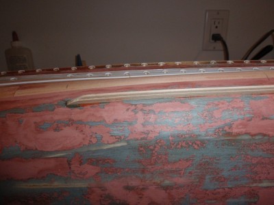

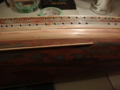

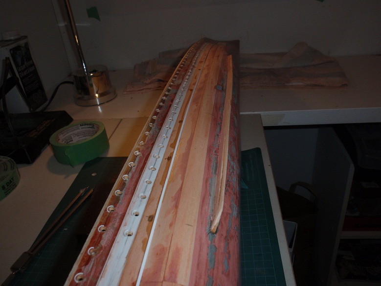

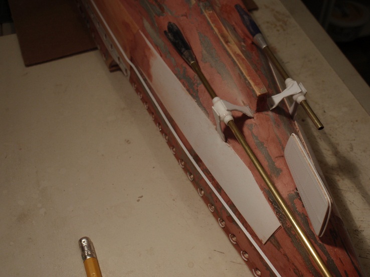

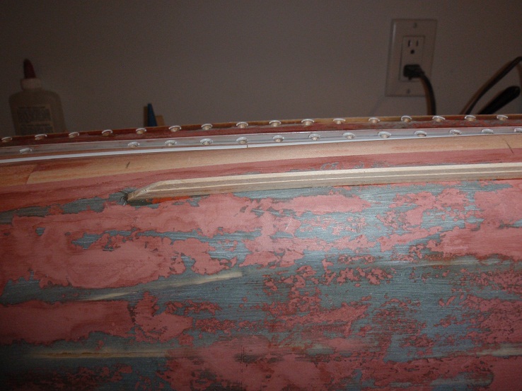

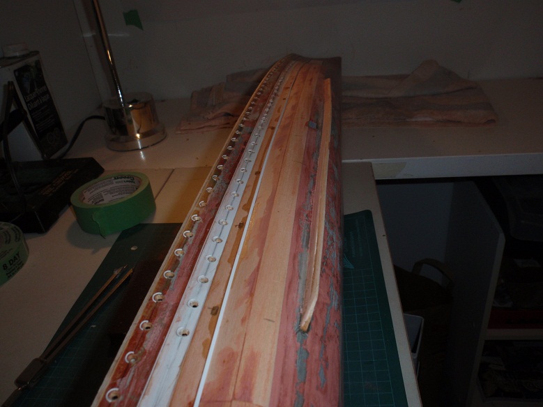

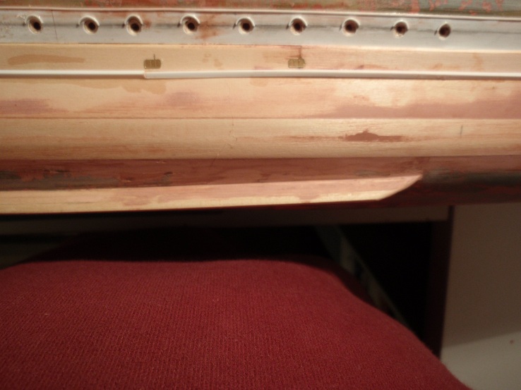

thanks for the feedback guys,on the wild west coast of canada we call them portholes :big_grin: bilge keels have always given me fits.i hated cutting long slices in the hull,lot of chance of poping i plank.trying to fit a single piece of styrene or wood involved much cutting and fitting to get it to fit the hull curve.this is what i came up with.i used 3 strips of basswood,starting with a piece 1/8 by 1/8 in. this i glued to the hull in the right place,being a small sqaure strip it can bend in compound curves.after it came i piece 3/32 by 1/8 glued to the first piece,then one 1/16 by 3/32 glued to that one.i then trimed the ends and sanded it down a bit to smoth out the joins and it came out not to bad,and no cutting into the hull :smallsmile: now i have to fiqure out where the thru hull fitting are,so far i can not find any pics,there is one of sheer sunk at the doc but i think the holes one sees are from the salvage crews gaining access.
Ticonderoga
Posts: 652
Re: 1/144 admiral sheer s.c. scratch build
Post by Ticonderoga »
Hi Russ,
A very nice approach to constructing the bilge keels :thumbs_up_1: I was contemplating the "pins in the bilge keel and drill the hull" method, but I think I like yours better. It certainly makes getting the initial line of the bilge keel correct much easier.
Getting timber the right size AND flexibility might be a challenge at 1/72 scale on a big ship - we will see.
Andrew
:wave_1: :wave_1:
(Dedicated scuttle supporter :cool_2: )
russclark
Posts: 1173
Post by russclark »

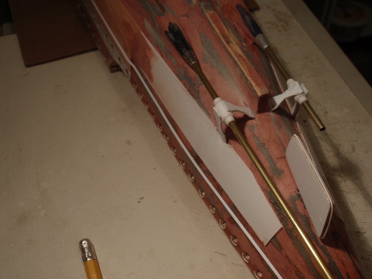

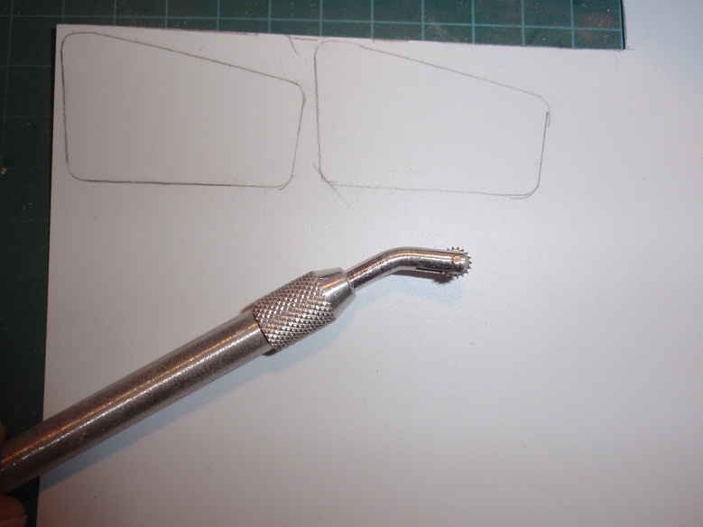

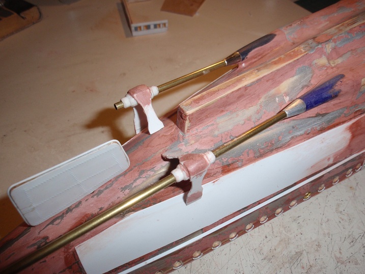

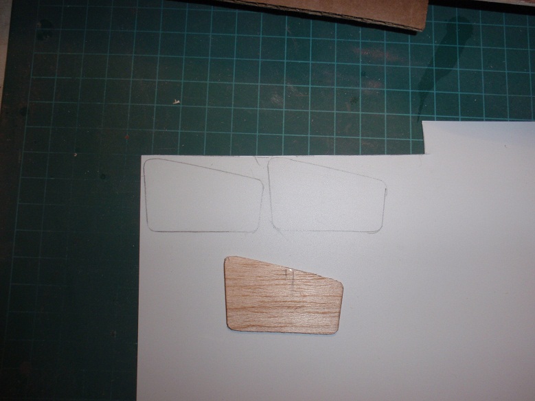

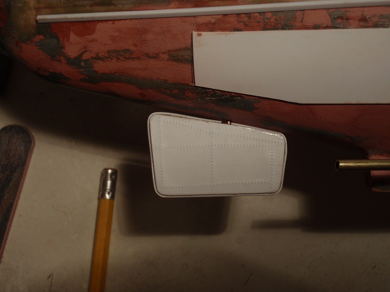

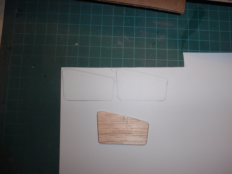

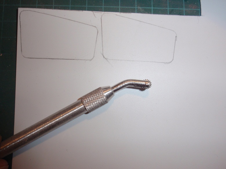

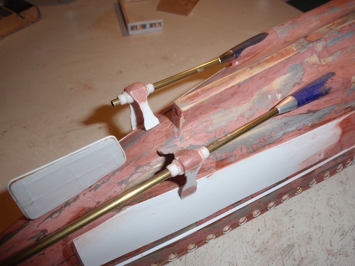

hi andrew,laminating many small strips allows the wood to be bent and twisted fairly easy mine are three piece once they are glued on they are pretty tough i sanded mine pretty hard and they did not fall off. having built a few 1/192,1/200 ships i find it hard to get used to a bigger scale my brain seems to have 1/16" to the ft'. embeded in it .heres some progress on the rudder and prop struts.

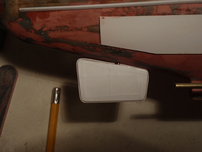

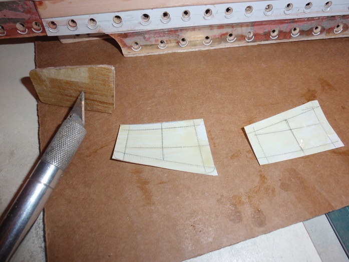

1/16" balsa skined with styrene

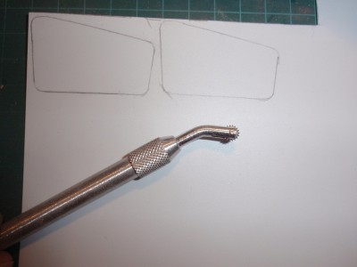

this is a ponce wheel they come in many differant spacings for making rivets
have to make sure which side the rivets will be on ,or you will have holes instead of bumps
i used to make my struts out of brass, but seeing my ship are static styrene does very nicely
after a little filling with bondo putty

Looking geat , rudder is neet . :woo_hoo: Were did you get the ponce wheel ?
russclark
Posts: 1173
Post by russclark »
hi richard the pounce wheel is from floating drydock. it is in the much,much more stuff under tools.

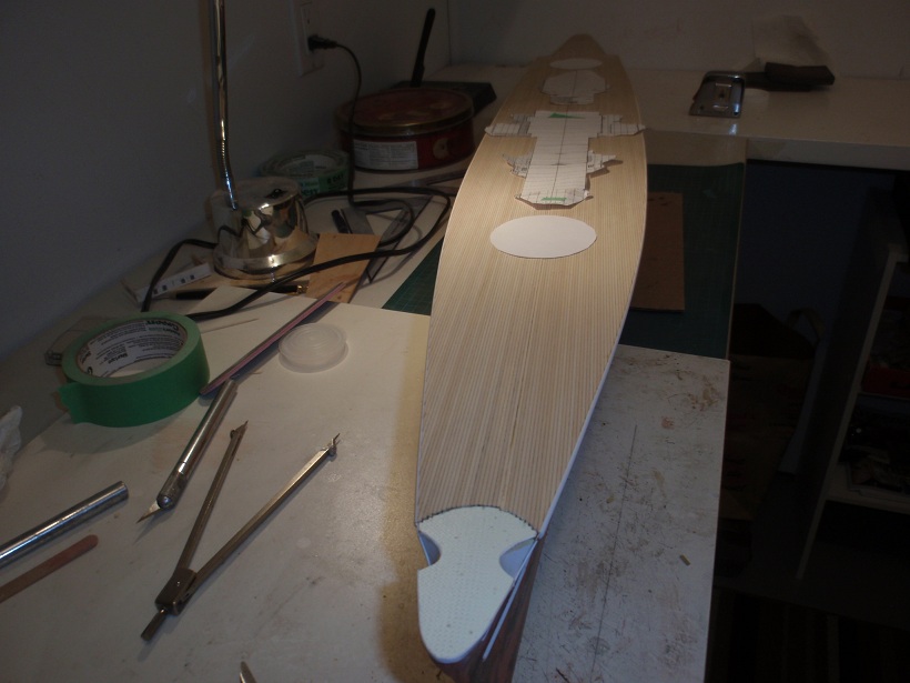

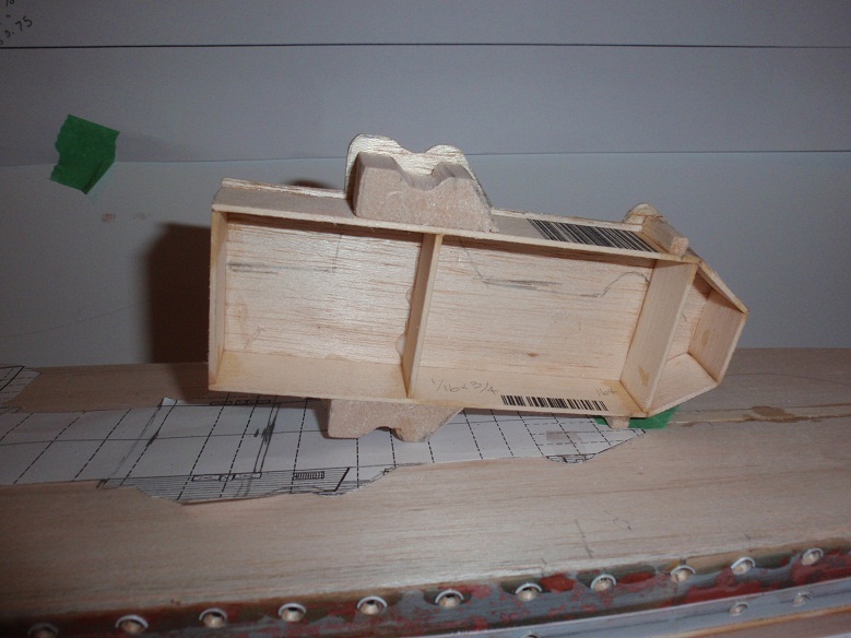

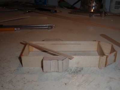

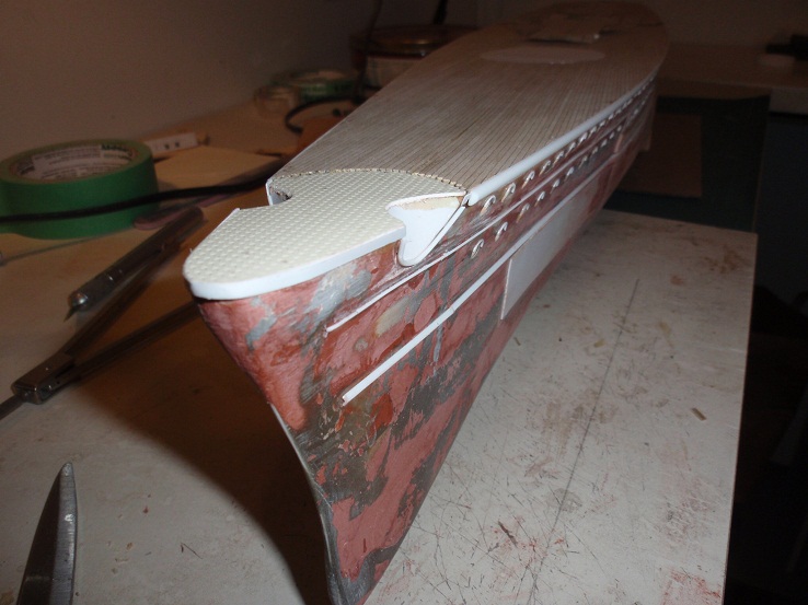

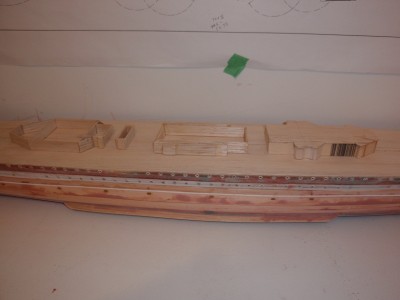

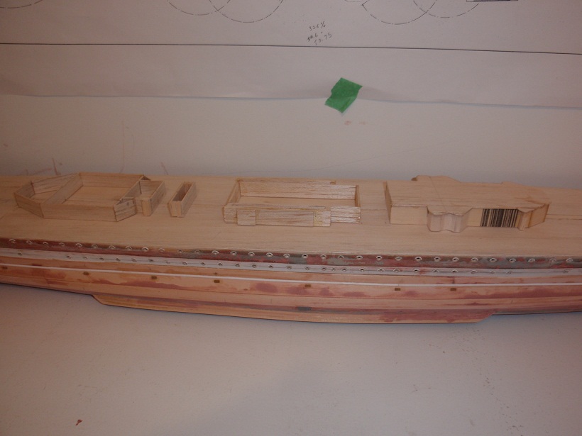

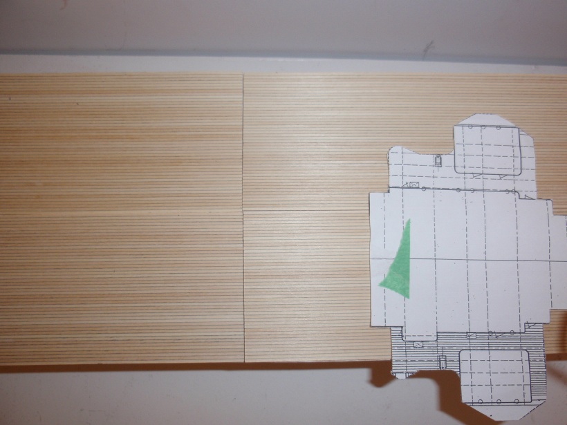

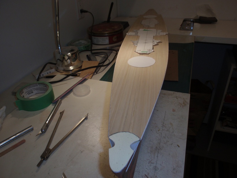

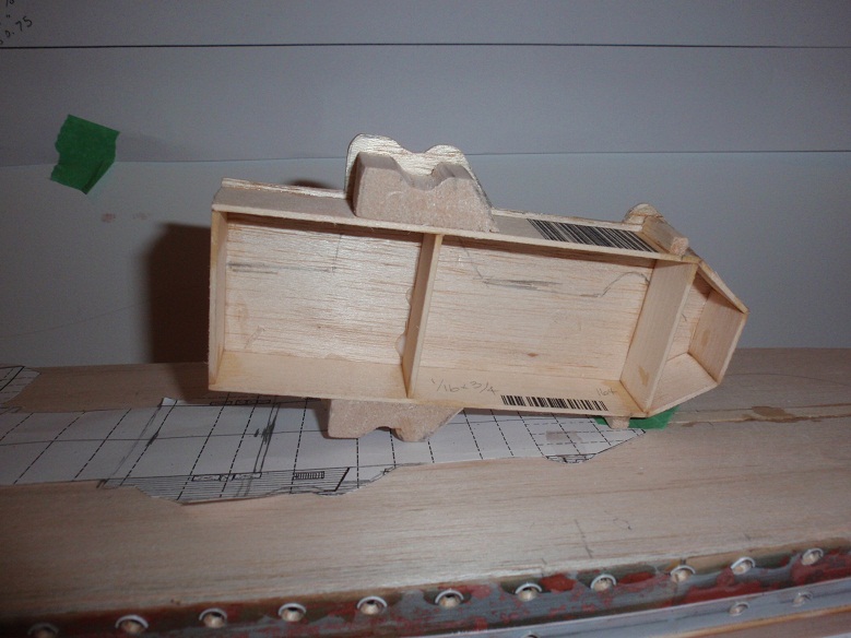

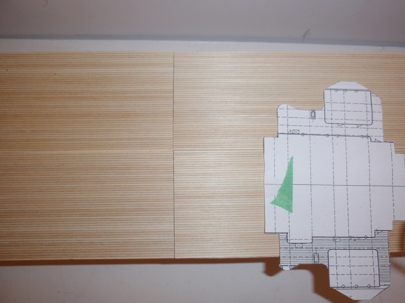

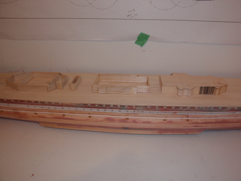

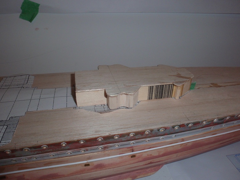

thanks every one for your comments.after the sub deck was glued on i took my sander and beveled the outer sides down by 1/16" this will give a little camber,i do not think it will be noticable ,but it is there.to get the decking to fit i had to build the rough assembly of the deck housing.it is balsa that will be skinned with styrene latter.the decking where it butts to each other worked out well as the seam will be under the widest part of the deck house.i will use contact cement to glue the deck on,this is tricky as if you make a mistake ,big problem.i will lay a sheet of paper down first then start at the bow and work back.
piece on top is to keep it sqaure
a look at the under side
all the first decks
all the first decks
this is the join in the decking
the seam is now not visable,there are no plank lines yet and the decking is not glued down or trimed

russclark
Posts: 1173
Post by russclark »

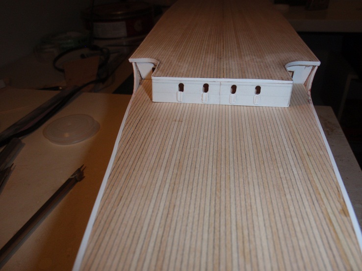

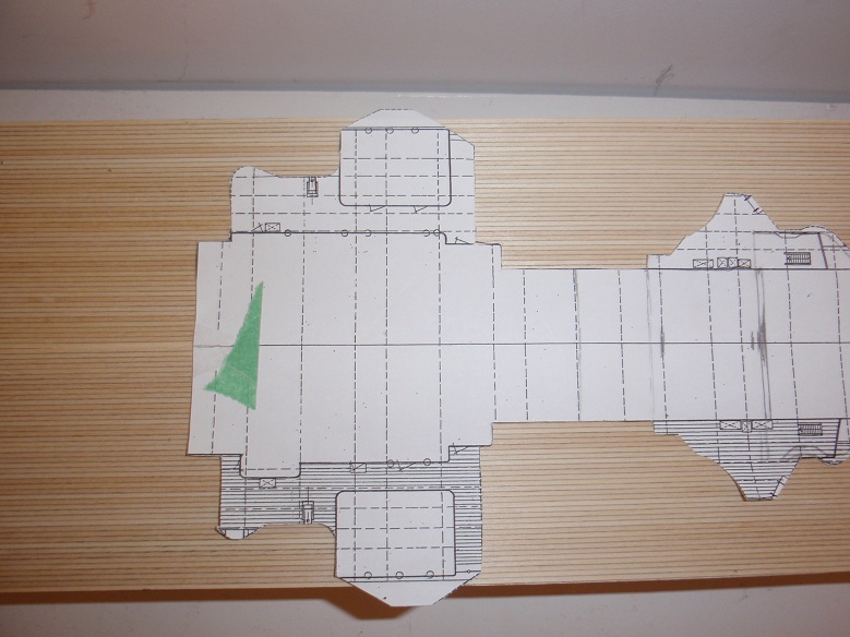

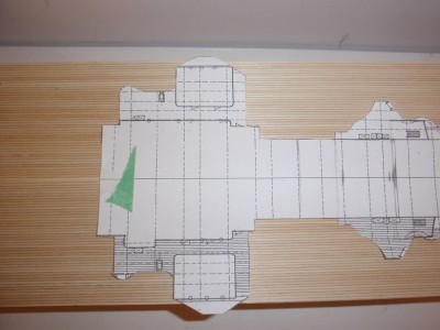

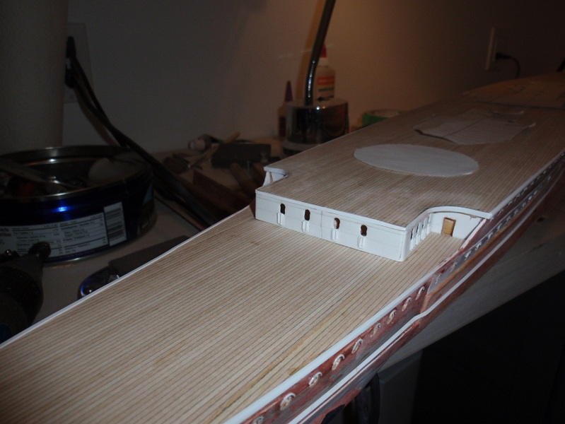

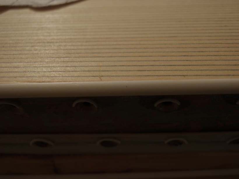

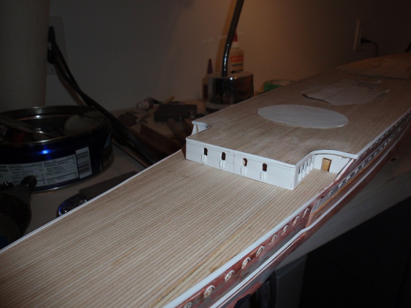

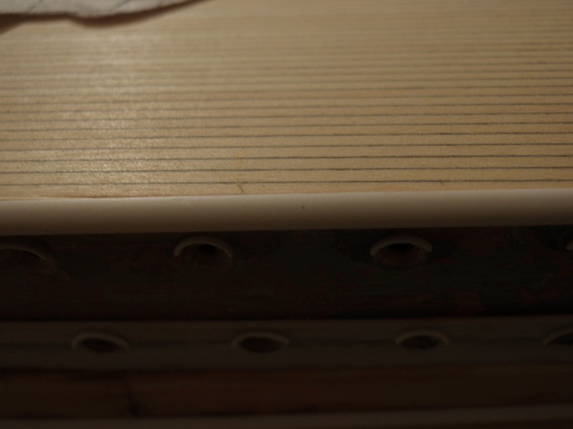

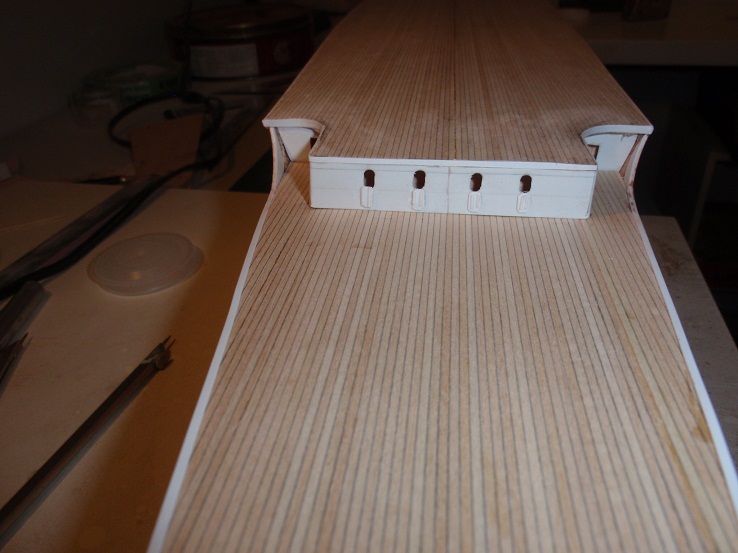

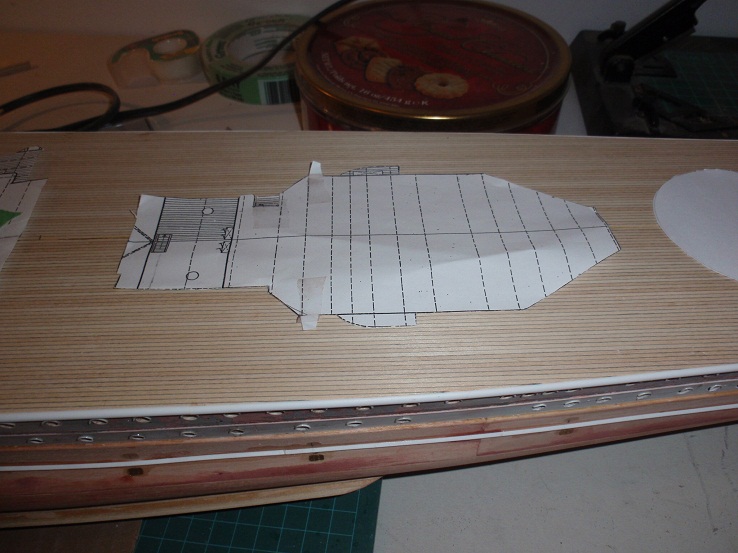

hi all scratch builders,deck is installed ,still have to make plank length lines,i tried my very fine micron pen,it works great on my other decking ,but the stuff i am using this time has very faint glue lines ,almost a dark grey,i tried a lead pencil it seems to be close the the glue lines.i will try it on a piece of scrape later and see what ever one thinks before doing the deck.
there are no visable joins anywhere to be seen,makes me a happy camper
a piece of half round styrene,this matchs the rolled sides of sheer pretty close
this decking is from blue jacket shipcrafters as close to real planks i have seen i little pricey thou.

Wow Russ, those planks look really good :thumbs_up_1:
It must have been a painstaking task to secure each individual plank and to keep the lines straight, well done.
Andrew
:wave_1: :wave_1:
russclark
Posts: 1173
Post by russclark »
hi andrew, i can not take credit for indivdual planks it comes in a glued up sheet 3"by 22" about 1/16" thick.i have tried planking before cutting my own planks but it is not my forte.i have the great'st admiration for the guys who lay there own decking,it is a very time consuming finicky process.
