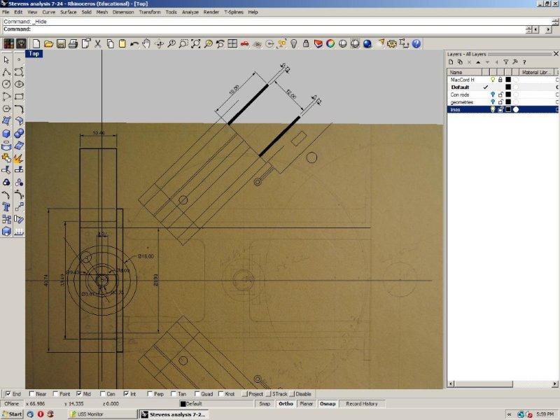

Here is a photograph of an original Ericsson drawing taken by Adam Winger at the Stevens library. Even with the browning of the 150-year old paper, it is substantially easier to read than the much reduced version of this drawing reproduced in Peterkin's book. This design was drawn by John Ericsson in the fall of 1861. It is kind of a thrill to read the penciled notes made in his hand. This is a photo and not a scan, and the lines may deviate a little, but it is a fairly reliable source document.
Stroke is 16", bore is 12", cylinder wall appears to be about 3/4" thick.
The bore and stoke are 16 inches and 12 inches respectively. This is my opinion, based on overlaying CAD lines on the pencil lines and making measurements. The port cylinder has been mirrored into the clear. The cylinder wall dimension reads out as 0.73 inches. I take this to mean 3/4 inches.
Note that the 16 inch stroke and 12 inch bore dimensions are consistent with those used in the next generations of Ericsson monitors, as documented in the Scientific American article referenced above.
Phil, you are right, I have noticed on antique steam tractors that small cylinders can be very potent. (We had a J.I. Case steam tractor one year at our 4th of July parade. It had a steam whistle you could hear for about 8 miles.)
In the case of the USS Monitor, however, I think we can safely extract and rely upon the bore dimensions as depicted in the surviving drawings. On this basis, it looks like the bore diameter was 12 inches.

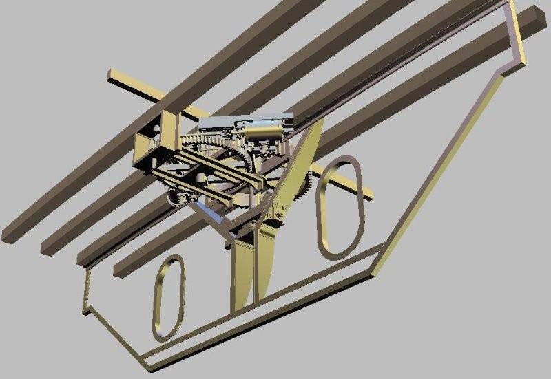

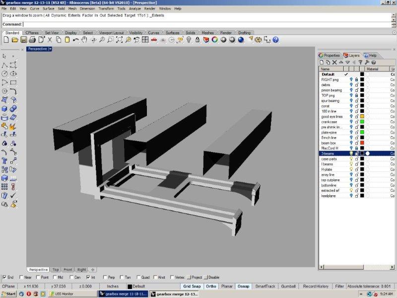

DuCoin, the project is still progressing. Here is a sketch of the H-frame Ericsson used to support the central spur and pinion. It is a 3D composite from 2 different 2D source drawings. The top view (and dominant dimensions) came from the Stevens collection, the side view came from the Mariners� Museum.
There was a thrust bearing in the middle of the H-frame crossmember. The exact structure of the crankcase is still up in the air. I am thinking it will solve itself as I add other components in and around it.

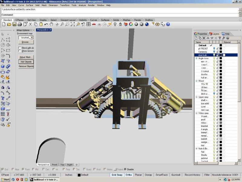

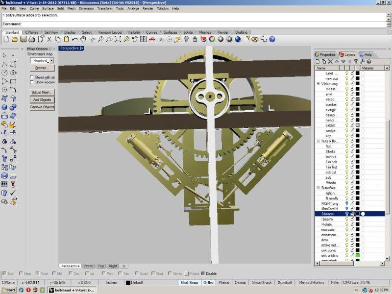

Switched from Rhino3d 4.0 to Rhino 5.0 beta. The new software is 64 bit. It really helps make the larger files in this project more manageable.
Today I installed the engine and the gear train, so finally we have an overview of the turret elevating and drive machinery. This would be how it looked under construction, around Thanksgiving, 1861. The point of view is looking forward and up from a vantage point below the ship's galley area. I turned off the steel bulkhead for visibility. The longitudinal metal beam seen above the deck beams is the floor beam of the turret.

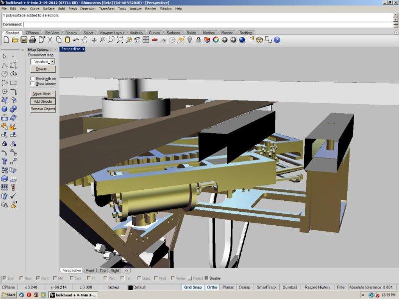

The height of the engines within the gearbox is fixed by the position of the crankshaft throw. This is a position we can find on good, clear drawings. Here is a glimpse of the two connecting rods, now in place on the crankshaft. I treated the V-twin engine as a "group" and positioned the whole assembly, vertically, using the crank throw, at the left of this image.
It was a pleasant surprise to find that the top of the frame of the portside cylinder fit precisely to the bottoms of the overhead deck beams. Bear in mind that we are fitting a USS Monadnock turret engine into the USS Monitor, on the assumption that the two engines are very similar. In fact, the Monadnock engine fit into place very well, perhaps exactly.

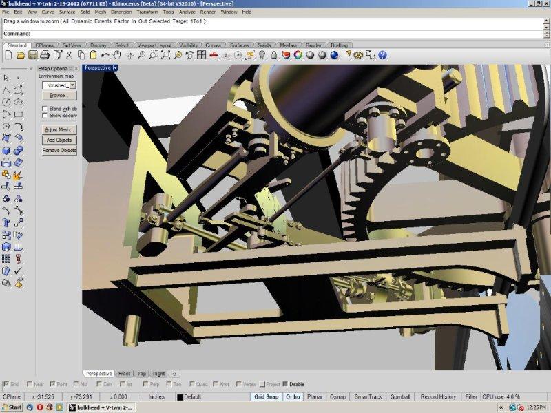

From the McCord collection, it is clear that the bore and stroke of the Monitor's turret engines were 12" and 16", respectively. Yet in some 1997 CAD illustrations of the turret engine, we find cartoonish cylinders with tiny diameters. I got another clue today about why these artists drew such skinny cylinders. It turns out that if you view the whole assembly from the top, this is what you see:
The hole in the engine frame in effect crops our view of the cylinders from above, so that they appear to be long and skinny. If you were working from a murky overhead view, it would be easy to assume the edges of the hole in the frame were the edges of the cylinders. In fact, seen whole from below, the cylinders are robust. They look like this:
It was sort of amazing to see how everything fit together without physical interference. I was worried the valve gear, which is all over the place, might be snagged by a gear, but there are no such problems. The system needs bearings next, and framing. Two vertical stanchions flanked the crankcase on either side. Ericsson used them to support the weight amidships of the crankcase, gearbox and spur gear -- and he also used them to form the legs of the galley stove.

That is amazing work - especially that the pieces fit into place without interference. That's quite a testimate to your modeling skills and ability to interpret the original drawings - congratulations!
