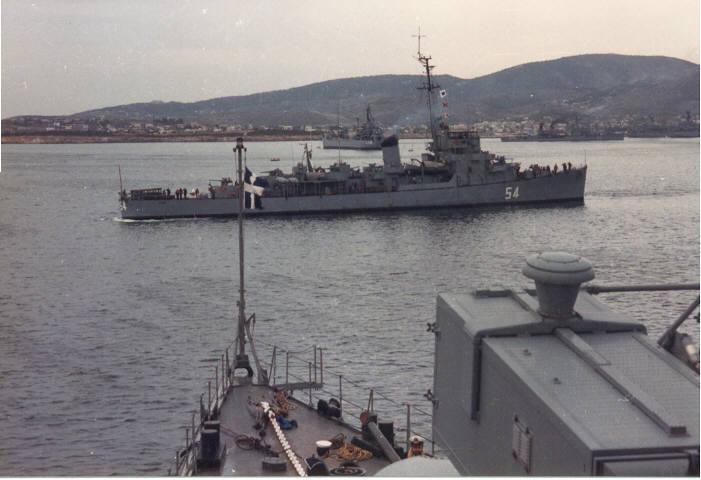

This is for timmy. This is HS LEON (lion in greek) ex USS Eldridge sometime in the early 90's

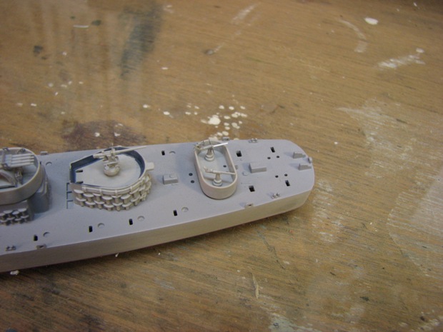

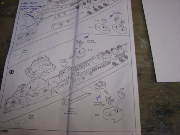

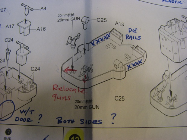

I started working on my USS England again after 22 months of working on other projects. I decided to waterline my kit and I cut off the lower hull. I then moved on the the guns. I'm using Gold Medal Models PE on my build. I finished the 1.1'' gun that I had started on earlier and the worked on the 3" guns with no problems. I then turned my attention to the 20mm guns. I cut off the barrels and replaced them with .015 plastic rod. I think that .010 rod would have been a better size to use but I had a hard enough time using the larger .015 rod. I then cut off the shoulder supports and replaced them with GMM's PE parts. I decided to mock up the ship to see what it looked liked and that's when I found a problem. The 20mm guns are too long for the gun tubs.
You can see in the picture that the kit gun and the reworked gun are too long. The only way they fit in the tub is to turn them at an angle. The bridge guns have the same problem of not enough room.
Paul Champigny's "Building the USS England" in the November 2008 Fine Scale Modeler shows this problem with better pictures than what I have posted. Paul used the GMM PE also on his build.
I don't know if the aftermarket guns would be a better fit. Maybe someone who has replaced to 20mm's with aftermarket guns could let us know how they fit.

I had the same problem, Gordon, hehe. None of my guns fit normally either, a problem exacerbated by my choice to use the kit shoulder rests as Mk14 computerized sights.

Granted I haven't copied & rescaled my plans, but is the sense that the guns are too big or the tubs too small?
- Posts: 12444
Re: Calling all USS Buckley / RN Captain class (DE) fans
Guns too big. They're 2/3rds the length of the 3"...
Comparing them to Dragon's 20mm makes it very obvious the size inconsistency.

I took the time to break open my DD boxes and check the size of the 20mm guns. I took four different kits by three different manufactures and set the guns side by side. (Trumpeter:England,Tamiya:Flecther, Dragaon: Buchanan and Trumpeter: Sullivans) The first three are very close in size but the Sullivans has 20mm's that could only be used by a twelve foot tall man. They a huge compared to the others. I then looked at the size of the gun tubs on all four kits and the England's were smaller in size.

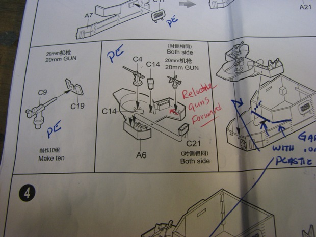

The solution to the four bridge guns being too big is simple. Just move the four 20mm bridge guns forward. Remove the raised locating points, fill in the holes with plastic rod and mount the guns forward to where they look right.
The easy soultion for the midship and strern 20mm mounts is the positon the guns at rest with the barrels pointing upward covered with canvus (tissue) or rebuild the tubs bigger from scratch. This is all hind site for me now but if I ever do another Buckley Class ship, this is what I'm going to do.

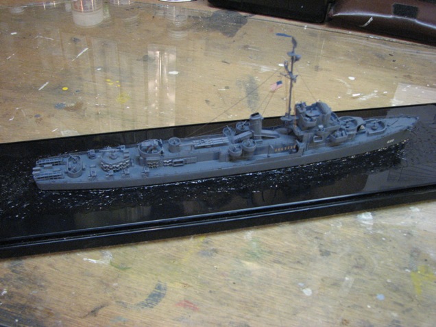

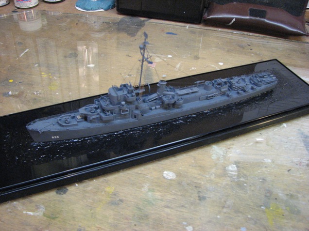

Here's a couple of pictures of my wip England. I still have to put the hose reels on, add the ship's boat and paint the water.
