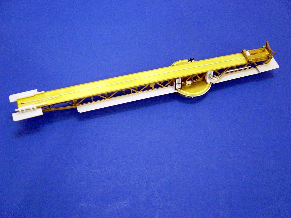

Hello again all. :wave_1: Here's a new update on the Indiana project. I have completed the aircraft crane on the stern as well as the catapaults. I have also added most of the deck hardware. There's alot going on at the stern section, just as much as the rest of the ship. I never seem to run out of things to make! Looking at photos of BB's, one does not comprehend how much "stuff" there really is, till you start to build it. Wow..... in any event, things are slowly but surely moving forward. Lets take a look.............

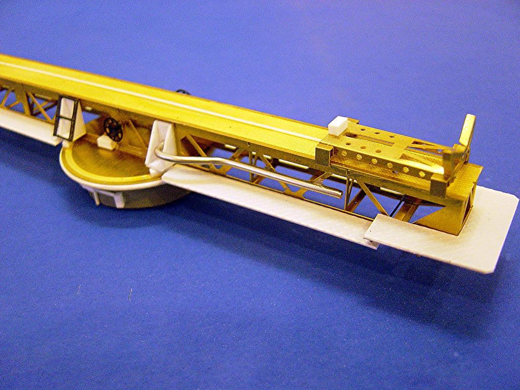

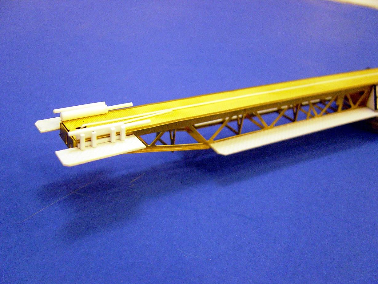

An overhead view of the left side of the catapault. The basic structure is photo-etched brass from JR Haynes. It comprises 14 individual parts. The aircraft cradle also comes with it, and has 6 parts. Anything not brass I have added. Note the catwalks. These also come with the catapault, but I found them difficult to bend into shape, so I made my own from .020 diamond plate sheet styrene.

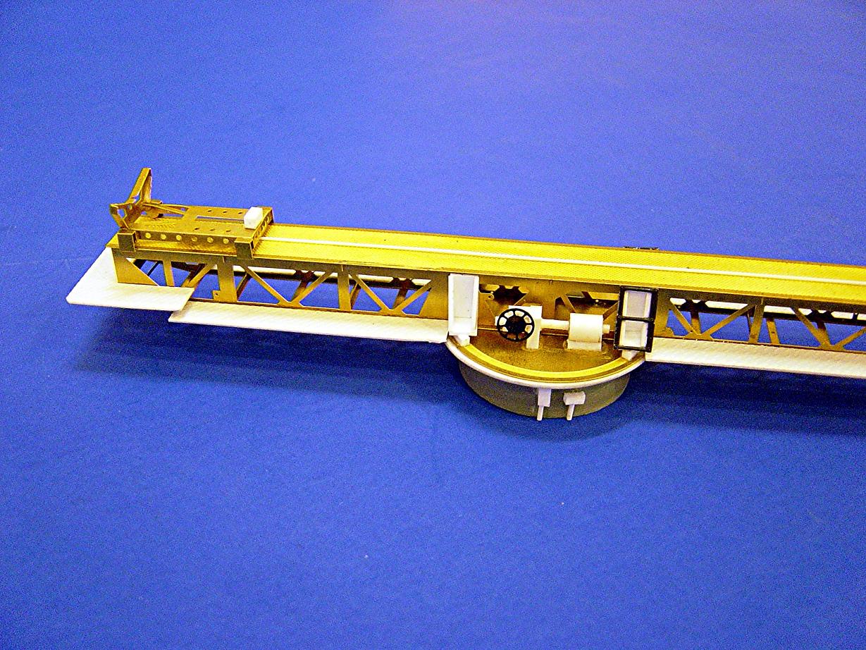

Here's the right side of the cat. The Haynes brass is very well done, and I found assembly to be fairly simple and straightforward. A very accurate piece. I was very happy with it, in spite of the fact that much has to be added.
Close up shot of the aircraft cradle. The OS2U scoutplane will rest here. Railings still need to be added to the catwalks, but I can't find any in p/e that are the correct size. I will either have to make them or just delete them Again note the scratch styrene parts.
The forward end of the cat. Note the "bumper" set up for the cradle. These were hydraulic, I assume and stopped the forward momentum of the cradle. The aircraft were accelerated from 0 to 80 mph in under 2 seconds. A 5" charge without the projectile was used to "fire" the aircraft off the cat. Bumpers are made from styrene rod and consist of 8 pieces.
Mid section of the right side of the cat. Note the motor assy on the base. I believe this was used to pull a cable attached to the cradle, to return it to its firing position. Beneath the brass base plate is a circular piece of .030 styrene, as the plate is too thin when viewed from the side. Beneath that is the actual base of the cat, made from butyrate tubing. Note the small electrical box details. Handreel is an HO freight car part.

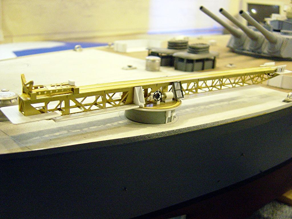

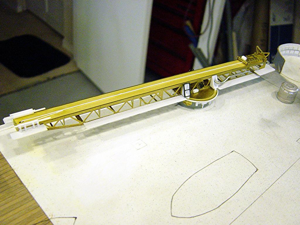

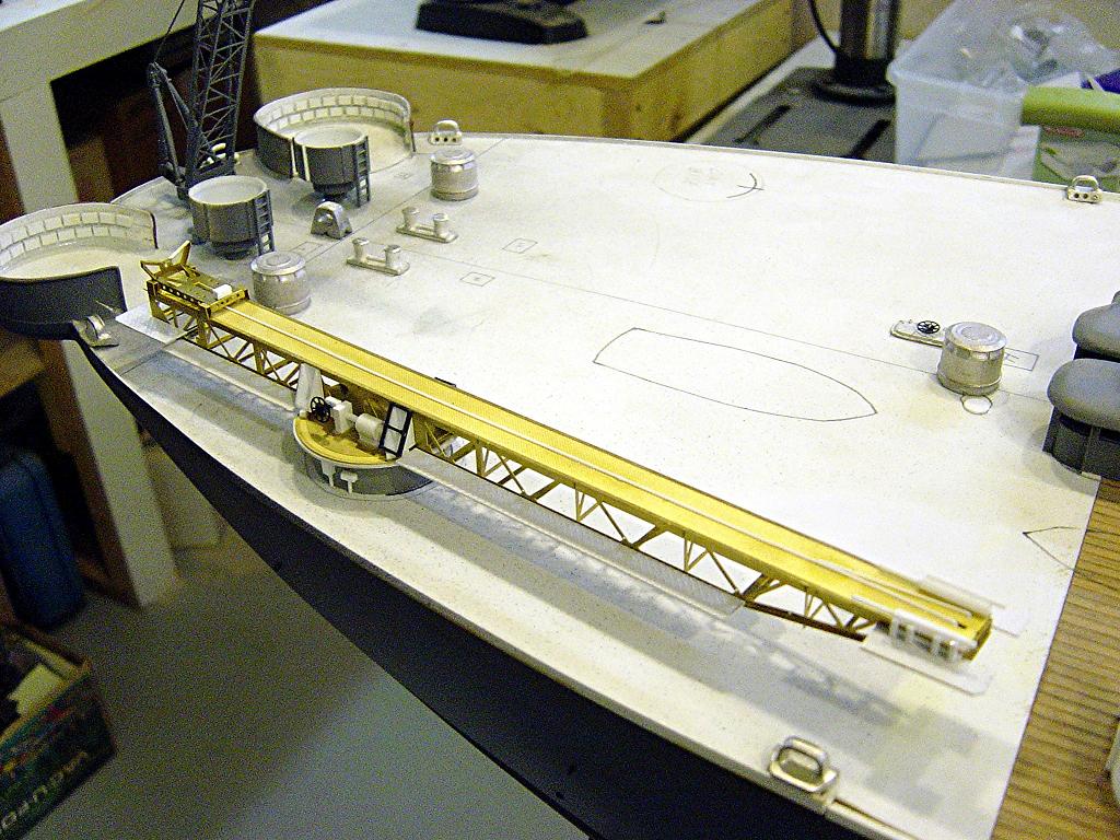

Nice overhead view of the stb. cat in it's relative position on deck. Portside not quite finished yet, but you get the idea.

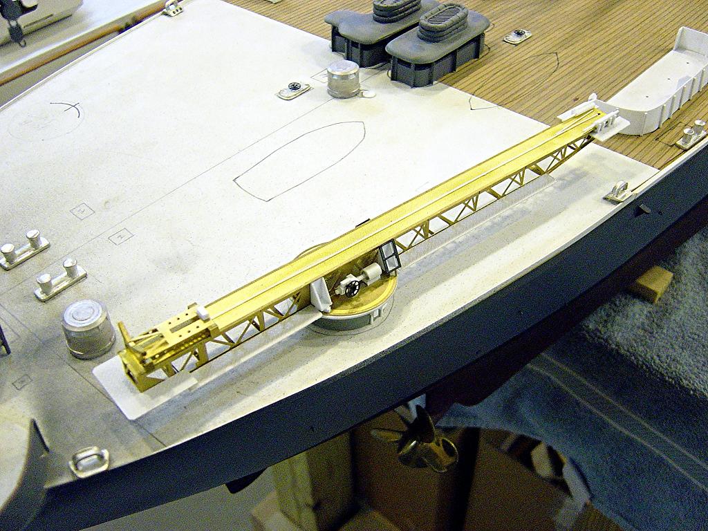

Another view. Note some of the cast metal deck fittings here.

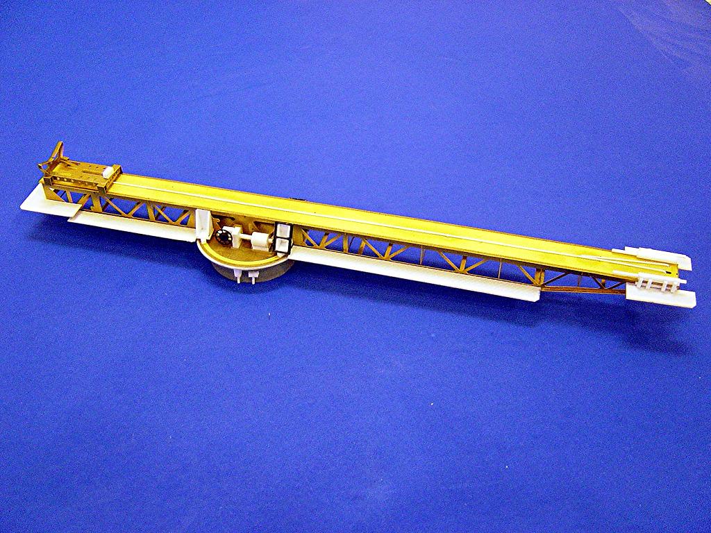

The cat viewed from portside.
Real nice detail view looking to port.

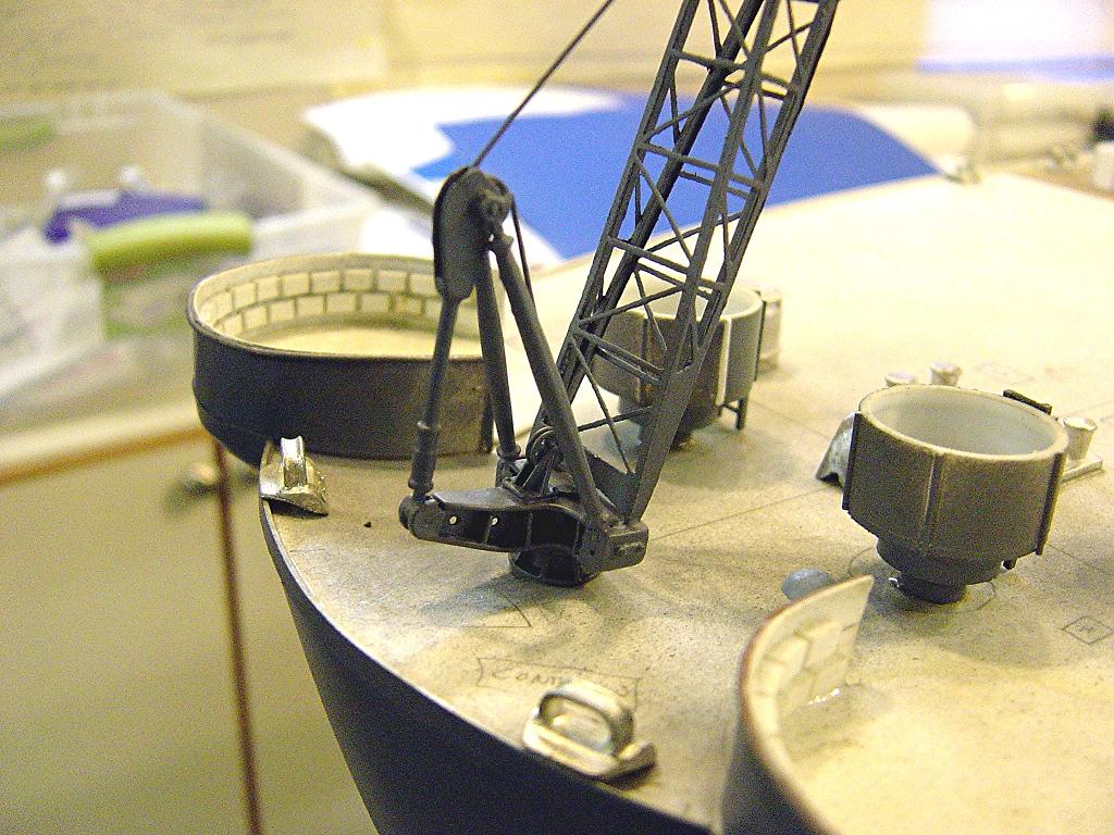

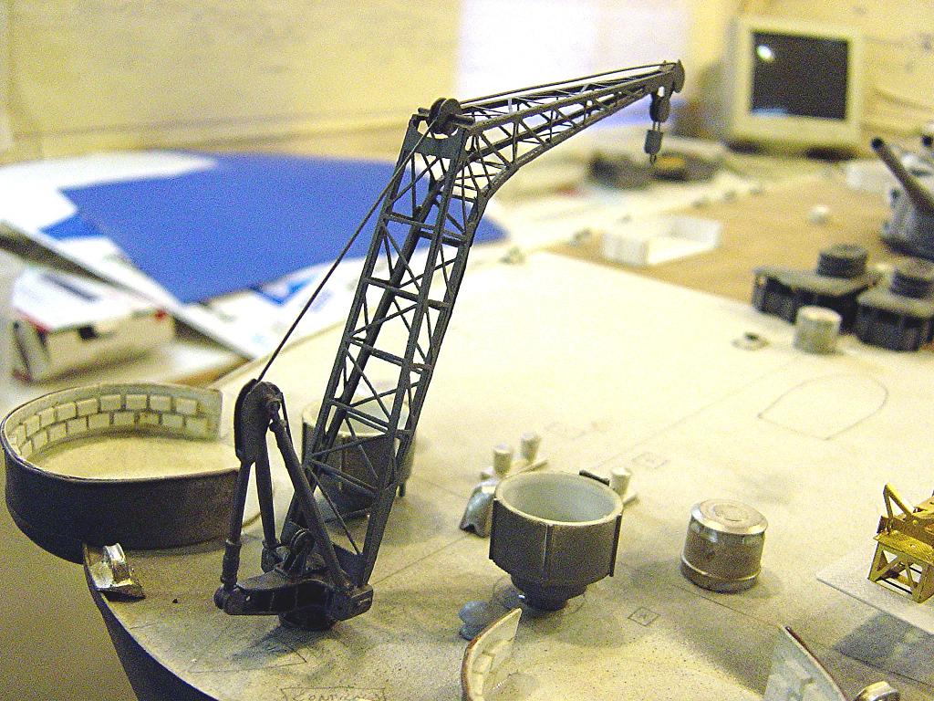

Here we have the aircraft crane. This is also p/e brass from Tom's Modelworks. Not to knock their products, but I find them too thin. The crane consists of 7 pieces. The sideframes were beefed up with .040 sq. styrene to stiffen the structure. The base is another JR Haynes product and is cast metal consisting of 8 pieces and is very well done.The pulleys and the hook are styrene that I fabricated. A bit more rigging has to be finished here.
A close up of the crane base.

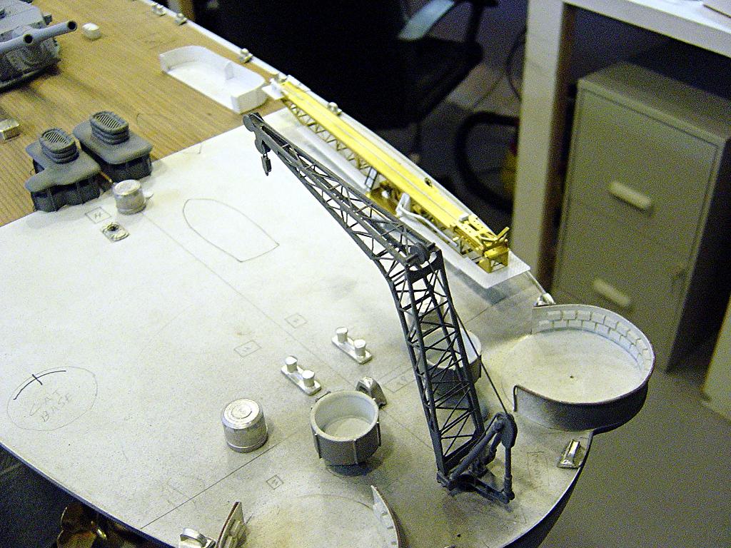

Overhead view of the crane assy.

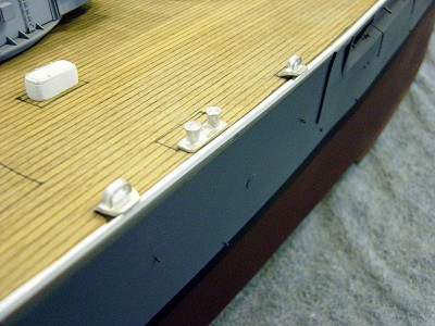

Aft view here looking fwd. showing the cast metal deck fittings I have added. From Bluejacket Shipcrafters.
Forward view here, looking aft showing the deck fittings.
Close up of the deck fittings. Pretty good cast metal, but require some clean up.
