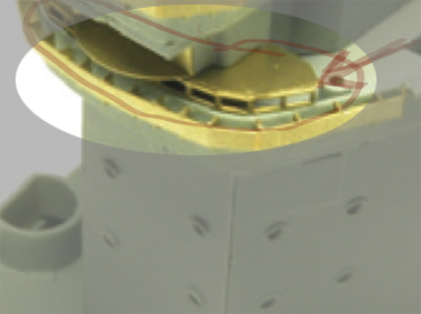

Chaps,
Can anyone help me in my hour of need, please?
I have had a calamity with the window strip of photo etch just beneath the compass platform on 1/350 Warspite. Is it the admiral's window? (It's the next section up from the main control tower. Please see pic.
Does anybody know where I can buy a replacement without having to buy the whole photo etch sheet again (It's from the Academy Premium edition - but am sure other versions would fit).
Pontos don't reply to their emails unfortunately, as I have already tried that avenue.
If anyone has a spare one (long shot) or knows of anyone who makes them, please could you let me know? I am willing to pay of course.
Thank you in advance.
ps: tjstoneman - thank you for your reply regarding the casemate guns (my error putting casement!). I appreciate your help.
CNH
CNH
