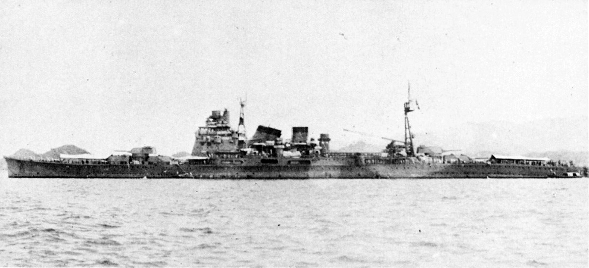

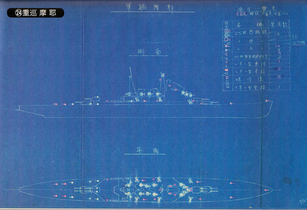

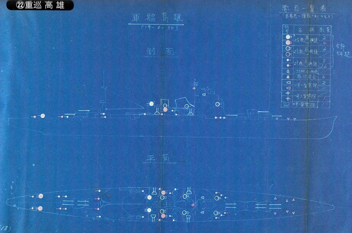

I don't remember where I first read this, but it seems the small gap between the midships superstructure and the catapult pedestal was plated up on Atago and Maya but not Takao. Dan can you confirm?
Aoshima's Takao kits ('42 and '44), their Atago '42, the Fujimi Takao and Atago all have the gap. Aoshima's Takao 1944 has a solid bulkhead going across, I believe it uses the same hull mold as their Maya. Are they right?
You probably read it in this thread, as I had posted something about it a while back. Some Japanese websites have picked up on two photos of Atago (one in late 1941, the other then or sometime in early 1942) that show Atago with this gap closed off. Neither photo was taken from close-up. These sites surmise that the gap was plated up. Unfortunately, there is nothing in the official literature to confirm or deny such a change, nor are there any other photos clear enough to absolutely confirm it.
So, it is possible. But, it is also possible that the openings were just covered up with canvas on a temporary basis. Also, the Fukui AA fit drawings of June 30, 1944 indicate that the aperture is still there for Atago as well as Takao, whereas the one for Maya shows no aperture. Given that Maya was heavily reconstructed in this area, I feel it likely that her (Maya) plating was solid back to the the catapult sponson.
(Note about the first Atago photo - she is not camouflaged. The discoloration was caused by water drops on the original photo.)

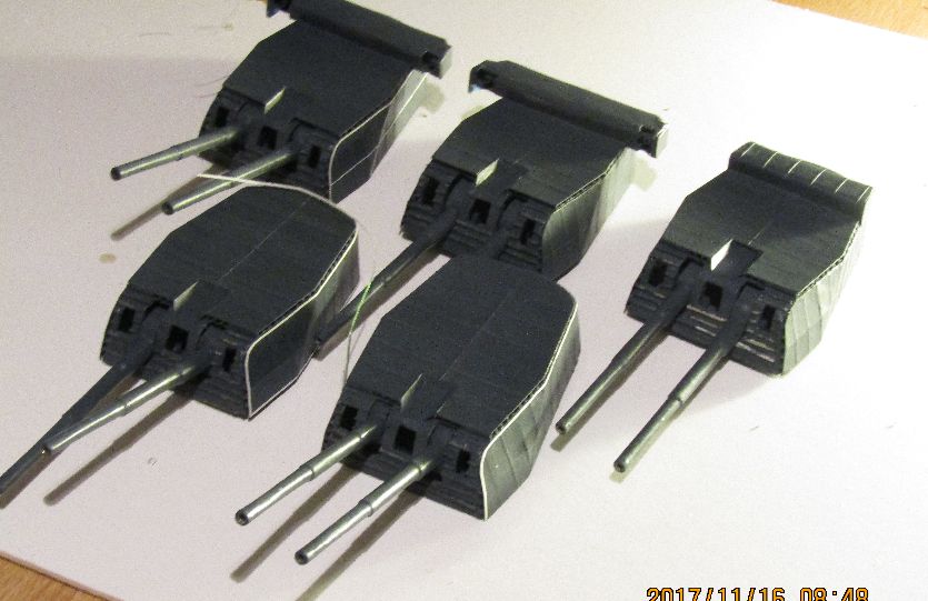

Post by Mutsuo Sasaki »
hi,all
Feeling urged to post something re. a new build of this class cruiser and by Dan�s recent suggestion,almost everything is in a slow-motion picture. Have so far managed to form the hull (in waterline, again!) with some difficulty as i had to make drawings by myself in 1/00 as a starting point. Firstly,the bread & butter in two sections,so i can have it seperated in case it needs to be transported in the future.
mucho,
Mutsuo Sasaki
Posts: 296
Joined: Tue Dec 10, 2013 3:33 pm
Location: The Savo Island
posting-part 2
In the middle of tackling with make of 20.3cm main guns and casemates....
Studying of steel-plates on the deck was under focus,too.
Still a long way to go.
mucho,

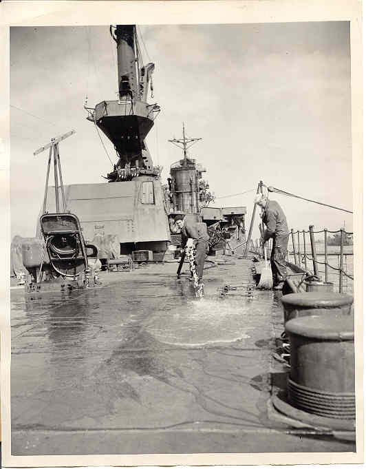

About question of brass strips by Mike, IJN did polish any object/utensil made of brass. That was according to rules of maintenance of deck cover such as linoleum,teakwood etc. Though,many of brass products were painted in grey color to save maintenance time during the wartime. I would think brass strips must have been an exception. Several photos can account for it,the attached being from Nihon Rikugun-Kaigun Gunso site. You got side works; pls guess the name of these crusiers. Am doing make of the gun houses first, the bridge and hull structure later...
mucho.,
Have some more pics to follow, these were rejected due to bmp images, changing them into jpeg afterwards.
I may be posting here, coz Dan K. started this up. :d
Mutsuo Sasaki
Posts: 296
other pics showing brass strips that glitter.
mucho
