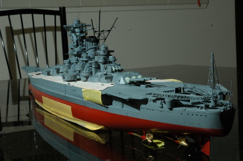

Timmy C wrote:And I like that your deck does not have any oversized planking lines.
I used Northeast scale lumber's 0.8mm wooden strips. Their widths are actually still overscale, but less obviously so than some other widths I could have chosen. The flip side with using strips so thin and narrow is the quality control at NW scale is not good enough to ensure the strips are of uniform width and thickness, so some times I had to fit a strip in edge wise so as to make up for the gaps that resulted from strips that fitted ended to end but were not of quite the same width. Also extensive sanding was needed because the strips were not all of the same thickness, so in a slant light the unevenness of the planked surface became quite obvious.

I think my eyes are deceiving me now :big_grin: is that really your model CHUCK :heh: .... awesome job :thumbs_up_1: :thumbs_up_1: her bridge looks flawless Chuck, i know it took you a a while to get to this point but you are getting paid back sir. can i ask you something, the 13 mm mgs on the tower where did you get them?.

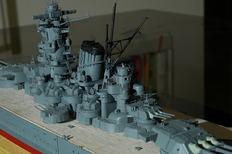

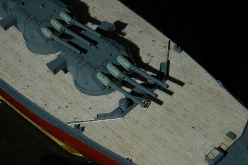

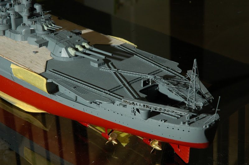

philman62 wrote:Outstanding, Chuck. Please, post more detailed photos (of the deck also).
Thanks. Here are some more photos. Notice the unevenness of the planked deck. The antenna support on top of the 6" turret is built to rotate like on the real ship. In the photo it is skewed because currently no antenna aerial has been rigged to keep it straight. One 25mm mount is missing. It was dropped somewhere and a replacement need to be made.
Lion Roar's aircraft crane and catapults are real gems. They are not only accurate and detailed, they actually take a lot more trouble than anyone else's PE parts to reproduce many of the separate working parts inside in 3D instead of just as 2D patterns on a single PE sheet.
Another shot of the wooden deck. The slanted lighting here also shows up the uneveness of the planks. I did not remove the deck details prior to planking the deck. Instead I planked around the details, using edge pieces like they would on a real ship. This additional work added little to the appearance of the result but increased greatly the tedium of the work. So I probably won't try it again. The ventilators behind the breakwater are not as accurate as could be. They actually straddle the breakwater rather than rest behind the break water. But they are far more accurate than Tamiya's original.
I accepted the Kure interpretation of the ship's stern, with a prominent towing fairlead, over more recent interpretations which suggested the ship carried either depth charges or aircraft fuel drums on jettison racks at the extreme stern. I also accepted the kure interpretation of the boat tube doors and traveling crane overhang.

I will apply some kind of age coloring to make the deck a little more gray, and also seal it with some sealant. But to correct the bowing of some planks, I impregnated parts of the deck in very fluid CA glue. I am currently experimenting to determine what effect CA glue would have on various coloring and sealing agents.

Nice looking deck :thumbs_up_1: :thumbs_up_1: i don't know if i could finish it using that size of planks..
