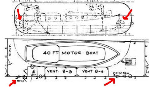

Have all the main components of my first boat pocket made, but in looking at the HNSA plans, I see that the port forward pocket has two "disc fans" under the catwalk...does anyone have any more info on what these look like or can point me towards a picture of them? Thanks!

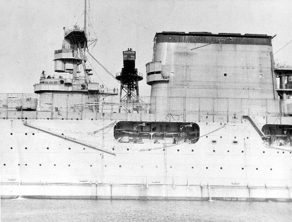

lvsquarerigger
Posts: 398
Joined: Tue Feb 17, 2009 12:26 am
Location: Albuquerque, NM
Re: Calling all USS Lexington CV-2 fans
Post by lvsquarerigger »
This is the best pic I have and if you zoom in you can see the two circles but they look like they are closed.
James

I'm guessing they are some sort of hull ventilation system, and I would assume that they have some sort of armored cover over them that can be closed when the ship goes into action...I'd like to try to find more info on them, but if nothing else, I suppose I could just put down a thin circle of plastic to represent the cover and move on.
