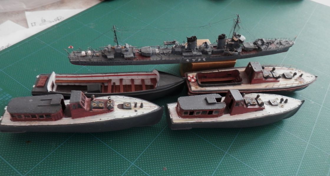

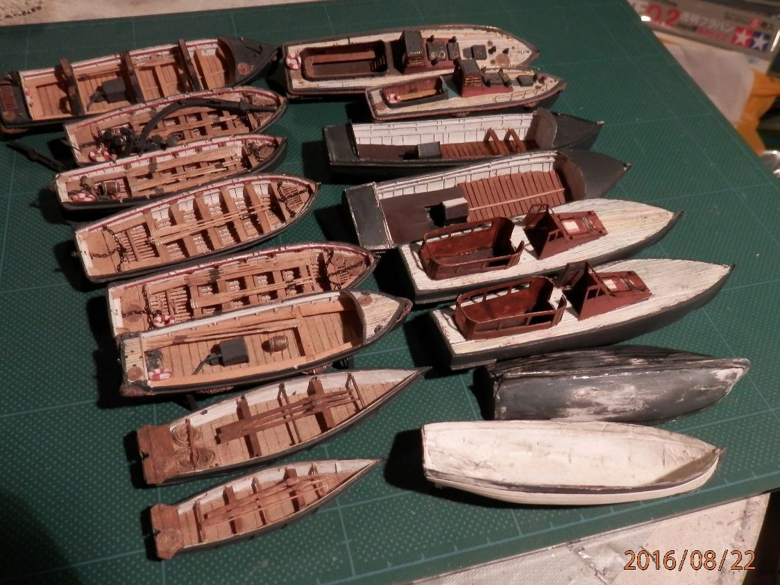

Have added 6 more boats to the making of cruiser Aoba�s. They are to go to Chokai 1944 when she left 1/2 cutters ashore for the Philipine Opr.Oct. the same year. Pls note IJN cutters have the upper belts(Jyotai= ??) painted in green and red color for starboard and portside.

Beautiful work on your small boats. How common was it to paint the stripes to match the colors of the navigation lights, like those on the cutters? Would boats of a certain type have those stripes, no matter what kind of ship they were on, or were they only on boats of a specific ship?

Besides cutters, i haven�t come across any sources regarding the painting of other boats. Take fx, 11m and 12 meter launches. They had oars as many as 16 (not only 4 )for the 12 meter launch. I�m imagining they also must have had their upper belts painted likewise.

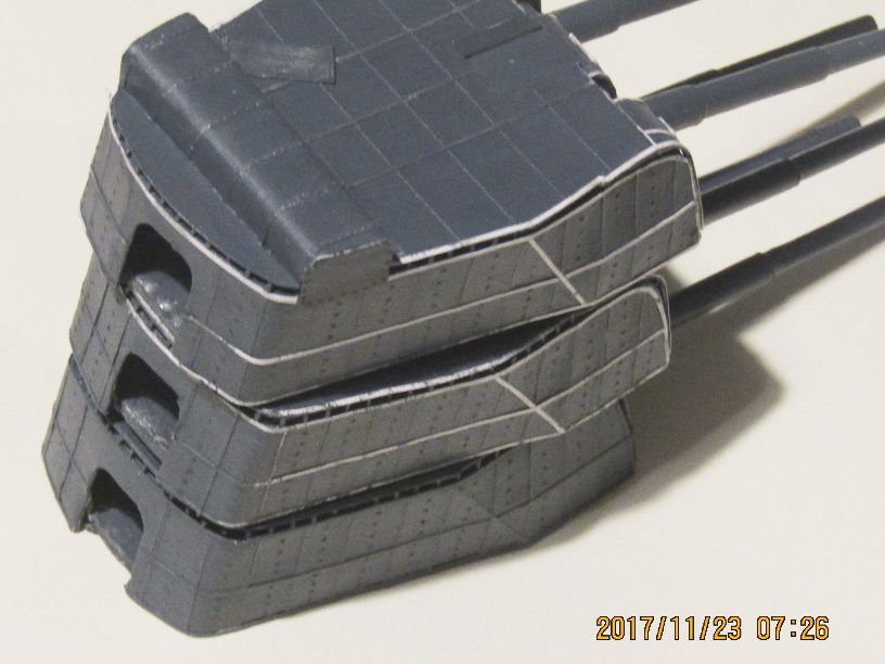

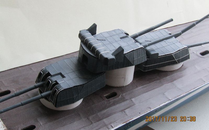

Beautiful turrets, Mucho.
Mutsuo Sasaki
- Posts: 296
- Joined: Tue Dec 10, 2013 3:33 pm
- Location: The Savo Island
danke sch�n,DanDan K wrote:Beautiful turrets, Mucho.

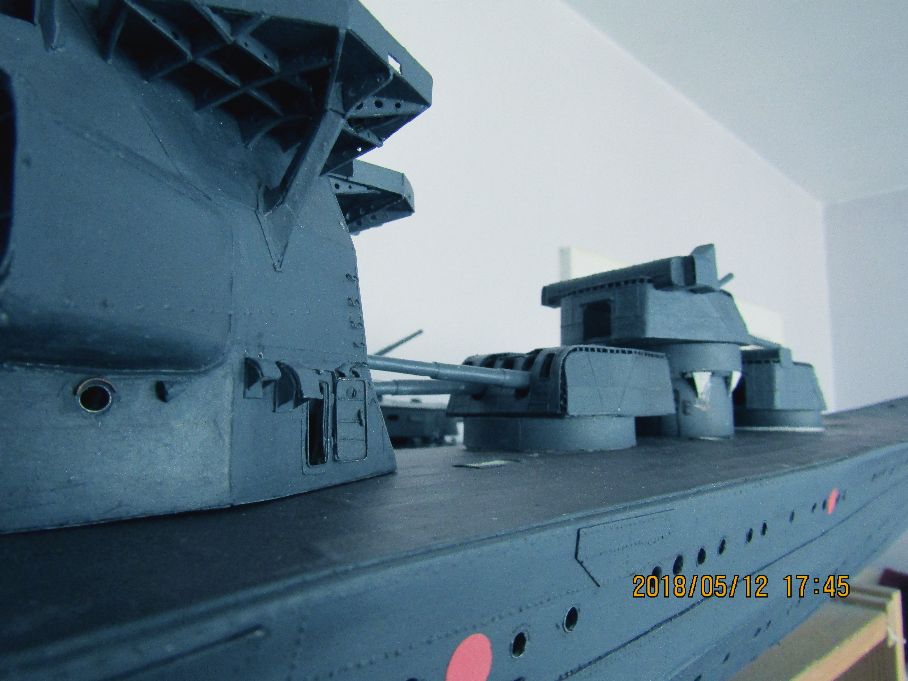

There is one minor mistake in my forming of the turrets,but, I hope it would be compensated by 2 new findings.They are visible also on the pic of the model of the turrets. Will be telling you later about where these are. Will be away in a mater of 3 days to Japan... am in the middle of a small chaos for doing miscellaneous preps.
As you already definitely know, Chokai will have more with minor modifications than this pre-war appearance.. I fear this tiny model will never see daylights as completed.

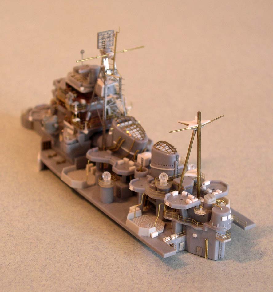

I'm currently working on the Fujimi 1/700 Atago kit with photo etch parts. I've been using other modeller's build photos and guides on the internet as my references, but I think I really do need to make a purchase on books, and on this thread I found out about the AOTS Takao book by Janusz Skulski. Problem is, on Amazon I could find this, and or this, and I'm not really sure which one would really get me the most bang for my buck? I know they're both quite cheap, maybe I'll just buy both, but surely they're not redundant?
Also, I'm toying with the idea of making the main/aft mast with brass (as I do want to learn to do rigging, and I hear brass is better for this than the flimsy plastic one provided in the kit), but I have no idea what size/gauge brass rods are used for a 1/700 scale... Again, I realize that this requires scratch building and soldering (both of which i've never done), it's just an idea at the moment..

I can check my Chokai and May tonight regarding brass widths. Atago and Takao differ only in small details; have you reviewed this thread?

The mainmast tripod bottom was the same for all the sisters. It was re-positioned and turned around in the Takao-Atago rebuilds of 1939. The main, 5 pointed star platform at the top of the tripod was also the same, save for the yardarms that were lopped off to either side. It was the top that was altered somewhat.
My Chokai/Maya builds used .030" brass rod for the main leg, and .025" brass rod for the supporting legs.

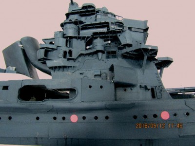

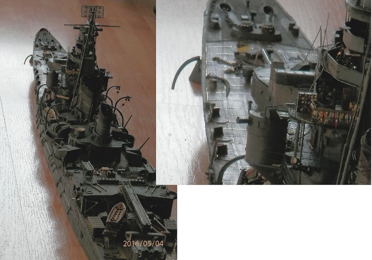

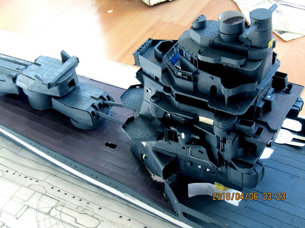

Some work in progress in the Chokai build 1/100.
13 months have elapsed since start of this build...

- Posts: 9037
Magnificent work, Mucho! I think you've made great progress.
