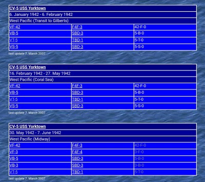

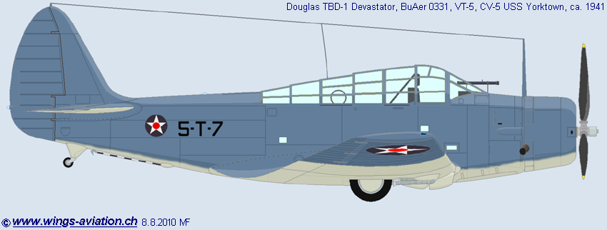

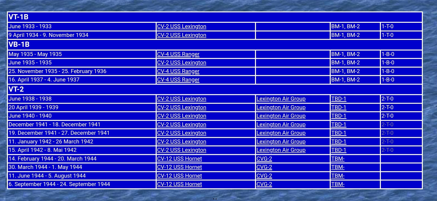

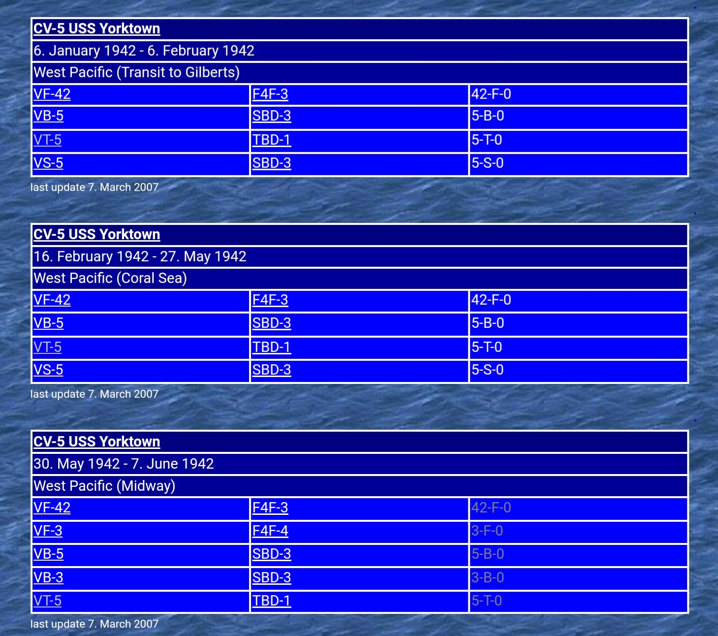

Thank you Devin for your reply....
I did some extra research and l found out on this website
http://www.wings-aviation.ch/24-Naval-W ... rktown.htm
That Yorktown never had VT-2 (Cv2 Lexington) but had VT-5.

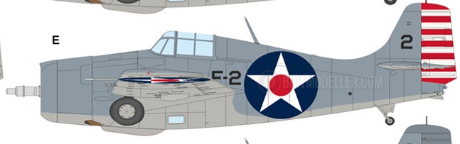

So l need to change the markings...that should be side # before star
Please correct me if l'm wrong
Have a nice day

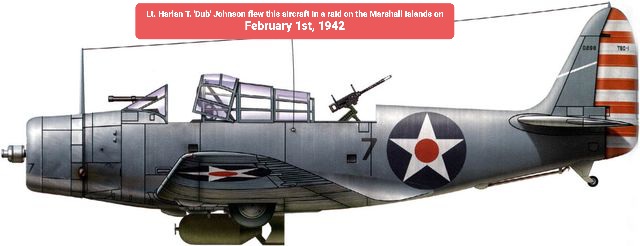

Please check also the pics of the markings of the other markings of the other squadrons
Have a nice day

Correct. That table looks to be accurate for February through May. After Lexington was hit, some of her aircraft landed on Yorktown, so post-battle you could have some of her birds on deck, but I don't recall how many or of what type.

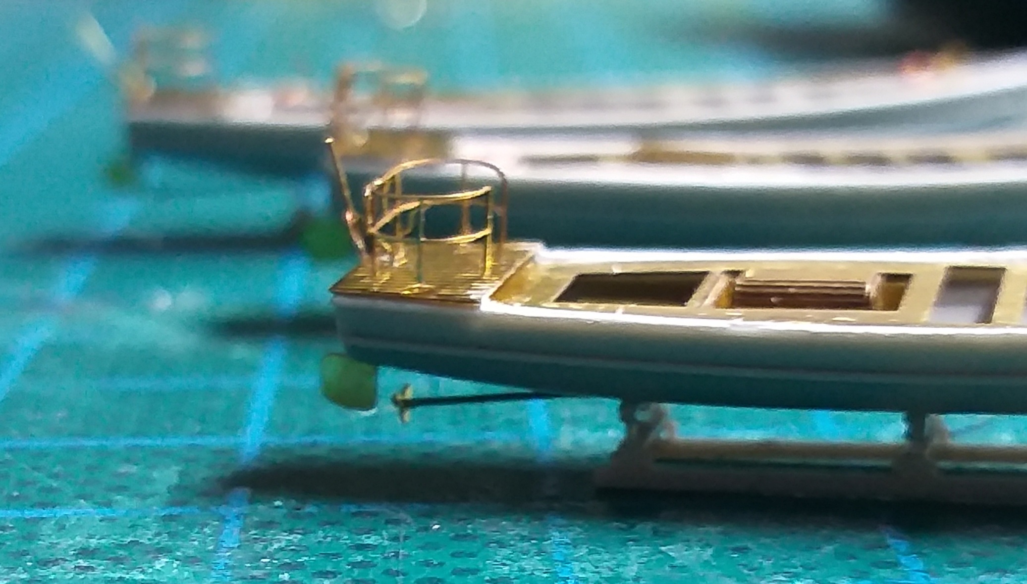

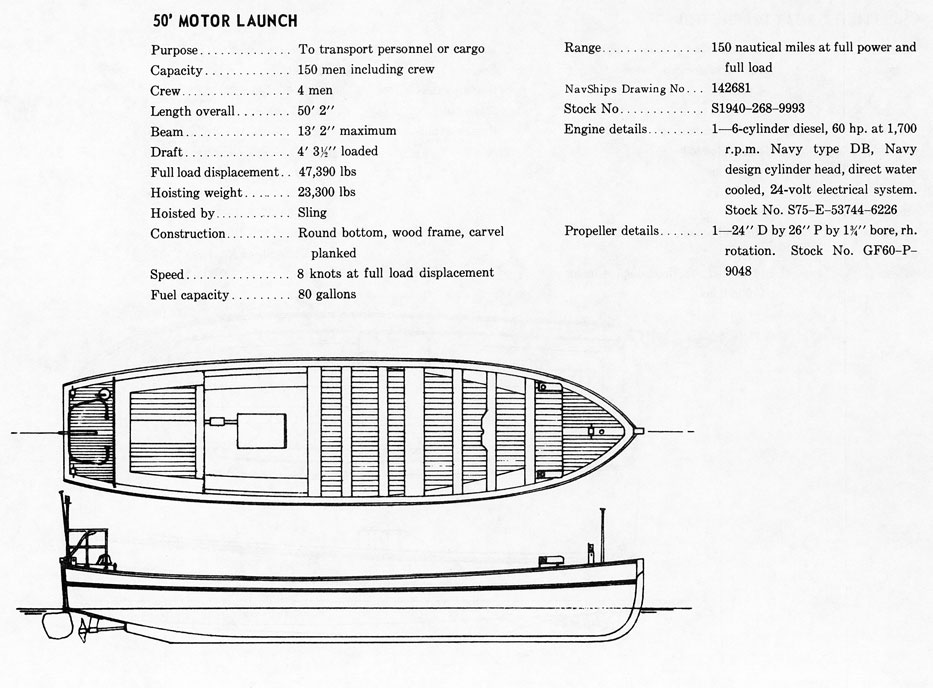

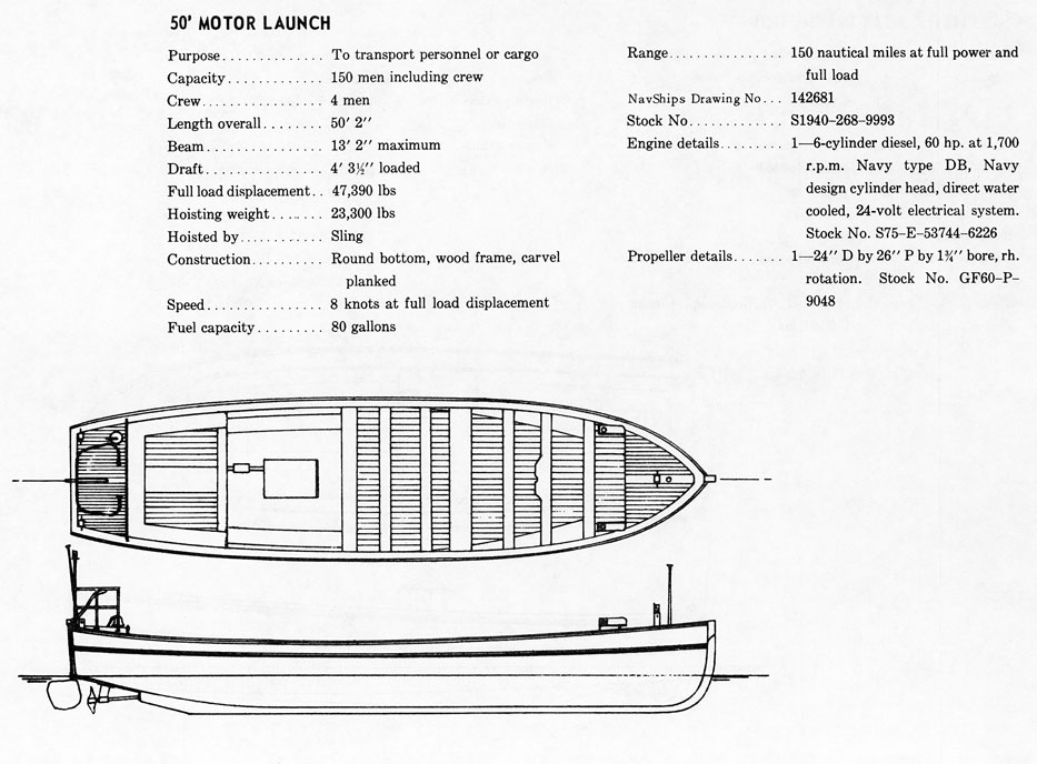

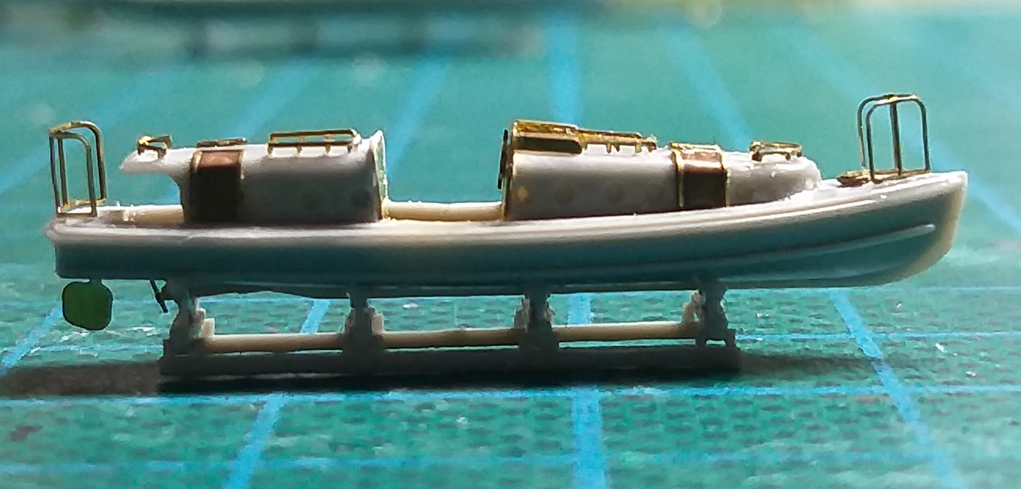

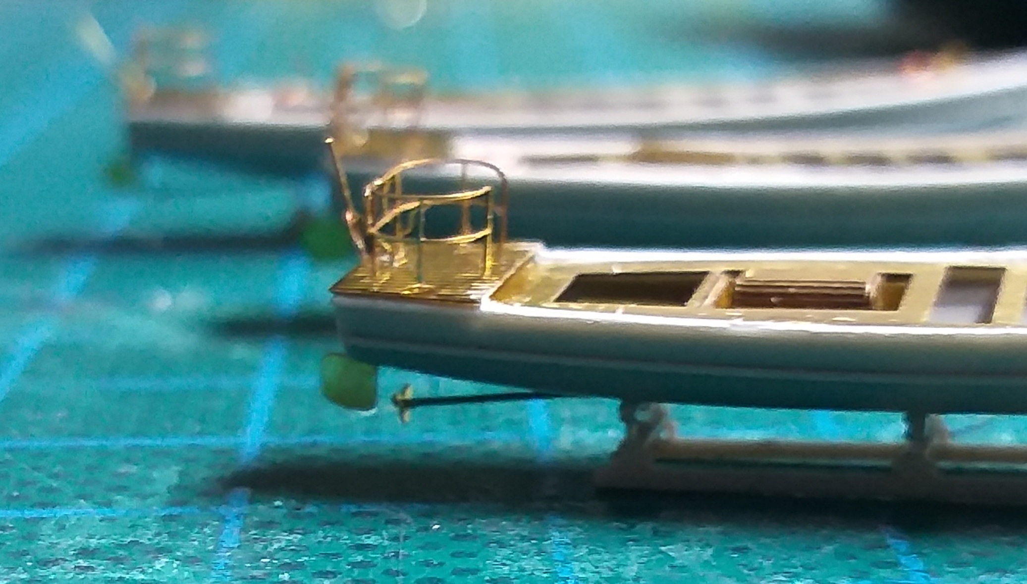

Dear all l need your help you will see here the picture of a 50' motor launch l need from you if you have any picture of those launches secured on the deck of the carrier...
Thanks in advance
Pic for reference
Greg
Thanks in advance
Pic for reference
Greg

the 50 footers would be in the boat bays plus 2 x 40 footers & a 35 footer while other 40 footers would be parked alongside the starboard side of the island.
CV-5 USS Yorktown Booklet of General Plans (1940) https://archive.org/details/cv5bogp1940

Thanks FFG-7for your reply...but l need to see the ropes or other means that secured the launches if you can help l really appriciate

does your pe set include boat cradles?

Sorry FFG-7for the late reply, yes they are all on their cradles

take a look at these links that shows different ships' boats.
https://www.alamy.com/a-detachment-of-u ... rchtype=0/
viewtopic.php?f=46&t=103218&start=840

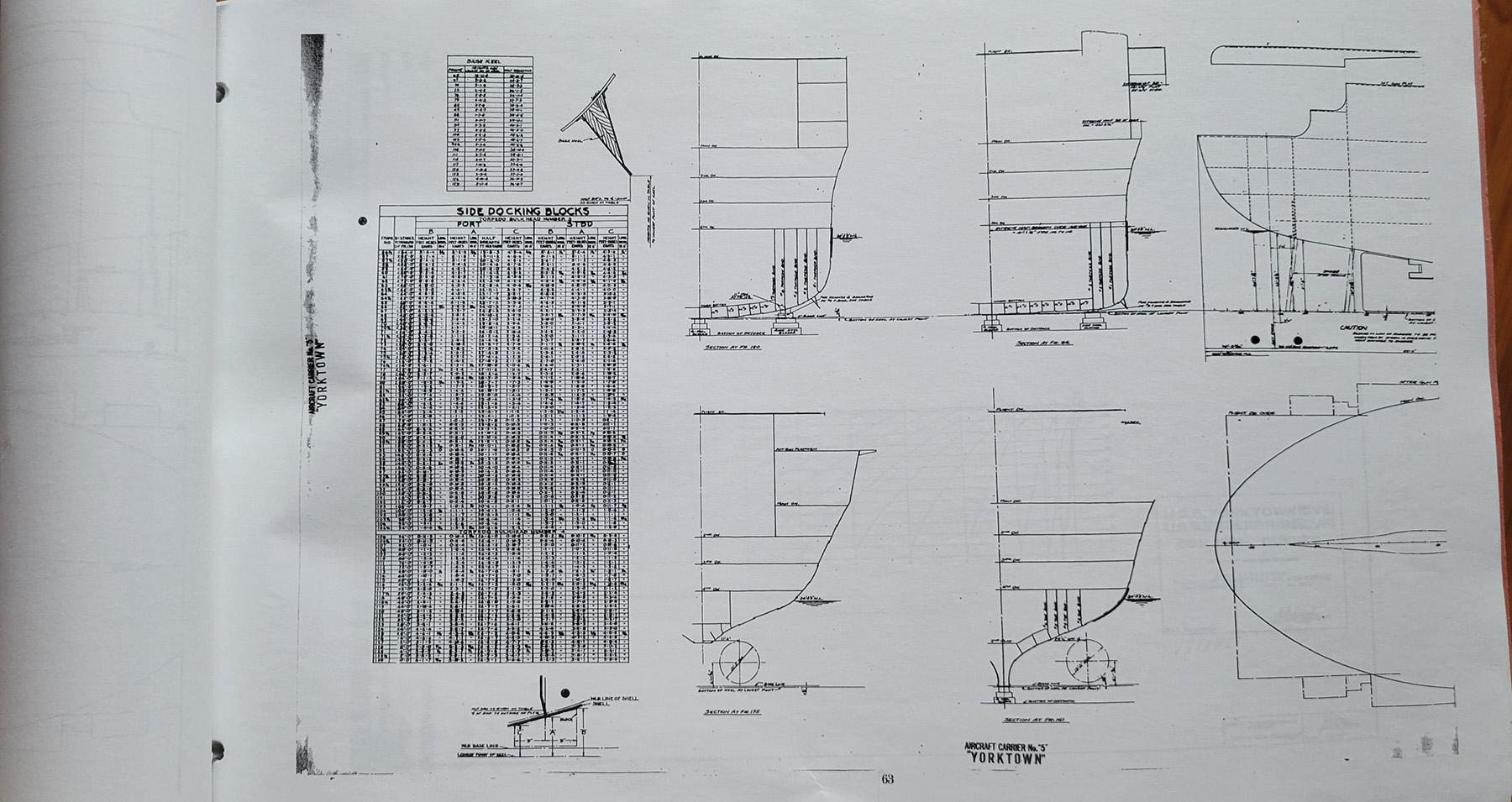

I'm gathering resources for building Yorktown mid to late 1940. I'm hoping to get answers to the following questions:
Did Yorktown have docking keels? If so, are there available plans that show these?

None of the plans I have show external docking keels. There may have been some internal structure serving part of that function, but there was nothing outside of the hull other than the bilge keels.patrickmil wrote:Did Yorktown have docking keels? If so, are there available plans that show these?

I contacted Devin at cv5yorktown.com and he looked through the giant book of plans from Maryland Silver Co. and found nothing resembling docking keels. We're at the same conclusion. In fact, he stated "It looks to me as if what they used for �keels� are the prop skegs, and the flat portions of the hull, but I don�t see any specific protrusions that one would call docking keels."Tracy White wrote:None of the plans I have show external docking keels. There may have been some internal structure serving part of that function, but there was nothing outside of the hull other than the bilge keels.patrickmil wrote:Did Yorktown have docking keels? If so, are there available plans that show these?
Appreciate your efforts in looking. Thank you!

I emailed this docking block plan to Patrick. As Tracy said, I don't see any docking keels. It looks as if the shaft skegs are used for some of the blocking, but otherwise the hull simply rested on the docking blocks.
