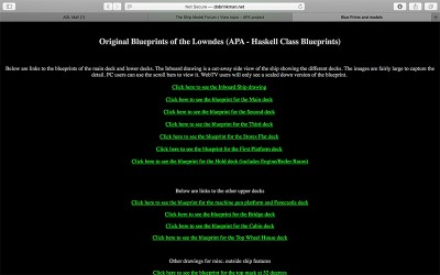

Ian asked about my sources. USS Lowndes has a site "Dobrinkman.net" which has links to some reasonably detailed plan views of the various decks and equipment. This was helpful, showing various hawser reels, and other equipment locations as well as being a fairly decent generic set of Haskell drawings.

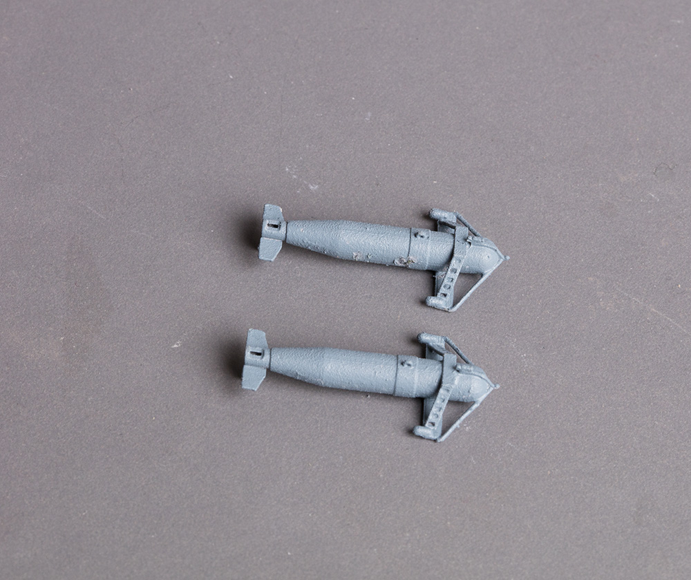

A few more items today: Designed and printed a pair of paravanes as the one's I had built were nice enough, but a little too big. Painted and resting in their new home; Attached the 5" 38 to the fantail via sinking a round magnet into the deck in the training circle and glueing a trimmed piece of sheet metal to the bottom of the mount, such that it sucks and holds the mount into the training circle. Both rotates and is removable.

Ah Pair of Vanes, or a pair of paravanes (is that four?).
