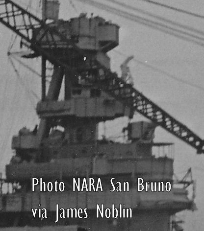

DennisJP
Re: Calling all USS Lexington CV-2 fans
ModelMonkey wrote:Seeking help in determining the configuration of the Flag Plotting Station enclosure as of May 8, 1942.
Knowing that there is not much information available, and having studied the available references and followed the discussion here, what is the current conventional wisdom regarding the enclosure's shape, extents aft, number of windows, and height?
It's clear from the photos presented in this thread and elsewhere that the Flag Plotting Station (the level above the Pilot House) was lengthened forward at Pearl Harbor in April, '42, and it and the splinter shield look very much like Saratoga's. The enclosure is barely visible in May 8th photos, but had not yet been installed at the time of the superb James Noblin photo (posted again below for reference).
Martin Quinn posted documentary evidence from BuShips stating that the enclosure was to be fabricated to a design using SPS with shatterproof glass. The details, extents and dimensions remain awfully uncertain since good photos of the enclosure seem to have been lost to history.
It could be speculated that the enclosure follows the angular splinter shield and that there was probably one shatterproof glass panel per shield facet. The top of the enclosure would probably be level with the roof of the Flag Plot. How far back it extends could be extrapolated from the number of glass panels visible in May 8th photos, assuming that the glass panels were all the same size, which seems reasonable. But I have no proof for any of this - yet.
Also seeking any other information regarding features of the bridge tower specific to April-May '42 (not sure if "island" is the correct term for CV-2 class). For example, there appears to be a small, roundish platform partially enclosed by a solid shield fixed to the forward face of the wind break on the upper top Fire Control Station (the large uppermost platform on top the tripod) in the Noblin photo. Very interesting feature and certainly there are more.
The boxy structure under the Spotting Top I believe to be a Radio Direction Finding Station. I think it is the same structure that appears in May 8th photos. Is that right?
Any help, even reasonable guesses, is appreciated.
hope this helps. Also look closely behind the construction going on. You will see in the middle of the picture a sky loook out platform like Sara had after rebuilding. Just a deck lower.
- lvsquarerigger
- Posts: 398
- Joined: Tue Feb 17, 2009 12:26 am
- Location: Albuquerque, NM
Dennis, if you are referring to that piece hanging down just behind the FC radar I think you are referring to the top of the former 8" director. The odd shaped part had windows that would fold down and allow spotters to have an unobstructed view. Some models have them this way. The director level was enclosed for the equipment serving the FC radar. Is that what you are talking about?
James
James
Tracy White
- Posts: 10632
- Location: EG48
Hey Dennis, just so you know, US Copyright law will allow you to post an image from a book under the fair use law if you do it WITH ATTRIBUTION. So in the future, to protect your posts from possible take-down requests, you might want to say that's from Classic Warships "Warship Pictorial #33 - USS Lexington CV-2." Since that photo has added commentary it is definitely copy written and not subject to the usual US Navy public domain clause.DennisJP wrote:hope this helps.
