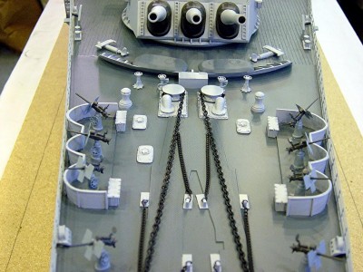

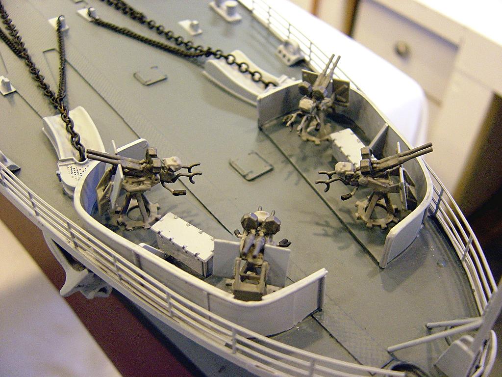

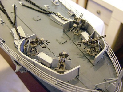

Lets start at the bow. Here is the very forward twin 20MM mounts. There is some dispute as to wether these were in fact installed on the ship, as 20MM singles are also noted in my research. I decided to go with these. 20MM twins were in short supply, but I belive a few were added at Indianas last refit.

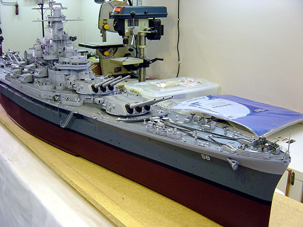

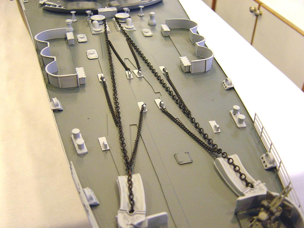

Anchor chains and stays now added. Copper and SS chain used here.

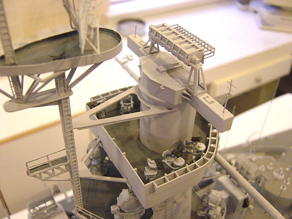

Here I have added the Mk27 stand by fire control radar atop the conning tower. This replaced the Mk 40 optical director.

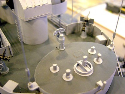

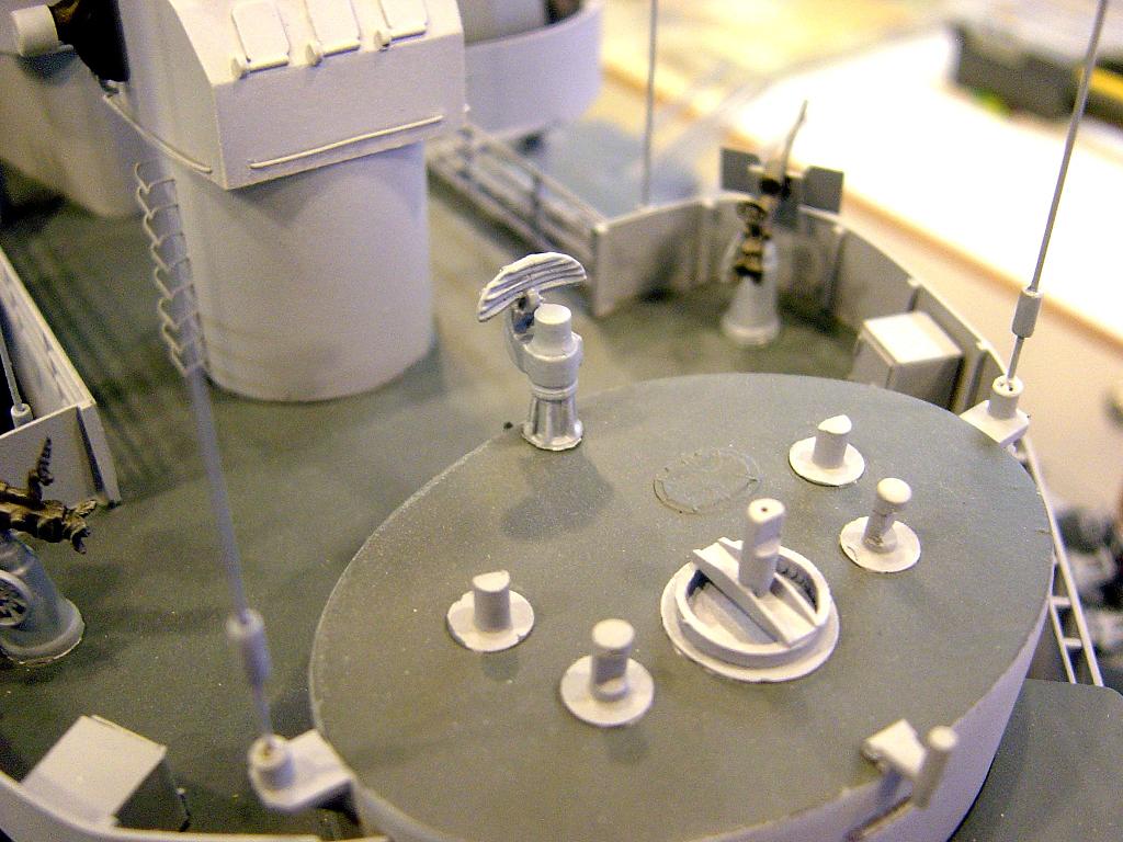

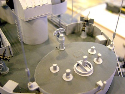

I have added the sky-lookouts and target designators on the air defense platform atop the conning tower.
Another view of the AD platform.

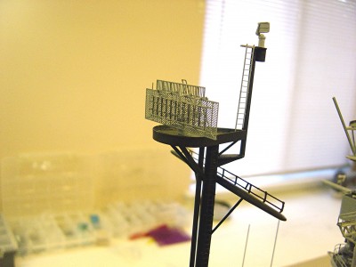

SR/a secondary air search radar added here.

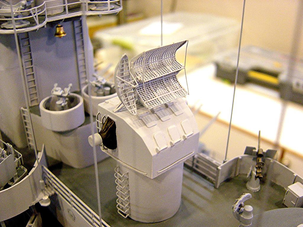

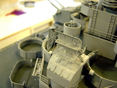

One of four Mk 37 gun directors for the 5" guns. The large radar is the Mk 12, and I have added the Mk22, the smaller football shaped one next to it. All P/E. The Mk 12 is a ranging and tracking radar, while the Mk22 is a height finding radar. These directors were employed against surface and airborne targets.

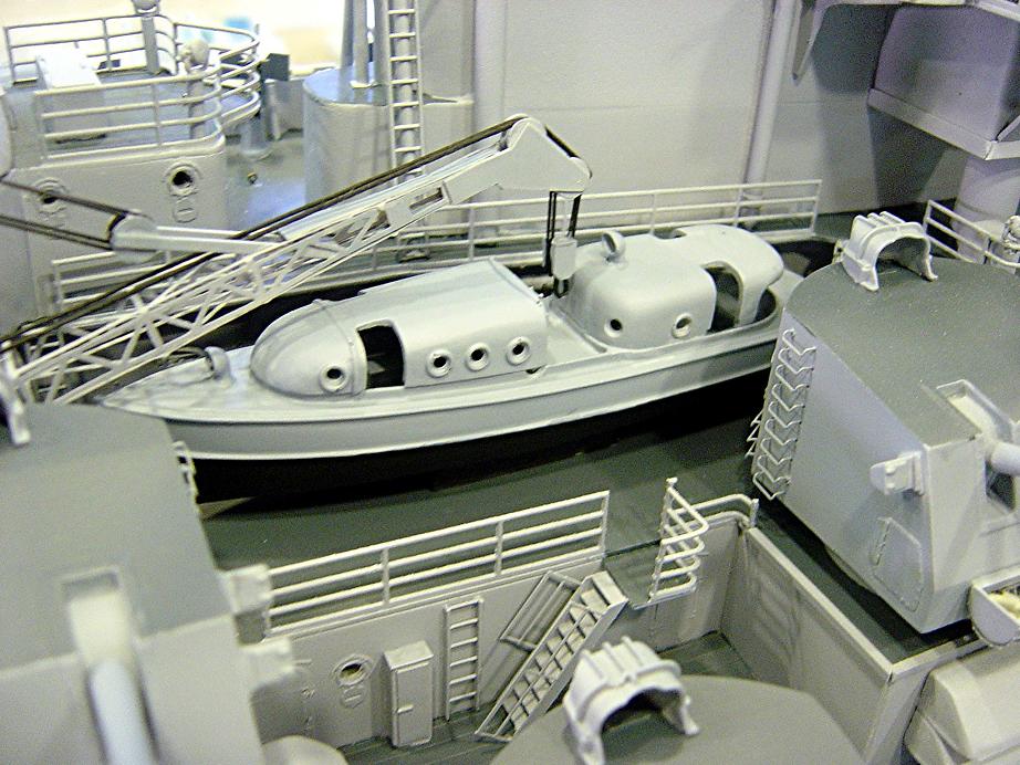

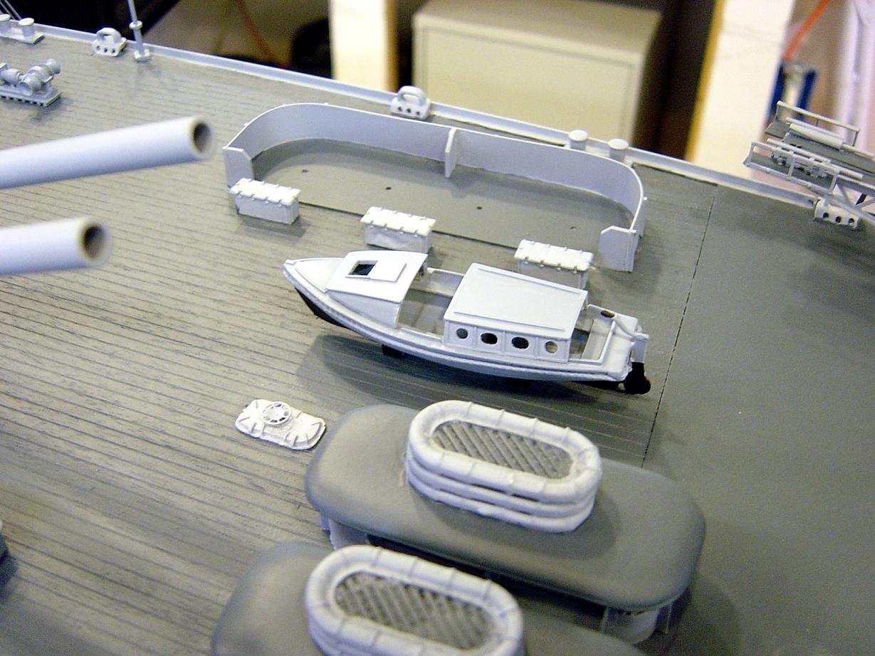

A 24' personnal boat added. A 26' MWB will be added also.

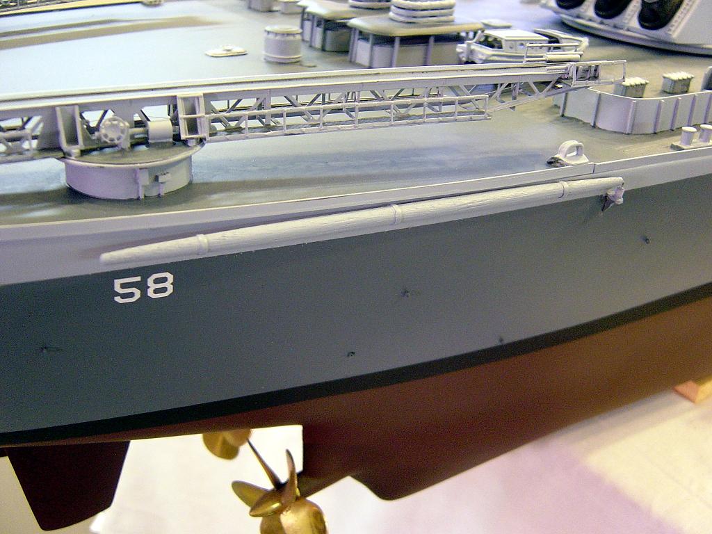

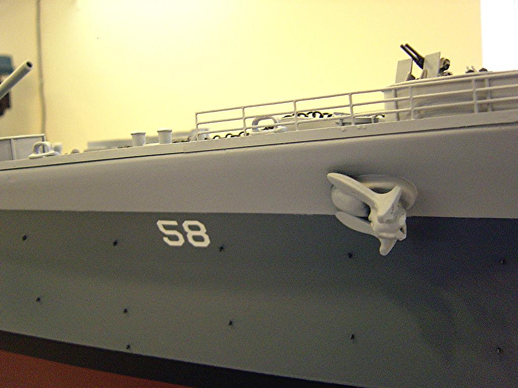

Ship number added. Techmod decals.
Boat booms added, port and stb. Tapered wood dowel used here, with fine tape to simulate metal rings.

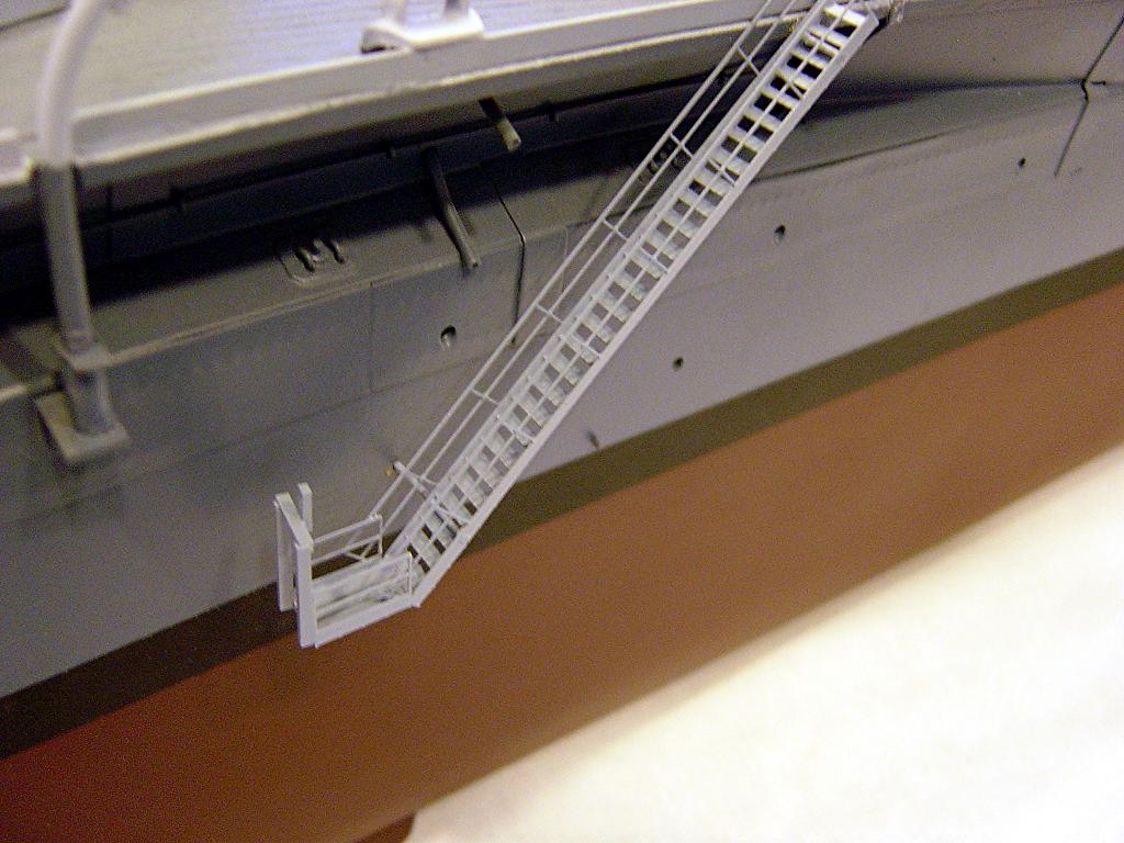

Accomodation ladders added, two stb. and one port aft. Brass P/E. The lower platform is styrene w/brass railing. Not rigged as of yet.

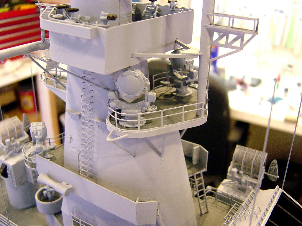

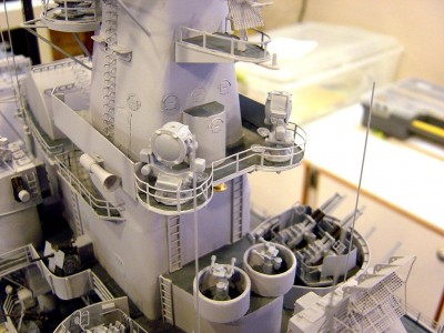

Forward searchlight platform on the conning tower. Searchlights are cast resin. Note the MK51 gun directors just below. Also note the ships bell.

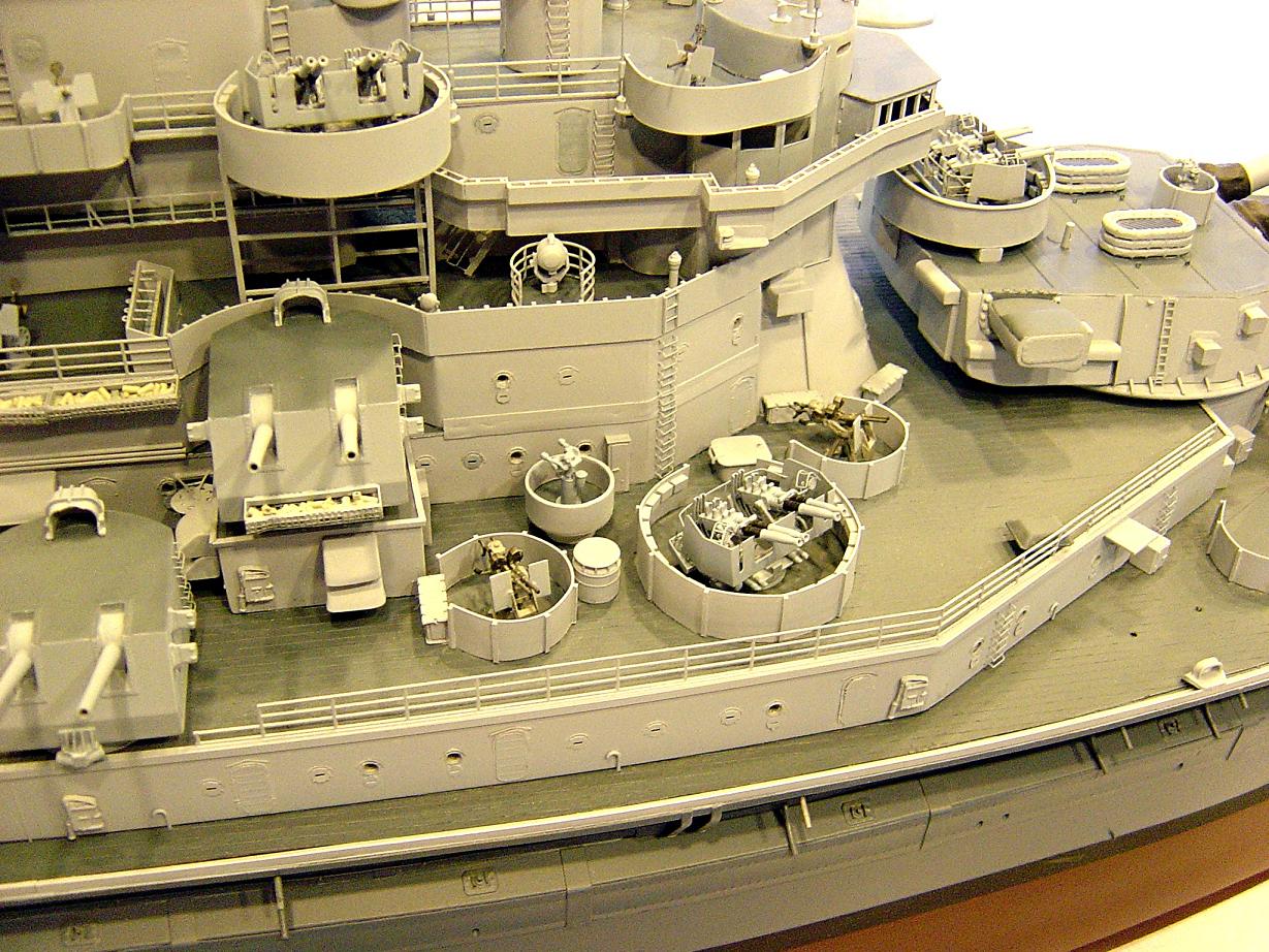

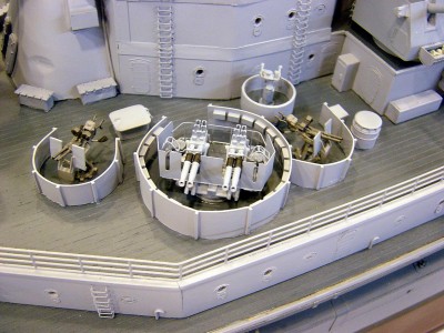

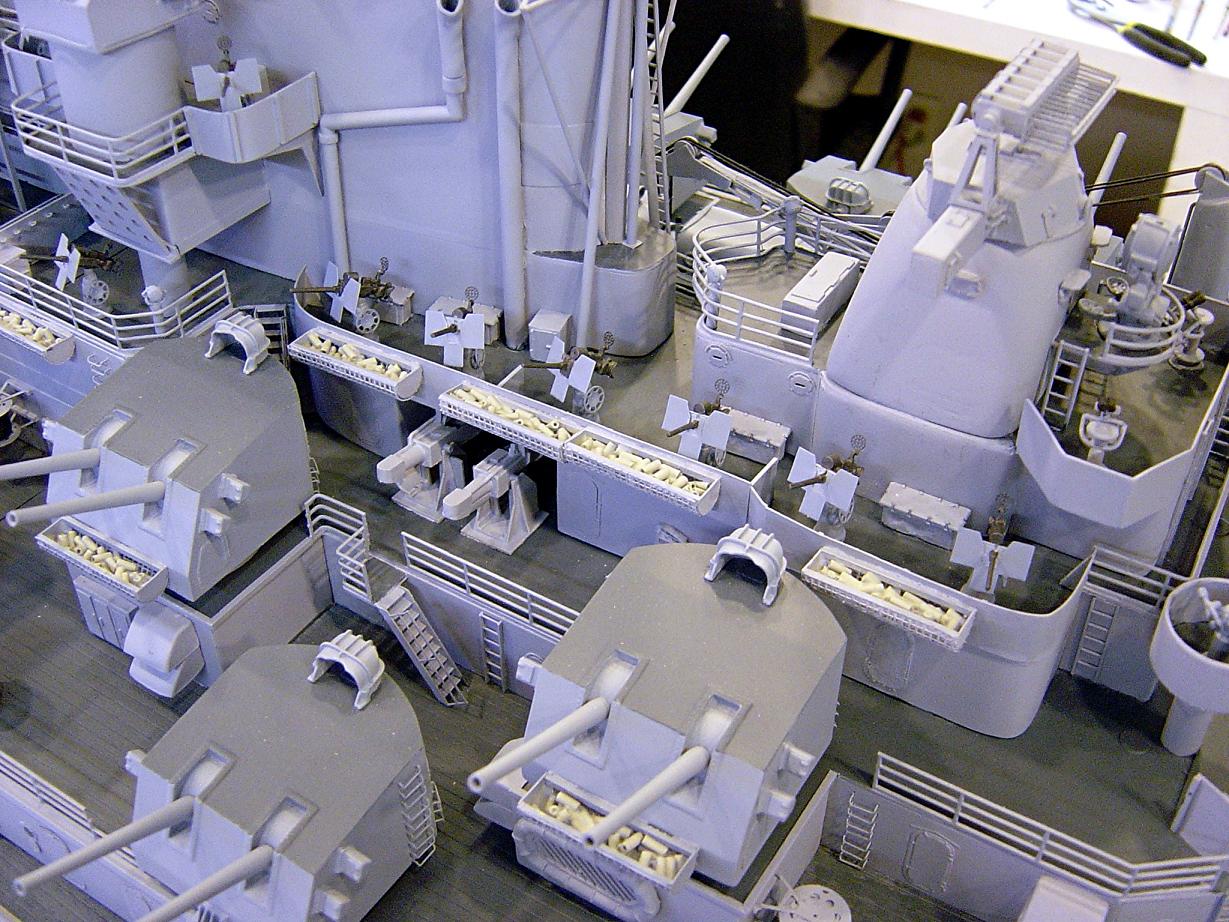

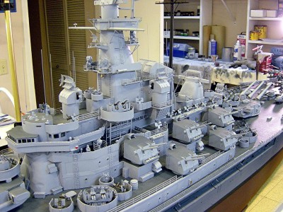

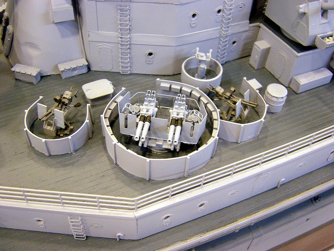

Gun arrangement on stb side superstructure deck. Portside differed from this arrangement. Again note the 20MM twins. I figure there were 8 of these mounts in total.
Heres the portside arrangement.

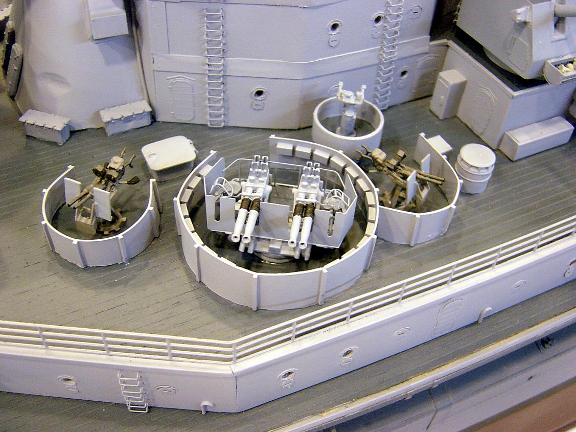

This area portside is where the other crane used to be. It was removed and this 20MM arrangement was added. Note the practice loading machine below the 20's, between the 5" turrents.

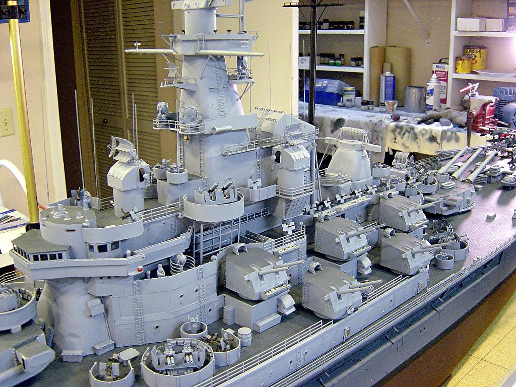

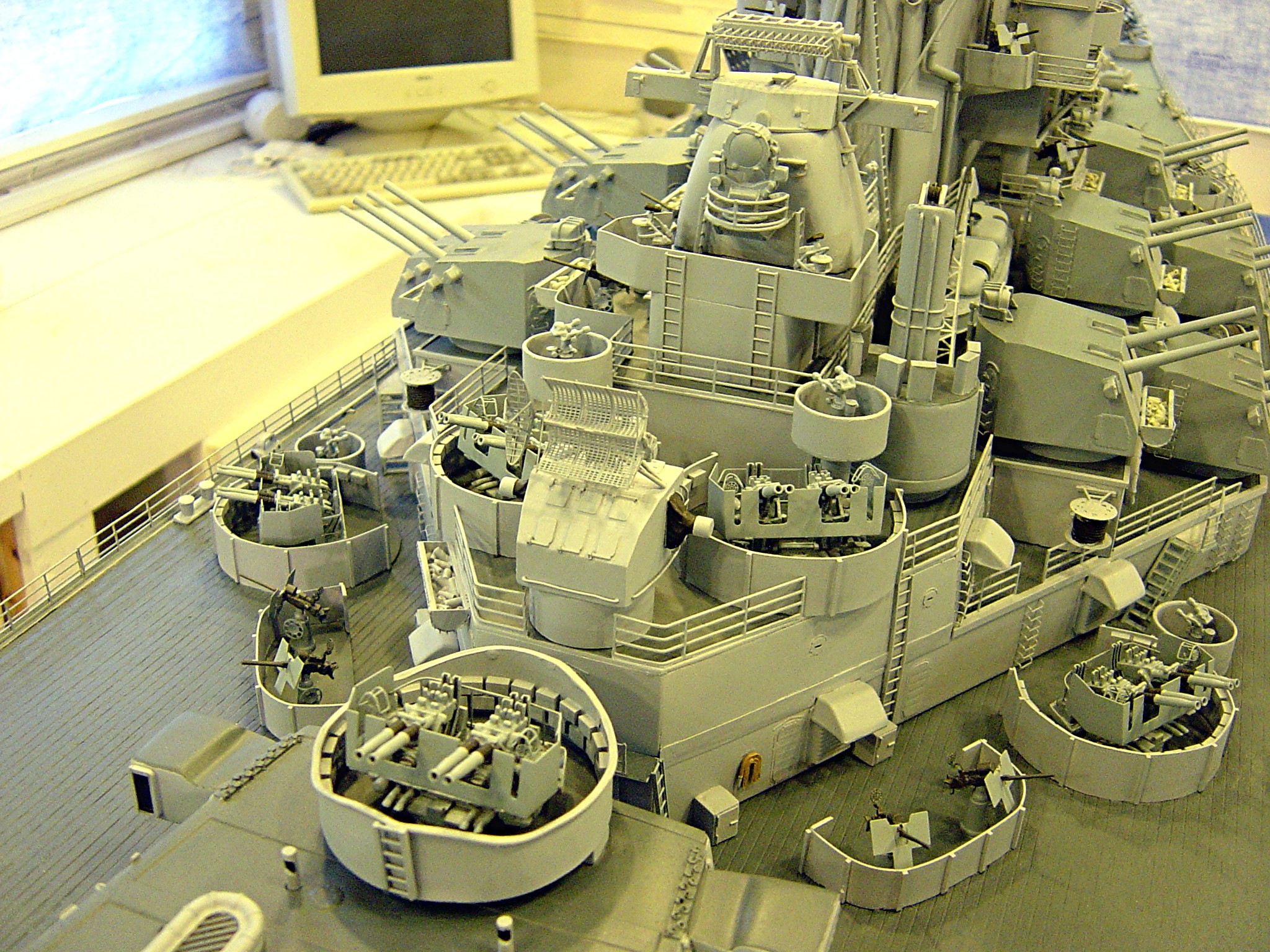

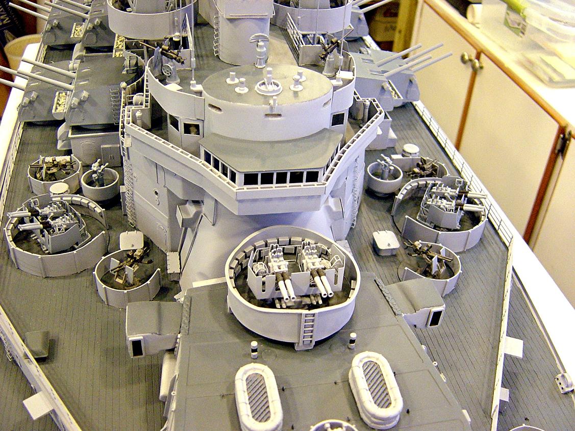

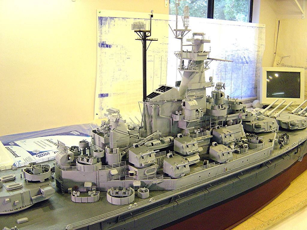

Good view of the forward superstructure AA complement.

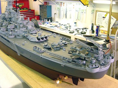

Hello again all! :wave_1: The final phases of the construction of the USS Indiana have now been completed. All AA weaponry is installed as well as the aircraft and a few other small details. All that remains is rigging. Time grows short! I have a delivery date of July 27th, I think I'll make it! The replica will be flown direct to Indianapolis from here in Jacksonville, Fla., via FedEx, and will have a man riding along to be sure it gets there in one piece. Never have put a large scale ship on an airplane, so I don't know what will happen, if anything. In any event, I sure hope they are careful. This ship is like my kid! Been around the shop for so long ,I got attached to it. Sort of sad to see it go. Good thing is lots will see it. Better than here. Anyway, enough of my rambling, lets take a look....................

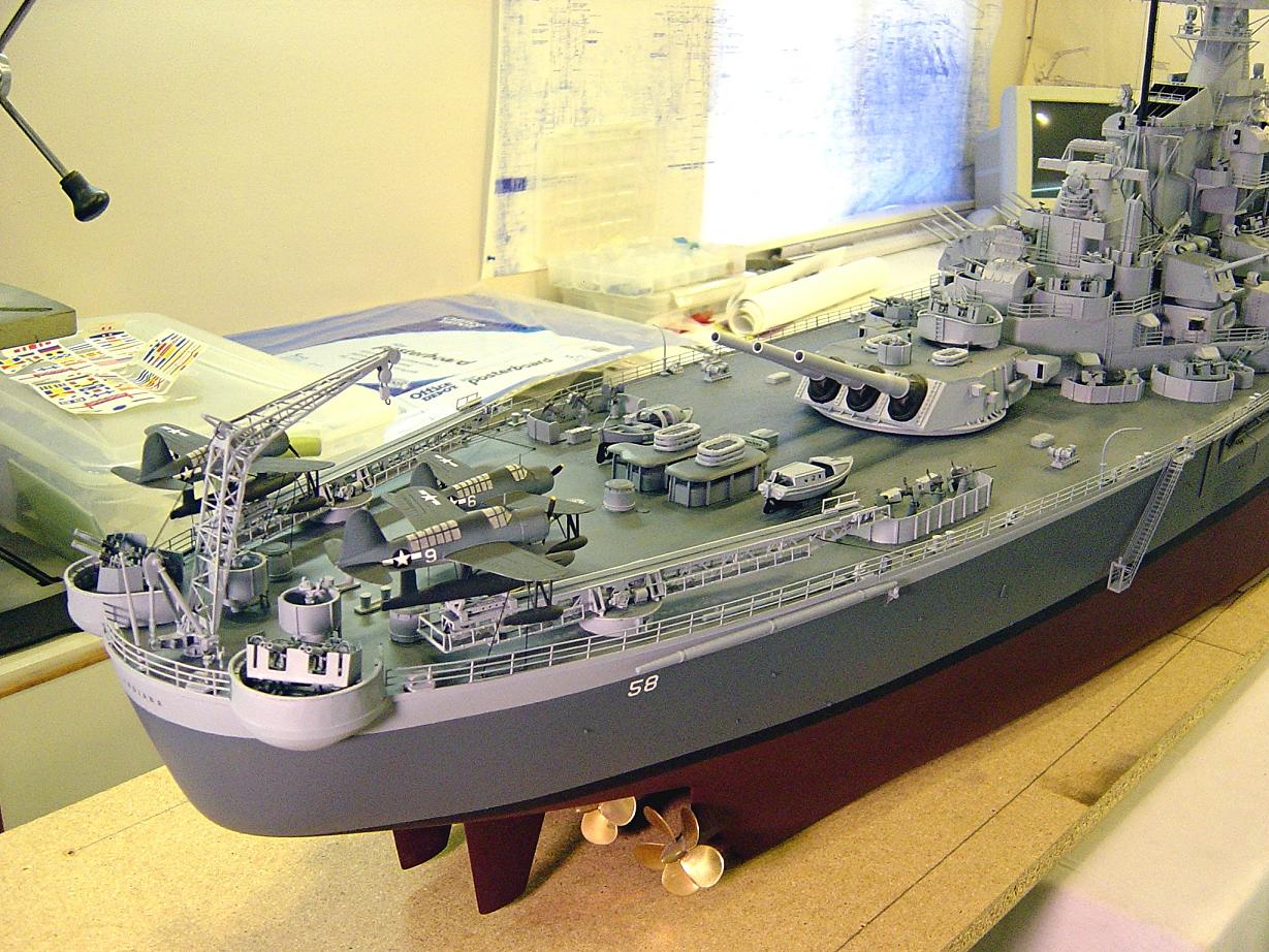

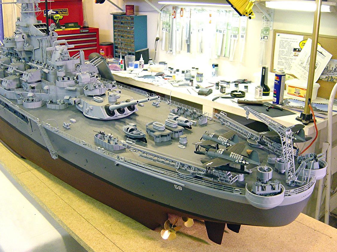

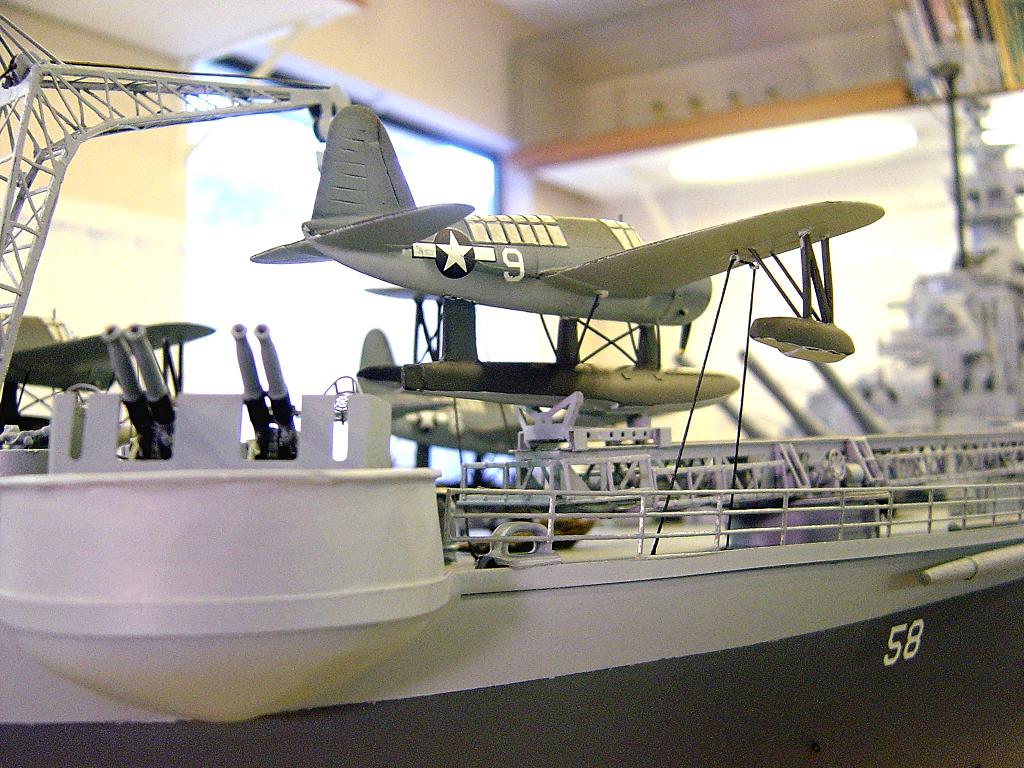

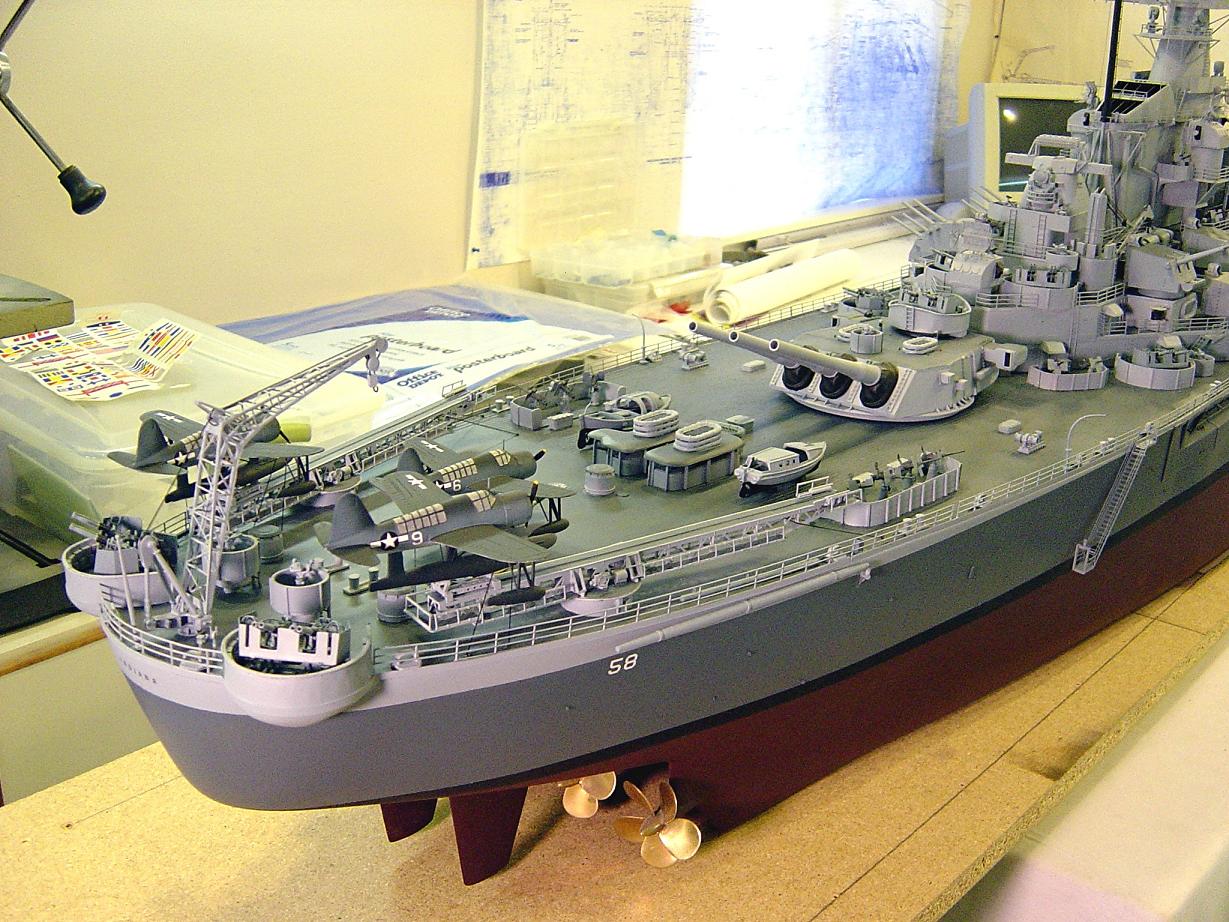

A stern view here from stb. side. I have added three OS2U Kingfisher a/c here. Two on the cats and one on deck. A/C from JR Haynes. I added the radio antenna, and some additional struts and bracing to the floats. Note the crane controls. Ships name has also been added. Quad 40's installed too.
Another view of the seaplane. Note it is on its trolley and the tie down cables securing the aircraft to the cat while the ship is underway. There was no hanger deck on the South Dakotas, so the a/c were stowed as you see. Many were lost due to bad weather and rough seas.

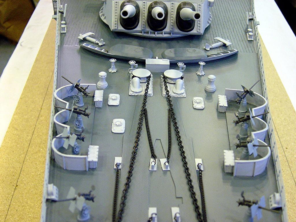

More 20MM singles added forward on the focasle deck. Main part of the gun is from Bluejacket Shipcrafters and is cast metal. I added the shield from Tom's Modelworks, and a sight from JR Haynes, both p/e. Handreel is from Kadee products. So four mfgrs. to produce one part. There are 45 of these on the ship. I added the ammo canister from styrene rod.
Another view of the single 20MM arrangement forward, just in front of turrent #1.

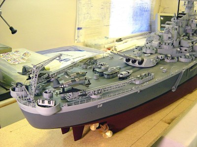

These next few photos are some overall views.....
[attachment=0]DSC03474.JPG[attachment=0]
Well, there it is! As I said, on to rigging and flags. Then to build the plexiglass case and crate for shipment. More to come. By the way, the dedication to the Vets of the ship will be July 29th as I have said, but the time has changed from 2 PM to 11 AM. Hope to see some of you there. Stay tuned, we are almost there.................. :wave_1:
