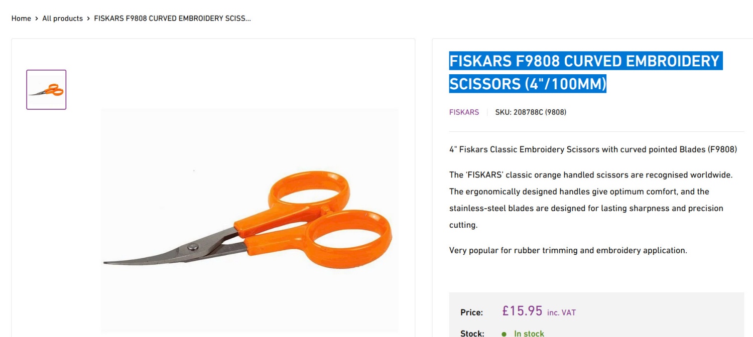

and also....
try this
FISKARS F9808 CURVED EMBROIDERY SCISSORS (4"/100MM)
the curved blades mean you don't catch the continuation of the wire etc
I used them to great effect as a 'retro-extraction ' here....
viewtopic.php?f=59&t=168156&start=200#p866650
and the choices here
viewtopic.php?f=59&t=168156&start=220#p866927

Woohoo! More shopping! :big_grin: :big_grin: :big_grin:
Thanks Jim! :thumbs_up_1:
I do have some small and large scissors of course, but maximum strength and sharpness is of great importance for these tasks indeed, and I could use some improvement... ;)
