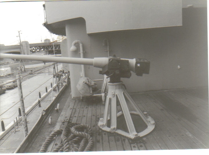

Sean, You have a sharper eye than these old ones. I missed the 1936 flag bridge altogether. Given your observations I agree, One saluting gun per side.
Here is a 3 pounder on Salem.

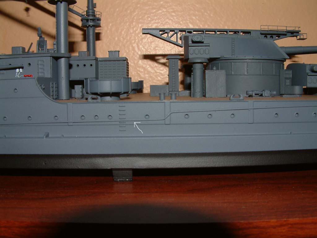

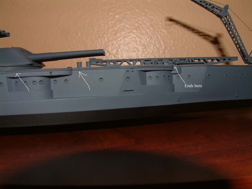

The fuel line runs along the hull from the bow back to the final hull notch, right near the fantail catapult. It angles slightly upward as it goes back, witha distinct jog just aft of the 1.1" gun tub. This shot gives the sense for the full length of the pipeline.
Another excellent reference for this is here:
http://navsource.org/archives/01/039/013933w.jpg
which shows the housing at the aft end of the line that, I'm guessing, contained the pump and hoses.

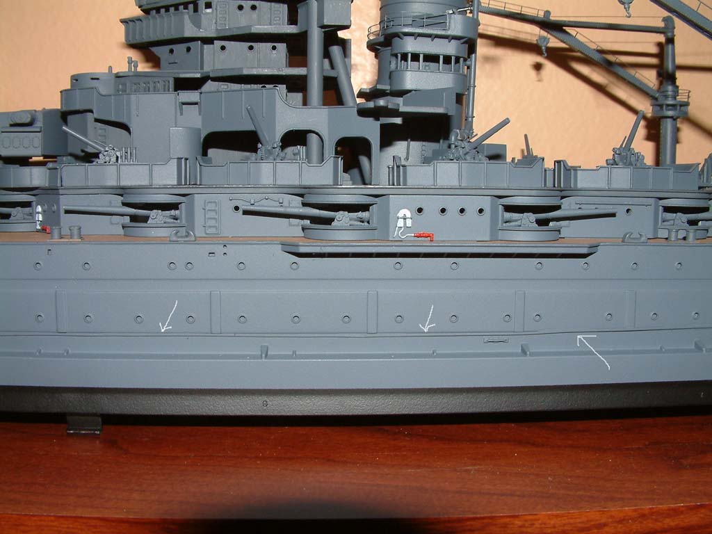

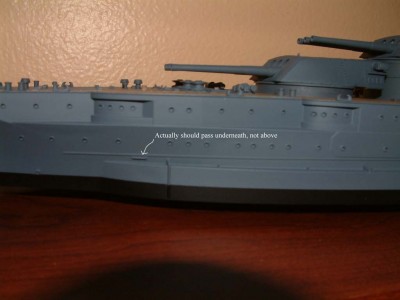

By the way stef76, here is the aviation fuel line I glued onto my hull. I thought I had bought round styrene strips, but I realized afterwards it was .010"x.020" instead. Turns out it made gluing it to the hull just a tad easier, since the flat side stuck easily instead of dancing around spreading glue everywhere. The one mistake I made was assuming the line ran above the grab bar near the bow. In reality it went underneath and passed through the reinforcing rib immediately aft of it. Aside from that it should be correct.
