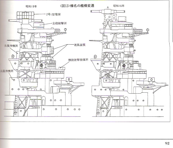

I may have posted this before:

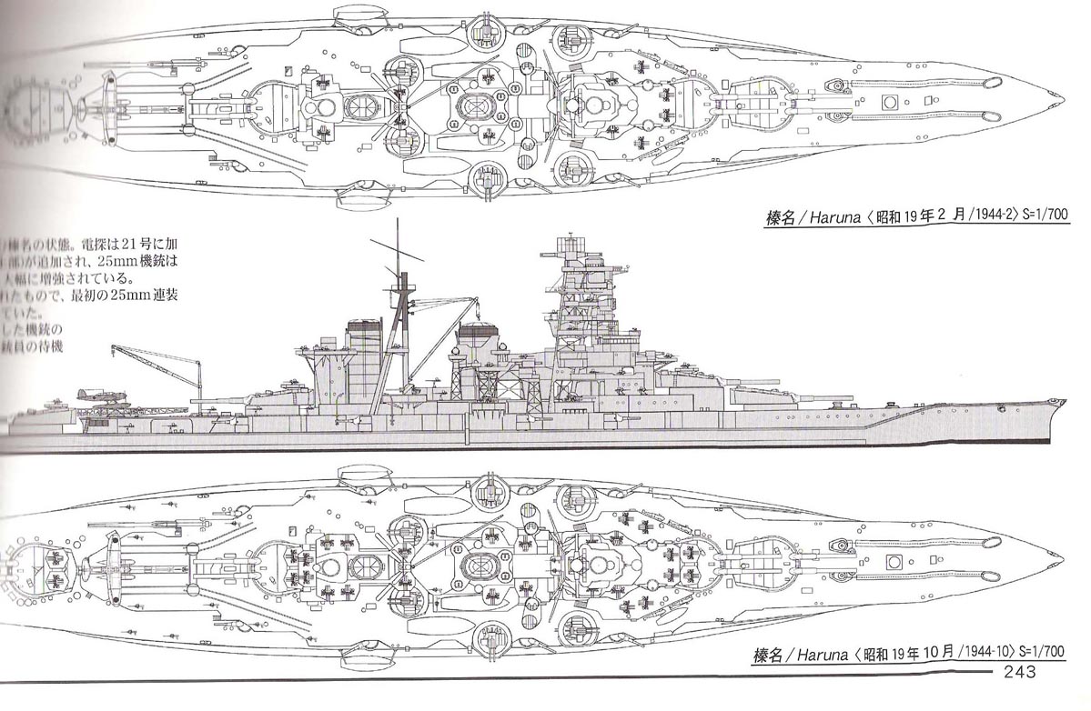

Three, Takao Ishibishi might be the foremost IJN BB expert in Japan as of recent times. In 2007, he published an enormous illustrated volume on IJN BBs from 1868-1945. Below are two scans of the same page of Haruna in February (top) and October(bottom) 1944. If I were to trust any one source, this would be it. HTH,

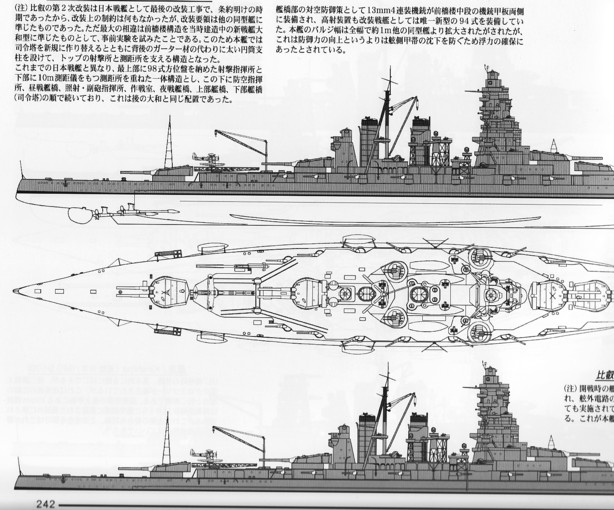

If you're into the BBs, then yes. But, it's long out of production. There were only 500 or 1000 copies printed. It was quite pricey.
You could check Ebay, though I think if it were posted anywhere, it would be on the Japanese version.

Any idea of what the bridge tower would have looked like when it was mounted?
Because the kits show a very different bridge from the Pre-1942/43 bridge (prior to when it had the additional 127mm DP guns added, and additional 25mm AA Guns).
And it would be nice to know if I can bash something together from the Late-war and Earlier-war kits for a Kongo from Aug-Dec 1942.

According to Ishibashi the three triple 25mms on the aft bridge were at the same level. This seems a bit odd since the support beams for at least one pair were already there when they removed the fire control posts.
You're not mistaking the pair on the top of turret #3 as being on the same level, from the overhead view?

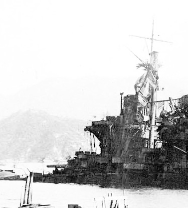

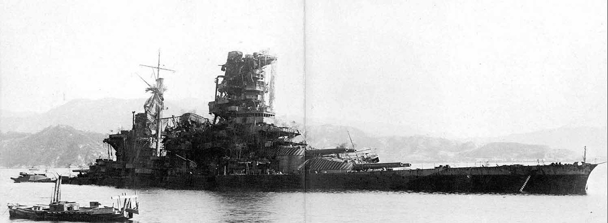

We lack a good overhead or port side view, postwar. However, I believe Ishibashi does have it correct.

To answer one of your previous questions...The Kagero's Haruna gives credit to Mutsuo Uchiyama.
Now, according to this picture the original triple platform (on the left) is at the same level as top of the superstructure, the right one is clearly raised and extends way past the vertical mid point of the funnel. Ishibashi's drawing here is thus incorrect.
Marked with yellow is a gangway which is lower than the platform.
I think Kagero has it right.
The sponson on the pagoda tower also seems to narrow on Ishibashy's drawing and I would go with Kagero as well.
Please keep in mind I'm not in favor of anyone, I just wish to get a clear impression.
I'm like a bloke who had a drink to much and has double/triple vision and is desperately trying to unite them ;-)
Posts: 9117
Re: Calling All IJN Kongo-Class Fans
Post by Dan K »
Mucho is definitely an expert; he's been kind enough to participate several times on the CASF Aoba & Furutaka class threads.
Agreed, the platforms are staggered to the rear.
