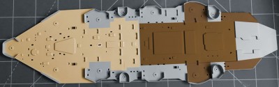

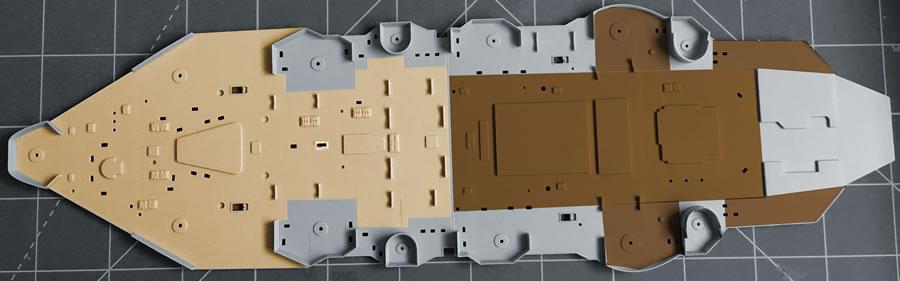

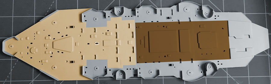

FWIW, for my Hood I'd just got satisfied with the correct grey and red, and painted the hull and sealed it after '50 shades of Grey' over a few years. Changing paint chips, new research, the scale effect, and what I could reasonably lay my hands on here in regional Australia; it came a full circle and I ended very close to where I started, I believe John Donne wrote a poem about something similar...

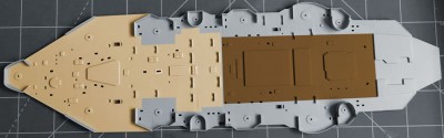

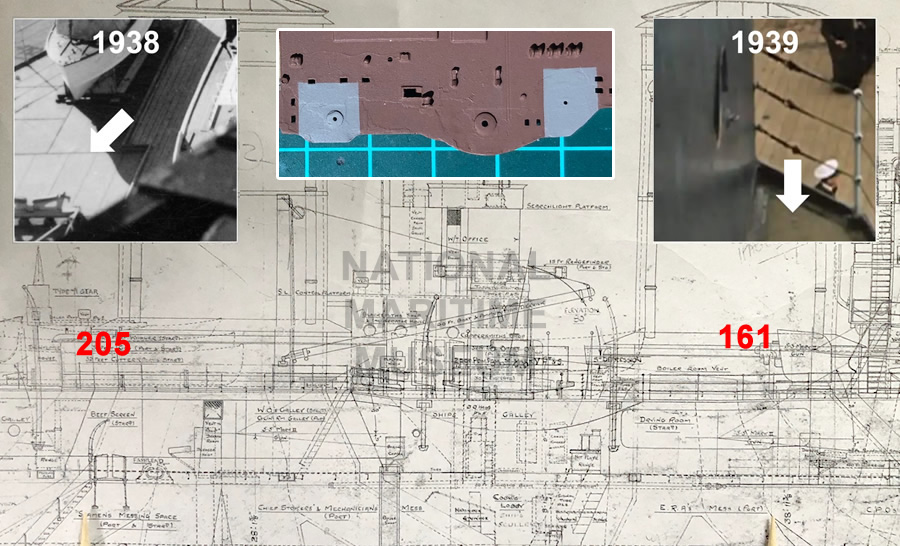

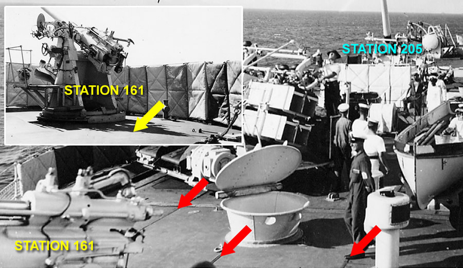

Figure 1a � The Original Confirmed Locations of Semtex on Hood�s Shelter/Boat Deck (Side Profile)
The image above shows the locations of stations 161-205 (the areas to which semtex was added in December 1937). There are also inserts showing the use of corticene in 1938 and 1939.

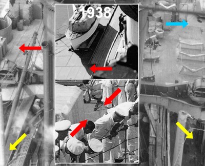

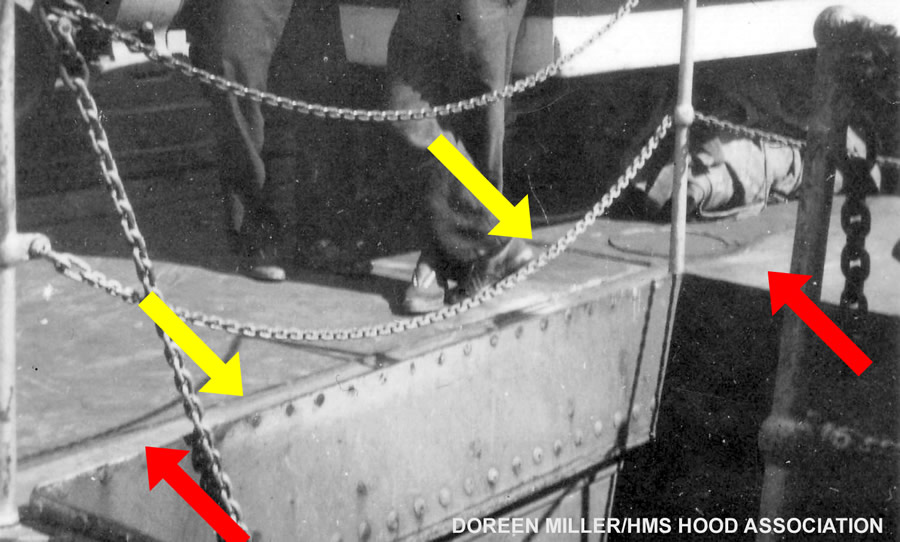

Figure 1b �The Original Locations of Semtex on Hood�s Shelter/Boat Deck (Stations 161-205 Starboard, 1938)
This photo shows the starboard side of the forward shelter deck sometime in 1938. In the inset, we see the gun mounted at Station 161S...and the absence of panels and strips shows us that this is after semtex was applied. A view of the wider area (main photo) taken at the same time shows that this was confined to the area immediately around the gun and that corticene still existed outside of the area. We cannot see the deck for station 205, but presumably it would be the same. This verifies that the deck initially had only a small amount of semtex in limited locations. This was not in doubt, but its nice to have visual proof for the time period in question. It shows a progression in the changing of the deck materials.

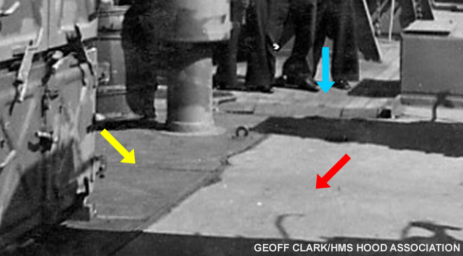

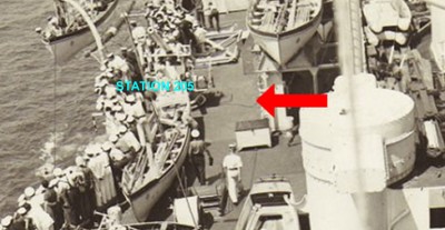

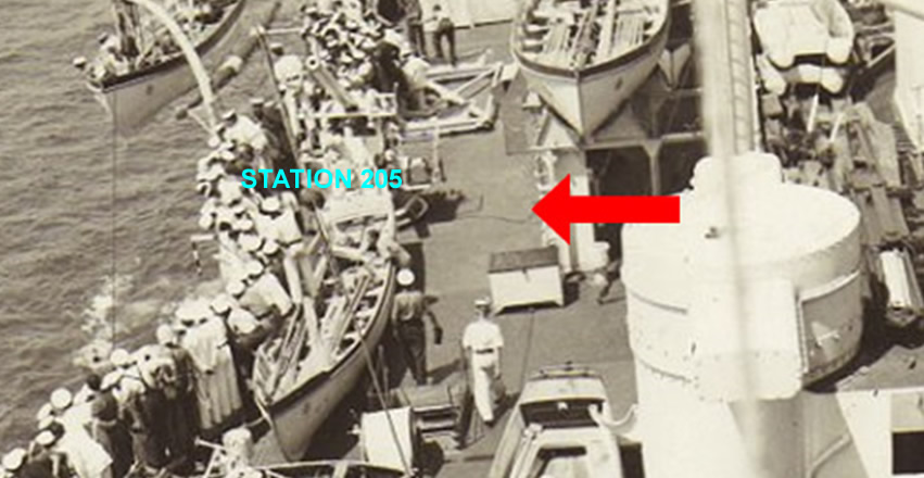

Figure 1c �The Original Locations of Semtex on Hood�s Shelter/Boat Deck (Station 205 Starboard, 1938)
This photo shows that the decking around station 205S (red arrow) is somewhat "bland" and shows no raised strips. Corticene panels can be seen inboard of the small boat. Again, confirmation that for a time, both materials were definitely in use.

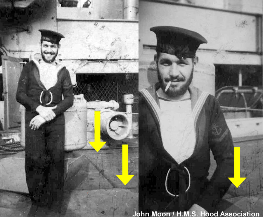

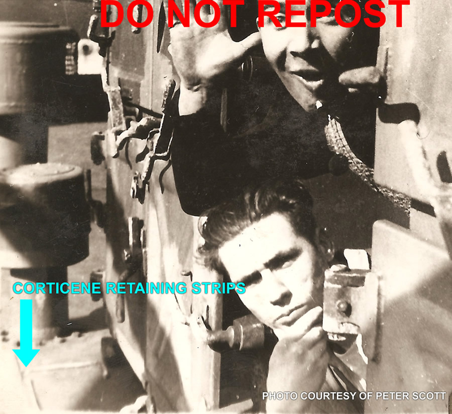

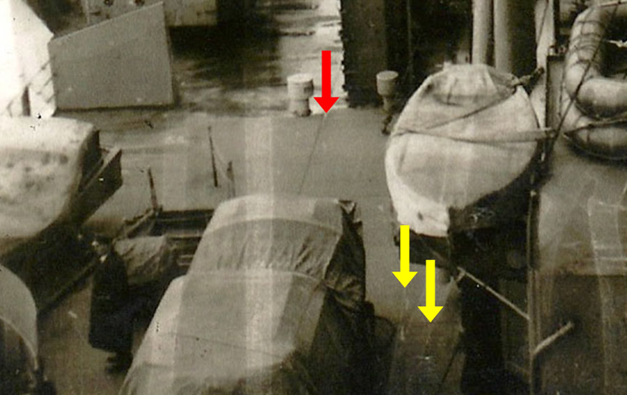

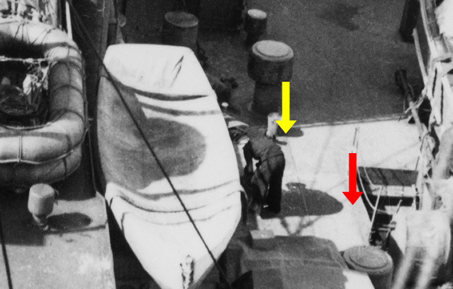

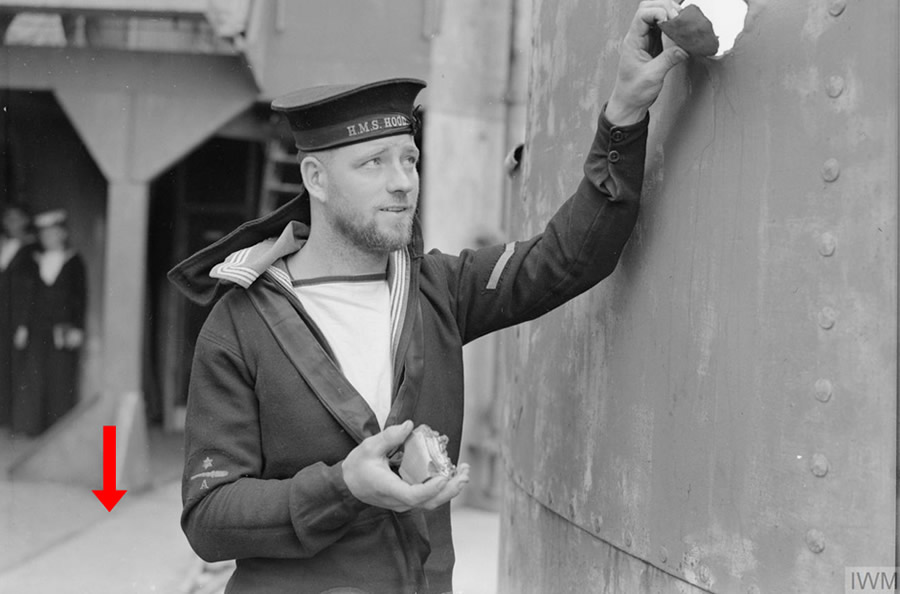

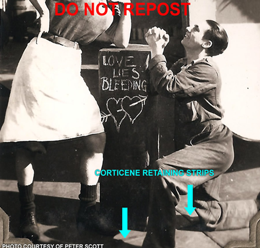

Figure 2 � 1940/41 Photos of Hood�s Starboard Shelter Deck.
The above photo (figure 2) was taken near stations 189/187 in front of the forward starboard ladderway/companionway. Inboard you can see strips separating two contrastingly different deck surfaces. The inboard surfaces is darker and has border strips (indicated by yellow). The outboard area (red arrow) is featureless and light in colour. This is suggestive of corticene inboard and semtex outboard. We are unable to pinpoint the exact date or month of the photo, so we have no way to confirm if this was before or after her 1940 refit.

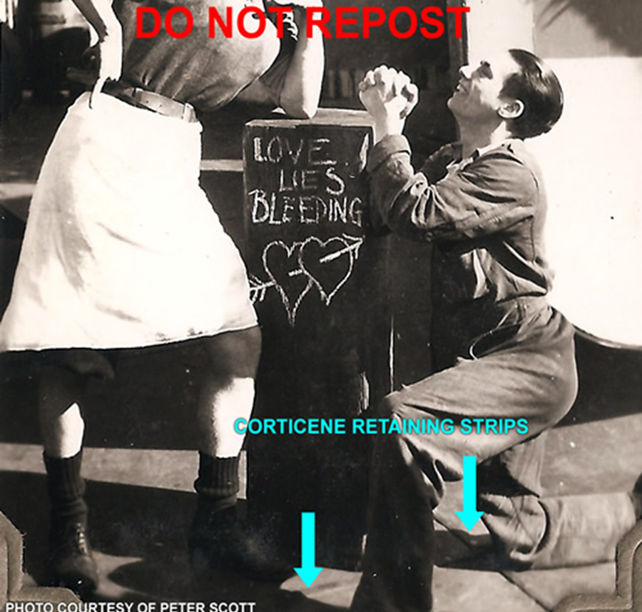

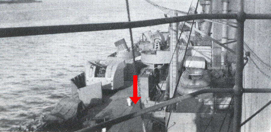

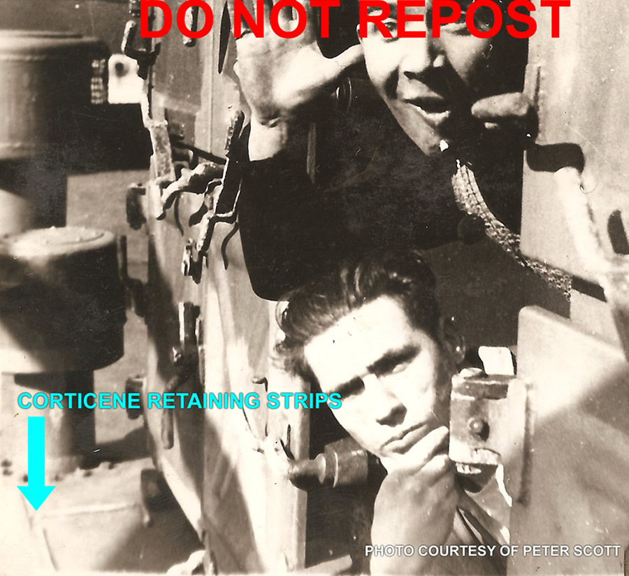

Figure 3 - Forward Shelter/Boat Deck, October 1940.
Figure 3 shows stations a crewman standing near the forward starboard UP mount with the base of the bridge visible in the background. Because of the angle, the crewman and corresponding field of view, we can�t see transverse strips but one of the fore-aft strips can be clearly seen (red arrow). This roughly aligns with the edges of the engine room vents below the funnels.

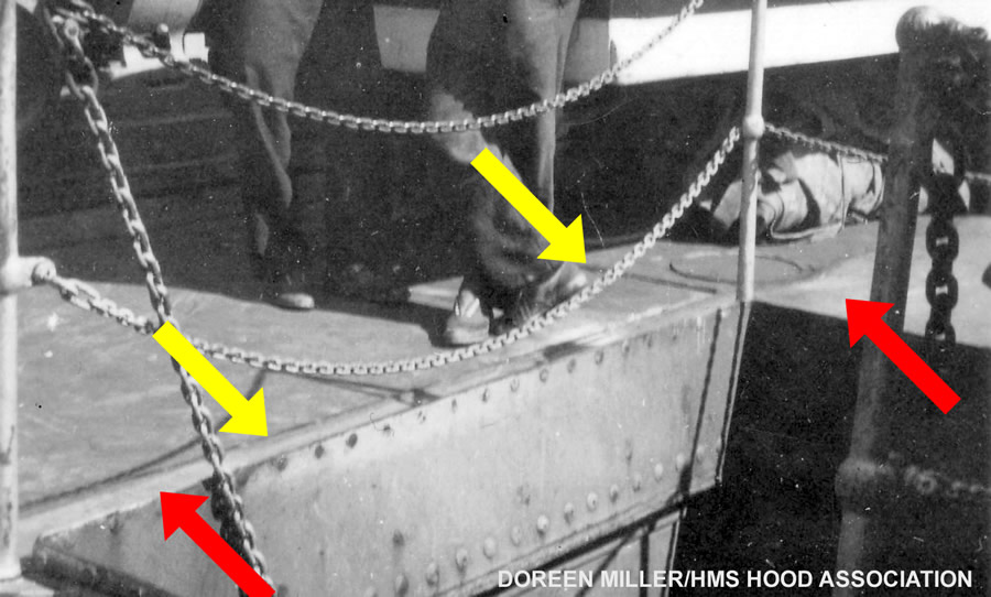

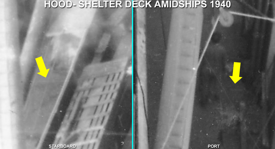

Figure 4 � Port Amidships Boat Deck, Spring 1941
Figure 4 shows stations 208-210 on the port side. This corresponds to the area just aft of the disinfector house and amidships searchlight platform. This photo clearly shows three different deck coverings: Blue indicates teak planking. Yellow is likely corticene (as evidenced by different shade and presence of both fore/aft and transverse strips) and red indicates likely use of semtex (in an area where its usage was documented). We base the date on the fact that in the uncropped original photo the men are posing in front of a 35ft Fast Motor Boat (which was supposedly fitted in 1941).

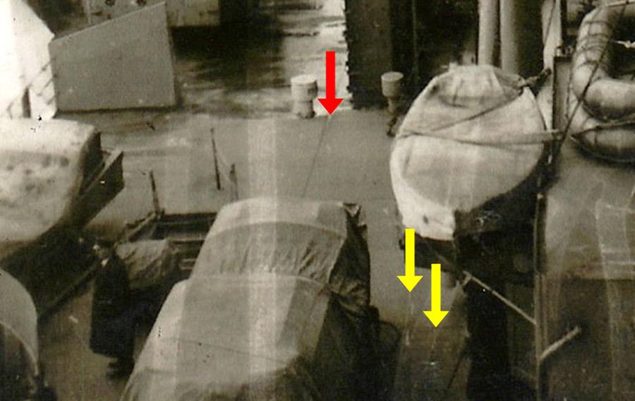

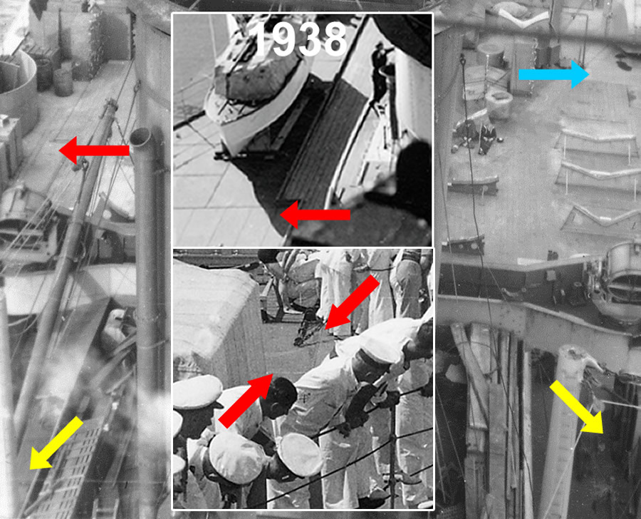

Figure 5 � Hood�s Boat Deck, Likely Early 1941
Figure 5 shows Hood�s boat deck as seen from the bridge, most likely in early 1941. This is evidenced by the fact that her rear funnel has a patch following damage incurred at Mers El Kebir in July 1940. UPDATE (13 Dec 2020): The presence of 35ft Fast Motor Boat crutches on the port side indicate this was taken during her 1941refit. In this view, the areas along the sides and under the guns (blue and red arrows) are light in colour. You can see indications of a rectangular deck feature (red arrow), which corresponds to a previous location of corticene (see inset for two 1938 photos that shows similar panel lines...in other, closeup shots not presented here, these lines are clearly corticene retaining strips). The comparison does show, however, that this strip pattern is not the same in 1941. As such, its unclear how much, if any corticene remained in this area. So, this confirms that although the rear deck extensions were, at one point, covered with corticene, they appear to have changed later (perhaps semtex?).
Figure 6 � Hood�s Boat Deck, 1941 (Enlargement of Figure 5).
Figure 6 shows the deck alongside the second funnel base vent (both port and starboard). Its difficult to be certain, but the photo suggests the possibility of strips on the deck in these locations. This could of course also be other features or even image artefacts, but they do match-up with modern analyses of the corticene pattern (most notably EJ Foeth�s model). UPDATE (13 Dec 2020): I corrected the year to be 1941 (see the reason in the description for figure 5).

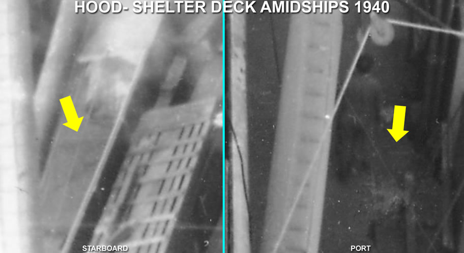

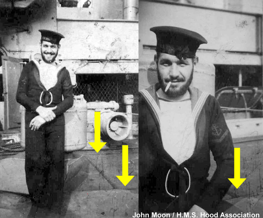

Figure 8 � Hood�s Shelter/Boat Deck Near Station 210, Late 1940.
Figure 8 shows the area immediately aft of the disinfector house/motorboat workshop/amidships searchlight platform. The teak planked section of the deck is just out of view to the right. Corticene retaining strips can clearly be seen in this view. We date this to late 1940 based on the photographer�s service period in Hood (he was aboard in 1940 and left as one of the so-called �lucky 13� who departed the ship shortly before she sailed to meet Bismarck) and the fact that there is no 35ft Fast Motorboat present behind the �lady.�
Figure 9 � Hood�s Shelter/Boat Deck Near Amidships Searchlight Platform, Late 1940/Early 1941.
Figure 9 shows the port side abreast the rear funnel/just forward of the amidships searchlight platform. Strips can be seen very close to the ready use lockers. The strips seem to be inboard whereas a featureless deck is outboard. This may indicate semtex outboard and corticene inboard. We date this to late 1940/early 1941 based on the photographer�s service in Hood. It should also be noted that the paint is quite matte in appearance.
Figure 10 � Portside Between Funnels, 1940/41.
Figure 10 shows a crewman (who joined the ship in 1940) standing on the port side of the forward shelter deck near stations 185-187. In the background is the forward edge of the rear funnel and engine room vent. The open door leads to the Coppersmiths Shop and/or Incinerator Room. He is standing on a featureless section of deck, but behind him are telltale corticene retaining strips. This suggests corticene inboard, possibly semtex outboard. Previously this outer area also appeared to be covered with corticene...and the edges of the panels were previously neatly aligned in a grid pattern. The absence of a lateral strip and a change in deck contrast suggests it may have been repositioned (staggered) or removed outboard.
Figure 11 � Hood�s Starboard Shelter/Boat Deck, 1940.
Figure 11 shows the starboard side abreast the structure between the funnels. In this view the prominent fore-aft line mentioned previously can once again be seen (red). Additional lines/strips can be seen inboard (yellow). This may (or may not indicate corticene strips inboard). Generally, the deck seems bare outboard of the prominent line. This may indicate semtex usage. The exact date of the photo is difficult to discern, but we believe it to be from 1940 based on a set of stacked boats in the background of the original full-size version of this photo (the top has been cropped here to show only the deck area in question).
Figure 12 � Hood�s Shelter/Boat Deck, 1940.
Figure 12 shows the starboard side abreast the structure between the funnels. In this view the prominent fore-aft line can yet again be seen. The line divides the deck into two areas of different contrasts...lighter outboard, darker inboard. The composition shown also matches other photos taken of this area (use the ladderway as a reference point). This shot is most likely from 1940 as it appears to have been taken from the rear of the Admiral�s Bridge deck (which was mostly enclosed during Hood�s 1941 refit).
Current Findings/Train of Thought
Based on these photos, its obvious that the coverings on Hood�s forward shelter deck changed not only in 1937/38 (as the last known surviving documentation has verified), but again sometime before Spring, 1941. This much was already known (or at least expected), but the amount/degree of change still eludes us. We DO see what must be semtex, but we also see indications that SOME corticene remained in place (inboard/around the funnels) even after the 1940 refit in which it was supposedly removed.
It may not �make sense� to have such a mix...especially in light of a supposed CAFO/order for the removal of corticene, but photos do not lie. Unless, we�ve drastically misinterpreted things, photos indicate that corticene was still present in places on the shelter/boat deck (and bridge decks) following the 1940 refit and possibly even the 1941 refit. We can only speculate as to why corticene remained. We do know that the ship�s books are filled with examples of work that was slated but not actually carried out (reasons generally involved stock/availability, the ship�s schedule, etc.). So, its not beyond the realm of possibility that this was the case here.
So, until someone can produce more official documentation or better photographic coverage, we�re left with the following possibilities for Hood�s FINAL shelter/boat deck coverings (listed in no particular order). Please note that the last two images below are simply �onscreen musings.� They are VERY rough/crudely done and are in no way intended as an accurate painting guide!
1. Above- In the above example, the deck is mostly corticene (brown) with a few isolated areas of semtex (light grey...please note that we don't really know what the actual colour was...it could have been tan, light or dark gray, brown, green, etc. It may have even changed colours over the years) . The semtex areas are where it was first applied in 1937/38 (where the forward UPs were later installed) and under the extended areas of the deck.
2. Above- Areas of Semtex outboard/running along the outer portions of the deck , but the inner portion of the deck (to include the area around both funnels and the rear of the bridge) being covered with corticene. We don�t have enough coverage of the area ahead of the forward UPs to be certain of what covering was actually applied there. This interpretation is based on the observations of the deck further aft and shows what it would look like if carried forward.
3. A �patchwork� situation with some high traffic inboard areas /paths covered in corticene and large areas in semtex. I didn't bother trying to create an image for this possibility as it would delve wildly into the realms of the imagination.
I�m curious to hear what others deduce from these same references. Thoughts anyone?
