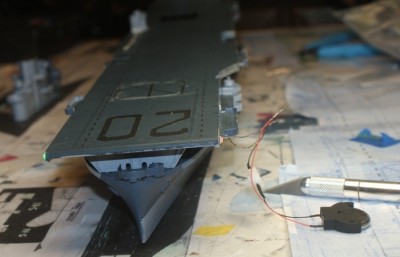

Update 41
To paint it, I started with one coat of deck blue to seal the tape, followed by two coats of black. It worked extremely well and there were only a few places that I had to touch up.
I couldn�t help myself, so I put the flight deck and island on and took more pix.

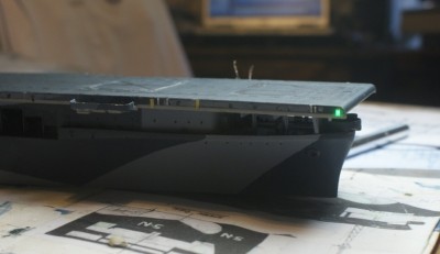

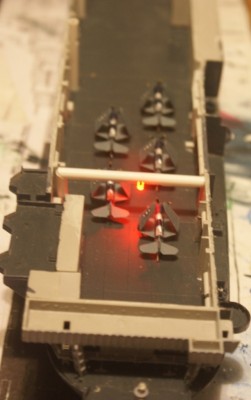

Update 43
There�s not a lot to report today, but I did redo the projector. It�s still too big, but I built the smallest enclosure I could build to house the chip LED. I�m not crazy about it, but I can live with it, and at least it now has a table.
I also started on the hanger deck lights. I installed the aft most light and laid out where the others will go. There are six going in the hanger.
To get the lights where I want them I�m using 3/16� tubing as conduit. They can�t be smaller due to the size of the connection at the light. A vertical piece of conduit is installed along the port side bulkhead through a hole drilled in the deck. (I put them on the port side because that is the side that will be displayed and the conduit won�t be visible.) The top is cut at a 45 degree angle to match up with a horizontal piece of tubing installed just below the tops of the headwalls. It doesn�t need to go all the way across, because the light is in the middle, but it looks better that way. A slit is then cut in the bottom of the conduit, the wire side is placed through the slit and the light is pushed in almost all the way, is bent at 90 degrees, and is then pushed the rest of the way in so that just the end of the light is protruding from the conduit. The wire is then run through the top of the vertical conduit and the horizontal piece is aligned with the vertical piece and attached.
I only installed the aft light because I don�t want to install the others until I know that I am through putting stuff on the deck. But I did make them and installed the vertical parts of the conduit. When I finish placing stuff on the deck all I have to do is run the wire through, align the pieces and glue them in place.
Next, though, is cutting off the plastic catwalks.

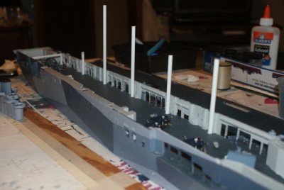

Ikes!
I cut the plastic catwalks off, scanned Arnold's catwalk profiles and plotted them to scale using AutoCad. Again, Ikes! There are several differences between the two ships, but the bad thing is the way the doors are depressed with stairs going down to them. Now that I've look at them closer, I seem to remember reading something about this on a post before I started this adventure. I think it was Tracy discussing it.
Anyway to do it right would be difficult, perhaps beyond my ability. I will have to see if they sell short stairs (I guess I could cut regular ones), because I know I don't have enough, even using extras from previous builds. The biggest problem I think though may be that I don't know if the bulkead adjacent to the catwak is tall enough on the model to allow for the sunken doors. I put a door up next to it and it looks tight.
I was going to start working on this, but I think I need to decide if I want to do the recesses or not before I start drilling doors or gluing closed ones on.

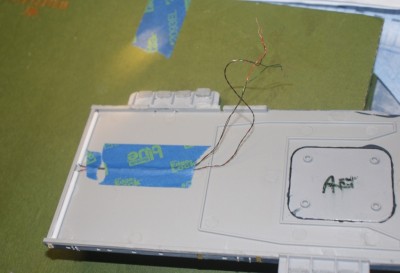

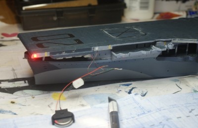

Update 48
Switching tacks again, it seems like I have three models going at the moment, the hanger, the flight deck and the island, I decided to install the bough running lights using the LED chips I bought. This was easy to do and simply required drilling a hole in the gallery deck bulkheads at the right locations and gluing the lights in place. I did run some thin conduit for the wires to the center line of the ship, but going aft I simply taped them to the underside of the flight deck. I apologize to all of you people doing such wonderful work on the undersides, but at this point in my modeling life, I�m only concerned with the exterior and interior points that are visible. (Ignore the mislabeled elevator in the first picture.)
The lights are a little bit bright but this will be toned down when I paint the lights so that they can be seen even if they are off. The directions say that enamel dampens more than acrylic, so I will have to test to see which I like best, but I�m thinking enamel. Also, I need to put an L-bracket around the lights so they look a little more life like.
